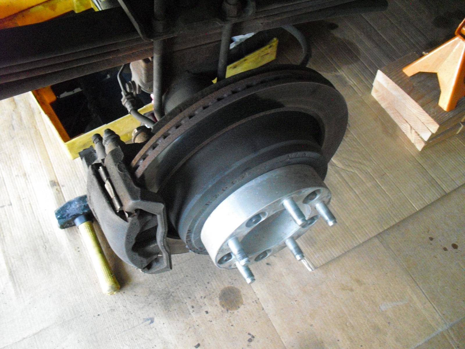

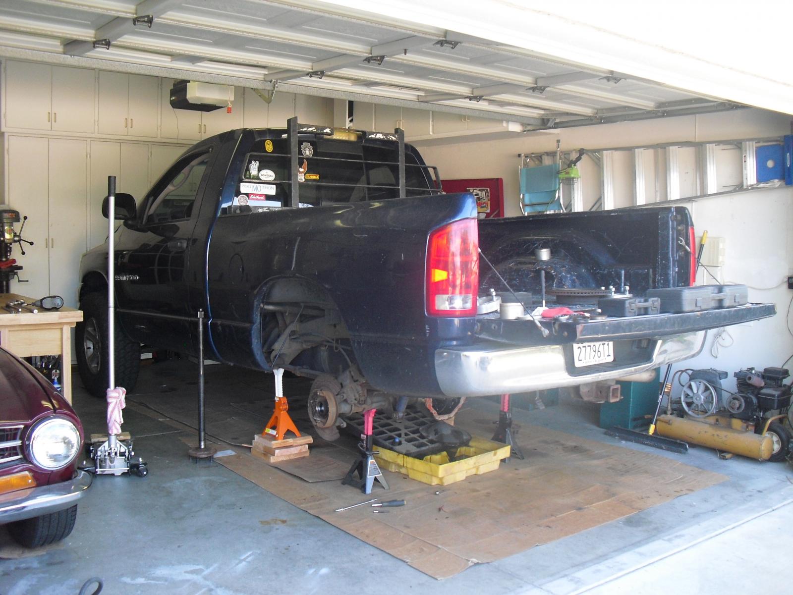

Howdy Ya'll.......... another tale of woe from the "That Piece Of Crap Dodge" department.
Rear wheel bearings are screwed, time for new ones.

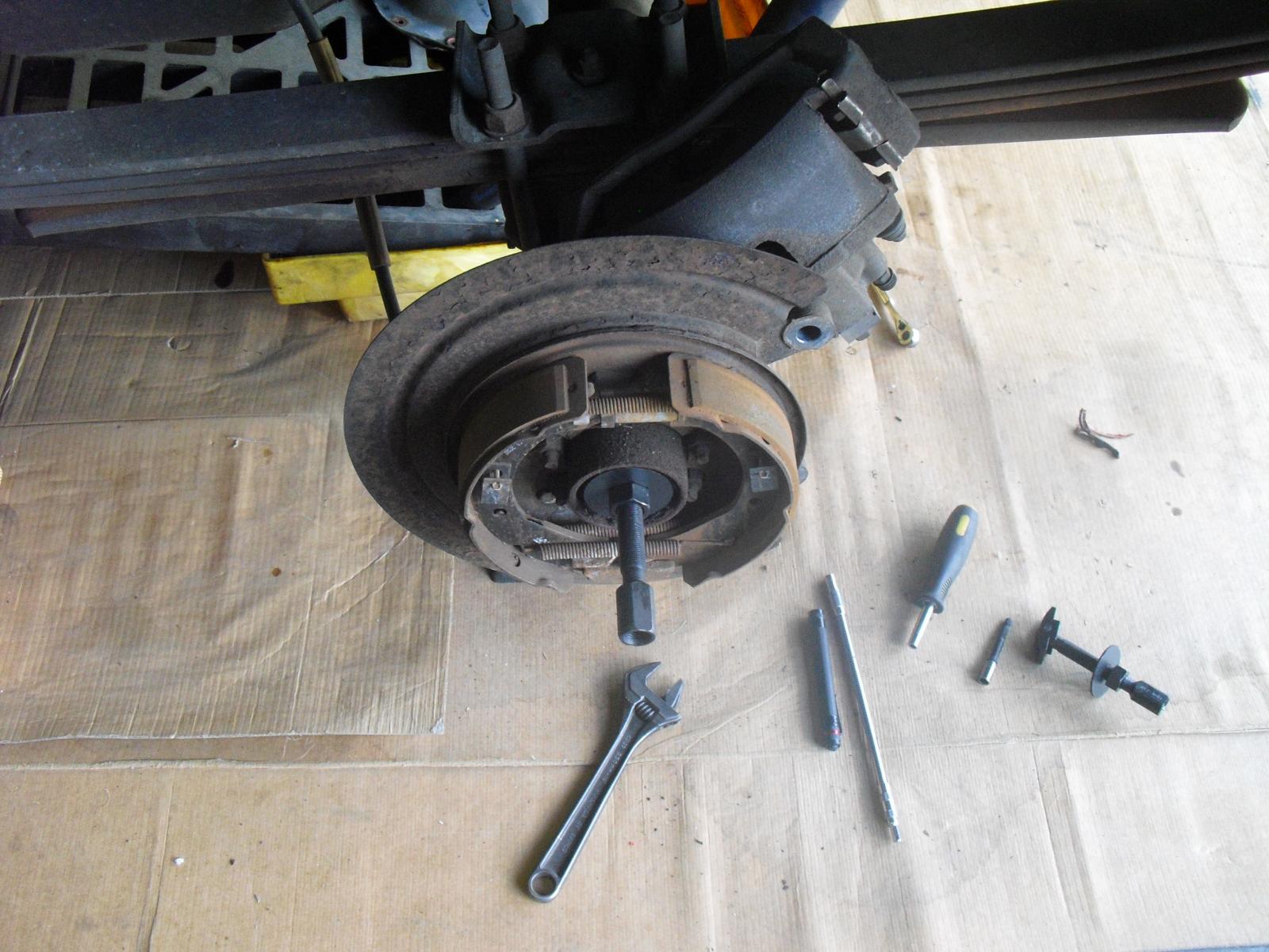

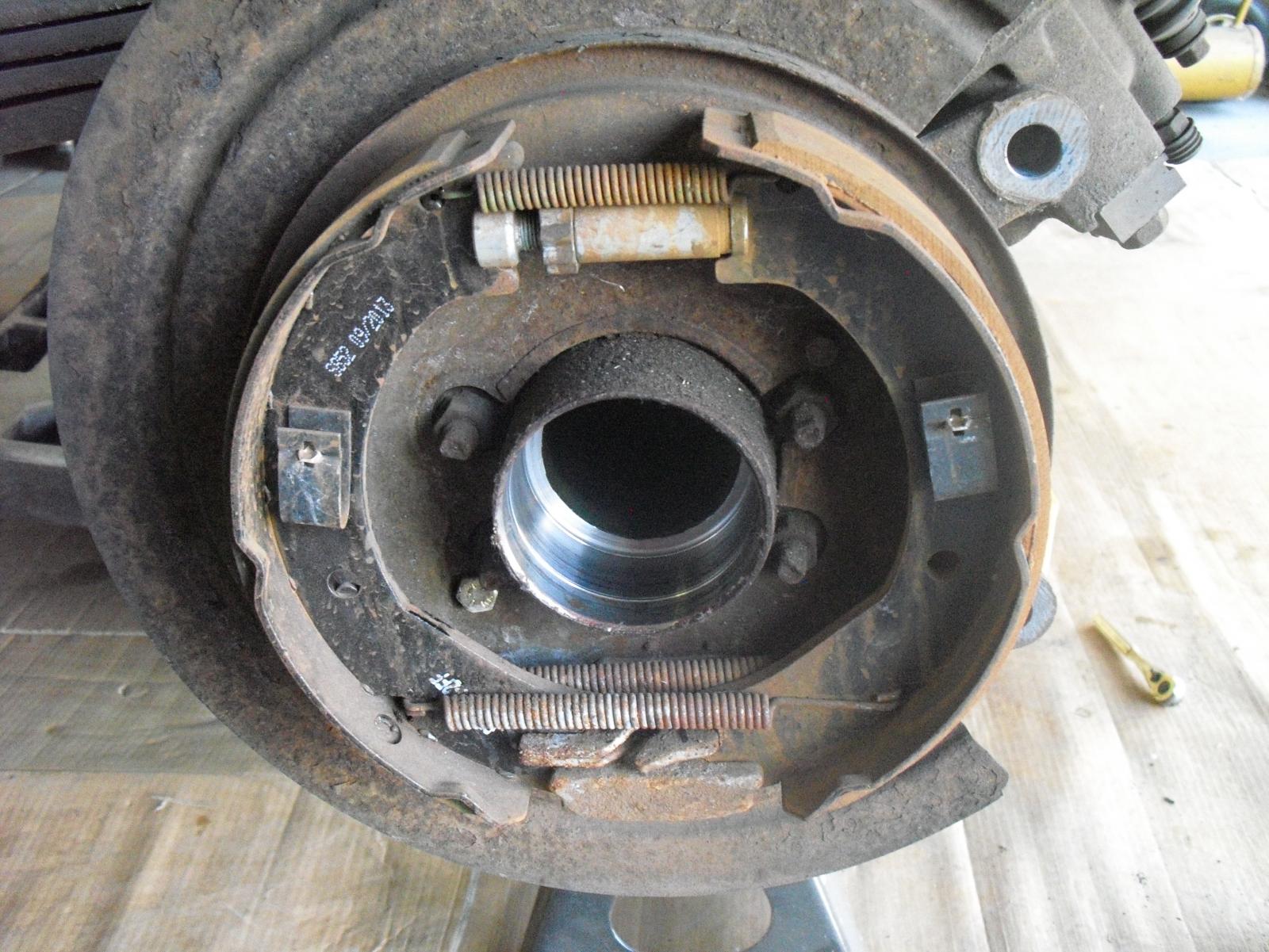

First off remove calipers, discs, diff cover blah blah blah and get to the nitty gritty.

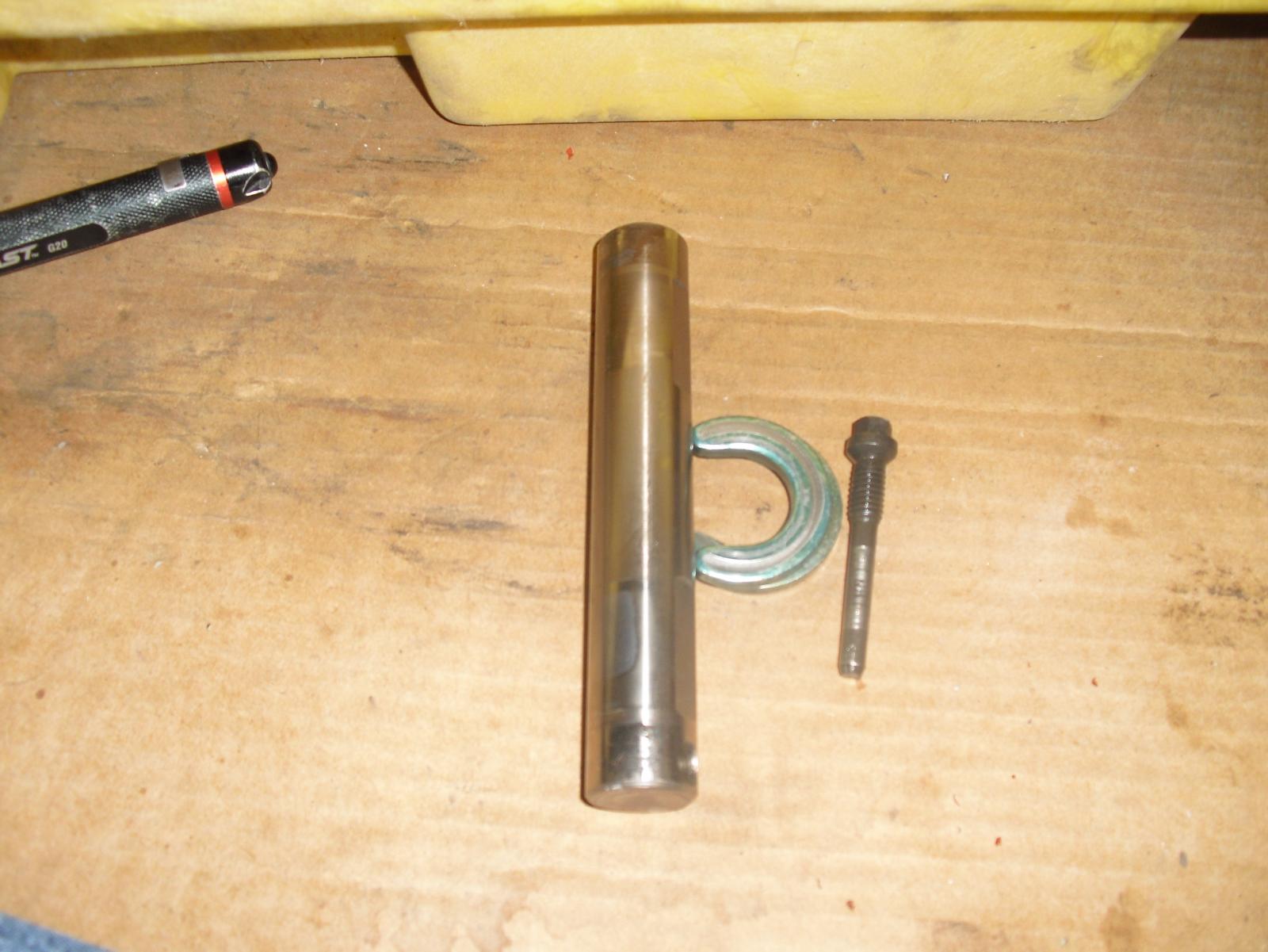

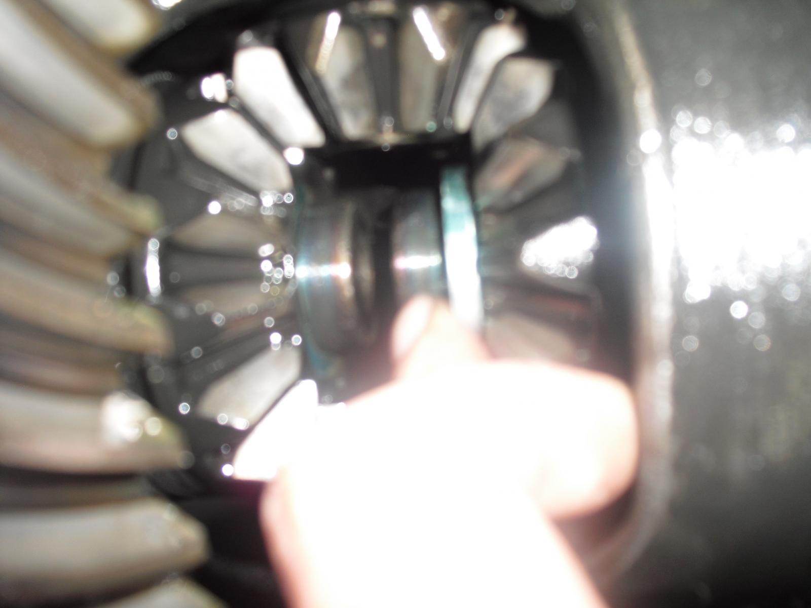

Remove holding peg bolt and withdraw shaft from planet gears.
Push half shafts inward and remove C washers from shafts.

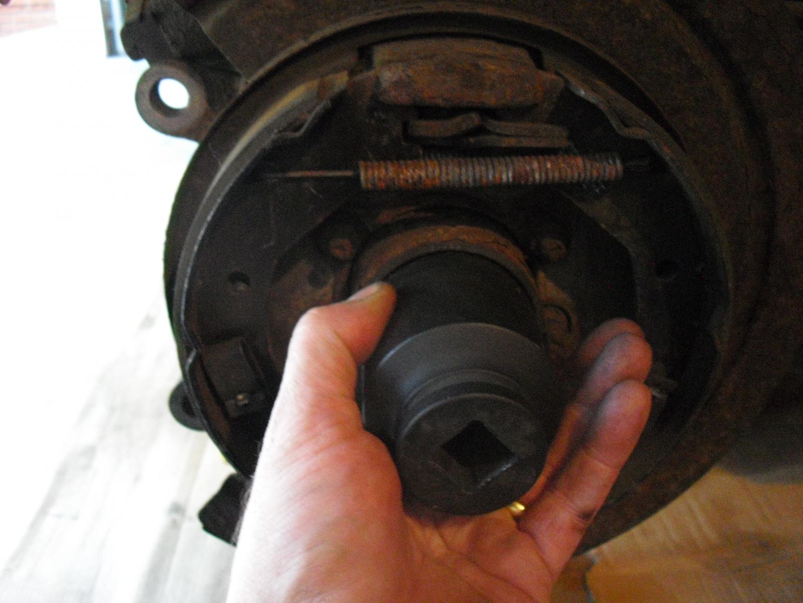

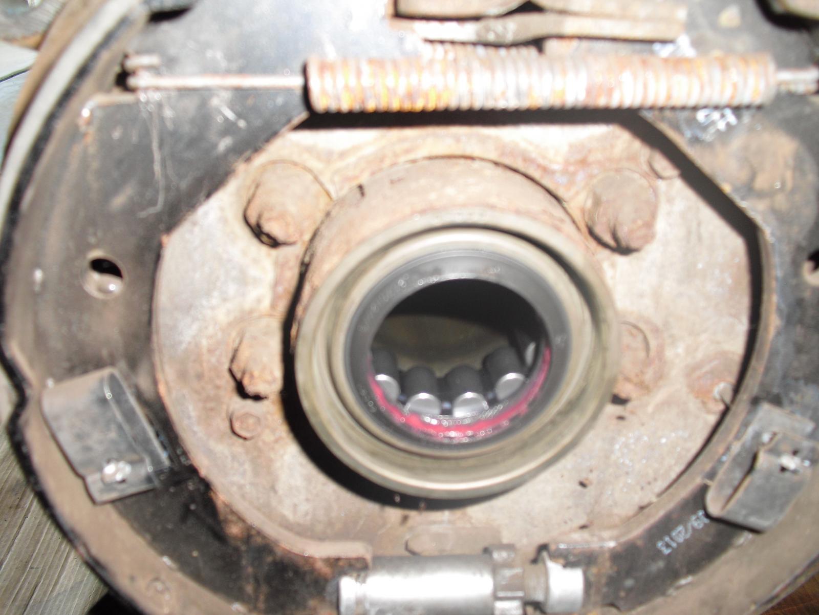

Insert internal bearing puller and attach slide hammer. Three or four good sharp yanks and the bearing and seal are out.
A quick phone call to Autozone and yes they have replacements in stock.
However these are damage replacement bearings, all one piece seal and bearing unit which is a reverse unit, thus the seal end sits in the original bearing housing and the bearing sits in the seal housing. Not what I want because I've no damage. Back at autozone they produce what I originally wanted, a roller bearing and separate seal. Fortunately I'd taken measuring equipment with me and discovered they were slightly wrong, .005" down on the outside dia.........Bollocks.......the original bearings are a bastard size and only available from the Dodge Dealership........Bollocks again.......Best get my pants down and lube up.
That's right........$227.66 for two bearings, two seals and a bottle of LSD lube.........Fucks sake.
Anyway, Gently tap in new bearings with an appropriate socket and the seals with a flat piece of wood, then rebuild is reversal of strip down........don't forget oil.

So is that C washer the only thing that axially locates the half shaft / hub / wheel?
(I guess it can't break completely free because of the brake disc)
Pretty much yes, apart from the brake disc as you've figured, and the shaft between the planets stops any inward float. It all looks a crap idea that could fail fairly rapidly at first glance, but this axle is just shy of 200,000 miles and shows no sign of not being able to do another 200,000 without issue...................having said that, the bearing noise has reduced a lot since the outsides were replaced, but there is still a rumble, so it looks like the taper bearings in the diff will be the next subject of attention fairly soon............time to lube up and bend over again.
