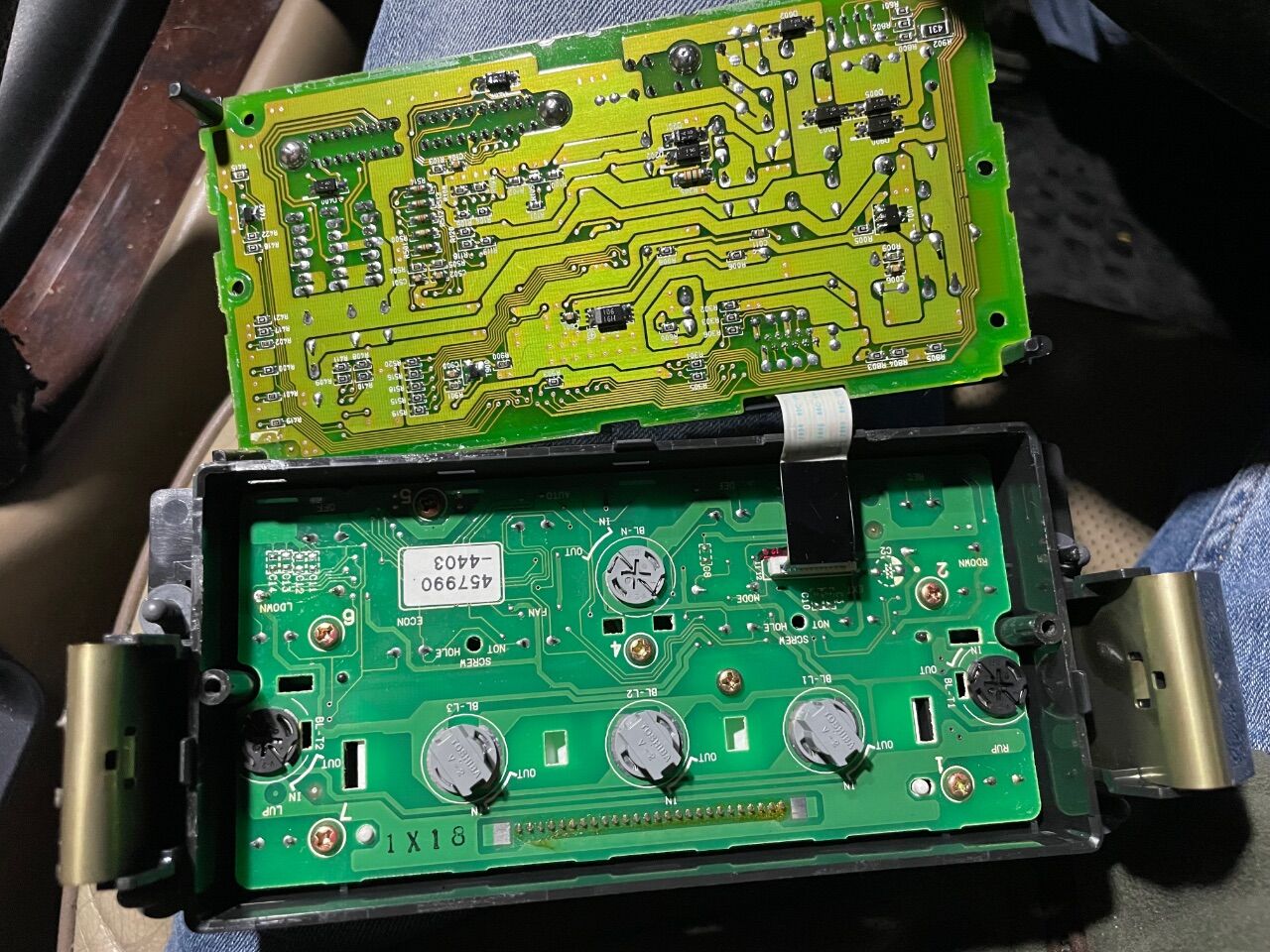

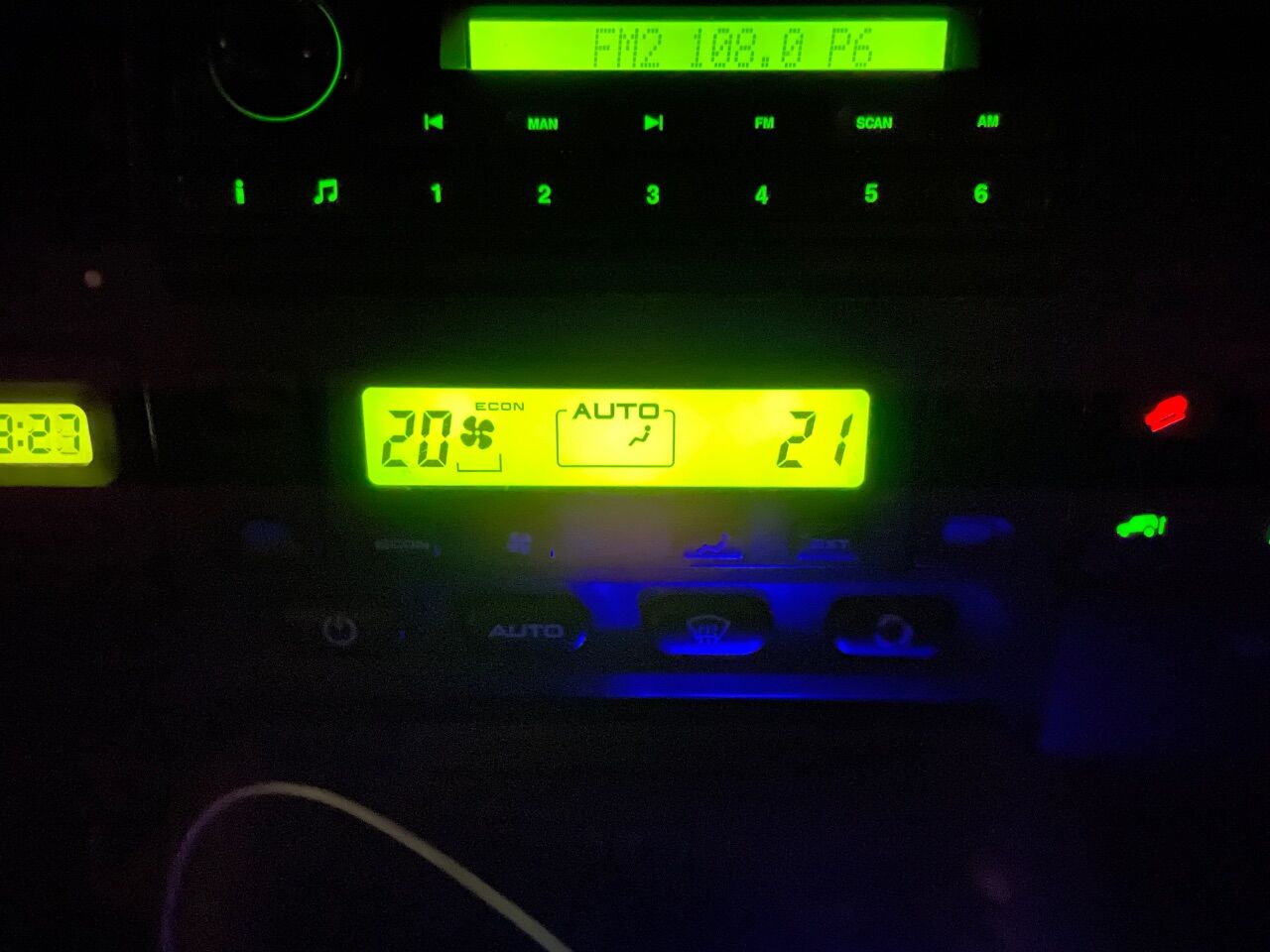

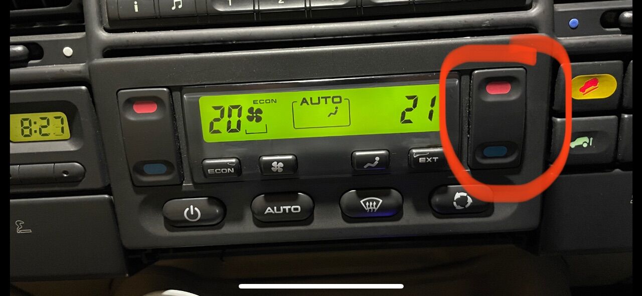

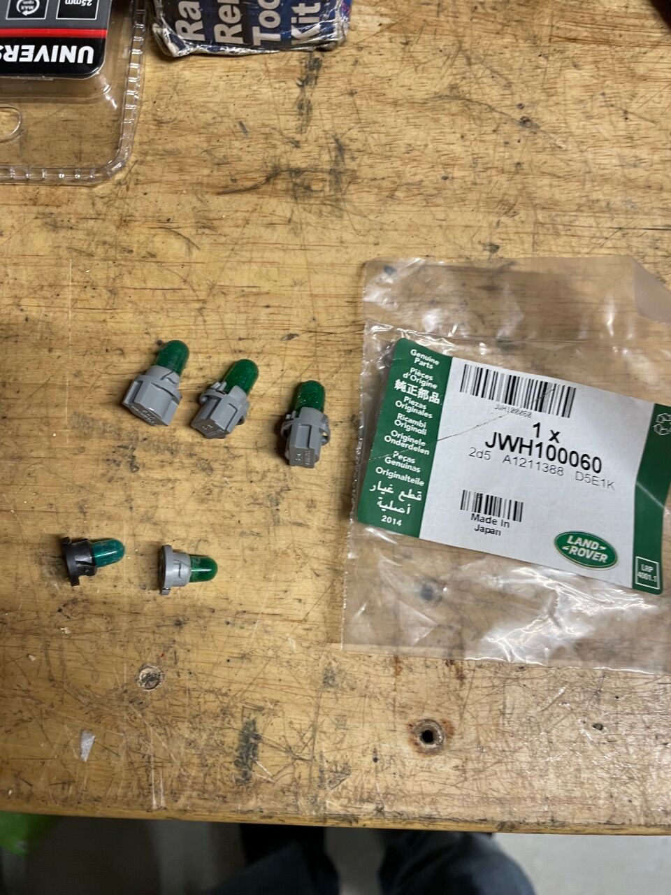

I’ve had a couple of dash bulbs out for a while now. And one more has followed. So tonight I’ve attempted to rectify at least a couple of bulbs in the heater control unit. It’s got dual control, and the right side heat button doesn’t illuminate, annoying now it’s dark early.
This one to be exact
so I set to and removed the control from the dash. I have brand new bulbs in stock, so not a penny spent.
while I was in there, I changed them all! 3 across the top that light up the display. Two for the hot/cold buttons and one for the buttons along the bottom.
and guess what! Now none of them work. Only the display bulbs. You fucking horrible hateful spiteful chunk of British SHIT.
im at a loss, I don’t know why. I put the old bulbs back in and nothing, still dark. Fuck you landrover. 🖕
Fucking ungrateful bastard. Like it wants to be set on fire

I sat down for a while to cool my head.

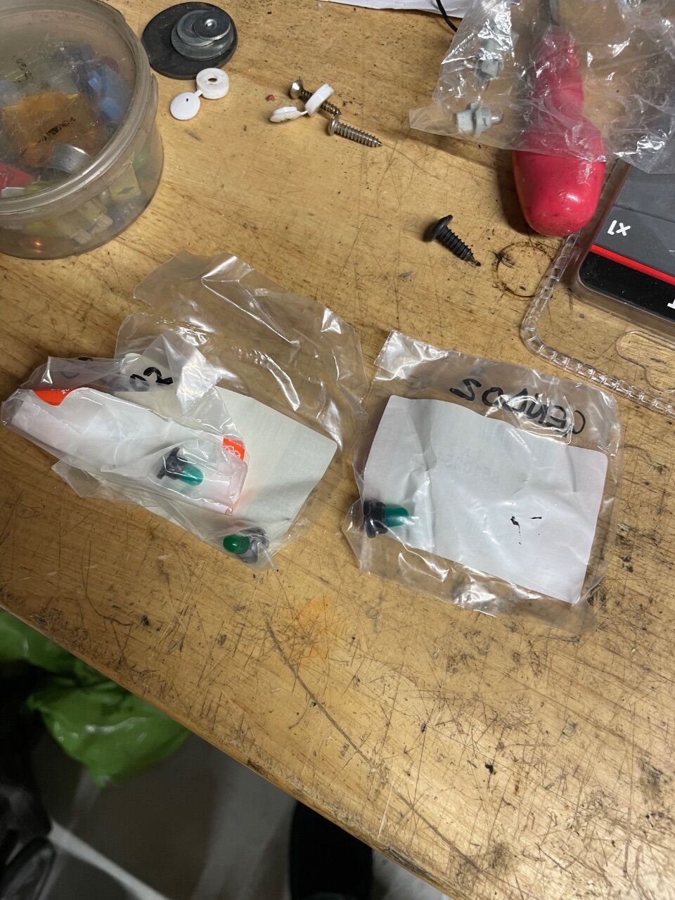

I had used bulbs from a bag full of bulbs. Were they already blown? so I had a look through the brown envelope of bulbs and found some still in packages.
out you fucking come
boom. Previous owner saved blown bulbs 🤦‍♂️

I've definitely started testing anything electrical, wherever possible, to see if it works before I actually start stripping the car down to fit bits.
I do try to make sure that I've binned anything that's taken out which doesn't work, but it's still really easy to get caught out.
  • Agree 1
I definitely got caught out on this one. I have more bulbs in random bags too that probably don’t work, but also still have another set in sealed bags so it’s a right mash 🤣

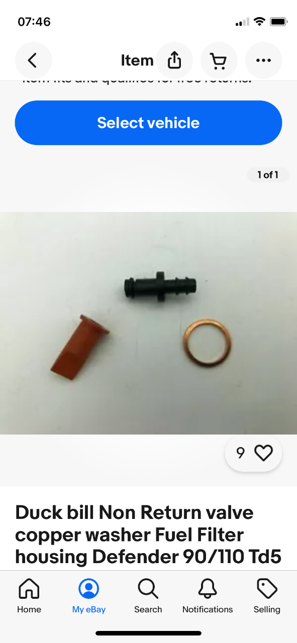

back to having difficulties starting again, exact same issue I had before. It’s been starting and running perfectly well since I changed the fuel filter last month, not an ounce of trouble, then boom. Attempted to start in the car park at work and it coughed into life. Attempted to start this morning and it wouldn’t. Fires but cuts straight out. Only once the ignition has been primed a few times will it cough itself back into life.
Thought I’d cured this. In fact I was ADAMANT I’d cured it with a decent filtray fitted. But no.
it’ll end up having the parts cannon thrown at it. Next up is injector seals or filter housing. The filter houses go porous apparently and drag air in. But why on earth has it been starting fine every day since mid November? Oh and my door is still rattling. Cunt.

On my old diesel P38, I had a major diesel drain back issue, sometimes it would almost flatten the battery before it actually dragged itself to life.
I 'fixed' it by fitting a cheapo no return valve in the supply line.
Yeah these “duckbill” non return valves are just over £20. Then there’s a bleed valve on the filter housing, they’re double at just over £40. Injector washers and o-rings are about £50 for a set if you can find the right seller on eBay for genuine ones. It starts getting expensive when you’ve already changed the pump (£140) and the filter (£18) 🙄😅
