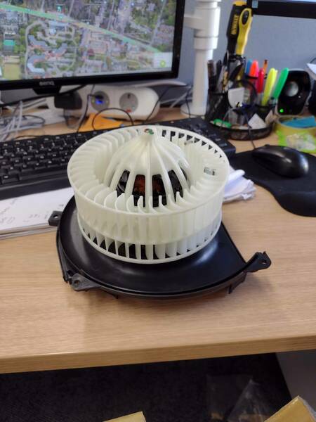

Volksy Posted January 22, 2024 Author Posted January 22, 2024 This arrived today. Although the original has decided to work now. Obvs. Will get it fitted on the weekend. As Mr Imp and I are planning on a tinkering day on Saturday. Rust Collector, N Dentressangle, Coprolalia and 2 others 5

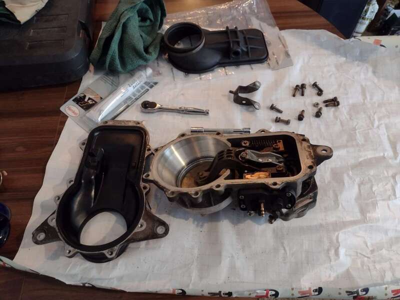

Volksy Posted January 29, 2024 Author Posted January 29, 2024 Managed a days 'Tinkering' on Saturday. Job #1 SUCCESS! Replaced the seizing blower fan, of course the replacement was LHD, so a mirror image of the original (Autodoc didn't state that they were handed). Managed to swap the new motor into the old housing and also reattach and sort out the small air sampling fan which had fallen off. This sits next to the blower under the dash, but sucks air through a tube which runs up the 'A' pillar, across the headlining to a small vent near the sunroof controls. The tube had detached which meant that the air sampler was taking its measurements from air under the dash and not engaging the rudimentary climate control. Seems to work now, even varying the temp controls has an effect, and the fan is no longer blowing fuses. Job #2 FAIL Had a look at the rear electric windows. The NSR has a blown motor by the looks of it, as I couldn't coax it into any semblance of life. On the OSR the small plastic slider has disintegrated, so the arm is no longer connected to the window. I have some new sliders, that are correct. However the motor needs to come out to fit them, as the stupid design means you have to hammer the slider to flatten out the connecting 'rivet'. Someone prior to me, has hard wired the wiring to the motor. Great. So to repair these I'll need two new motors. Job #3 FAIL Investigated the central locking. Which works from the passenger door, but not the drivers. Need to find a replacement microswitch for the drivers door lock. Also the NSR door will unlock, but not lock when the central locking is used, the vacuum actuator has a couple of diaphragms inside, one of which is blown. I ordered a new actuator, which was slightly different to the original. So now need to order some larger diameter vacuum hose as well. Job #4 F*CK KNOWS I put new Bosch plugs in and a Bosch air filter on, as it was on ancient NGK plugs and a no brand air filter. The old plugs were badly fouled, given how rough it was running, I'm not surprised. Driving around all day on Saturday and Sunday. it ran like a dream. This morning however (it has pissed it down all night) it ran like a complete bag of shite, cutting out at every opportunity until it was fully warmed up. I think moisture is getting into somewhere it shouldn't. These were all in between assisting M.Imp with the crank seal/cambelt replacement on his recently acquired Volvo 740. Which seems to have been a success. Rust Collector, HillmanImp, Coprolalia and 1 other 4
