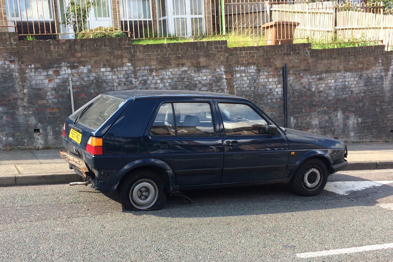

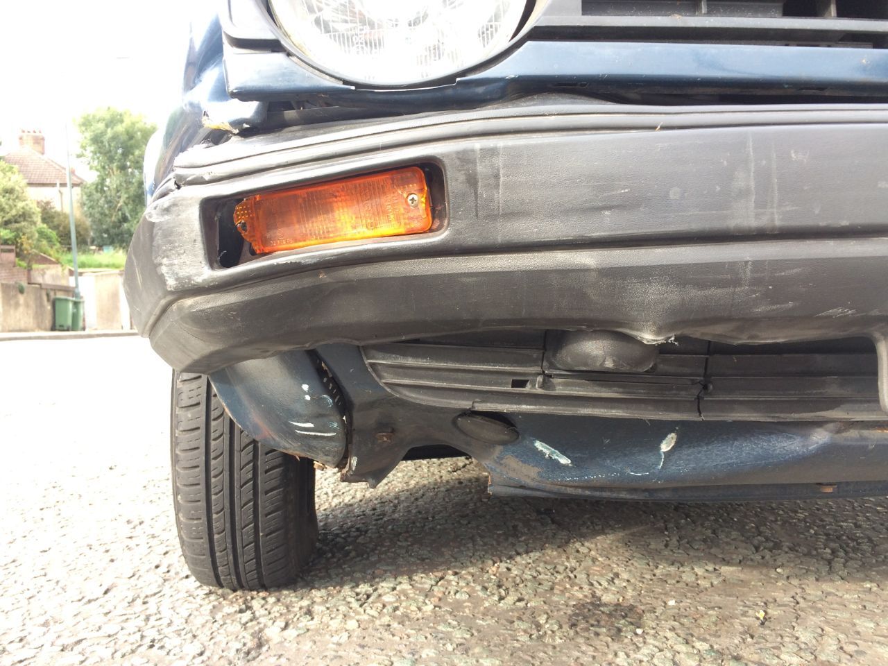

Then again I've got form - Golf looked like this when I got it back from being nicked:
IMG_E2578.JPG.2a69ac2b1cb1c7ef8459d9909c66664e.JPG  IMG_2619.JPG.d5adec9213af6cb81ef48bb0dfaee1f7.JPG
Was a £150 car, just couldn't bear to scrap it seeing as it had come back to me after an 800 mile-round trip, so here we are 9 ish years and 60k miles later

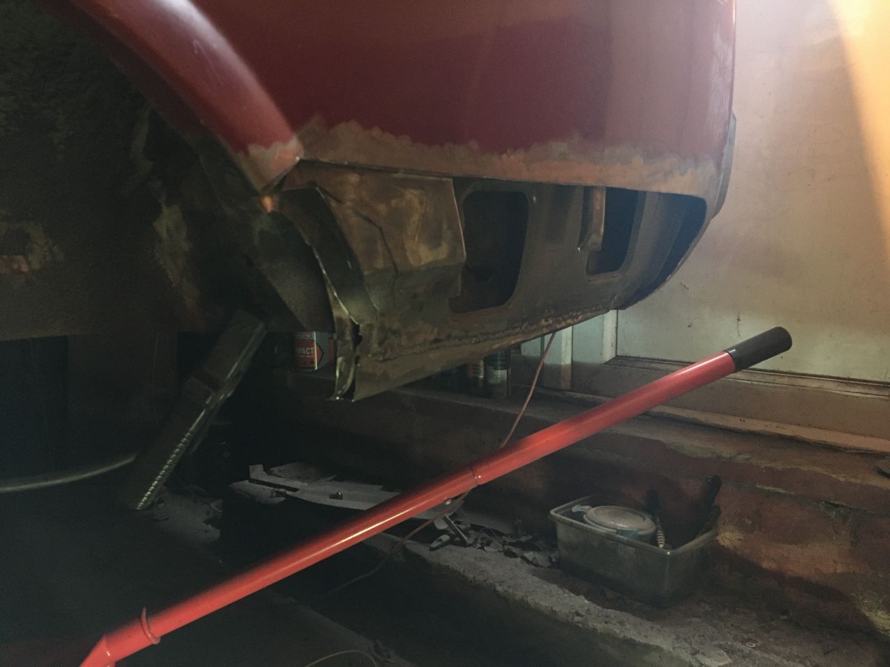

Cutting away the first bit of the outer sill reveals more work, as expected
New piece roughed out - not getting fussy as nobody's gonna see it:
Not the neatest but it'll do the job ok
Then removed the rest of the outer sill and made a few more small patches

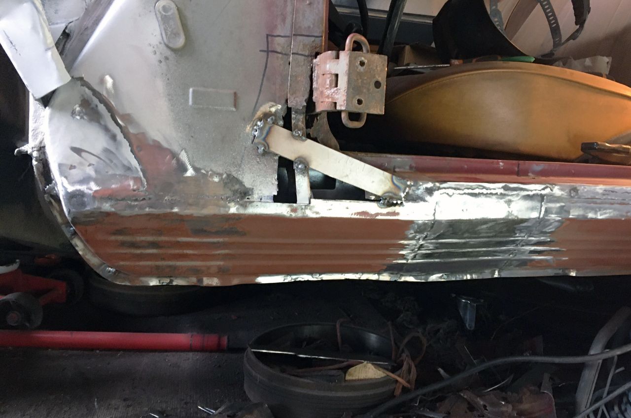

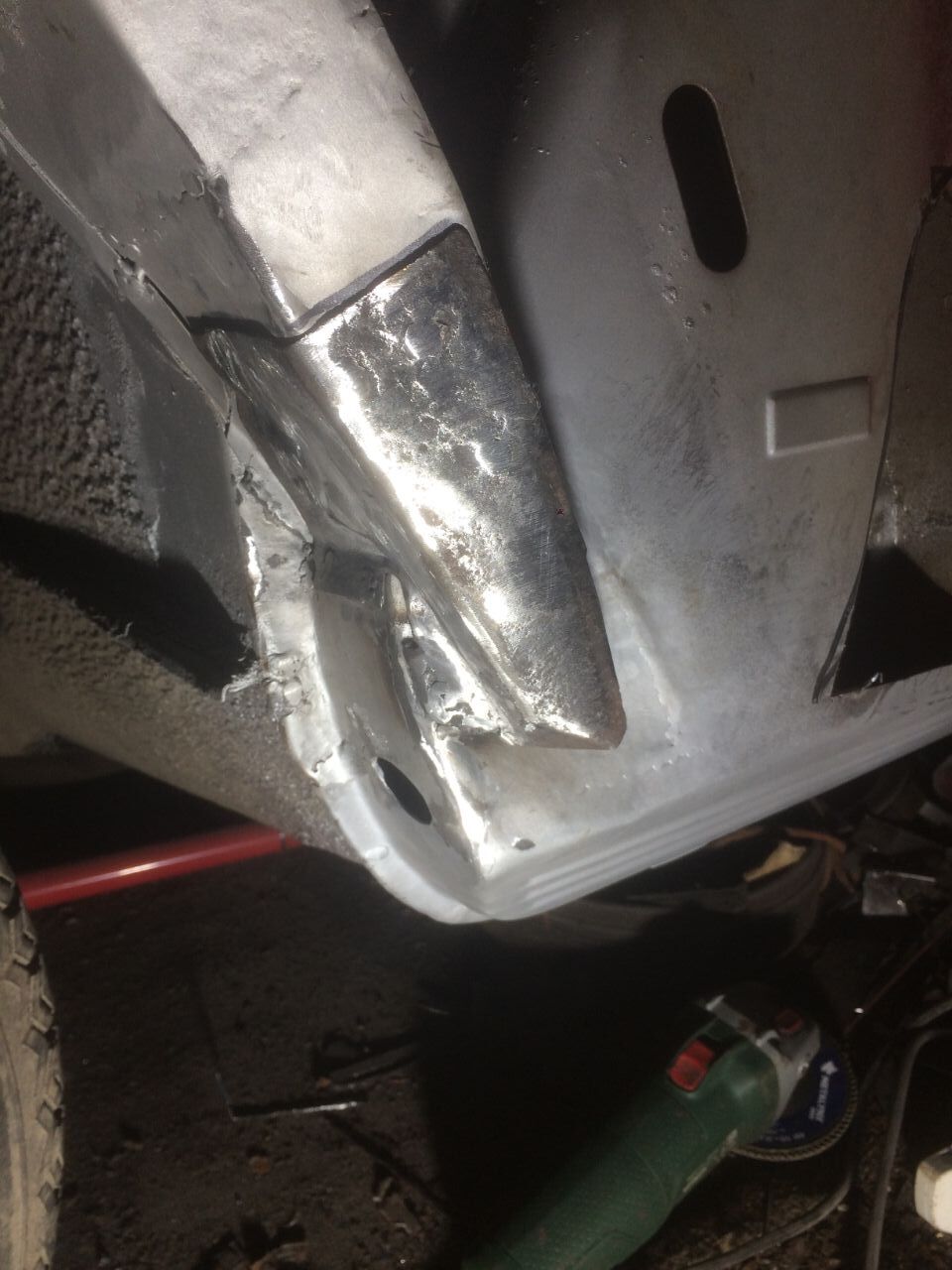

Chopped up some more sill repair panel scraps I had left, used the bottom of the B piller section to make part of the A pillar repair
Then poked somewhere I shouldn't have and created more work for myself...
There's still a fair amount to do - the n/s dogleg has rust, there are a few small holes in the passenger footwell, then the same repair as on the other side at the bottom of the rear wing, and of course the boot floor...
That bottom of A pillar/sill end/hinge bit scares me!

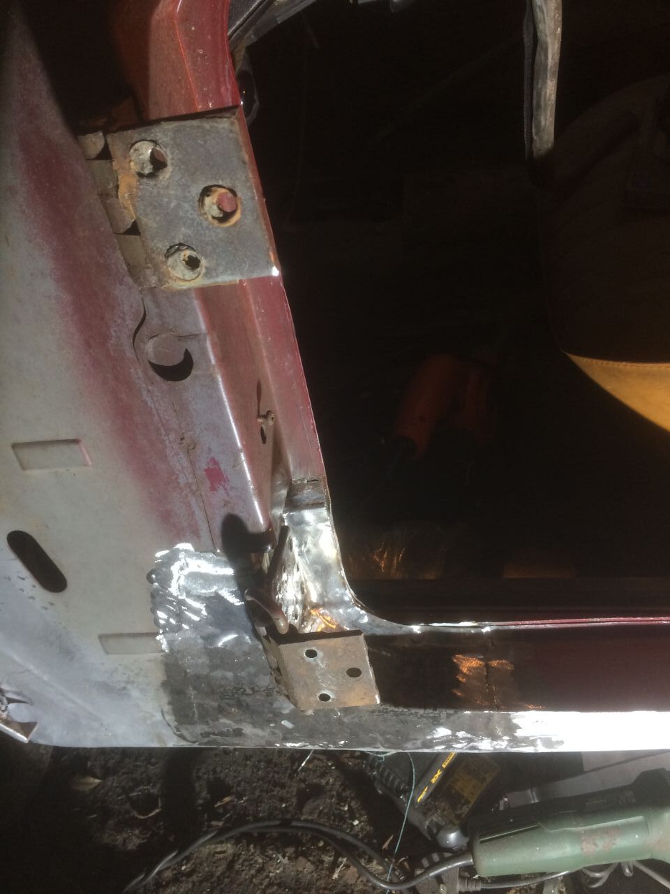

filled in the missing bits of the bottom corner:
Then kind of eyeballed the position of the bottom hinge and tacked it loosely in place so that I can fine-tune it later.

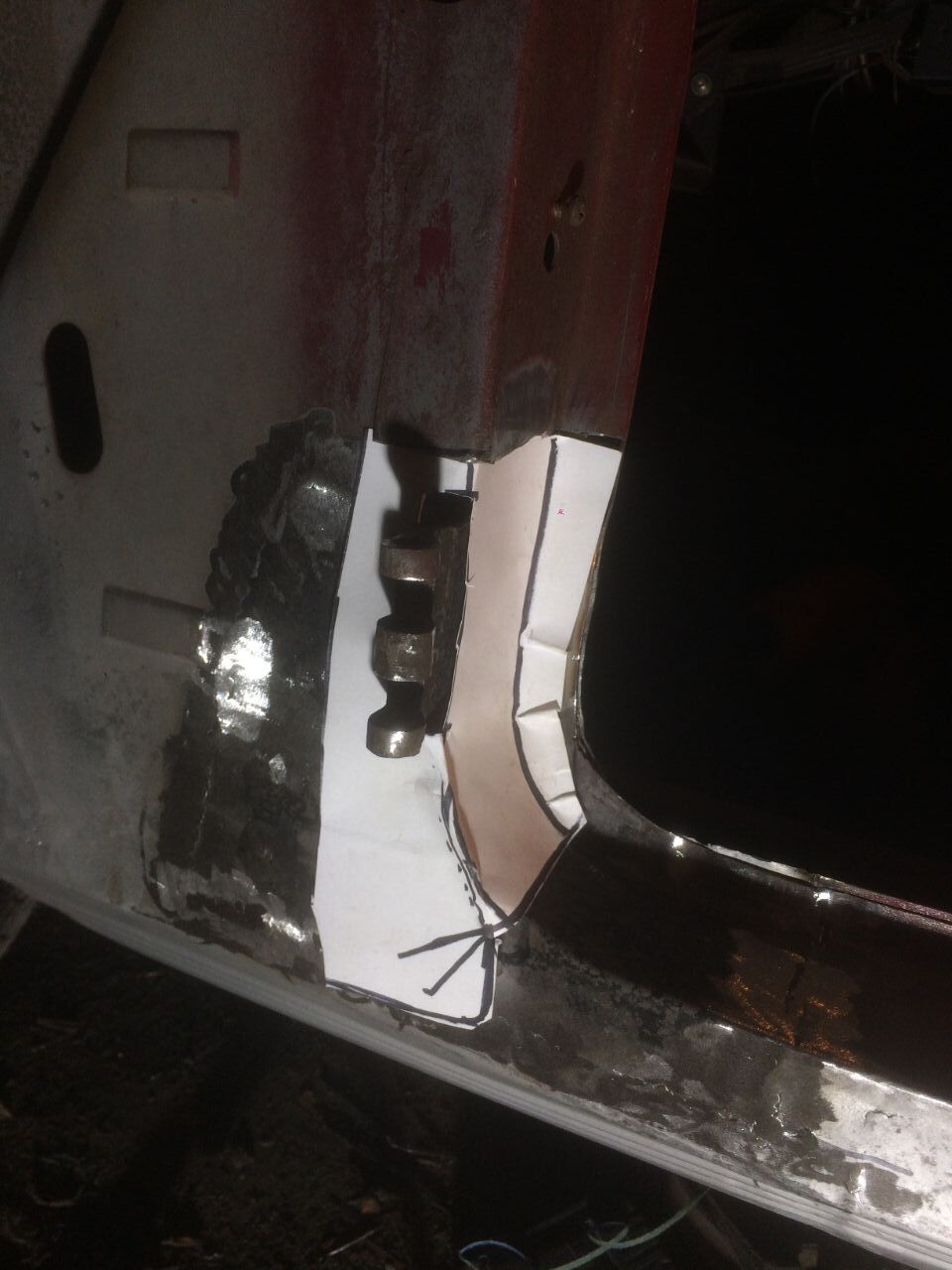

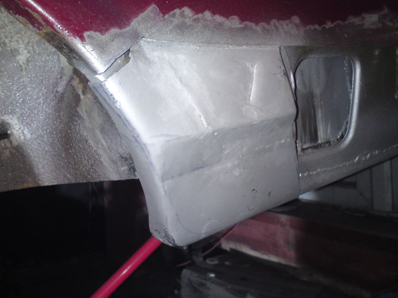

Bit of a difficult panel next, required templating
IMG_2195.JPG.daeba27a1d43088085818ae4f1bd310f.JPG  IMG_2196.JPG.f9882fc2bb63d8b25e6bb182623a3600.JPG
Eh, close enough, can see i didn't leave quite enough metal for the edge of the piece, but weather stripping will cover it so nobody will see my shoddy work !
the aperture for the hinge is a bit big but will make sure to put some kind of mastic around it to make sure no water gets in. From the factory it's just a hole, so no surprises that it's a pretty common rust trap.

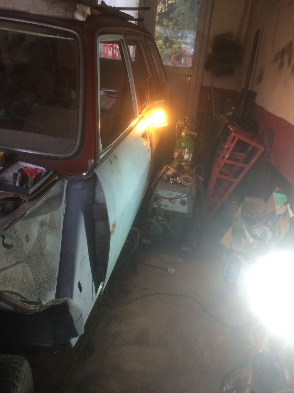

Hinge fitted, time to test fit the door:
Exact science applied for the panel gaps as usual
Whacked the bottom hinge a bit, but like the driver's side needed a helping hand in the form of a spacer:
Yeah that'll do
Now quickly weld the bugger in place so it doesn't move!

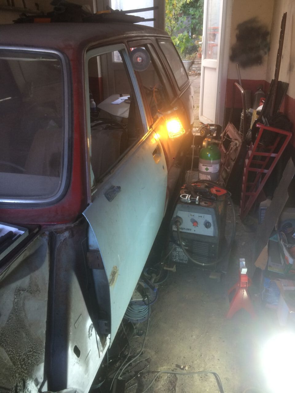

On to the bottom of the windscreen, which of course required removing the door that I'd just spent ages lining up...
Rough patch for the inner piece:
Part 2
And finally
Think we're doing alright bearing in mind before I bought this thing I'd never touched a welding set...
Then spent another hour faffing with door to get it to sit properly

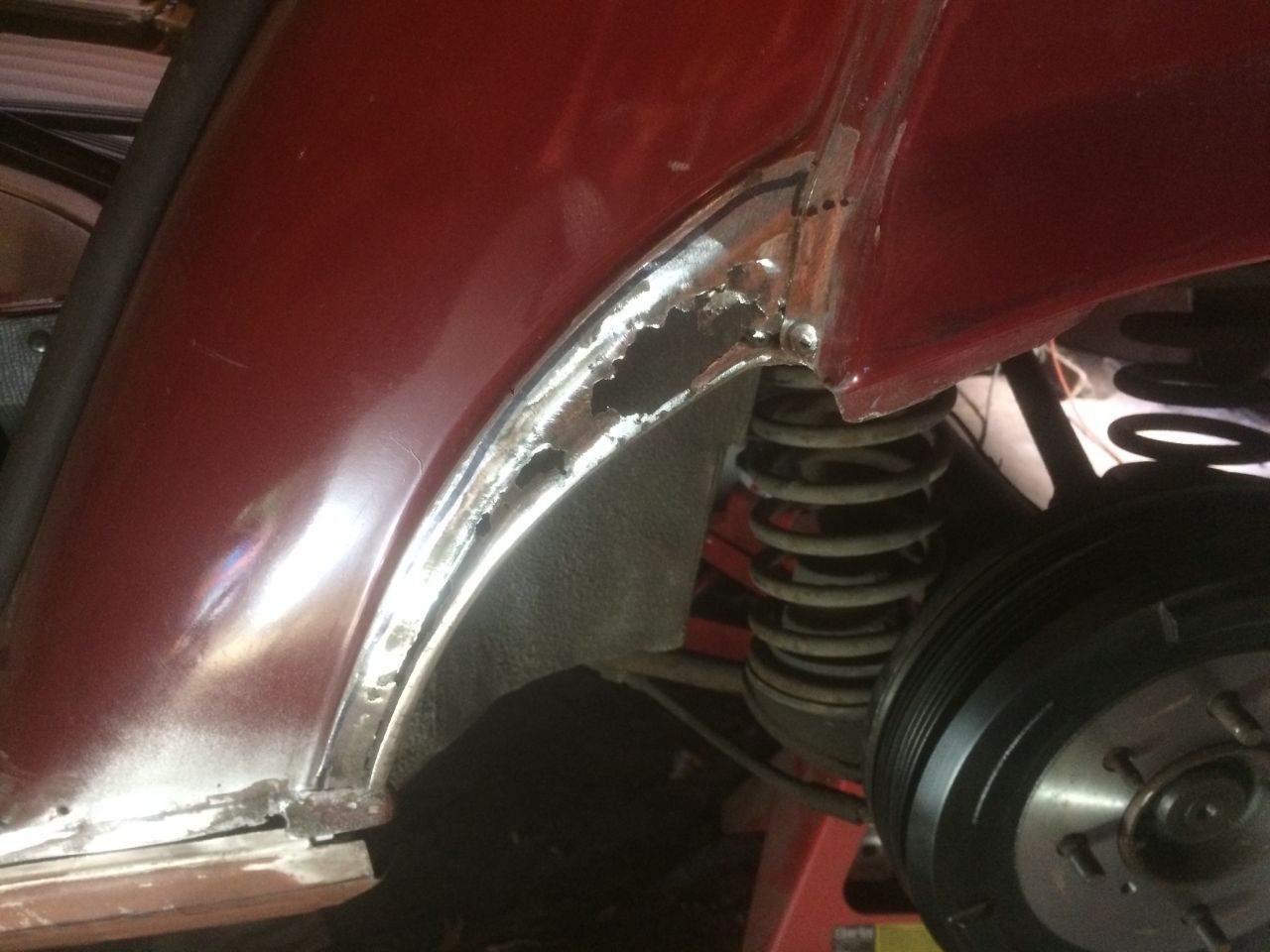

Dogleg rust:
Seen somewhere that you can use tape to make a template - layer it up enough and it'll match the profile when you peel it off - so decided to give it a go:
Bit of tapping and we had this:
Trimmed and welded into place, not too bad
Time to fill the gaps:
Again not the neatest but will be covered by running board trim anyway
And finally a few small patches to complete this section

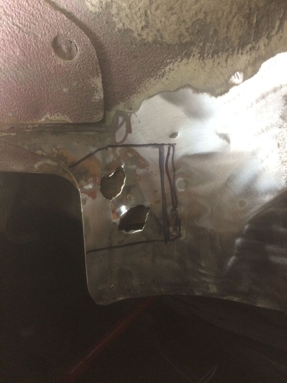

Finally cut out everything rotten, ready to make new panels.
There's a hole in the back side of this section behind the fuel tank bracket (can just about see it through the cutout in the reinforcing piece), might be a bit fun to repair that without taking the bracket off but we'll see

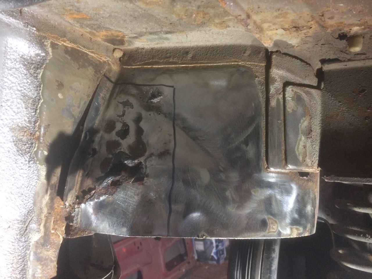

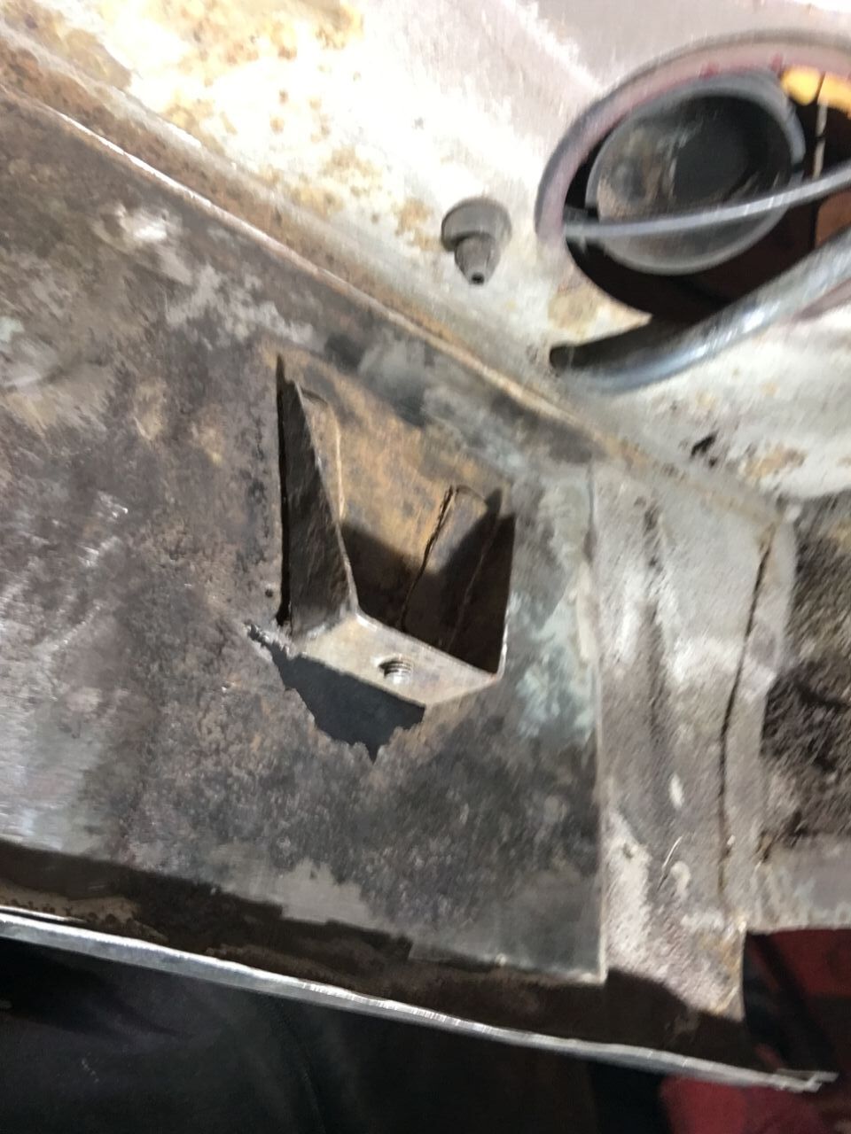

Continuing on the bum of the 504, started making repair panels:

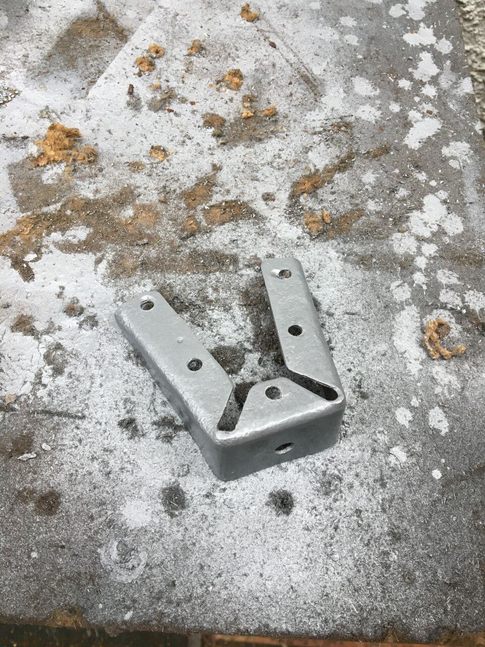

The fuel tank bracket acts as a very useful trap for all kinds of mud and dirt, so naturally the inner panel had rusted out:
Cut out the rust, drilled out the welds on the bracket ready to reuse
then forgot to take a picture of the thing actually welded back in but oh well...
Next repair panel:
and again...

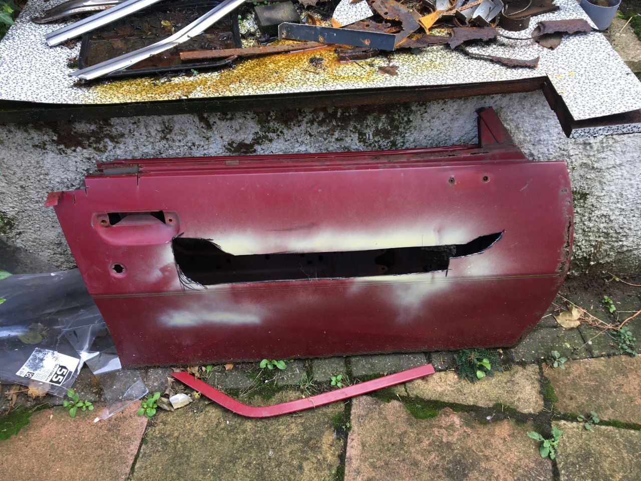

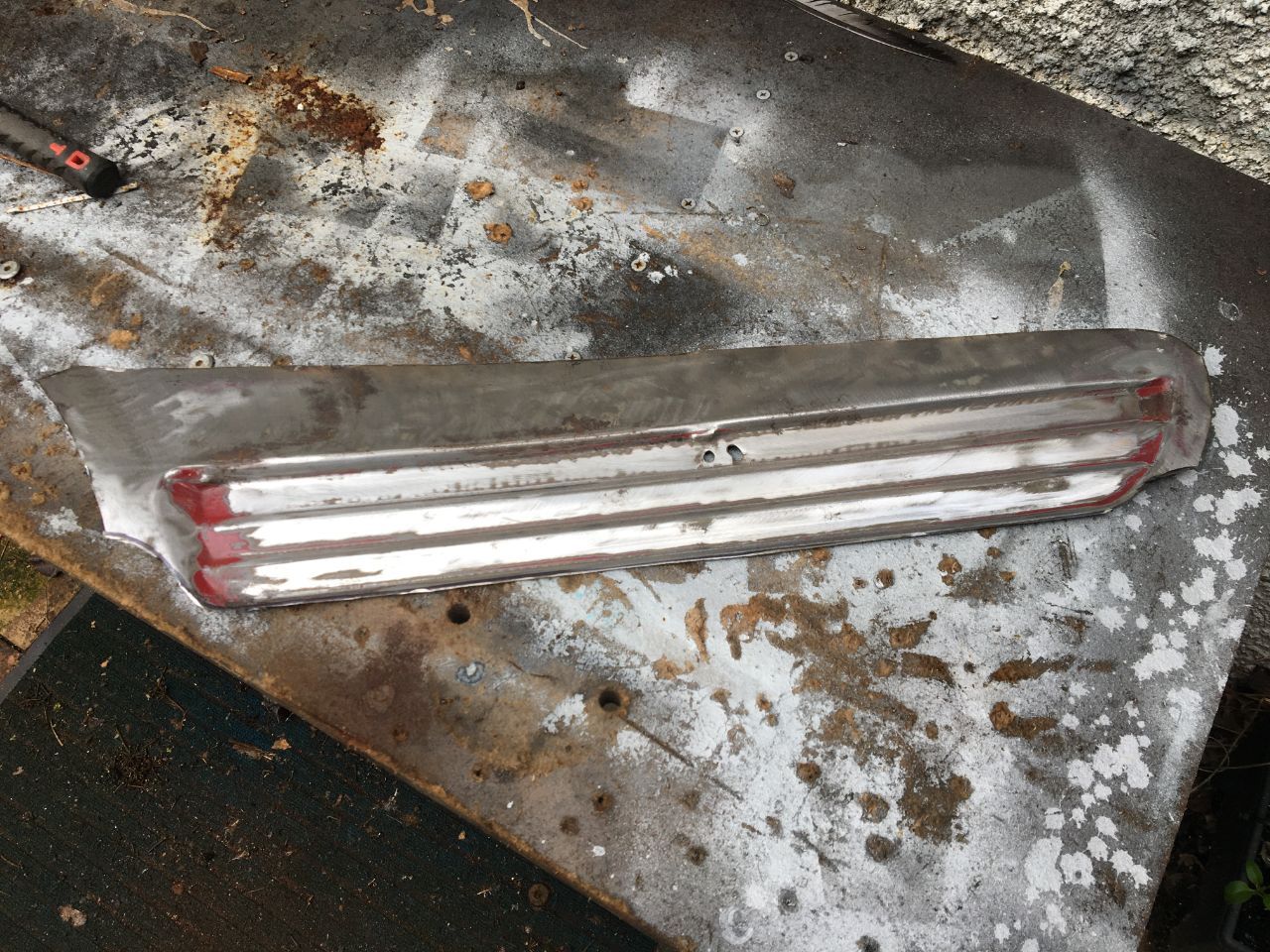

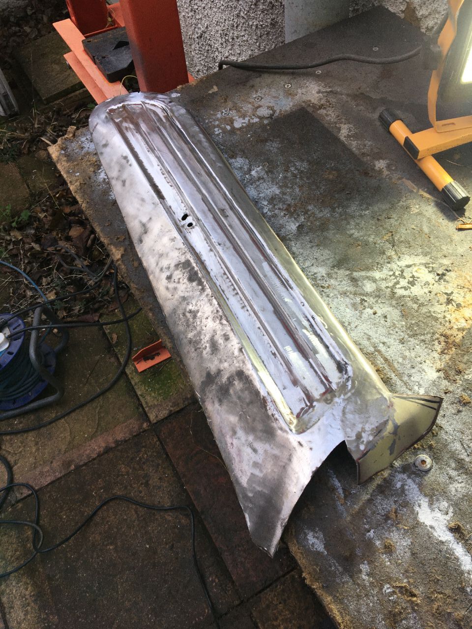

Then on to repairing the outer skin that I had salvaged previously.
Cut off everything for the bin, leaving this:
Starting to run out of material, so nabbed a bit from the remains of the old driver's door
Welded together we had this:
then attached to the car:
And with the missing piece filled in:

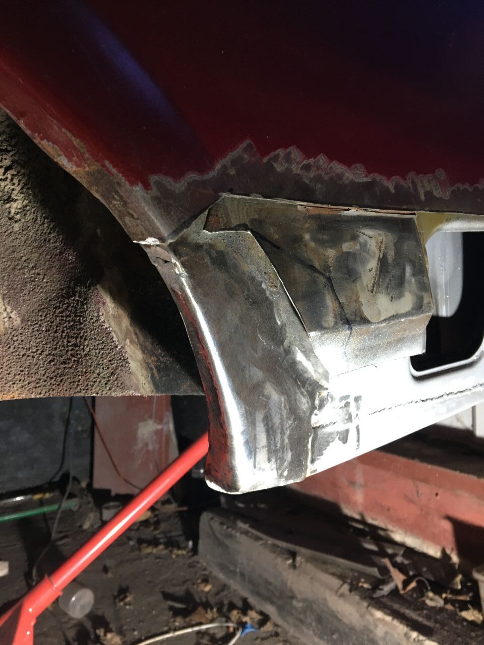

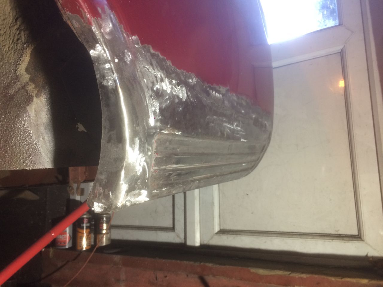

Last rusty bits in this area are in the trailing edge of the wheel tub.
Don't look too bad initially but of course poking reveals all as usual
IMG_2328.JPG.156a1a541b55adf092f6c67ba0d4a93b.JPG   IMG_2333.JPG.9c474910a0a1476ac51ab205caee24c8.JPG
And repair panels welded in:

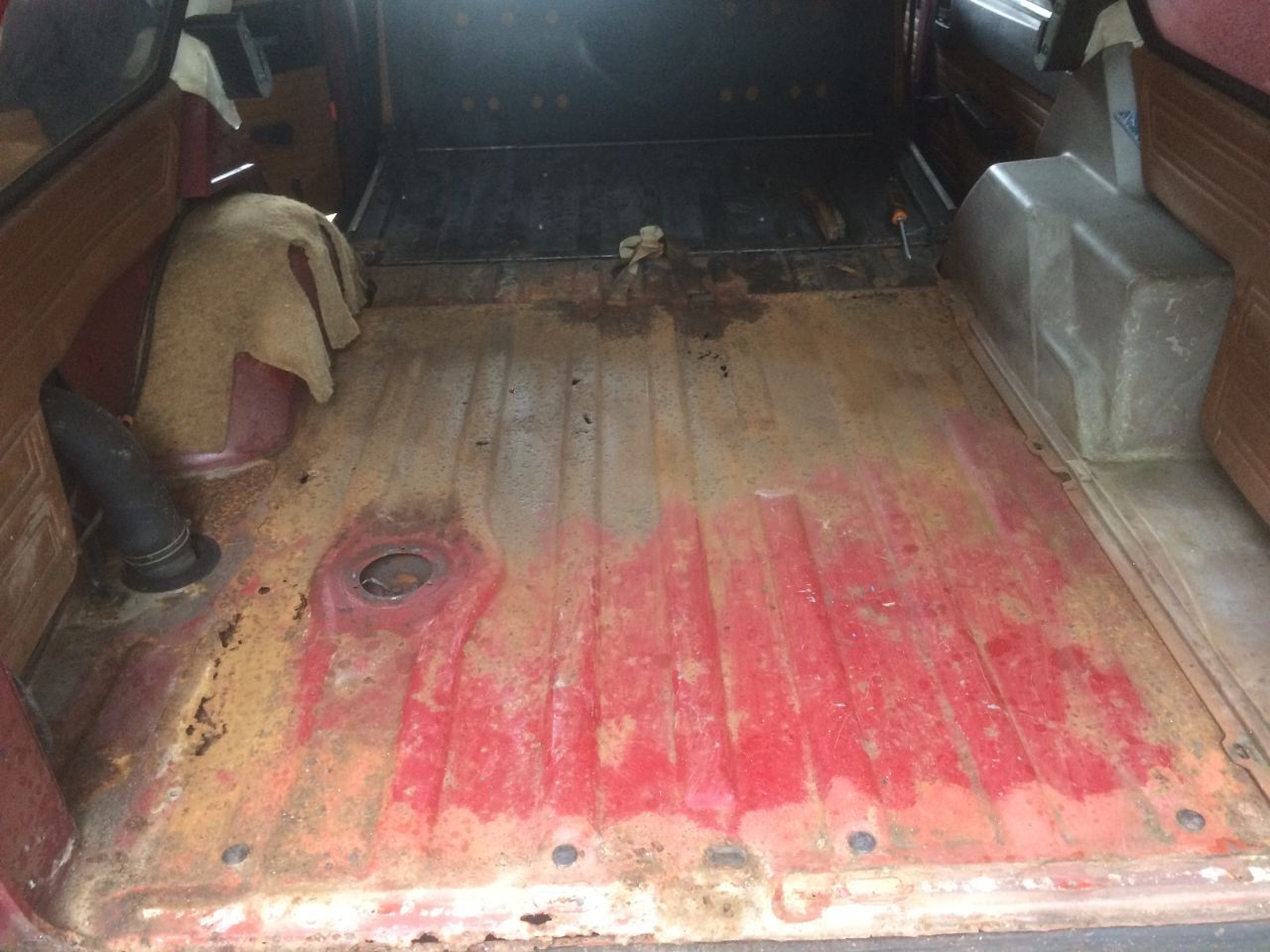

a reminder of what it looks like (can't take a photo now as the car is completely full of shit which I'll need to find a home for before starting this...)
It's very thin where it was left sitting with water leaking in from the tailgate, so I'm having to replace at least half of it.
Making the replacement piece will be fun though.
I don't have a bead roller, and even if I did it's a very big panel, so am leaning more towards making a 'mould' of sorts out of wood, clamping the sheet metal down and beating and chiseling it into the mould to form the pattern.

56 minutes ago, comfortablynumb said:
 and how much you want to piss off your neighbours!
think I've long surpassed this point - 6 months straight of angle grinder almost every weekend will do that
23 minutes ago, comfortablynumb said:
Or:
How big is your pressbrake?
Thanks yeah I watched this one, it's pretty good - problem is i don't have a brake. Seeing as the 'channels' are quite shallow might be able to get away without one? Would just take longer i guess
All I've got is a small vise and set of hammer and dollies. No air compressor either!
17 minutes ago, Asimo said:
See page 8...
In a similar vein also saw this video, at about 11mins he does something similar but with an open-ended former and air tools:
Would have to make a much bigger former though as the channels are much wider on the 504 floor
