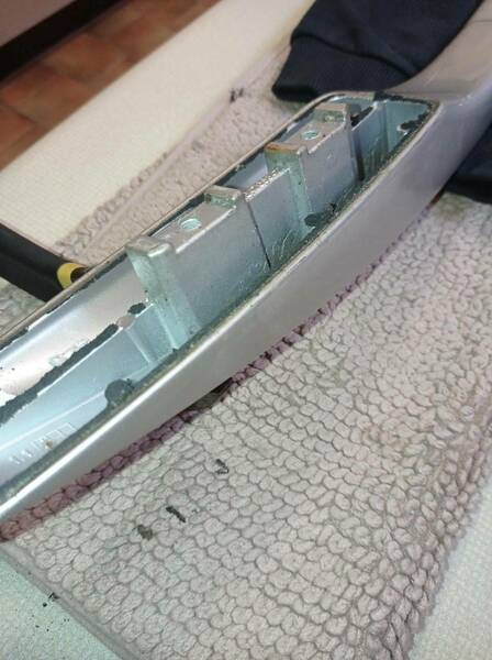

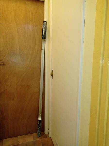

tooSavvy Posted October 27, 2023 Author Posted October 27, 2023 Praps twas a might 'impatient', on the choice.... A recce of the local Multi + tape measure mebbies a better plan ๐ค However..... ๐ยฃยฃยฃ O.M.G. Ebay bars..??? These were ยฃ42 delivered... Comparative steal ๐ .... Nice, slow 'winter project' ๐๐ ๐๐จ 500tops 1

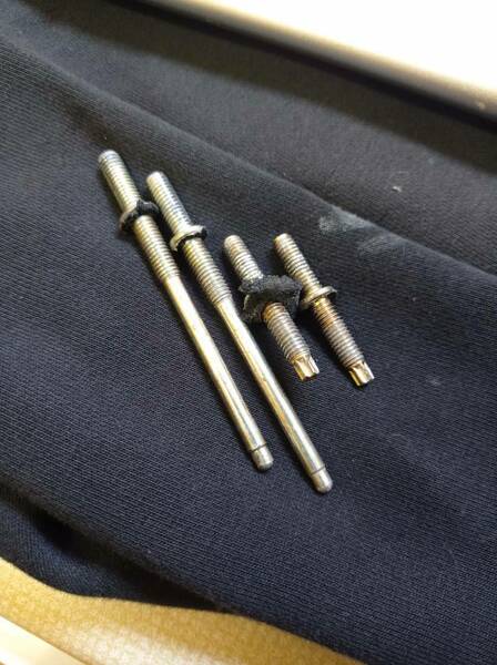

tooSavvy Posted October 27, 2023 Author Posted October 27, 2023 In order to fully assess the way these are constructed.... I have 'double nutted' the four retaining studs out. At the end of the day, I'm likely going to zipp off the protruding web (alloy) but didn't want to risk complications, with steel embedded in it!! Once the web is 'flattened off' I can lay this one on the roof and mark lengths/tube cut ๐ฏ.... No...... it's NOT S..H..O..R..T ๐คฆ ย privatewire 1
Rod/b Posted October 28, 2023 Posted October 28, 2023 Cant you get the bar out of the foot and shorten that rather than chop the foot down? Or is it all one casting? tooSavvy 1
tooSavvy Posted October 28, 2023 Author Posted October 28, 2023 12 hours ago, Rod/b said: Cant you get the bar out of the foot and shorten that rather than chop the foot down? Or is it all one casting? Yes..... Effectively, the bars are three pieces. My plan (cutting down the tail end foot) is a 'see how that looks' sort of idea. NO chopping yet!! ๐๐จ privatewire 1

tooSavvy Posted November 1, 2023 Author Posted November 1, 2023 Well.... Good to see everyone's curiosity burning away here ๐.. I will take the lid and cut it off, into a square piece, then chop out a 'letterbox' = equal to the high section of ally casting, sticking up from the foot. I will tape the tin plate close to the profile of the foot with gorilla tape.... I will then hacksaw the alloy [sticking through] into a sequence of slices/cut sequentially across horizontally... the tinplate will *guarantee I don't cut into the foot profile & ruining the finish ๐๐ A smidge of Dremel action will reduce any bobbles to a 100% flat plain face, and I may use the existing tapped holes for the securing Csk screws, holding the mounting flat face plate.... We Will See ..... ๐ ๏ธ๐๐๐ ๐๐จ Matty 1
privatewire Posted November 2, 2023 Posted November 2, 2023 12 hours ago, tooSavvy said: Well.... Good to see everyone's curiosity burning away here ๐.. I will take the lid and cut it off, into a square piece, then chop out a 'letterbox' = equal to the high section of ally casting, sticking up from the foot. I will tape the tin plate close to the profile of the foot with gorilla tape.... I will then hacksaw the alloy [sticking through] into a sequence of slices/cut sequentially across horizontally... the tinplate will *guarantee I don't cut into the foot profile & ruining the finish ๐๐ A smidge of Dremel action will reduce any bobbles to a 100% flat plain face, and I may use the existing tapped holes for the securing Csk screws, holding the mounting flat face plate.... We Will See ..... ๐ ๏ธ๐๐๐ ๐๐จ My curiosity was actually going on both cylinders! , but I genuinely couldnโt figure out what you were going to use the lid for. Looking forward to seeing the end result though! tooSavvy 1

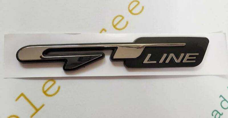

tooSavvy Posted December 18, 2023 Author Posted December 18, 2023 One in / One out..... I bought a GTline bootbadge, looks quite nice... I'm driving along, into Newcastle, and smell very hot brakes - then it goes away - then it comes back ๐ฏ >>> shopping @Tesco and I feel both front wheels = ๐ฅN/s. Shit, it's a sticky caliper (likely pin, rubber boot was split when I did pads so I sloshed plenty Coppaslip into it ๐คฆ) Rain all week so I'll see if my SpannaMan is free for the job.... ๐๐จ #Edit.... ๐ His Mother has just passed away ๐. So sad.... I'll be on my knees then, hope the rain isn't TOO brisk ๐งโโก... Matty and egg 2
tooSavvy Posted December 19, 2023 Author Posted December 19, 2023 Dry and quite warm..... TF ๐ Worryingly discovered 'not seized' ๐๐ ย ...... Could be a collapsed rubber Flexi ๐ฏ Matty and egg 2
tooSavvy Posted December 19, 2023 Author Posted December 19, 2023 Well.... 67miles out today = brakes as cold as clay ๐ค Whatevva ๐ ๐๐จ egg and Matty 2
tooSavvy Posted December 22, 2023 Author Posted December 22, 2023 See... ย ๐๐จ AnnoyingPentium, egg, Matty and 1 other 4
Pat Earrings Posted December 24, 2023 Posted December 24, 2023 On 22/12/2023 at 12:52, tooSavvy said: See... ย ๐๐จ Isnโt GT line a KIA trim level? The badge looks far too new for the car as well, just doesnโt sit right with the others.ย tooSavvy 1
tooSavvy Posted December 24, 2023 Author Posted December 24, 2023 14 minutes ago, Pat Earrings said: Isnโt GT line a KIA trim level? The badge looks far too new for the car as well, just doesnโt sit right with the others.ย Undoubtedly the case..... I feel consoled not to have 'hit up the Bay' for a Clio '16V', though ๐คฃ๐คฃ ..... 2024 'New Years resolution' to acquire a trilby, for the back shelf. ๐๐จ AnnoyingPentium, privatewire and Pat Earrings 3

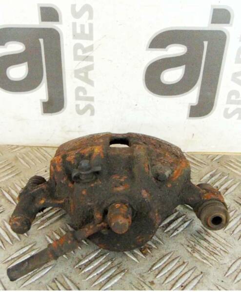

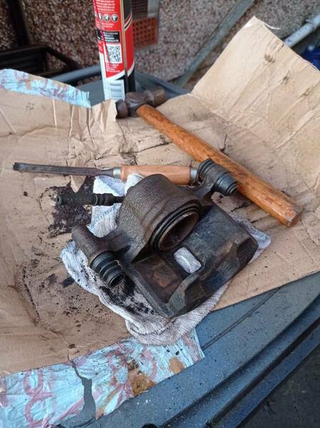

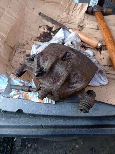

tooSavvy Posted December 31, 2023 Author Posted December 31, 2023 Gahh ๐คฌ... StinkWheel [AgAiN] *clue = heavy braking/avoiding bellend >>> 10 miles later toasty stink >>> stop & smack the caliper (open spokes FTW ๐) with steel bar ... Sorted โฅ๏ธ We have a 'sticky piston'..... Bought this boat anchor @fleebay and will swap ๐ ๏ธโ #fuckkin cars# ๐๐จ ย egg 1

tooSavvy Posted January 2, 2024 Author Posted January 2, 2024 Spunked ยฃ1.50 @HomeBargains for a set.... My 'boat anchor' caliper is now dispatched >> will require a 'buff up' before whacking on ๐ ๏ธ๐ ย privatewire and egg 2
tooSavvy Posted January 4, 2024 Author Posted January 4, 2024 Oof! ๐ฏ ย Postie looked relieved when he handed me this.... ๐คฃ๐คฃ ๐๐จ egg and privatewire 2
tooSavvy Posted January 4, 2024 Author Posted January 4, 2024 All sorted.... Nothing seized, all rubber nice and flexi/slapped on rubber grease.... Brake fluid emerging from severed pipe/bleed drilling, so piston is free when I press it ๐. Bleed nipple out/back in.... Will drop it off @oily spanner and see if he has a slot free ๐ ๏ธ. ๐๐จ .... looks like it has been in the sea... egg, loserone and privatewire 2 1
tooSavvy Posted January 5, 2024 Author Posted January 5, 2024 Not getting much joy with the garage (shut/hols). Think I'll D.I.Y. with a 'slit-in-rubber hose' brake bleeder (I have some silicone vac pipe lying around, just the job!). Shouldn't take more than a *half hour..... ๐ *possible rain/back lane ๐ Ah well... ๐ ๏ธ๐ egg and privatewire 2
