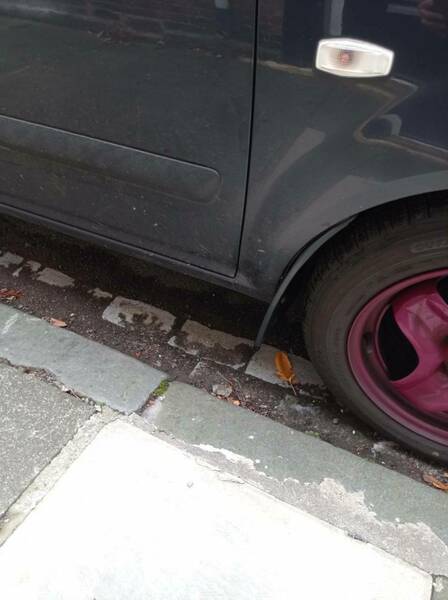

tooSavvy Posted October 2, 2023 Author Posted October 2, 2023 Quick glimpse of sun..... ToolsOot 🛠️ Those neat mudflaps are now on, and new blades/Matt paint to smarten up arms 😎 The tyres fitted on these Corsa rims are proud about an inch, at the wing edge/sill. Quite manageable but obviously lashing $hite up the wing/door shut area 😕 ... Sorted! 🥳 AnnoyingPentium, privatewire and RayMK 3

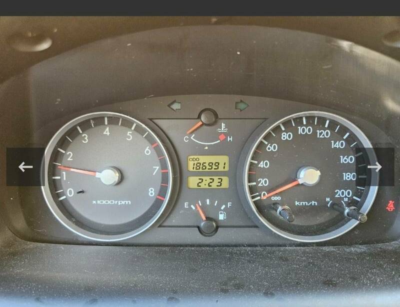

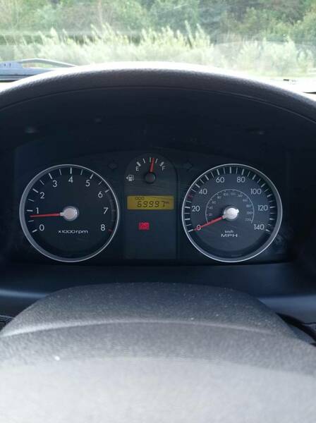

tooSavvy Posted October 3, 2023 Author Posted October 3, 2023 😳 ..... these numbers just 'creep up' on you 😯
tooSavvy Posted October 3, 2023 Author Posted October 3, 2023 At 71,000 we will be doing the oil n filter.... ..... that's including postage! Less than, with petrol, driving to our local ECP 🚙💨 egg and AnnoyingPentium 2

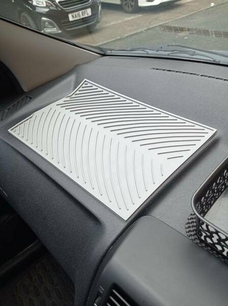

tooSavvy Posted October 6, 2023 Author Posted October 6, 2023 SWMBO lashes her handbag onto the dash... the metal studs sound like dragging an empty oil drum 🙉🤦 Bought a silicone sink drainer mat 👌 ..... if the light grey becomes noticeable, as a screen reflection, I'll crayon it over with black felt marker 🖍️ egg and privatewire 2

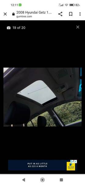

tooSavvy Posted October 6, 2023 Author Posted October 6, 2023 Top is an early Getz... Lower, mine.... Ba$tard 'bean counters' 🤬 egg and privatewire 2

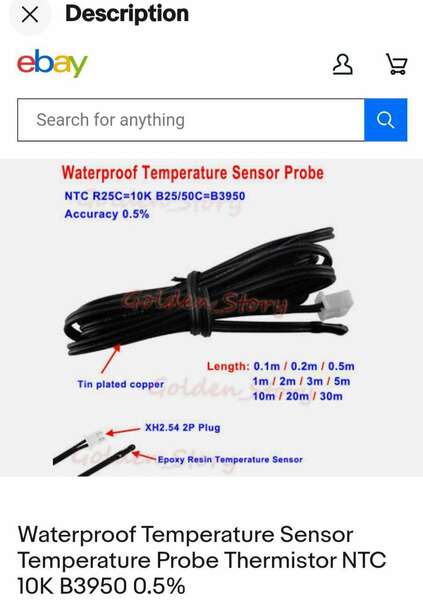

tooSavvy Posted October 14, 2023 Author Posted October 14, 2023 On 08/09/2023 at 10:11, tooSavvy said: So ... Results *partially, are in 😐 18.2 cold water tap running 24.2 ambient (see thermo display) 48.0 hot full cup, direct from kettle boil 85.0 immersed in hot, direct from kettle boil The area I'm most concerned about is the ability of the sensor to 'sense/register' a high temp (water) through a vessel wall (cup) 😕 I don't know how to discover the 'sensor spec' but they can be got as a 'washer tab' style - to bolt flat faced onto the 'hot' part... I may just buy one and run an identical set of tests 😉 *Power courtesy of SKY 12V router supply. ...... This, for instance, has the sensor in a splodge of resin (not a metal tube!) Further to the arrival of my 'resin tip' sensor... Tests are looking good.... 👍 A quick dip in water poured directly from a boiling kettle, into the test vessel [ally milk pan].... Display = 99° When the tip is taped to the bottom of the ally milk pan & kettle boiling water added = 89° ..... Hmm 🙄 I believe there is no problem with any of this BUT the tip will only accurately display engine/water temp if it is IMMERSED... Next best test (on the car) will be with a copper jacket over the sensor + computer chip grease. privatewire and egg 2

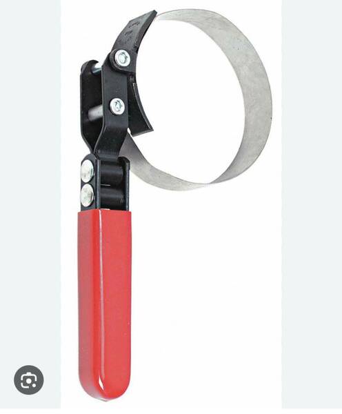

tooSavvy Posted October 18, 2023 Author Posted October 18, 2023 Just back from garage..... This got it straight off.... I looked such a 'girls blouse' 🤦 ..... Buying one of these !!! 🚙💨 privatewire, 500tops and egg 3

beko1987 Posted October 19, 2023 Posted October 19, 2023 Just make sure the new filter is done up by hand and youll need no tools. I felt very smug loosening my filter by hand before going under and getting oily hands when dropping the oil. It's the future! My chain strap almost struggled on a friend's Vauxhall though, if we do it again next year it should be easier! privatewire and tooSavvy 1 1
tooSavvy Posted October 21, 2023 Author Posted October 21, 2023 My 'filter wrench' plopped thru the letterbox yesterday... And I just received confirmation the TWO Peugeot roof bars are coming up by courier.... WooT..WooT 🥳 500tops and privatewire 2
