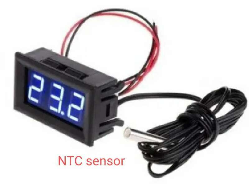

tooSavvy Posted September 8, 2023 Author Posted September 8, 2023 On 9/4/2023 at 1:23 PM, tooSavvy said: I only get an 'idiot light' for engine temps 😕😳 This kit (@£4) with the 'external' sensor lashed against the heater hose [hottest outlet one] will give me a rough >> direction of travel >> for the engine/water temps. This guy agrees to 'approximation' but, essentially, some number [..trends] is better than none 👍 https://youtu.be/tHNARNPFu8A?si=7kUJe3LdG6bFN8aP 🚙💨 So ... Results *partially, are in 😐 18.2 cold water tap running 24.2 ambient (see thermo display) 48.0 hot full cup, direct from kettle boil 85.0 immersed in hot, direct from kettle boil The area I'm most concerned about is the ability of the sensor to 'sense/register' a high temp (water) through a vessel wall (cup) 😕 I don't know how to discover the 'sensor spec' but they can be got as a 'washer tab' style - to bolt flat faced onto the 'hot' part... I may just buy one and run an identical set of tests 😉 *Power courtesy of SKY 12V router supply. ...... This, for instance, has the sensor in a splodge of resin (not a metal tube!) egg 1

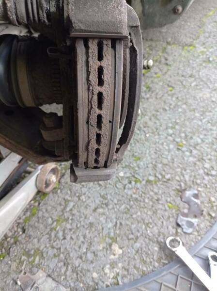

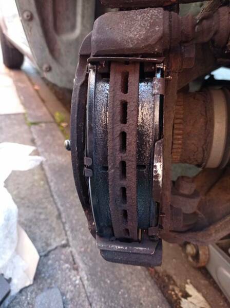

tooSavvy Posted September 25, 2023 Author Posted September 25, 2023 Pads done. Hell of a job forcing (gently... 😮) the pistons back in. Used my 17mm ring, edged against my hammer head, to make a lever 👍 I checked the fluid reservoir, as the pistons went back, and it came up to the rim 😳. A jury rig of silicone pipe/scent bottle got me able to 'suck it out' (oooh,err)😎 🚙💨 egg, privatewire and ProgRocker 3

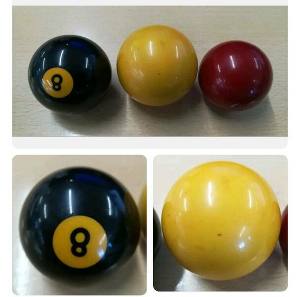

tooSavvy Posted September 25, 2023 Author Posted September 25, 2023 Pool balls arrived.... 3 different sizes 😳 Big = yellow Medium = eight ball Small = red privatewire and egg 2
