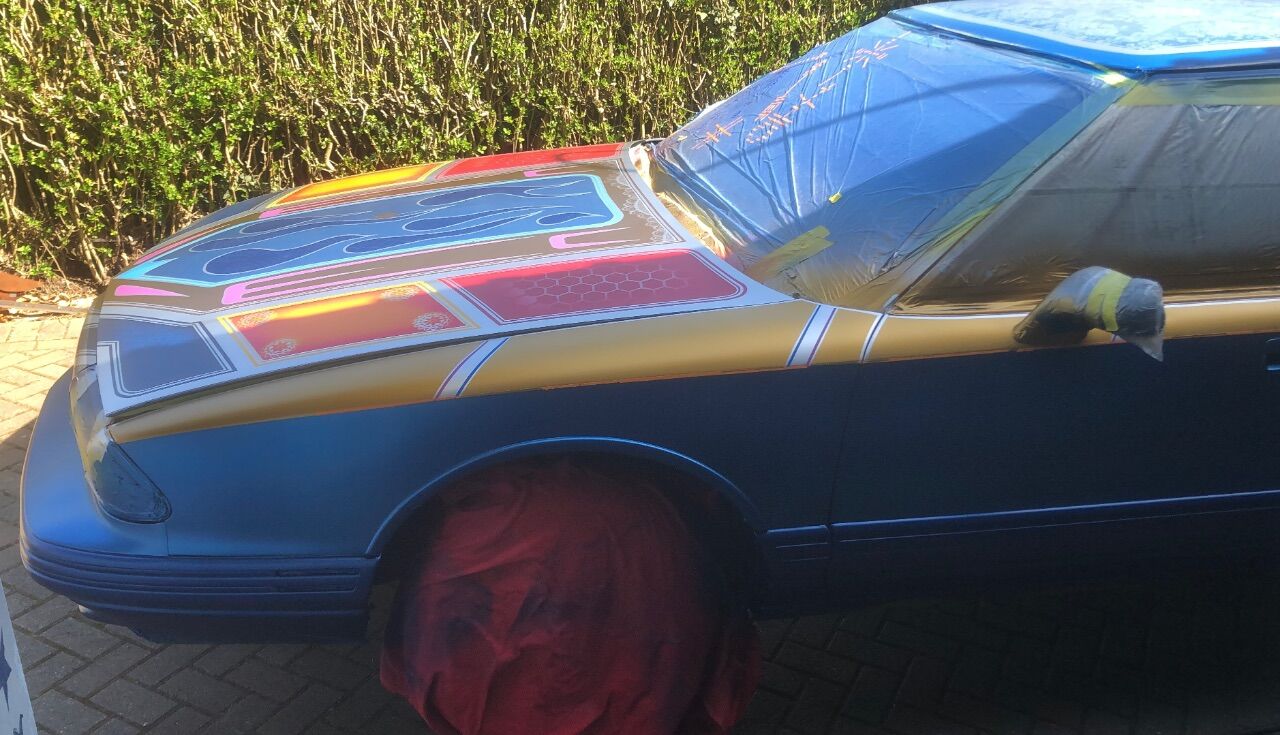

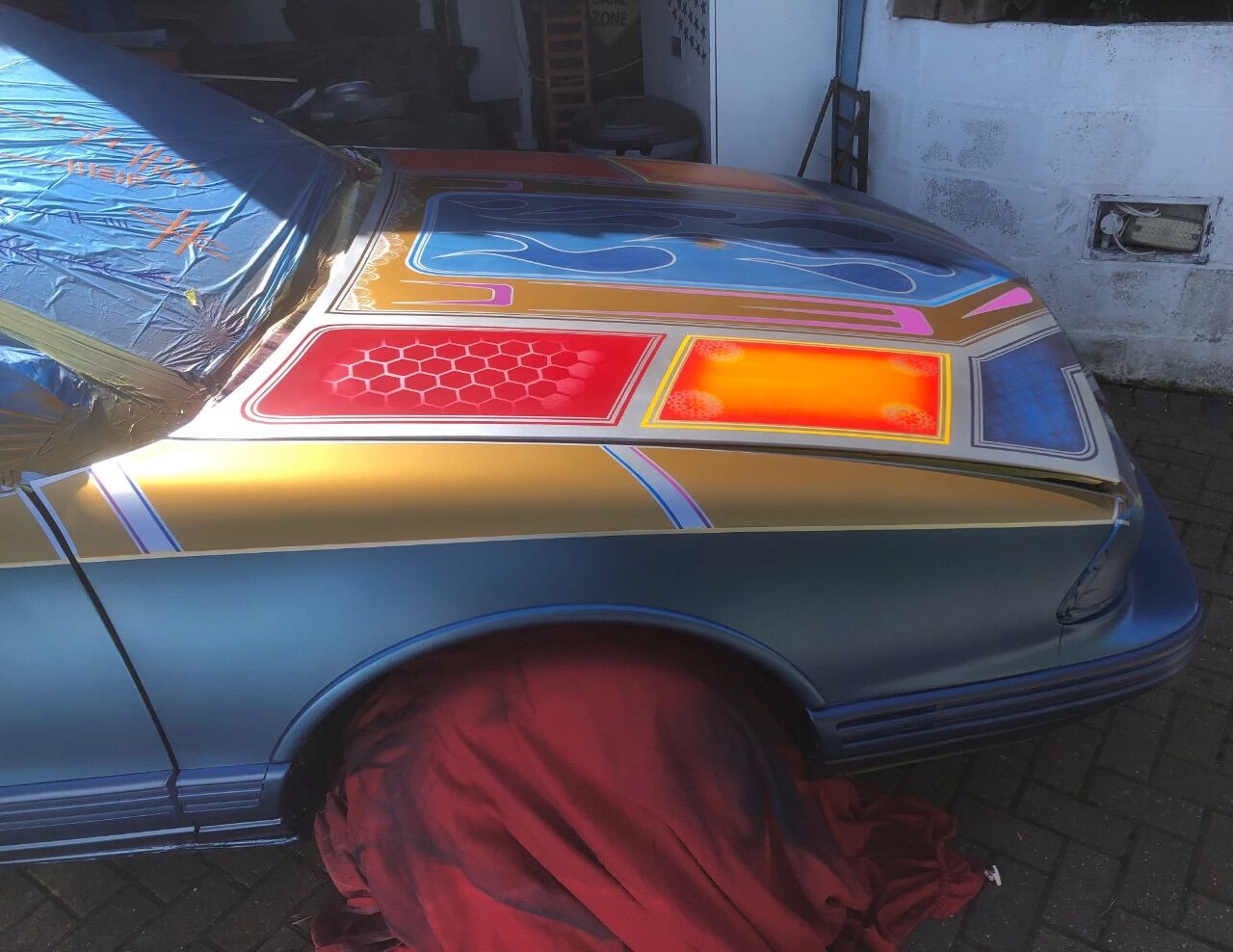

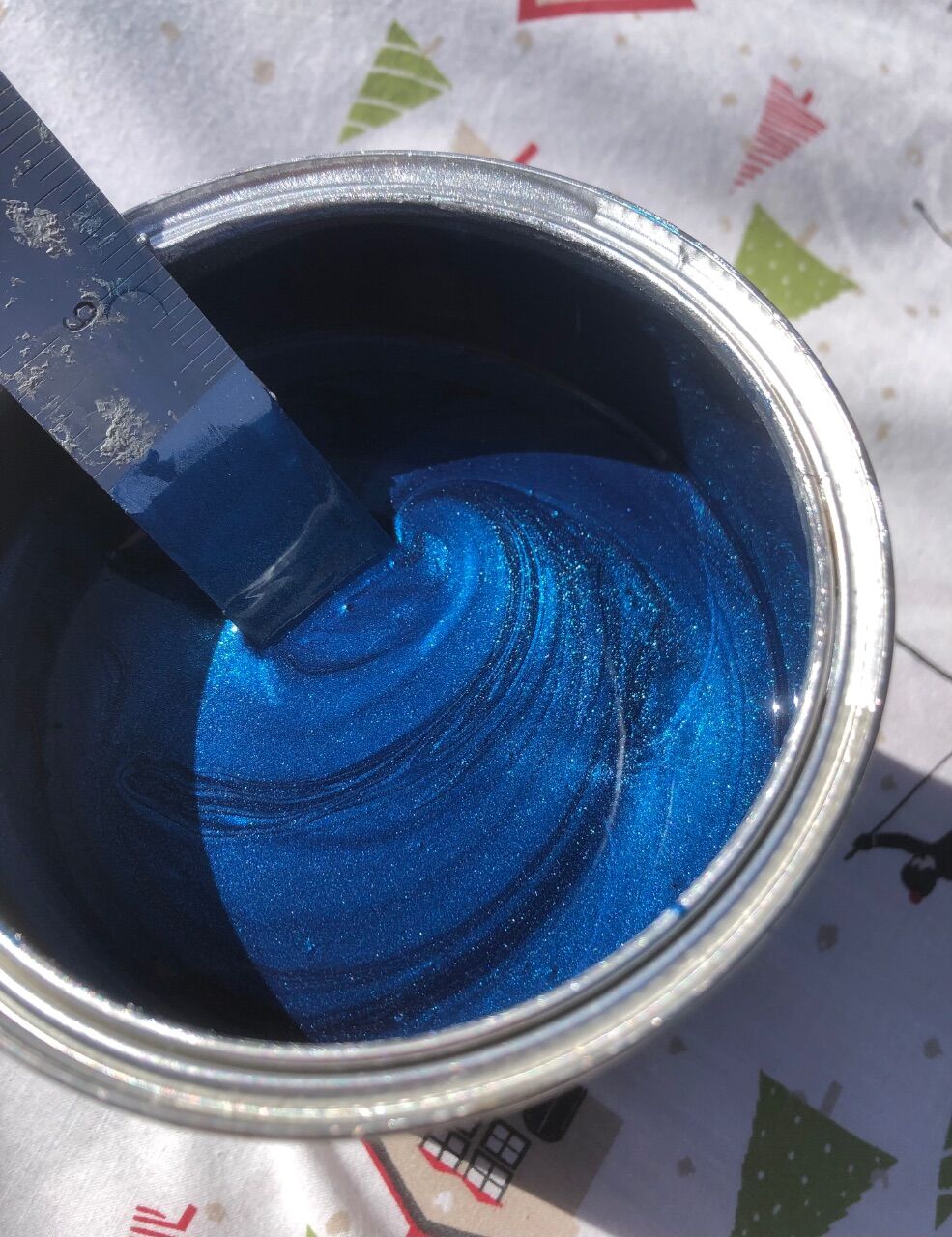

So I took a chance after masking the midsection.
I created a mixed blue, lighter than the original blue, but not as light as I had wanted it to be. But I had used all the sparkling silver I had.

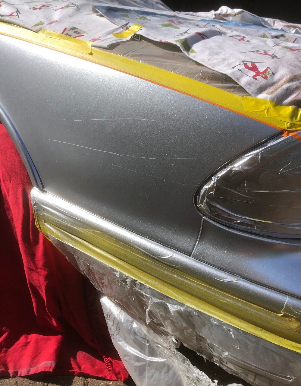

Also needed to cover some scratches on the fender that were my fault.
Outcome…….
AWESOME.

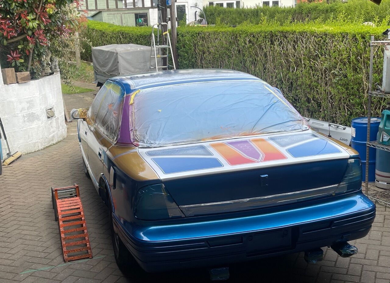

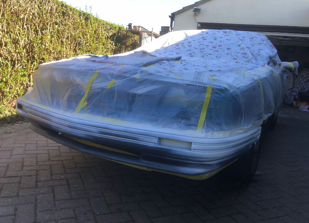

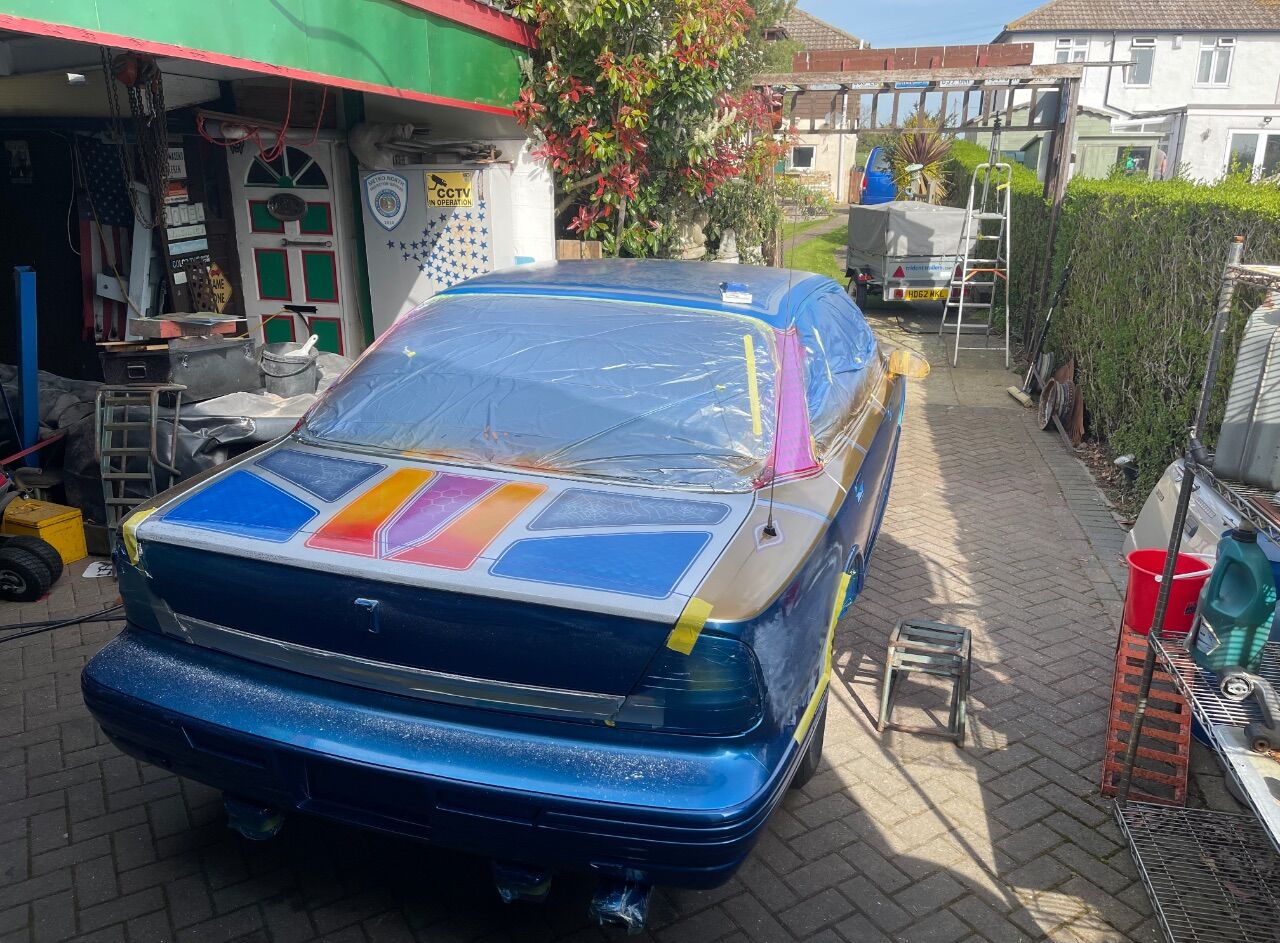

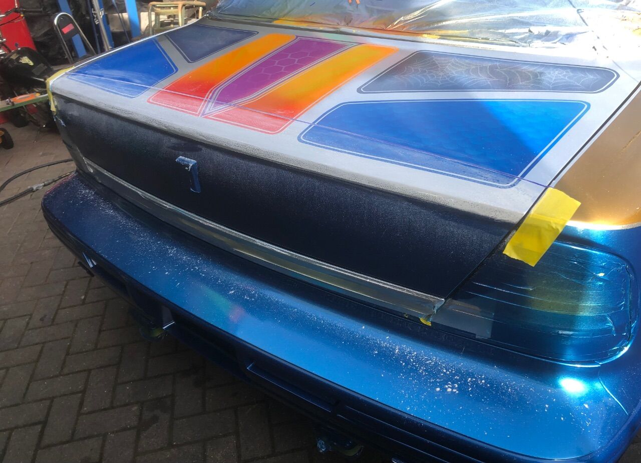

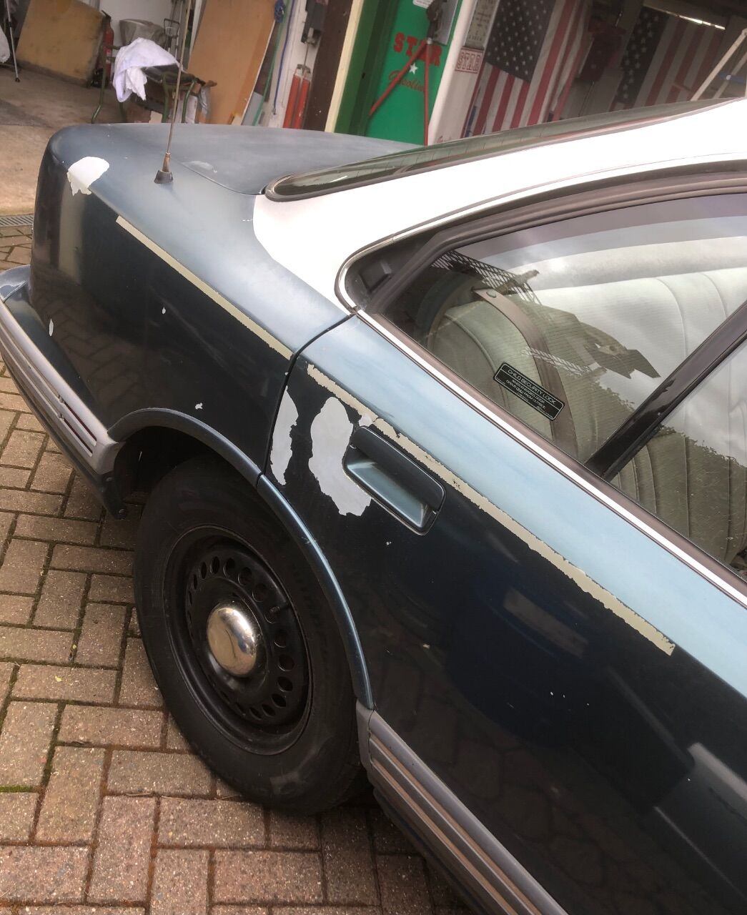

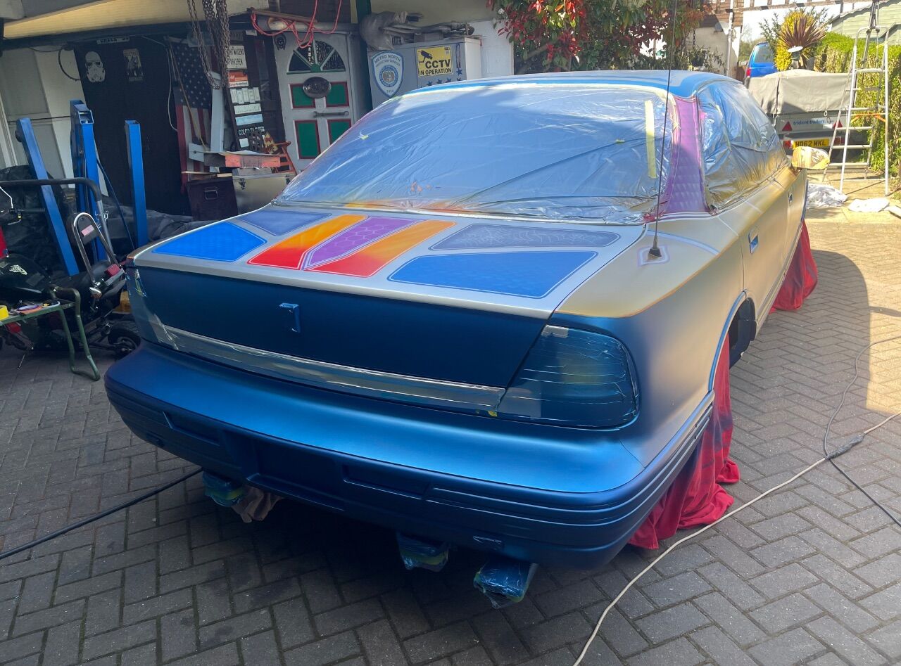

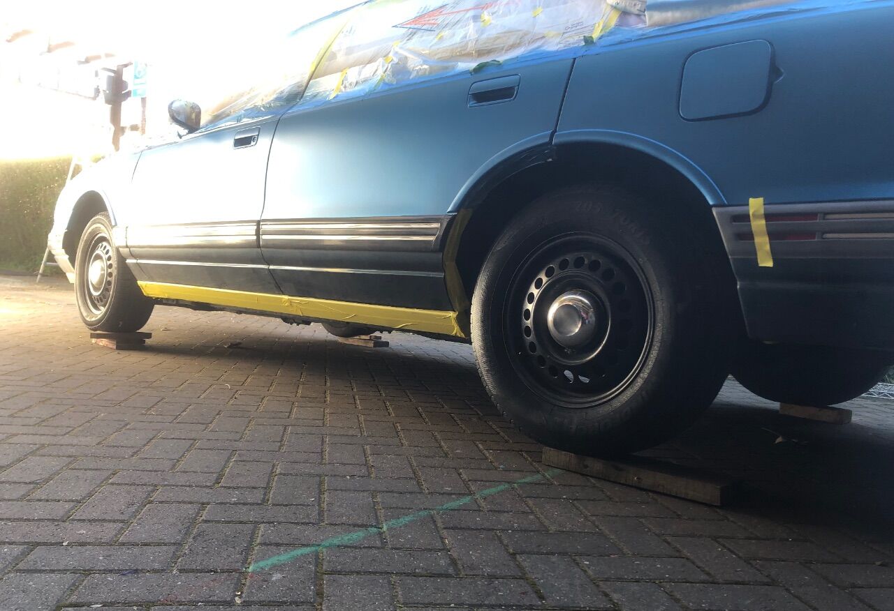

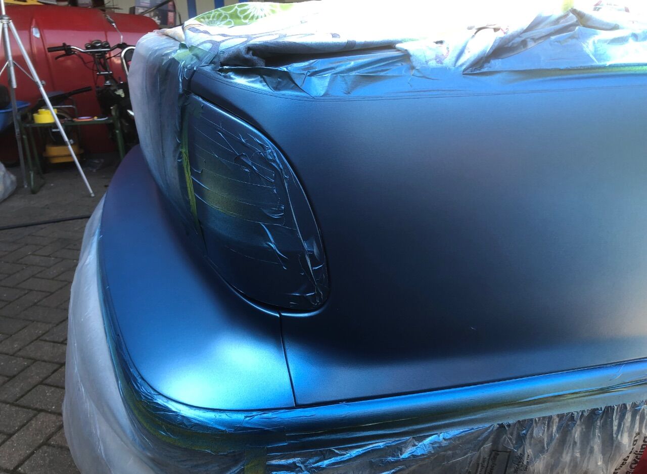

Once the midriff blue was dried and unmasked, the next job was another cautious one.

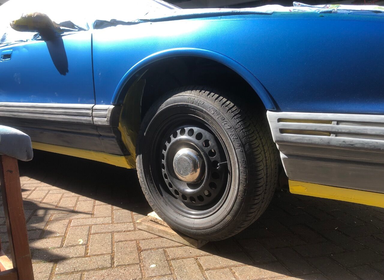

Preparing the lower section for that beautiful dark blue. Hopefully it will pull the car towards the ground visually.
So I used the 240 grit and went all the way around.

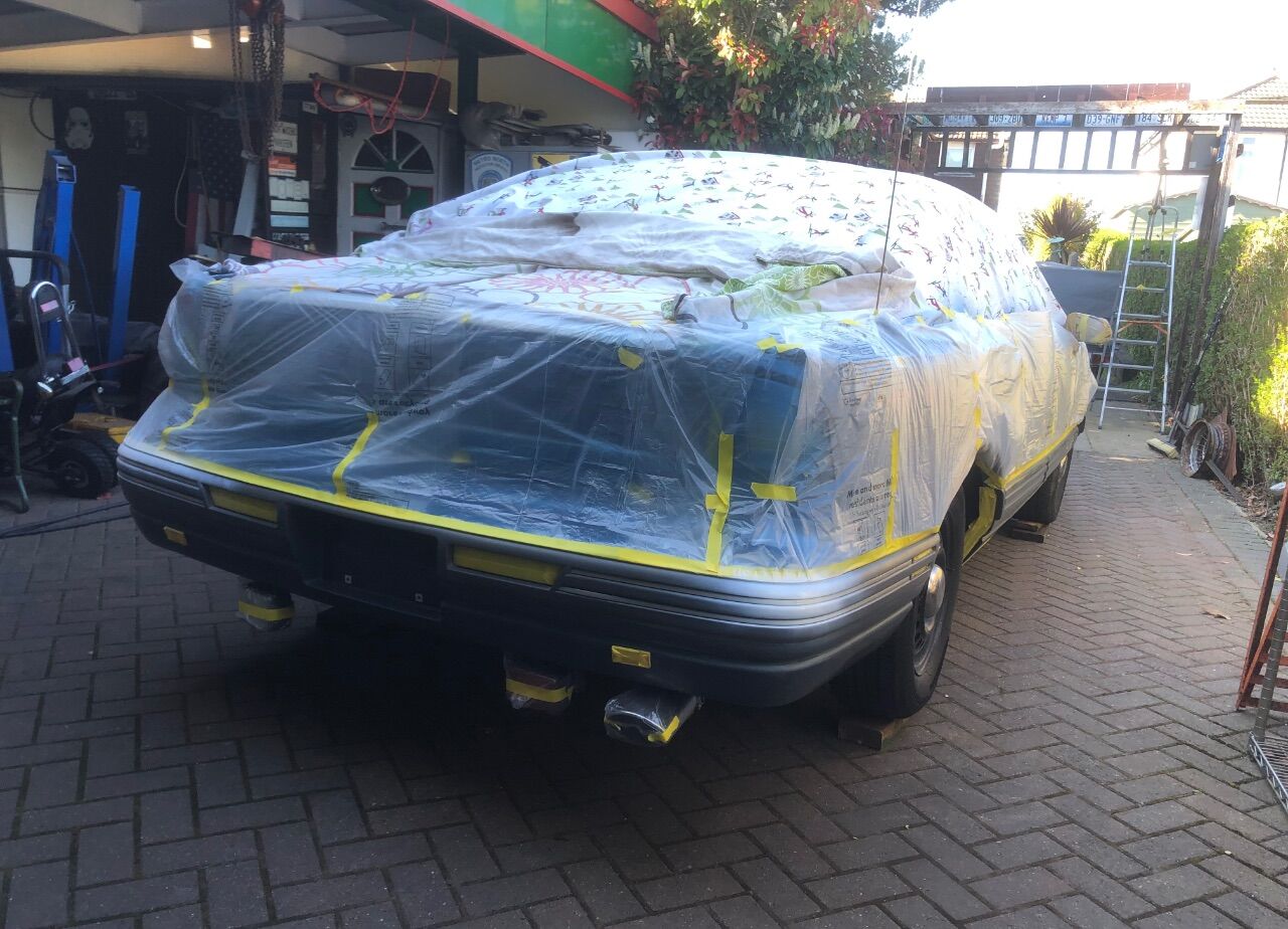

Followed by a good blow off and wipe down.

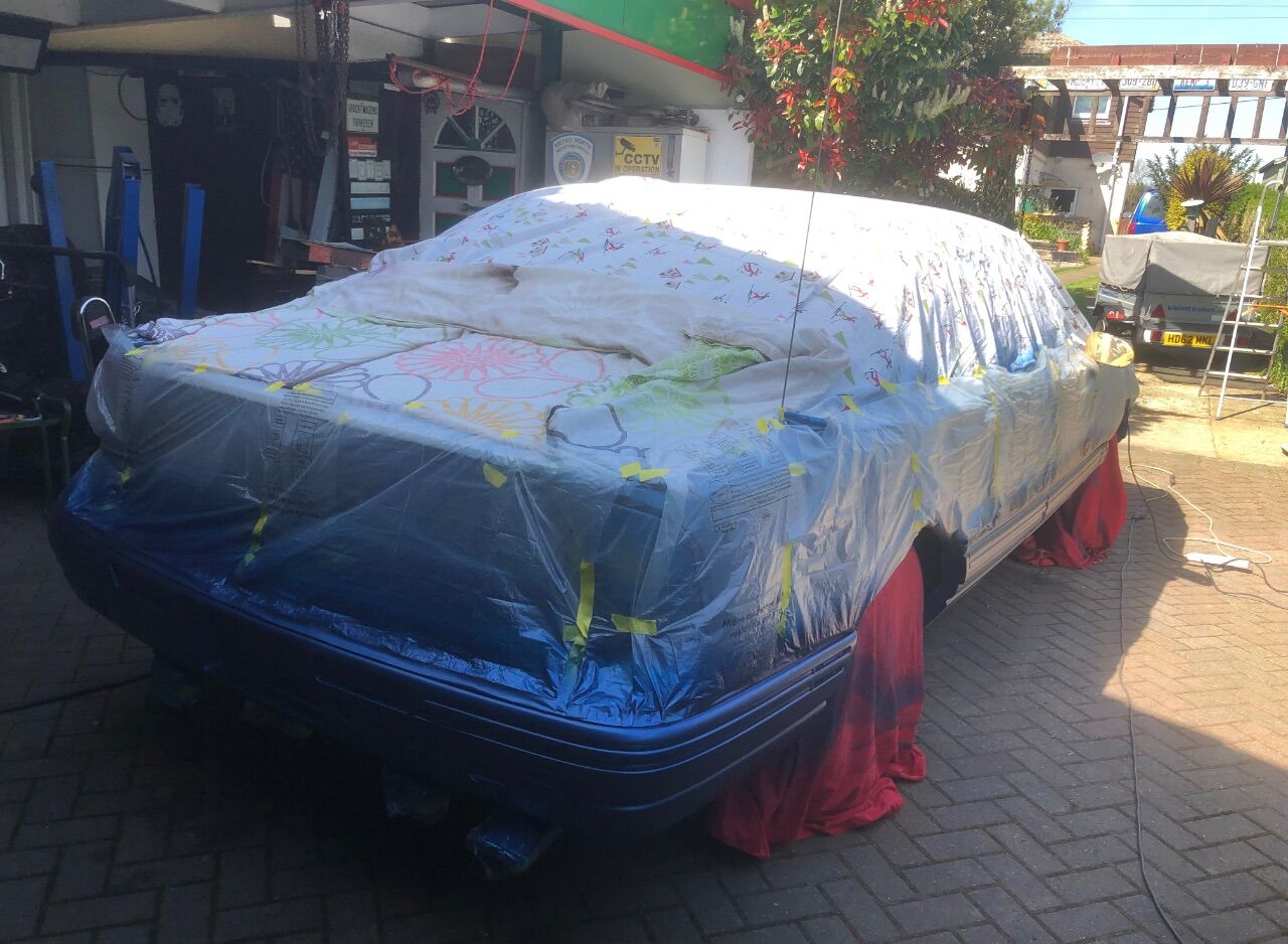

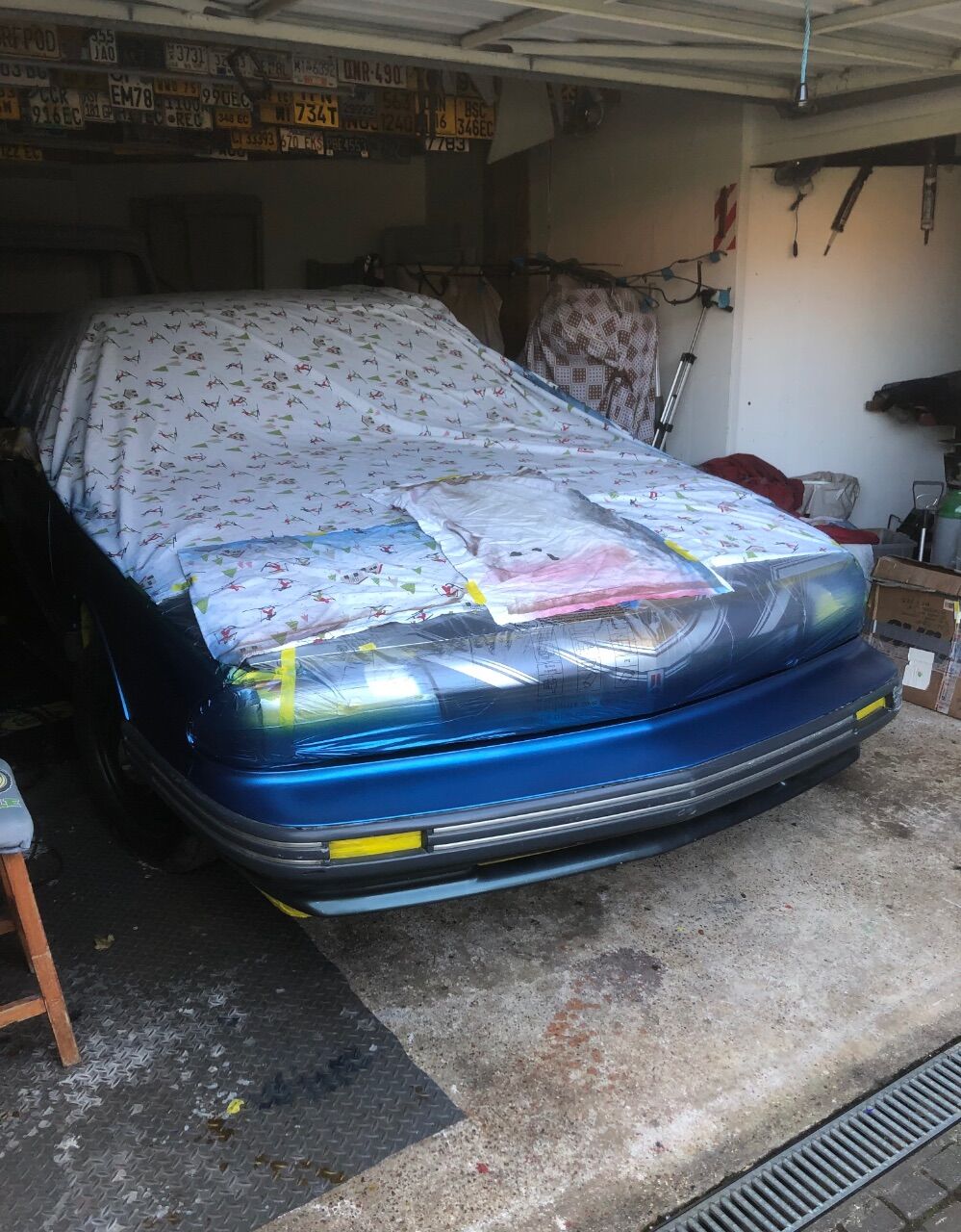

Then a load more masking, including the sills and inside the wheel arches.

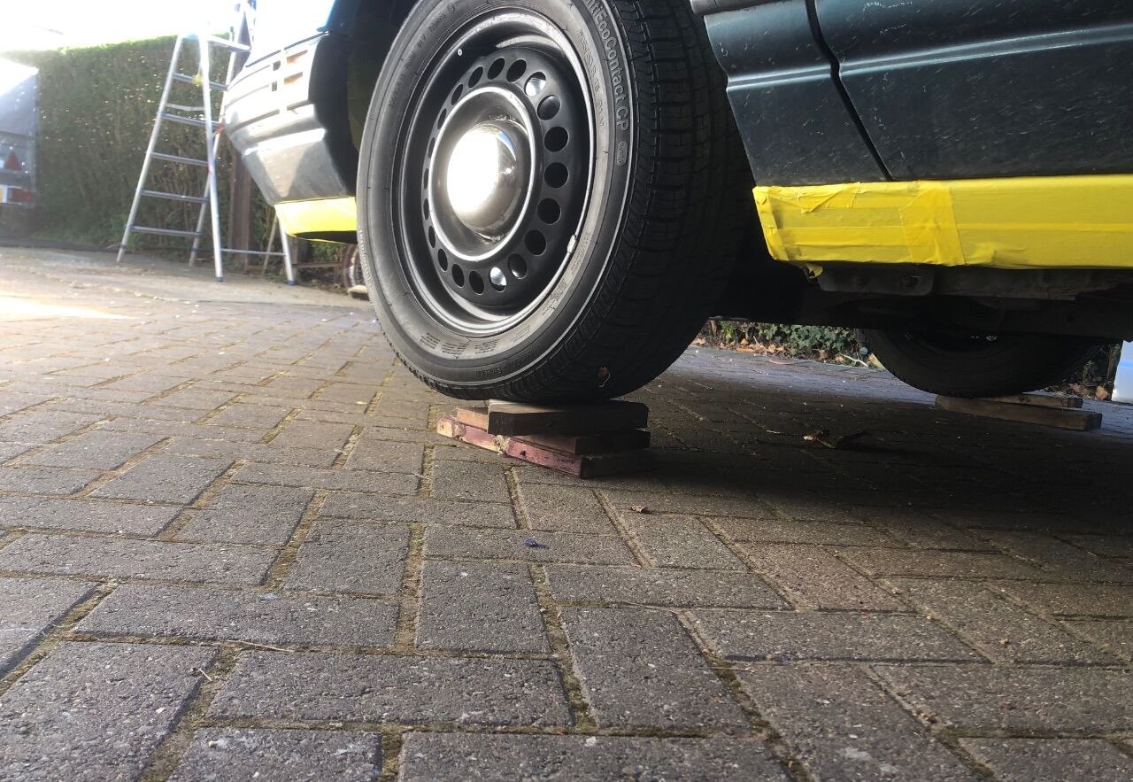

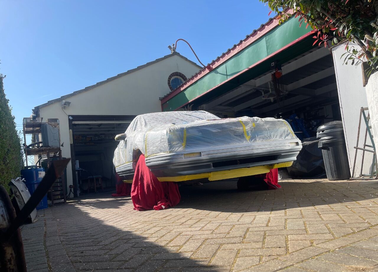

I also put the car on too of little piles of wood so that I could get the dark blue paint right under the bumpers and sills.
Really made a big difference in being able to get the paint on all the surfaces.

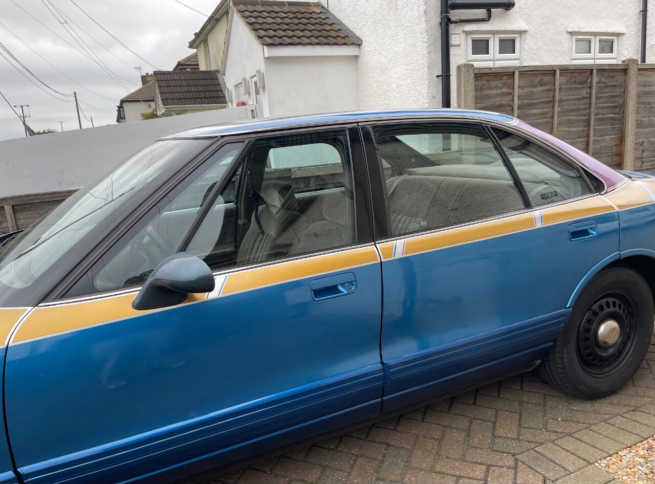

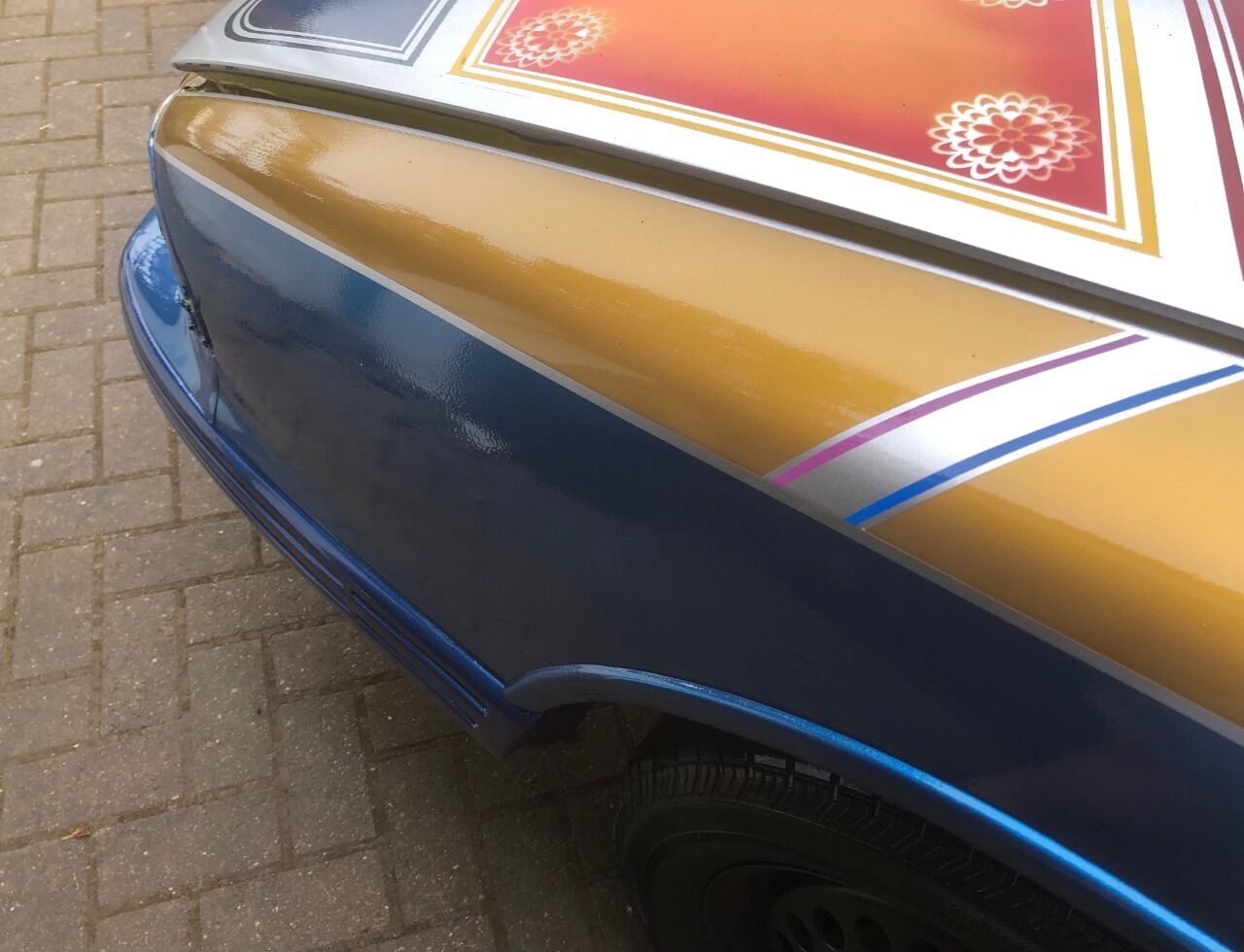

Lower part of the car painted late in the day.
Unfortunately as you can see, with the curvature of the body and multiple angles on the rubbing strips and angle at which the bumpers are folding under the car, they all conspire to make it hard to see how beautiful it is.
The idea with a dark colour low down is that it visually draws the car lower down towards the ground.

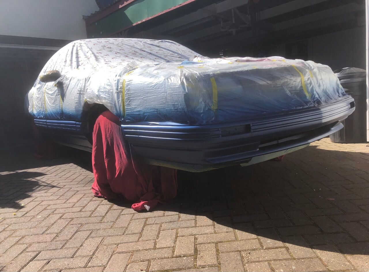

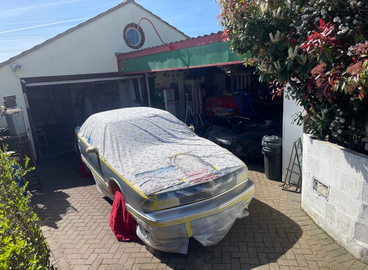

Next job was prayer for good weather once I had removed all of the final J-Tape, and pinstripes that were hiding various colours below them.
This was followed by some real hands on touch inspection and cleaning off any dust, paint flakes and denibbing edges.
Then I wiped/“washed” down all of the car surfaces with panel wipe. (This was going to bite me hard in the butt)

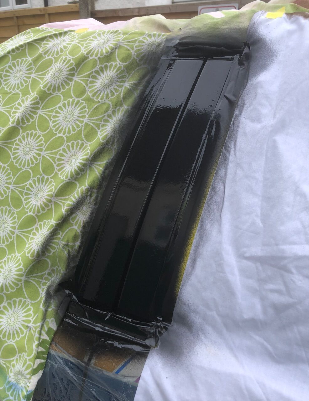

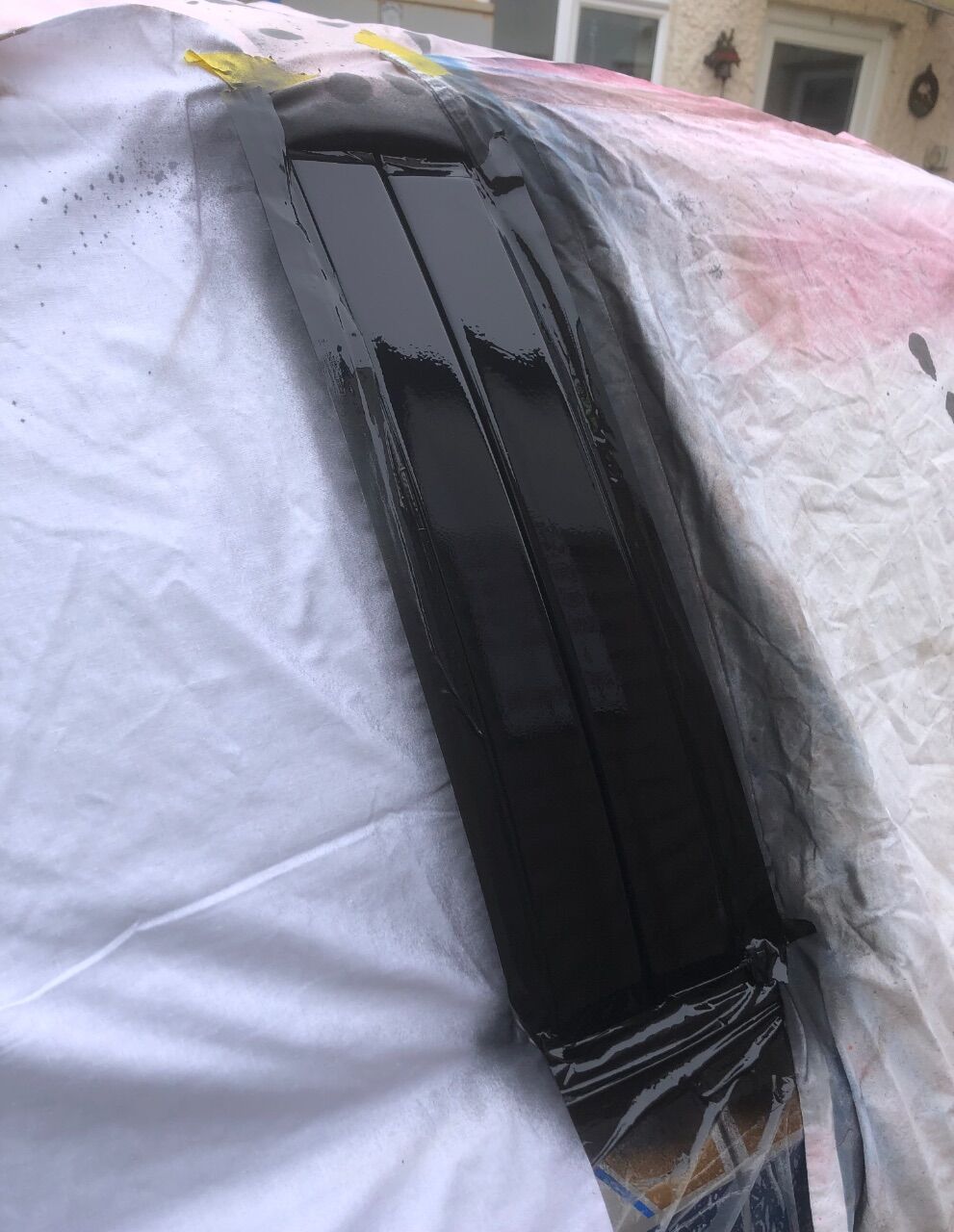

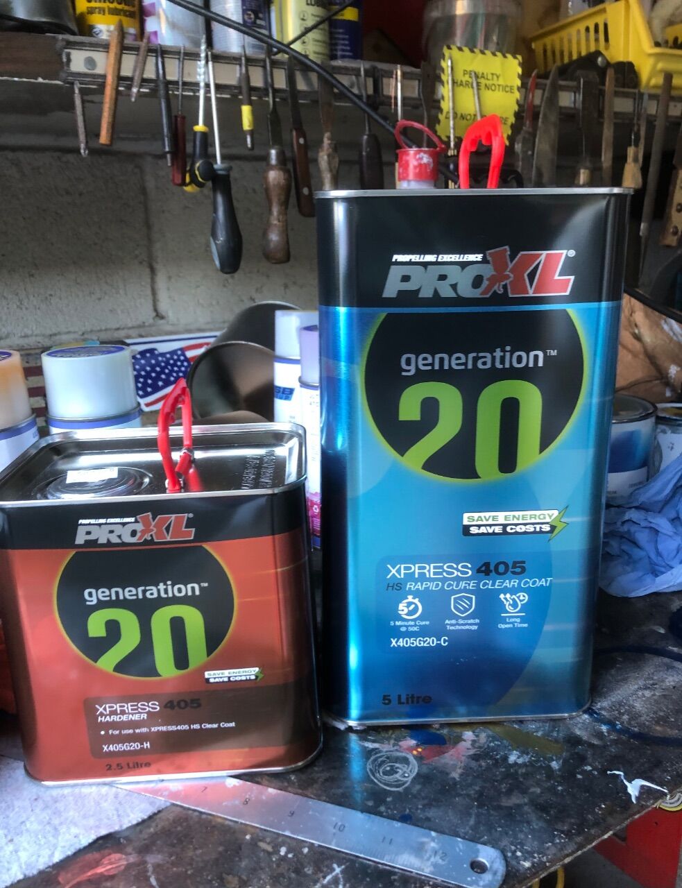

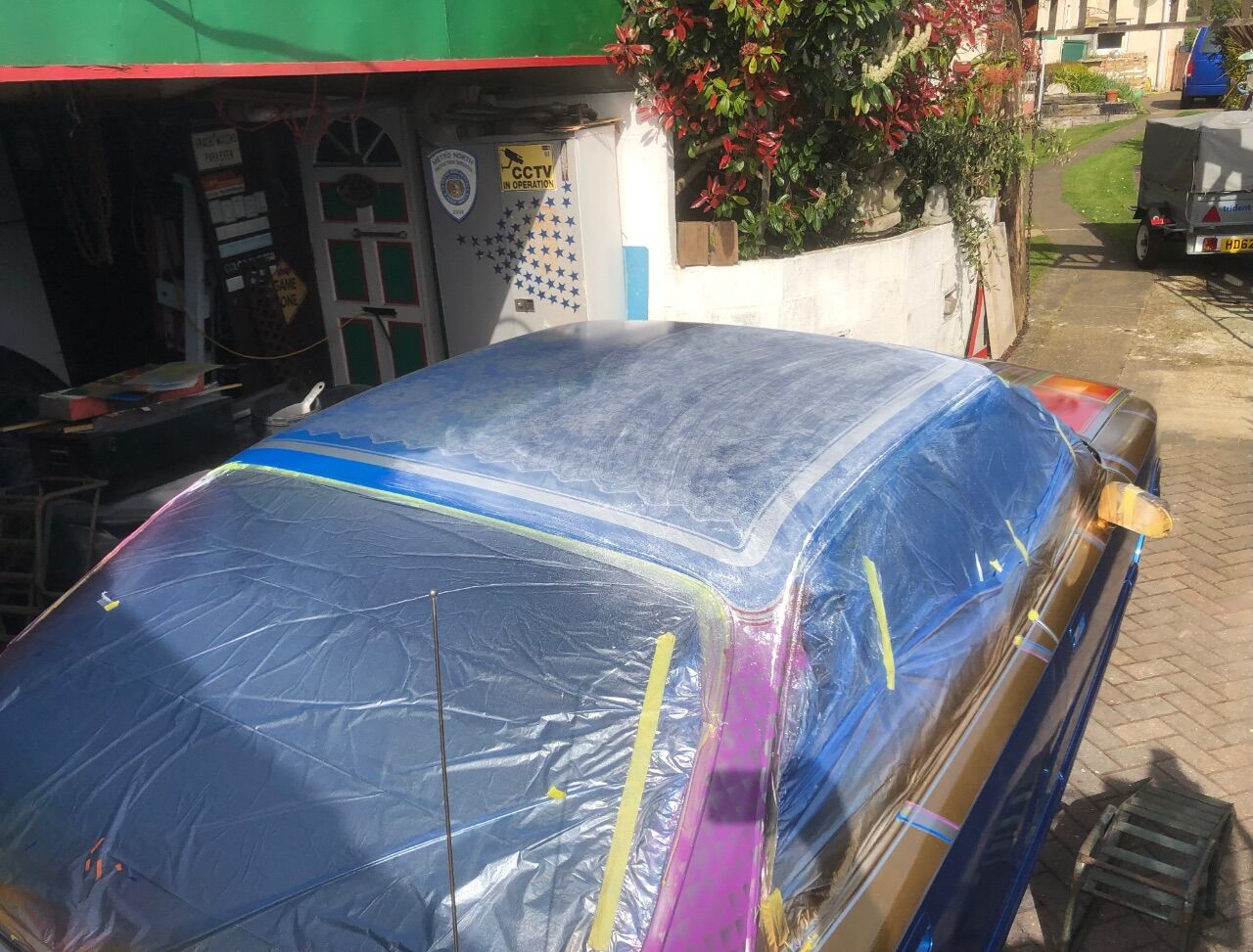

The job at hand was clear lacquer.
OBJECTIVE: 6 coats of clear over the whole car.

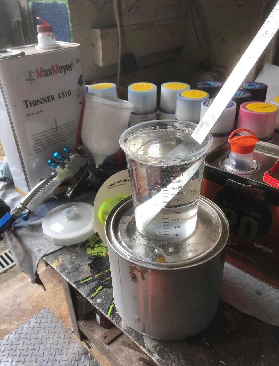

So I got mixing.
Two parts lacquer and one part hardener.
600ml mixes at a time.
First was a dust coat to create a a surface for the first wet coat to adhere to.
I probably gave it 10 minutes to flash off before starting at the start again with the first full coat.
Flash off and a bit of time.

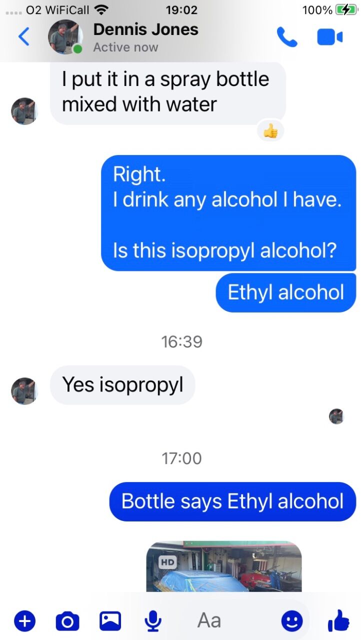

Second coat, and then I saw the problem.

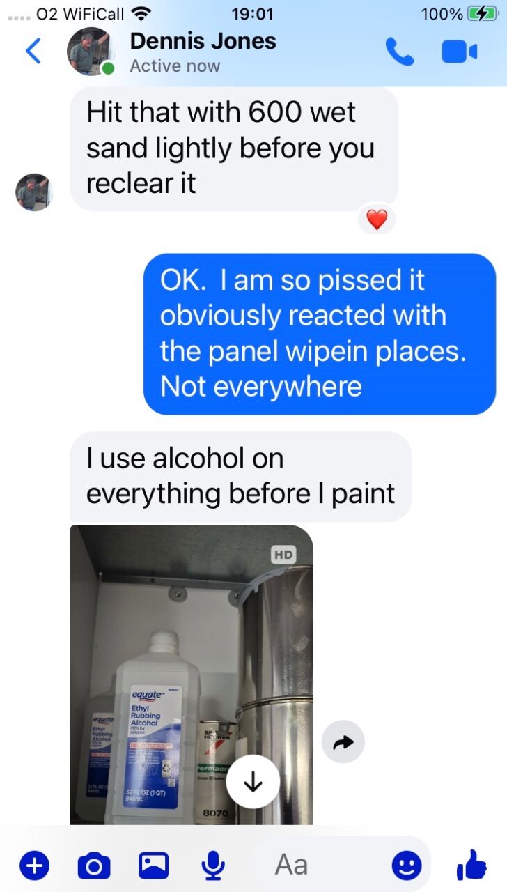

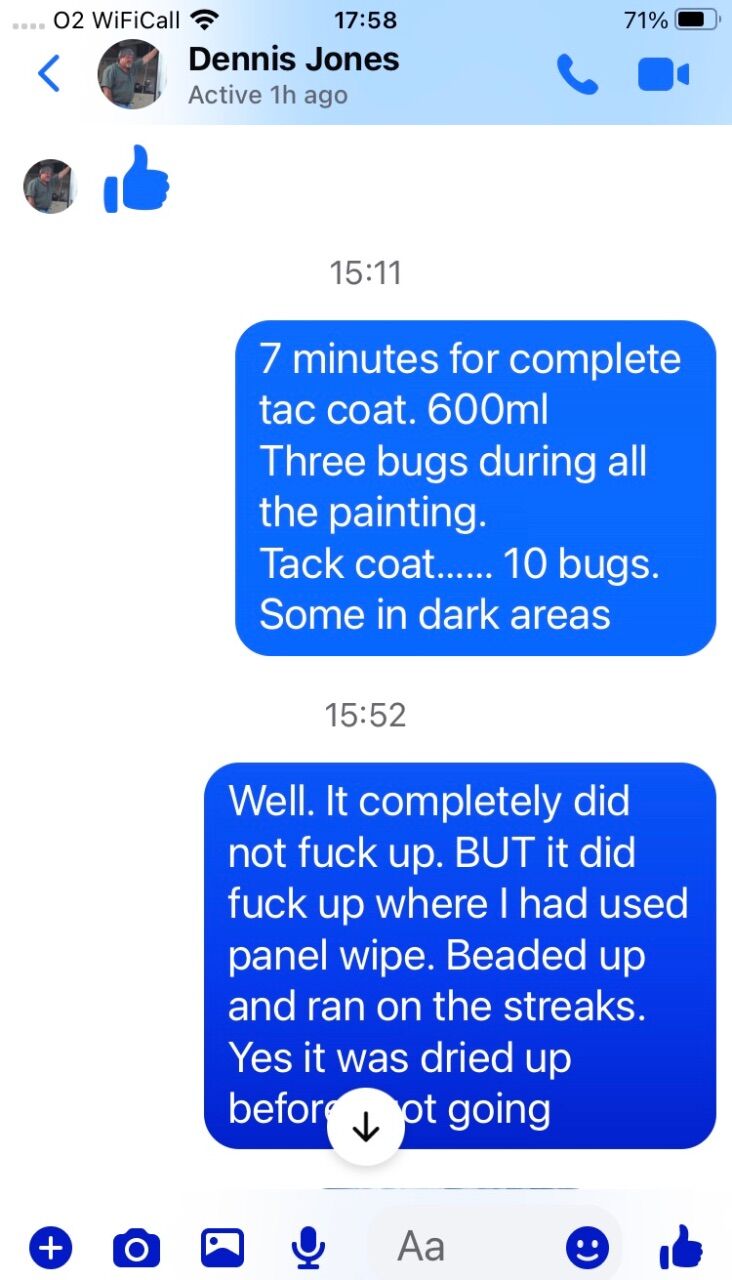

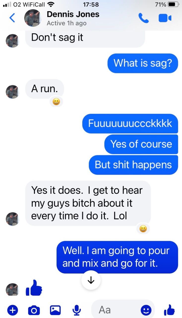

Dennis had warned me not to let it “sag” of course I had no idea what it meant.
So I asked him and he replied “don’t let it run”
Take a look at our conversation below in the next post.
Two steps forward and three steps backward.
It just takes time to get screw ups fixed.
But it is progress.
Bored yet??

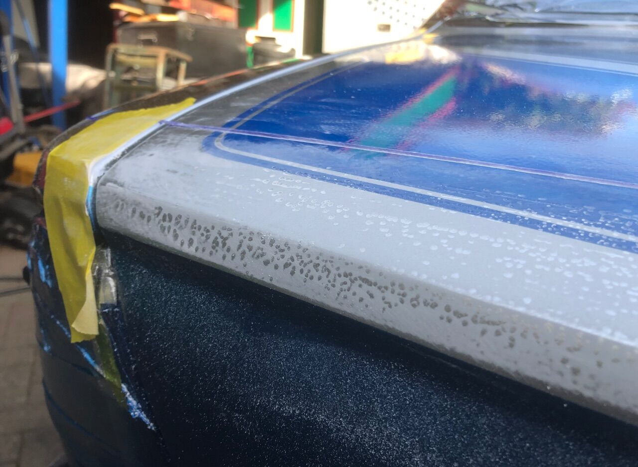

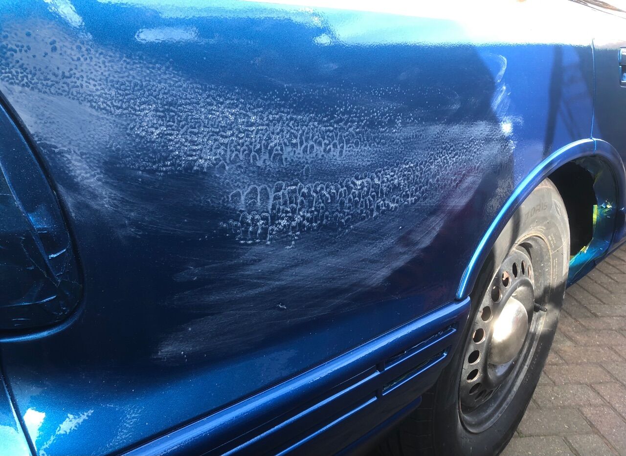

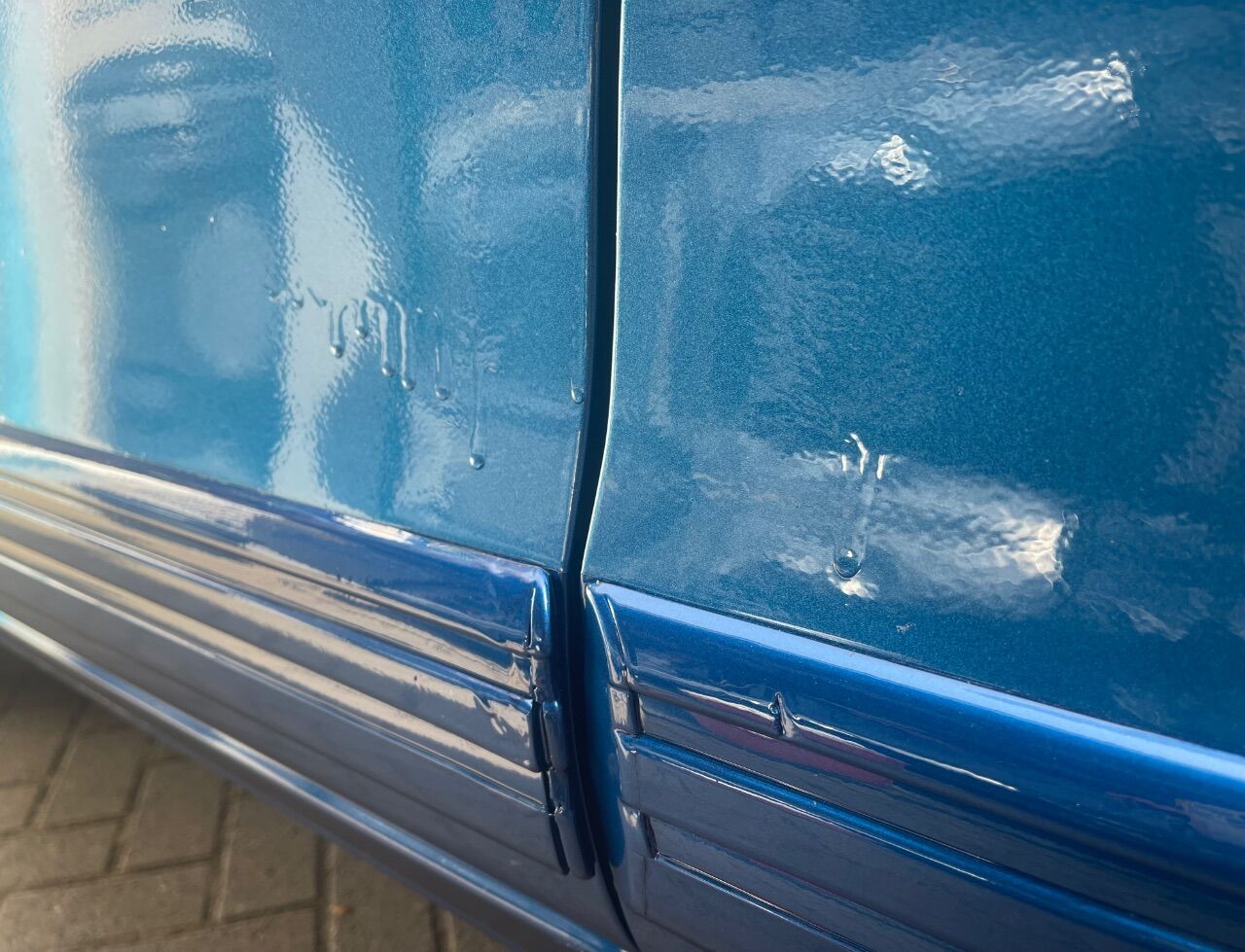

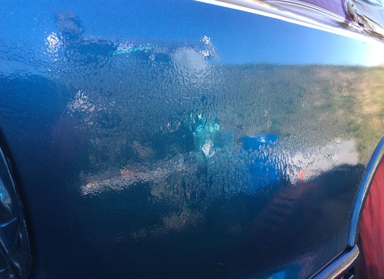

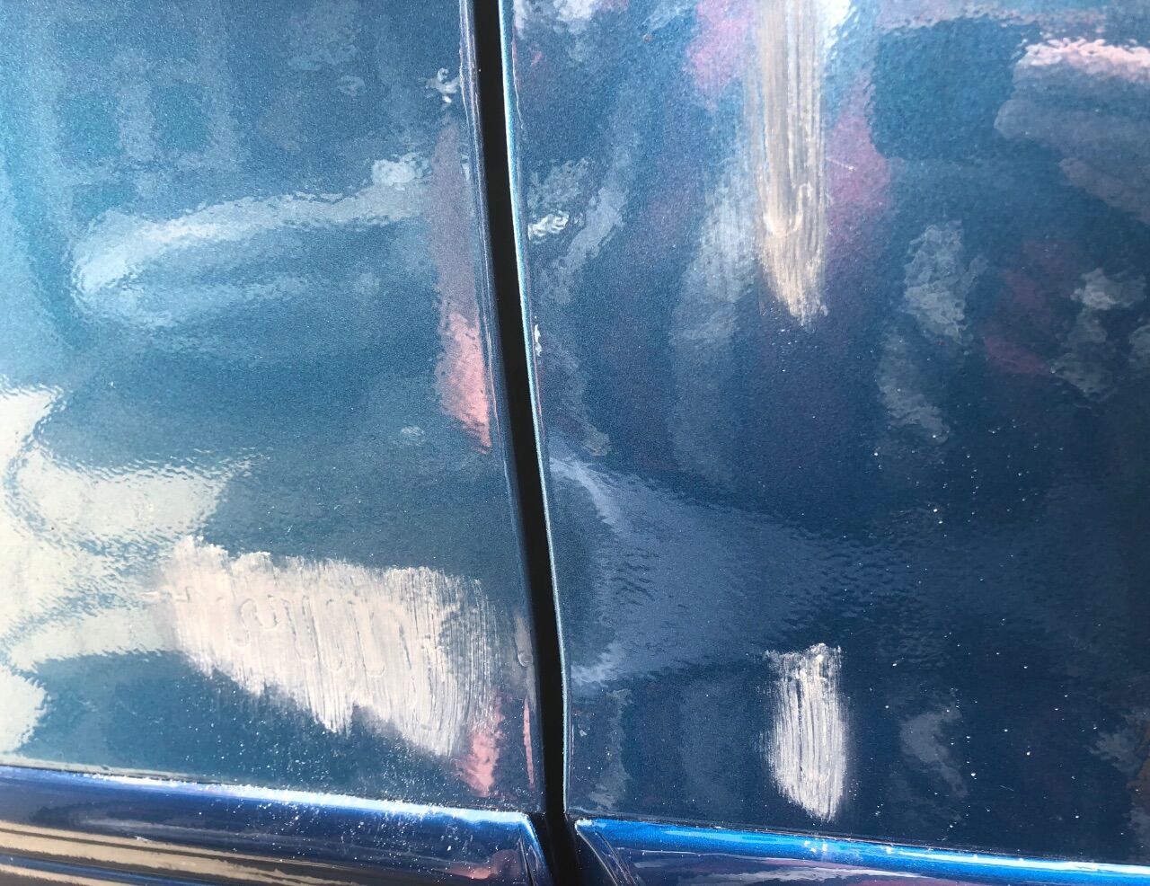

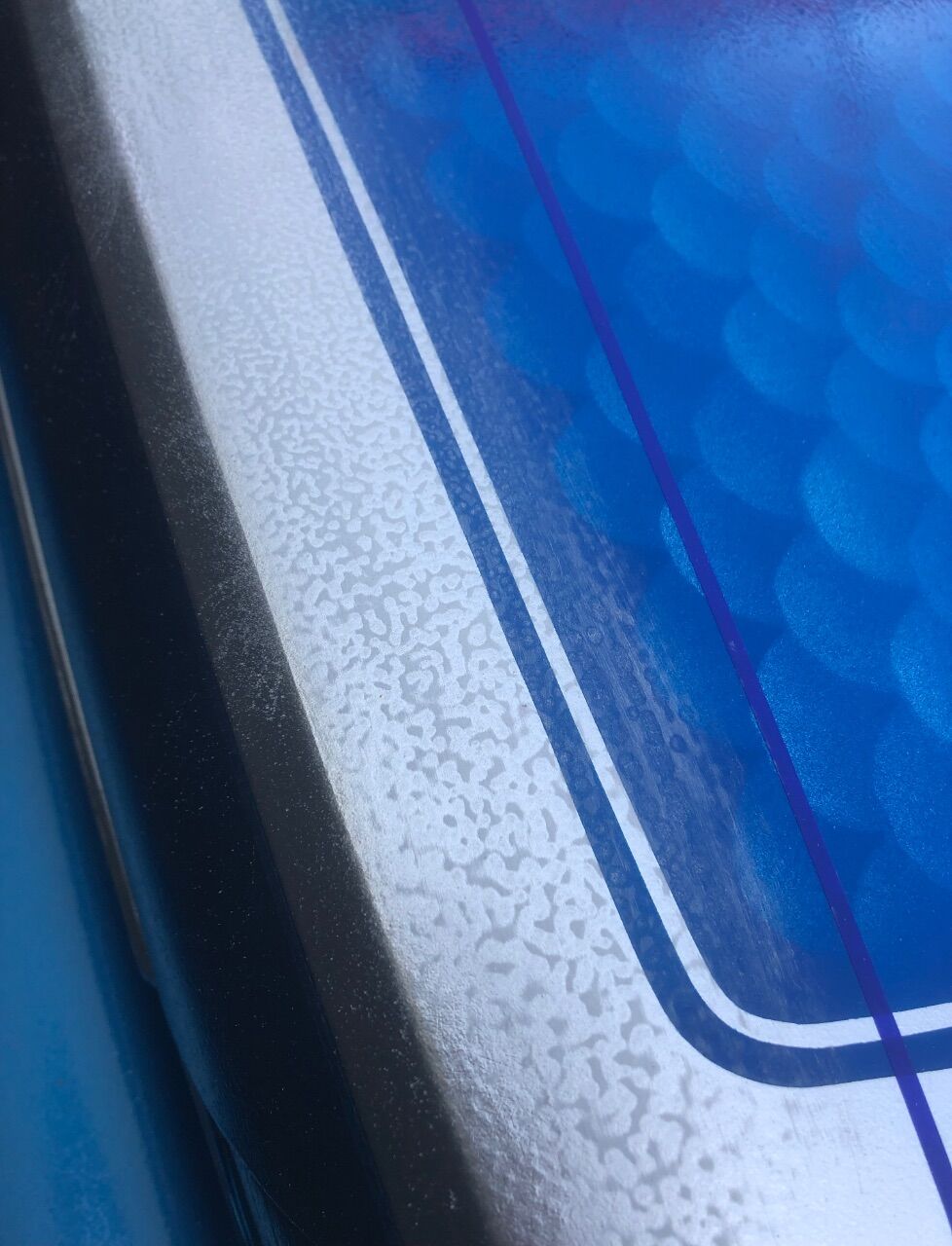

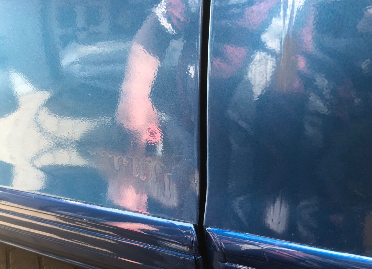

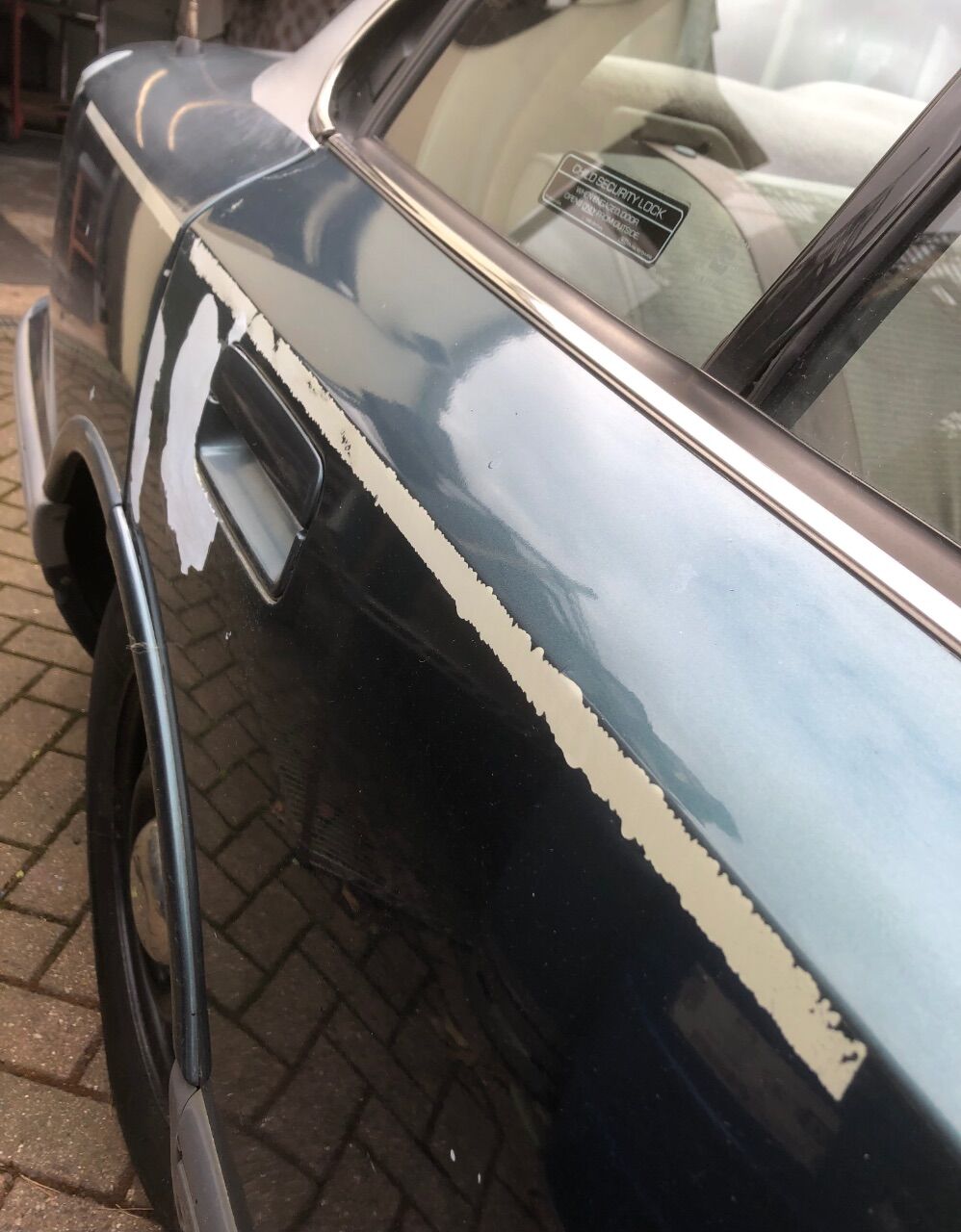

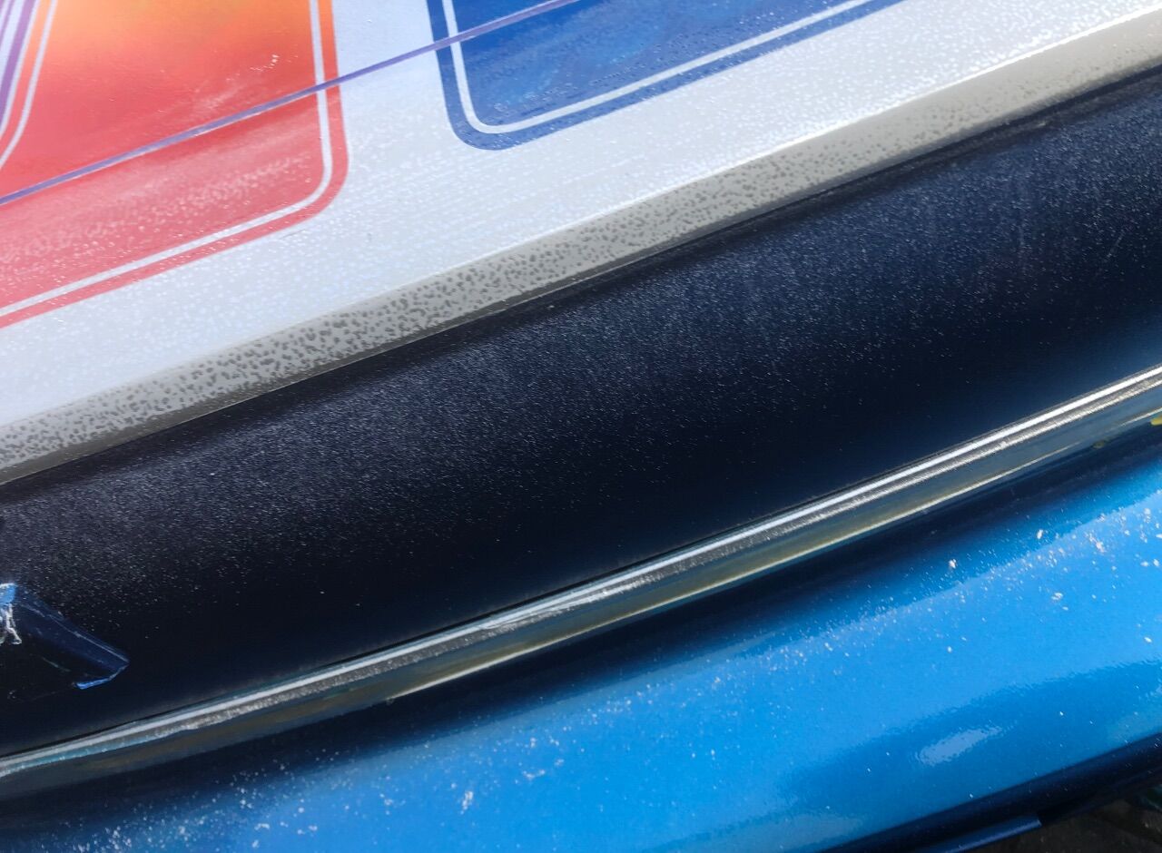

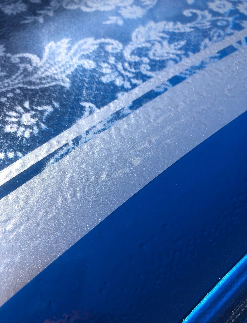

So the shit did hit the proverbial fan.
The clear reacted with a few of the wipe down areas on the car.
Photos don’t really show it fully.
Of course it took a significant amount of thought, effort and a bit of emotional fortitude to fix everything up after the reactions became fully apparent.
Razor blade or Stanley knife blade to shave away runs. Followed by 600 grit sanding.
Absolutely soul destroying work when you really just want perfection.
No choice here except for getting it done.
So I shut shop overnight to allow the clear lacquer to dry and harden fully before starting with recovery.

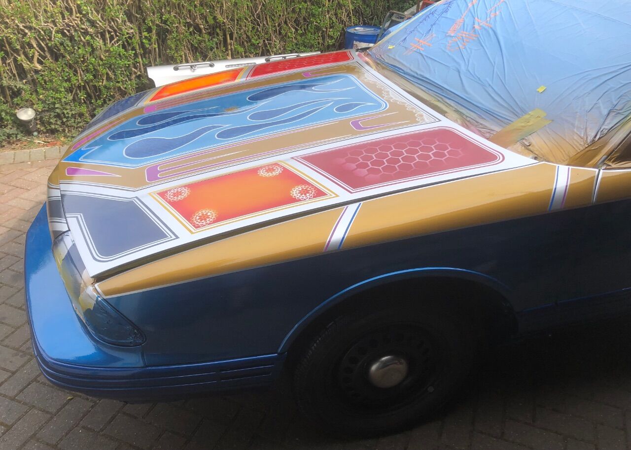

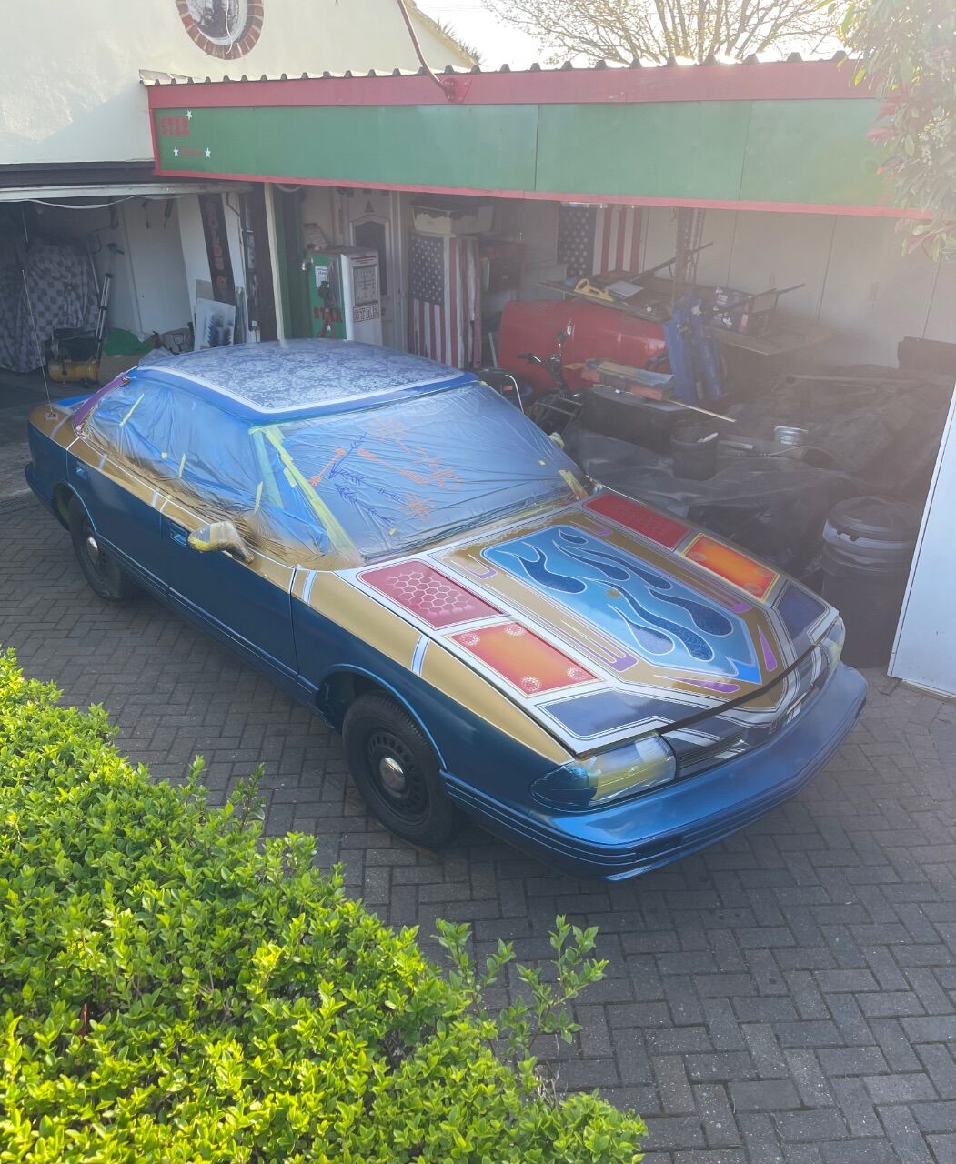

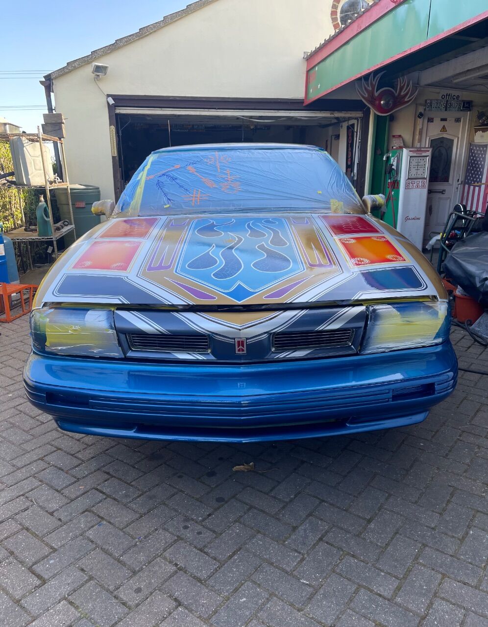

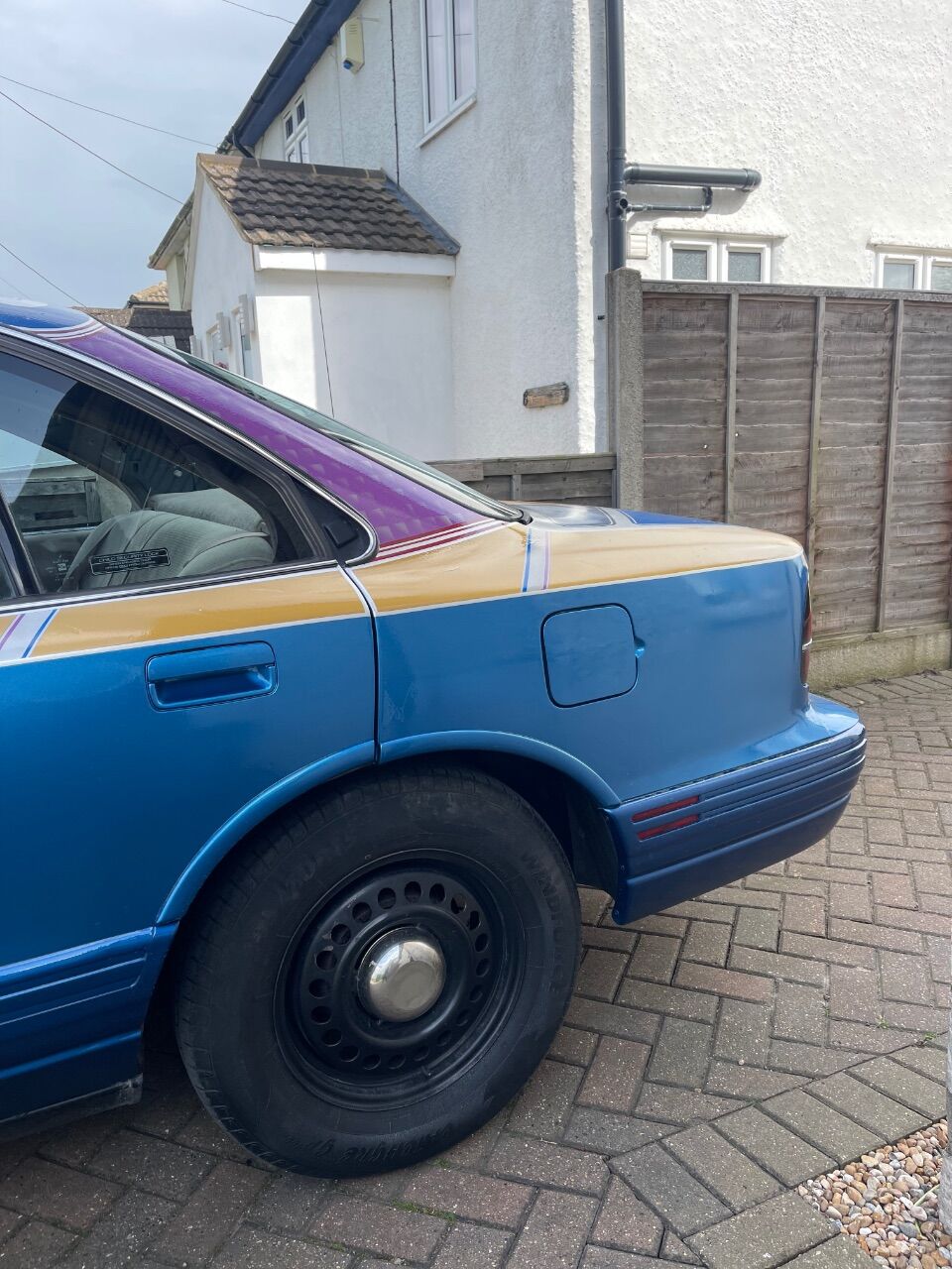

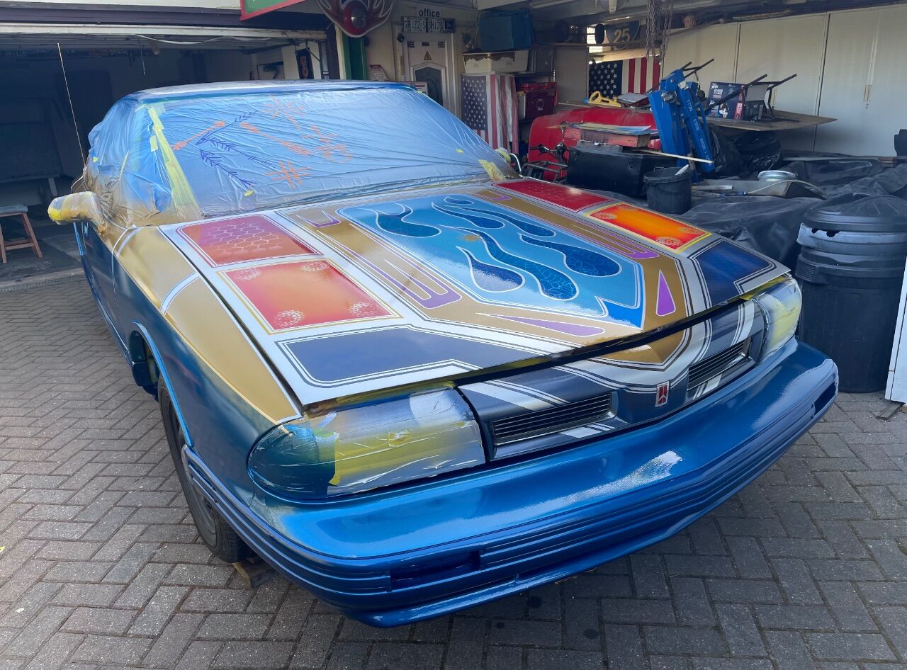

Managed to capture the two different blue tones on the car today.
It makes me happy.
Despite the work it has drawn out of me.

Three liters of Silver, Gold and Blue base coat paint and about 25  rattle cans of which 20 were different colours allowed me to be somewhat creative and satisfying my own needs for expression.
The amount of learning it has afforded me is well worth it and within the budget of the spend so far.
Oh, and 7.5 liters of two pack clear lacquer  of which 3.6 liters has made it onto the car

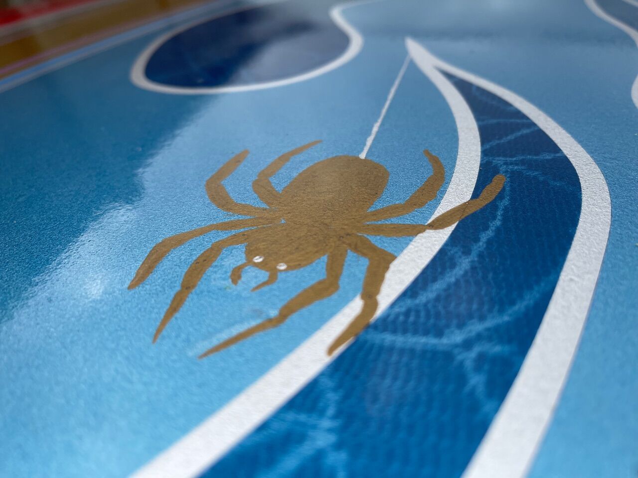

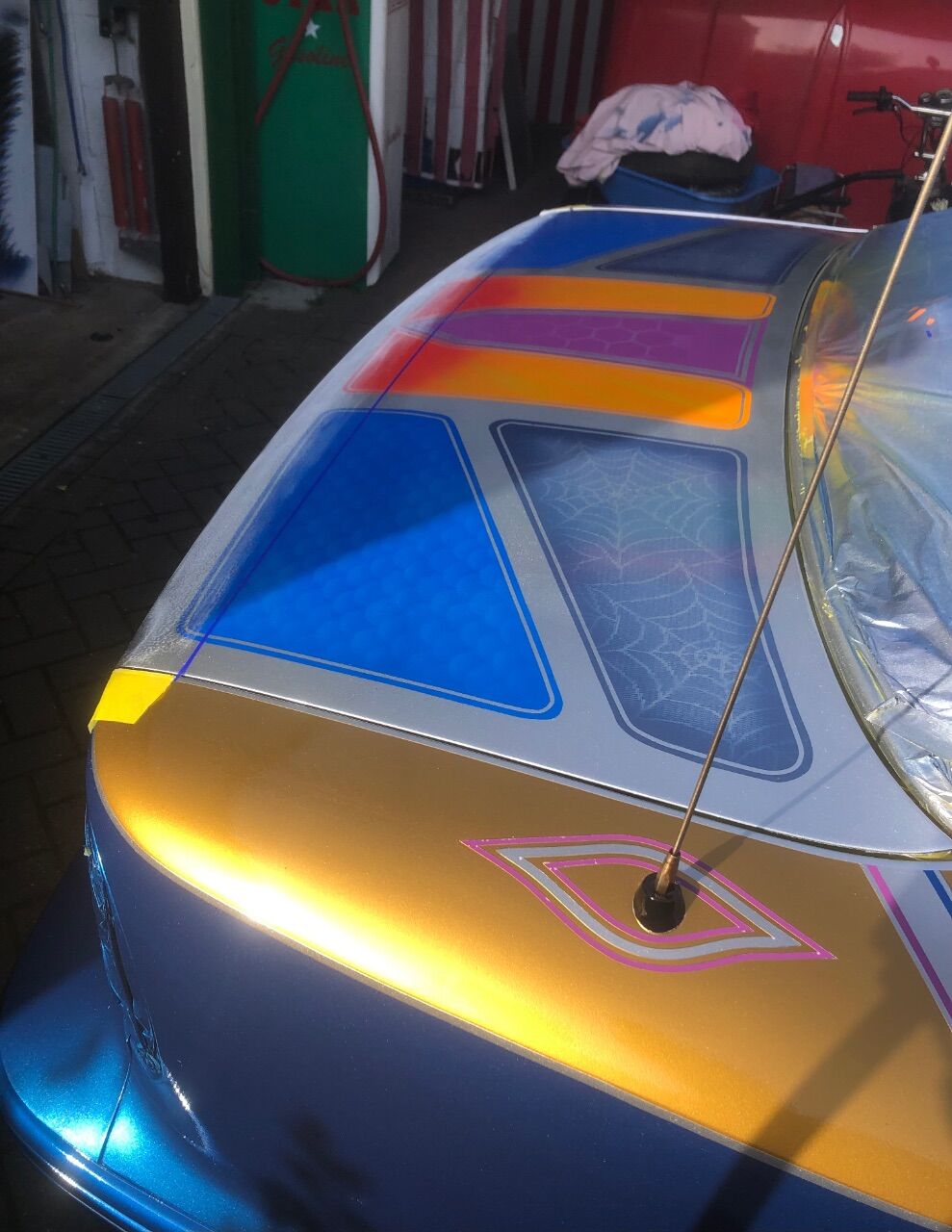

On 11/04/2026 at 08:14, grizz said:
Spiders webs, Spider, Sperm, Scallops…… Some Feathers.
So much stuff.
Want to see the combination together?
Here they
So much stuff.
Here they are.
That looks absolutely fantastic 👍👍
Thank you very much.
I went out shopping and visiting friends yesterday.
Every time I parked up, I kept looking back and took photos.
Happy for sure.

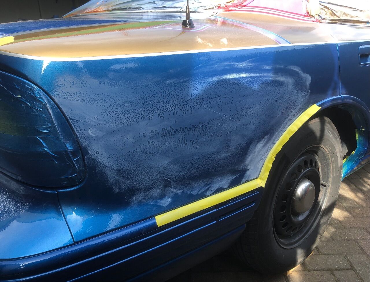

Waking up on Thursday morning didn’t make me feel any better about the chemical reactions that had taken place on coats 1, 2, 3 the day before, leaving me with a mess to try correct.
So I headed down to the garage, opened up shop and started to block sand all of the damaged surfaces with 600 grit
Eventually I washed/wiped it all down with soapy water and an added prayer before muxing another 600ml of clear.
Sprayed a mist coat and then followed with another two coats.
Next crisis…….
RUNS !!
More about them later.

So 4 hours of solid preparation and careful sanding saw me ready to mix coat number four of the two pack clear.
Tack coating all the repair sections, waiting impatiently until I could coat the whole car in the number four coat and then number 5 was completed by 3.30pm
This was 6.5 hours after I had started sanding back the reactions.
Guess what??
Repairs came out beautifully.
BUT…….
Of course it managed to create runs in different places.
More repairs to report on and explain the repair process I followed.
I am starting to think that my original idea to call the car Grizz’s Folly was great, but it seems the car objects to the name.
Maybe it would like to be called “Two Step”
Mixed clear applied twice mostly came out really well.  Except the runs.

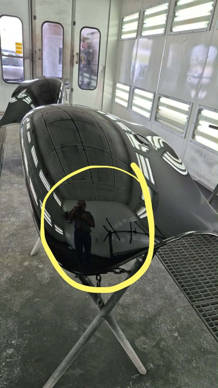

Dennis sent a picture of the fender of the 1934 Ford he is building.
Note the reflection in the paint. I think he knows what he is doing.

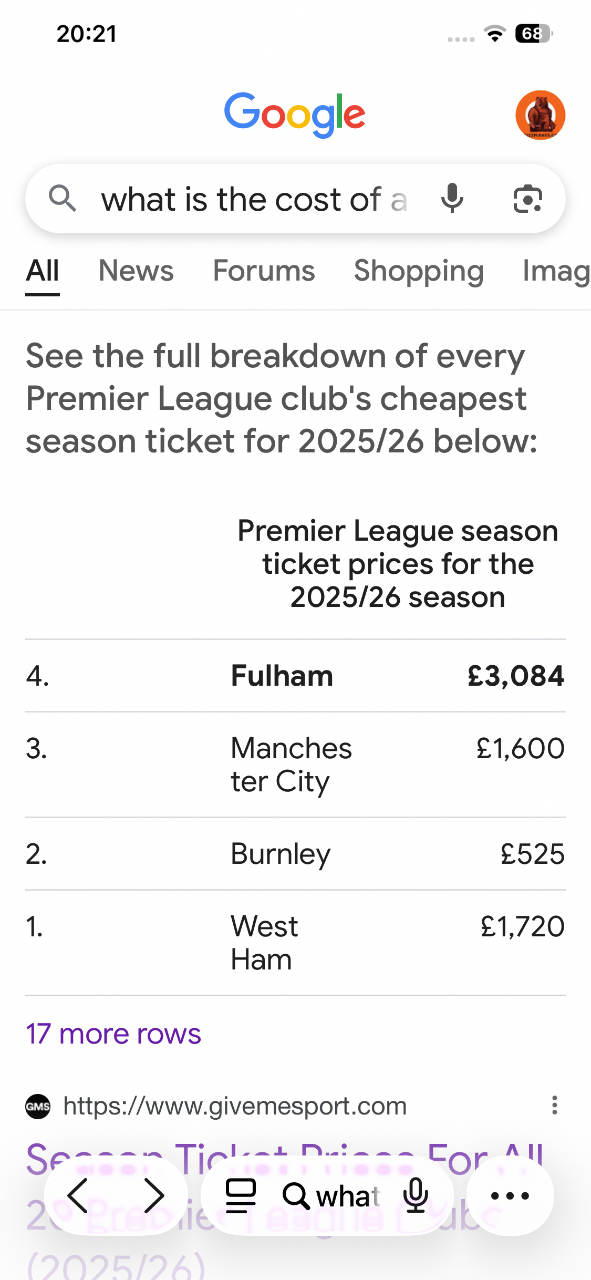

Question was asked above.
Click to open and see what he was asking.
Further comparative proof of prices, is up to you and Google or your favourite search engine.
I think totals will scare me if I kept a record.
If I had a football (soccer) season ticket for a club I supported……
Even the cheapest tickets are a lot of money and you don’t have a useful tool and car, plus mental health to show for it.
You also couldn’t sell the used season ticket for the money you spent at the end of the season.
I also only have to walk to my work shop to get my fix.
So it is probably all relative.
Football is probably a bad example as I dislike it intensely

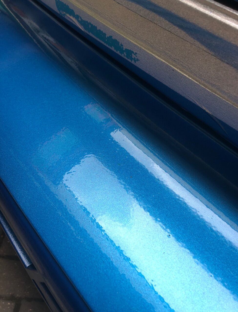

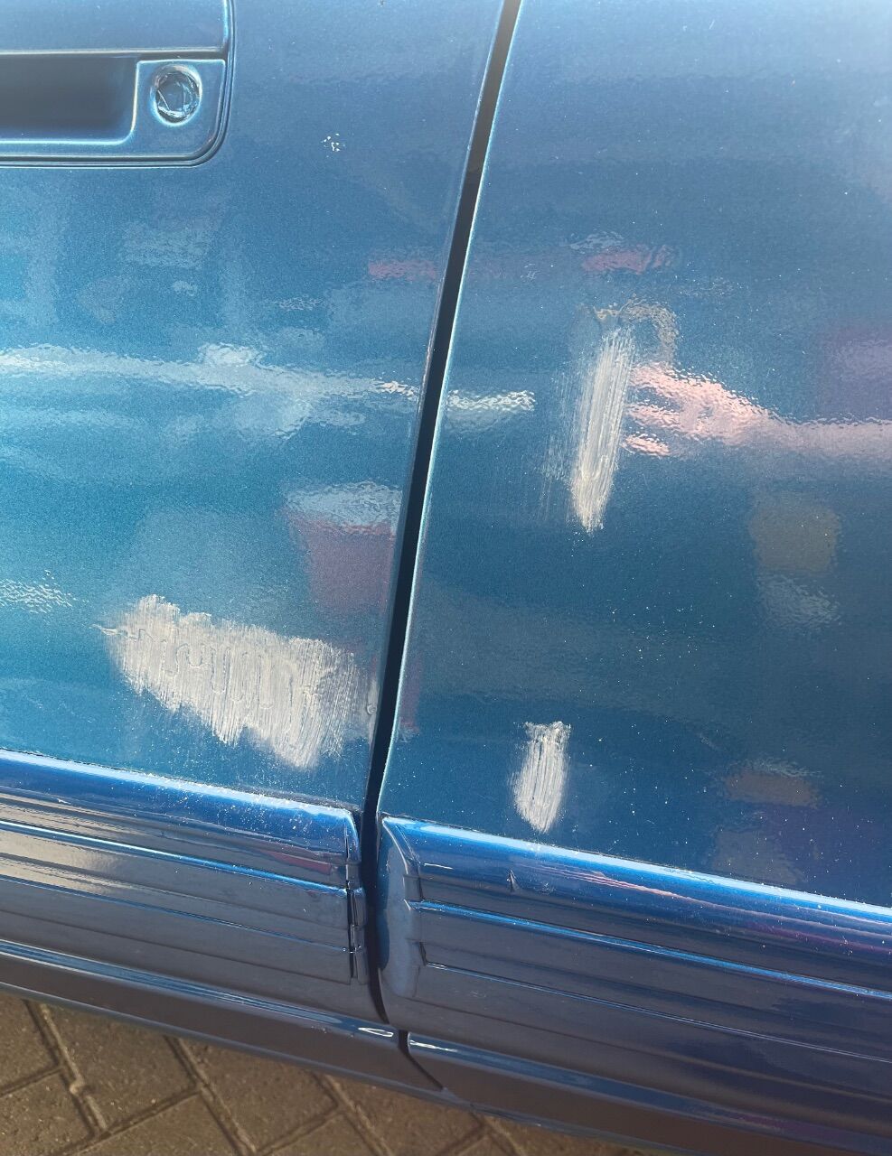

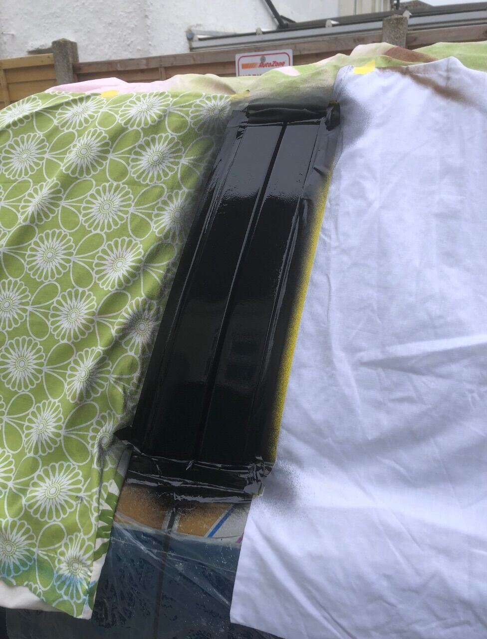

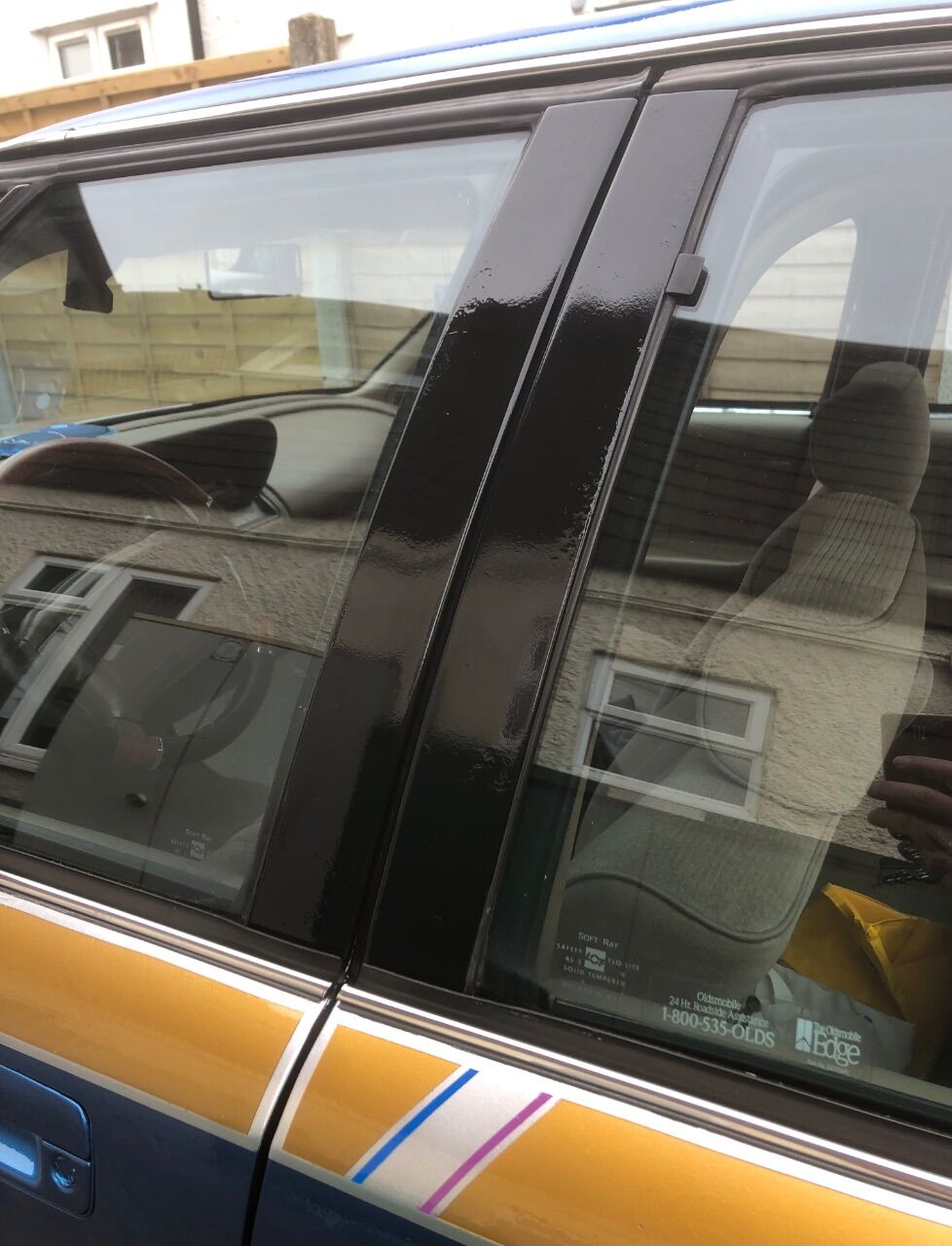

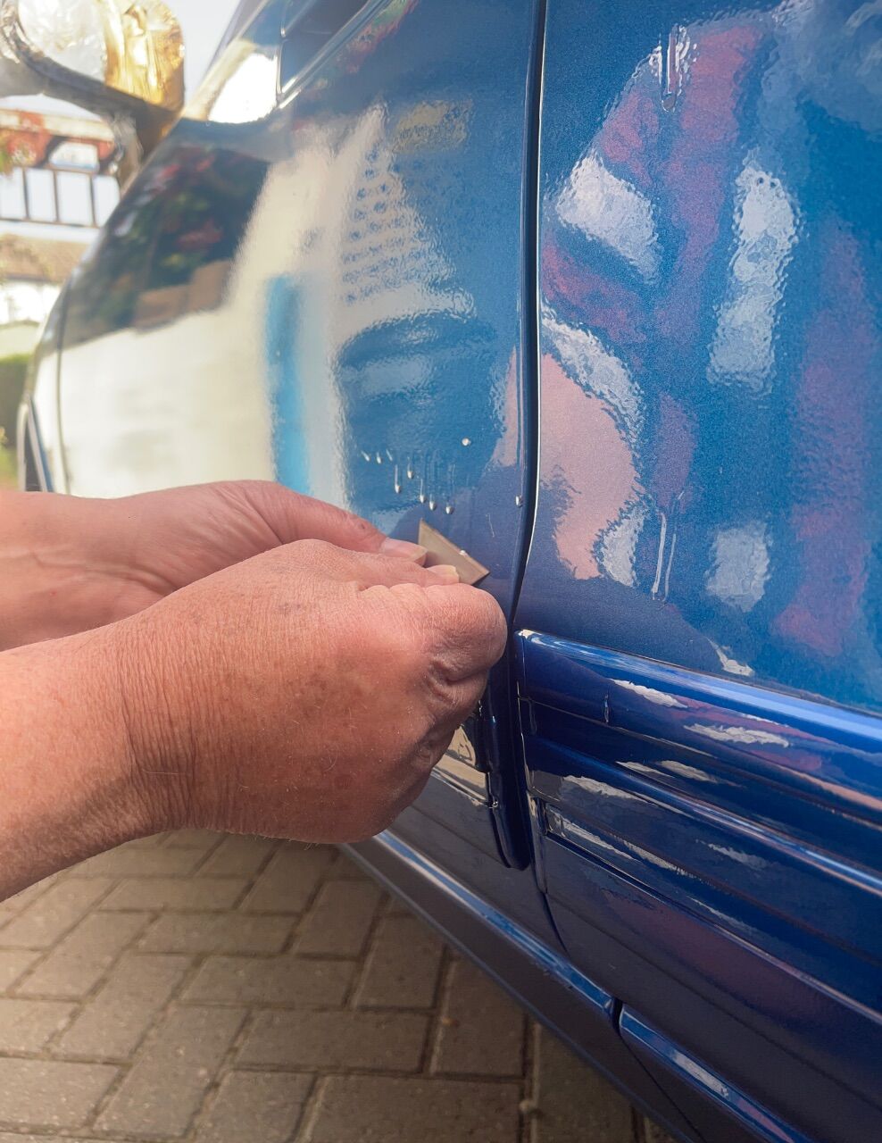

Clear lacquer runs.
100% my fault for being in a hurry, but also, painting outside in a mix of sunshine and shadows.
So you can’t always judge how wet the panels are.
Honestly, I think I have done pretty well with the limited amount of screw ups I had throughout this process, considering how little I had known and how much I tried and pushed my luck.
So the next step once I had the runs in the clear lacquer, was to “razor blade it off” using a variety of blades, in my case a used Stanley knife blade, remember that mostly we use the front 5% of the blade for cutting. So you have 80-90 percent of the straight edge still super sharp and unused.
Once the lacquer dries, an hour or so later, you cautiously slice off to droplets in a few passes so that there will be a bit of material left over to block sand with 600 grit or finer.
Followed by thorough cleaning and then a tack coat and another wet coat.
I did all of this with excellent results.
Final step would be to wait a few weeks and to then wash the car thoroughly and put a polisher and some rubbing compound over it repeatedly to smooth it out more, followed by various polish options.
I am hoping the buffing takes out more of the irregularities and the remaining undulations in coat number 6.

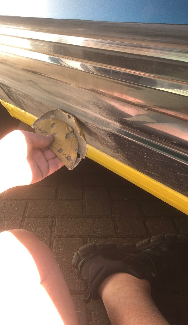

Overall, the whole car has a minimum of 6 coats and the roof, hood, trunk and bumper horizontal surfaces all have at least 7 good coats to work with.
Once I had allowed coat no 6 to dry it was time to unmask lights, sills, side repeaters, reflectors, mirrors (which are still in original paint) and of course the glass all the way around and all the doors, shut lines and more.
A job that took me about two hours.
Parts of that job again done with a heat gun to soften glue so as not to damage any paint.
Some of the bought masking film and masking tape, also left loads of glue and residue on glass, rubbers etc.
This necessitated the use of Turpentine or white spirit to shift.
After this, more soapy water to wipe that residue again.
Spider does show depth of 7 coats of glossy lacquer.
And still we are not done.
Razorblading lacquer runs.
Todays £12.00 investment.

The Oldsmobile is not yet done.
But it is unmasked and I have driven it.
There are a few more jobs to do.
Saturday morning I got the B-Pillars that are aluminium, cleaned up and got some etch primer on there.
Followed by three or four coats of gloss black.
Of course rain and wind, once again screwed up my day.
But it looks great.
Those little jobs.
And finally
I am happy the glass, rubber and frame looks good enough.
Well that's at least a 1000% improvement over what you started with!  Yes it's been hard work, but you've made the car look so much more cared-for than it was.  I can only admire and applaud.
It is good looking now.
In a slightly frenetic, psychotic way.
Certainly better than “as bought”
