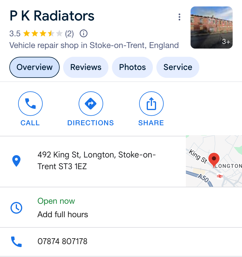

I’ve dropped a spare leaky radiator off with a local guy here in Stoke who’s been in business for ages. Hopefully it can be repaired but if not it’ll get recored. Apparently it’s an original and has never been recored before which is worth mentioning.  Once this one is fixed I’ll swap it over with the defective one still fitted to the 100. I think these rads have stampings on which make them unique to the car, the code for cutting new keys or something. I’m not even sure if it’s still got the original radiator still fitted, or even the original locks.

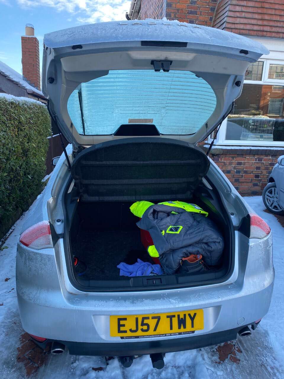

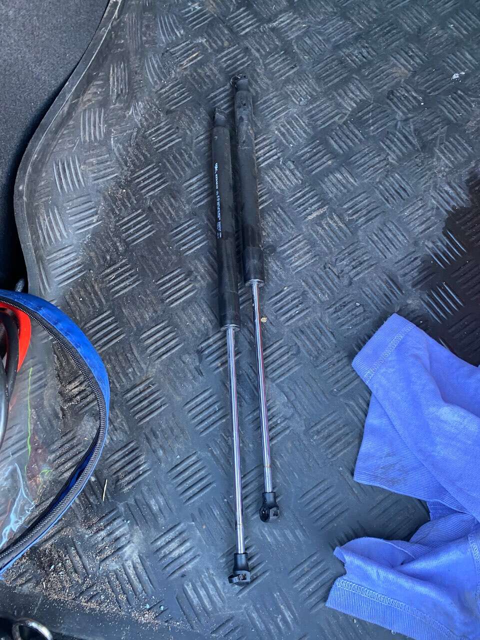

Not much of an update as the weather has been too cold for me to get my backside into gear and do much.  As a result of the cold weather the Laguna has been doing a great impression of a guillotine, the tailgate struts getting weak to the point the boot lid either won’t hold itself up or lures me into a false sense of security and smashes me on the head while I’m changing into my work boots.
These struts range from £11 a pair to ££HOW MUCH?? So I settled for a pair of £30 Quinton Hazel jobbies which are probably Chinese nowadays but took 2 mins to fit and seem to do the job, the tailgate now belting me in the chin when I open it rather than falling on the back of my head. Hopefully they’ll settle in use but I’m pretty pleased with them.

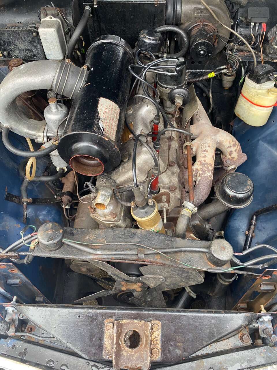

Ive been using the Rover every day for work, in the wind and rain and even taking it up the M6 again in an effort to weedle out any problems and allowing me to repair them when they arise. The parking brake was sticking on the NS, which I fixed but it’s now unfixed itself again- I need to reach around behind the wheel and push the handbrake rod back in to release the brake. More fettling required.

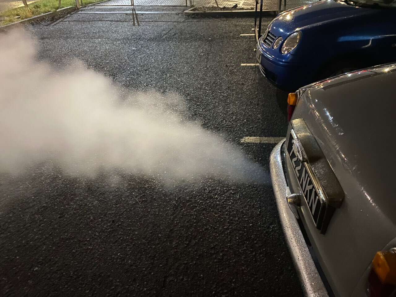

The bigger issue is the high coolant consumption and clouds of smoke on start up. The coolant I hoped was just me just overfilling the radiator, apparently you need to leave the level quite low to allow for expansion when hot or it just gets pushed out of the overflow, which is what it’s doing, however after a few miles the level drops dangerously low and the front crossmember gets soaked in coolant from the overflow. The cooling system doesn’t build up any pressure when hot either, which it only does when stationary. I suspect the thermostat is missing.  I replaced the rad cap for the correct type but it didn’t make any difference.
On top of this is the clouds of smoke/steam from the exhaust, mostly on start up which seems to clear after a few minutes. After a longish run the engine runs rough with missing and pops from the exhaust. Weirdly the spark plugs all look to be in good condition. I was expecting one or two to be soaking with oil or coolant.

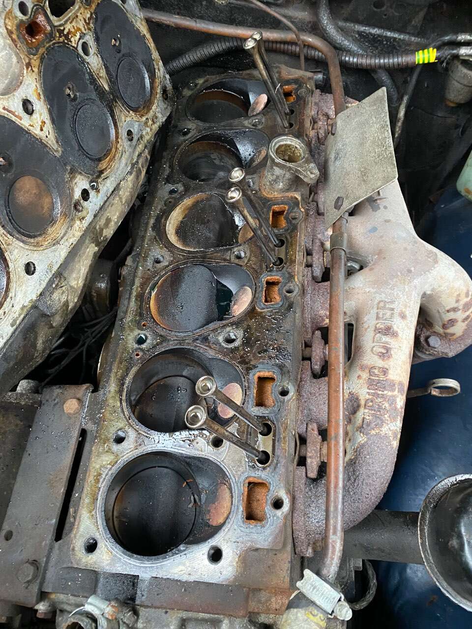

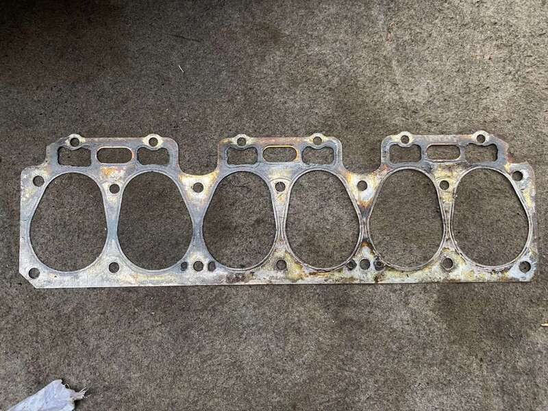

I’m leaning towards the head gasket leaking or maybe a corroded head. Fortunately head gaskets on these are really easy as the exhaust manifold is on the block and the inlet manifold is part of the head so much less messing around.
Taken for a jet wash to remove the weeks road salt before the head comes off hopefully tomorrow. Now confirmed as the head gasket as the oil is begging to emulsify and water is dripping from the rear breather on the cylinder head….. well, the head gasket is definitely one of its issues.

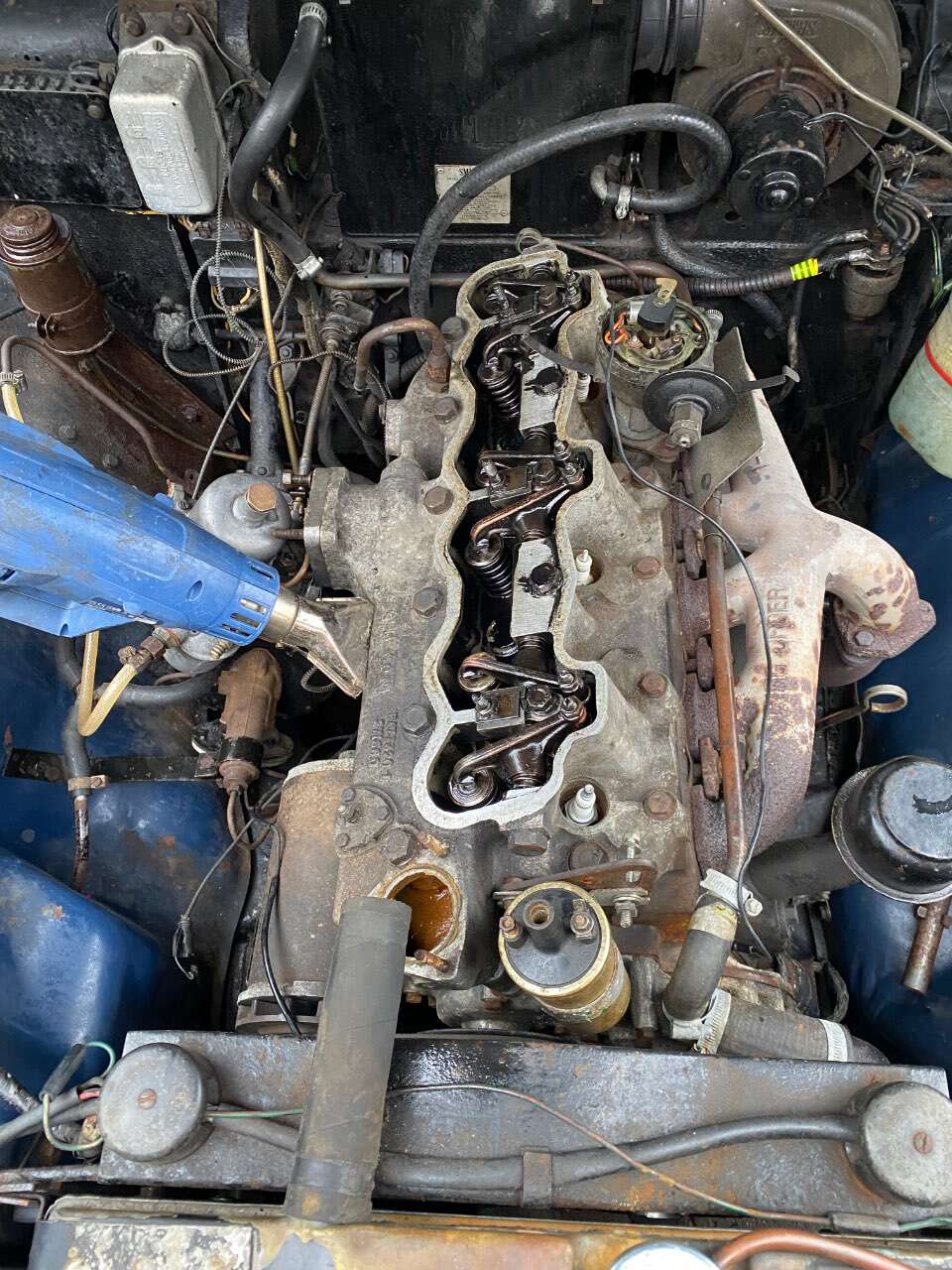

I’ve had a pop at this job this morning and it was very straightforward even for a “have a go hero” like me.
I got stuck in and had a fun time in the freezing cold, the job at least was straightforward. A few things I noticed were the head bolts didn’t seem to be tight and the thermostat was missing. Combine those with the previous owner replacing the water pump and the leaky rad and I’d be surprised if it hasn’t been overheated at some point in its history, perhaps I’m looking too much into things. I can’t find an obvious failure point with the head gasket but it does look very grotty. There was an oil leak from the rear of the head and down that end all the head bolts were covered in oil when I took them out.
Although the head is now off but I can’t get the temperature sensor out of the side of the cylinder head so it’s still physically tethered to the car until I can sort that out.
The bores look ok with no scoring I can see although each cylinder has a wear lip at the top I can feel with my finger tips.
Once the head is finally off I’ll have a proper look and send it away to be pressure tested and skimmed.

Bit of de-gunging and all should be well.
Maybe just dirt, but it looks a bit like it has been blowing between the rear three cylinders. I think the rear cylinders would get the hottest if it ever had over heated.

Agreed, the back 3 look pretty barn door as to where the problem is. Think you're right to give that a skim - it's a big long piece of metal that's been overheated in the past and not put back properly.
3 hours ago, N Dentressangle said:
Totes, especially in this weather.
I’ve dropped the head off at a local engine builders and the guy said exactly the same thing as soon as he saw it. I thought the compression was ok and had been looking for areas where the oil and water had managed to mix or get into the combustion chambers. I think it’s thoroughly cream crackered in a few places, it’s amazing it ran at all, even quite well!  I found a straight edge to put the head against and it does seem to have a warp to it. Hopefully this is the cause of multiple issues afflicting this engine.
I’m still waiting a call back from the engineers regarding the costs on what needs to be done but the fella recommended having all the valves re-seated along with a clean up and skim. Unfortunately they’re quite busy and it’s going to be at least a week before it’s done.  I’m looking forward to getting it all back together again!

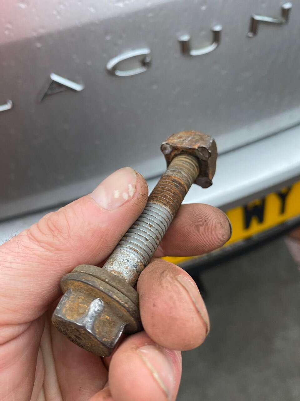

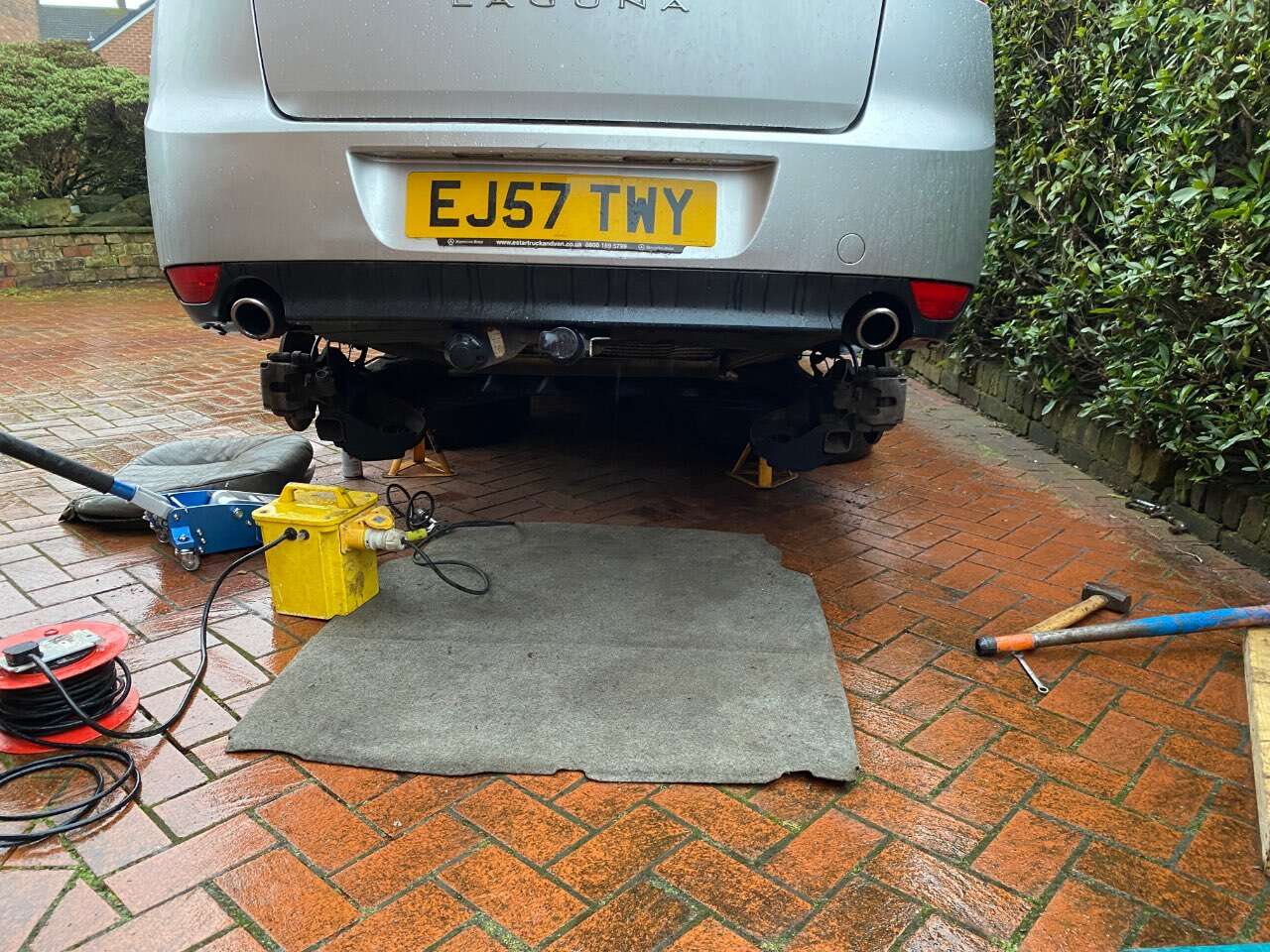

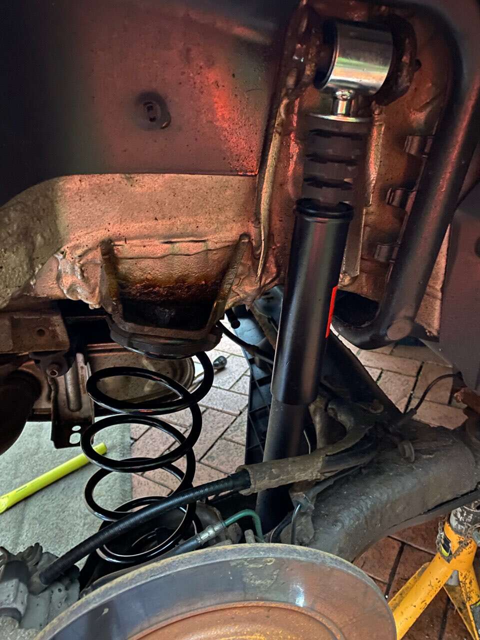

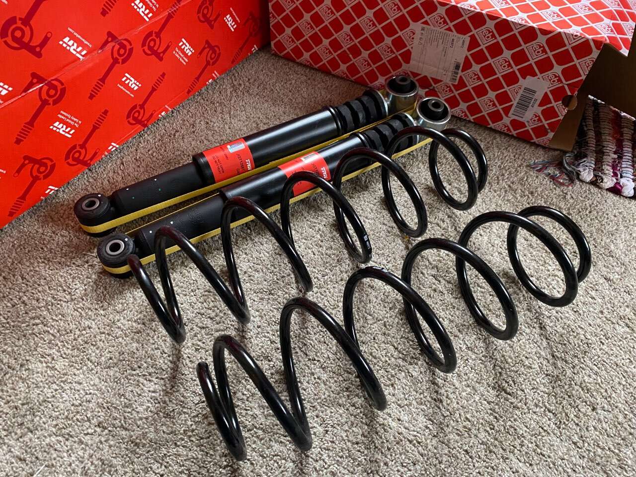

I'd suspected for some time that a rear spring had broken, with a full complement of passengers I’d hear an occasional “twang” when driving. While I had a rear wheel off last week I had a check and sure enough the bottom 3 inches or so of the spring had broken. The rear shocks looked a bit end of life too so a pair of springs and shocks were ordered from AUTODOC and arrived this morning.
I set about fitting them this afternoon (in the rain, obvs) and found it a straightforward job, with the shock absorbers unbolted the axle can swing down and release the springs. To my horror both captive nuts for the shock absorber bottom mounts broke loose prompting me to use some obscene language and shake the breaker bar in the air at God. Standard knuckle skimming fun. The spinning nuts could be held with a 20mm spanner and soon everything was removed and in a rusty pile on the drive. Refitting was much easier and the “gooner was soon back on its wheels. The high stance soon settled and a test drive revealed everything to be in order, feeling much tighter and no rattles. Brill! Who doesn’t love fitting shiny new parts?
