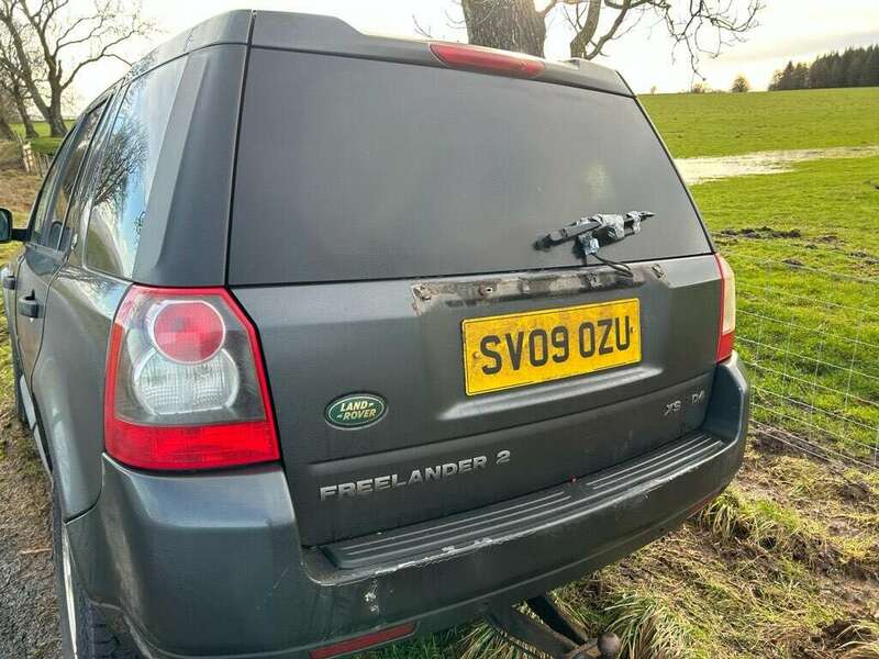

leakingstrut Posted November 26, 2022 Author Posted November 26, 2022 The LED’s will be gone soon, I’ve got some h4’s to fit into the standard headlights. They’ve been in the boot for a while now, it’s just not been a high priority as I’ve not been planning to drive it much till the gearbox is done. Cue my Freelander doing typical Landrover things, and the Toledo being pressed into commuting duty and not having time to swap the lights because I’ve got a daily to bodge fix. LightBulbFun, tooSavvy, High Jetter and 2 others 5

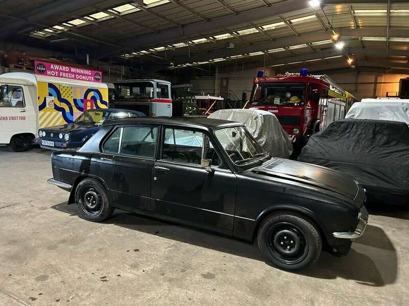

leakingstrut Posted January 20, 2023 Author Posted January 20, 2023 6 hours ago, Crackers said: Is that shared storage or do you have any connection to the fire engines and ERF in the background? Dundee Museum of Transport, £36 a month. Access requires 48 hours notice and I can’t work on it there, but it’s dry and secure so I can’t knock it for that price! GMcD and Crackers 2
GMcD Posted January 20, 2023 Posted January 20, 2023 26 minutes ago, leakingstrut said: Dundee Museum of Transport, £36 a month. Access requires 48 hours notice and I can’t work on it there, but it’s dry and secure so I can’t knock it for that price! Absolute bargain! You'll struggle to even get a council lockup roundabout that price.
Crackers Posted January 20, 2023 Posted January 20, 2023 1 hour ago, leakingstrut said: Dundee Museum of Transport, £36 a month. Access requires 48 hours notice and I can’t work on it there, but it’s dry and secure so I can’t knock it for that price! That is a Billy bargain, great find.

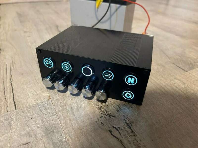

leakingstrut Posted April 30, 2023 Author Posted April 30, 2023 Got the stereo / control box wired up, buttons are: Interior lights, passenger/navigator light, control button for the Koso display, heated rear window, fan and stereo / usb sockets on the bottom row. I used to Wago connectors - dead easy. I did double connections at a few points which may not be kosher but nothing is mission critical it should be fine. The heated rear window switch is taped up as I had to remove the latch as it will be wired to a timed relay and it wasn’t keen to going back together. Stereo isn’t fully wired as I needed a relay and they were all in the garage! Slightly worried about heat inside from the stereo, so I’ll keep an eye on that. The stereo knobs are cheap plastic but I got some nicer metal ones off eBay for a few quid which should fit. Still to get it wired into the car, went over to do that but realised there was a bunch of other wiring I need to do first. I’ve brought the distributor home to rebuild once all the parts are here too, as a heated rear window and tunes won’t do much good without a running engine. CreepingJesus, High Jetter, GMcD and 2 others 5
