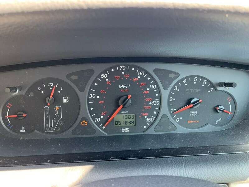

maxxo Posted May 13, 2023 Author Posted May 13, 2023 achieved 50k miles today also what do you notice? yes i’ve had an illumination! this is the fault, should be entertaining to sort, deleted the code and the light has stayed off though GrumpiusMaximus and 500tops 2
RoverFolkUs Posted May 13, 2023 Posted May 13, 2023 Ah, an EW10 with a secondary air injection fault.. quelle surprise. 50/50 whether the pump is duff or its all a bit blocked up. Probably latter given the code has cleared and stayed off.. for now
maxxo Posted May 13, 2023 Author Posted May 13, 2023 23 minutes ago, RoverFolkUs said: Ah, an EW10 with a secondary air injection fault.. quelle surprise. 50/50 whether the pump is duff or its all a bit blocked up. Probably latter given the code has cleared and stayed off.. for now common issue i’m guessing? reckon it’ll pop back on?
RoverFolkUs Posted May 13, 2023 Posted May 13, 2023 9 minutes ago, maxxo said: common issue i’m guessing? reckon it’ll pop back on? Fairly, whenever the EML comes on its usually that code! I think it most likely will do, but see how it goes. If it is caused by a bit of carbon buildup and it's only slight then it might take a little while to come back. Or it might come back tomorrow!
maxxo Posted May 13, 2023 Author Posted May 13, 2023 2 minutes ago, RoverFolkUs said: Fairly, whenever the EML comes on its usually that code! I think it most likely will do, but see how it goes. If it is caused by a bit of carbon buildup and it's only slight then it might take a little while to come back. Or it might come back tomorrow! i mean compared to diesel issues they can have i can live with this, i don’t mind it needing a new pump considering the age of the car and the fact it’s been incredibly reliable so far time will tell and i shall keep the thread updated RoverFolkUs 1
richardmorris Posted May 13, 2023 Posted May 13, 2023 What warning bing and message popped up on the central display? Anti-pollution fault?
richardmorris Posted May 13, 2023 Posted May 13, 2023 38 minutes ago, maxxo said: i mean compared to diesel issues they can have i can live with this, i don’t mind it needing a new pump considering the age of the car and the fact it’s been incredibly reliable so far time will tell and i shall keep the thread updated When mine needed a new fuel pump it was £900.
maxxo Posted May 14, 2023 Author Posted May 14, 2023 19 hours ago, richardmorris said: What warning bing and message popped up on the central display? Anti-pollution fault? yes indeed anti-pollution fault, i suspect it might be related to that whirring noise i've noticed recently at a cold start

Jazoli Posted May 18, 2023 Posted May 18, 2023 24 minutes ago, maxxo said: over 400 miles covered and no eml so should be fine i’d say It will fail eventually and ping the light back on, the pumps are dirt cheap anyway so just get it changed.
maxxo Posted May 18, 2023 Author Posted May 18, 2023 1 hour ago, Jazoli said: It will fail eventually and ping the light back on, the pumps are dirt cheap anyway so just get it changed. i’ve ordered one from ebay for £15, i can’t complain at that price even if it only lasts a few years glad it’s not something major

RoverFolkUs Posted May 28, 2023 Posted May 28, 2023 It's likely just a bit clogged up then, not bad enough to flag the light back on yet. Similar to EGR valve insufficient flow codes, they can come and go if its just a little bit clogged and borderline maxxo 1

maxxo Posted June 15, 2023 Author Posted June 15, 2023 as the song goes “there is a light and it never goes out” oh dear! BEEPS BE HAPPENING! we have a re illumination different circumstances this time engine up to temp, hot day, parked outside a shop in order to buy a drink, left the engine running as my partner was waiting in the car and i wanted her to stay cool and leave the air con on i was in the shop literally 30 seconds when i got a text “your car has just beeped and said anti pollution fault on the screen” i had left the car unattended for 3 minutes in total surely an air pump fault would only affect it from startup?
