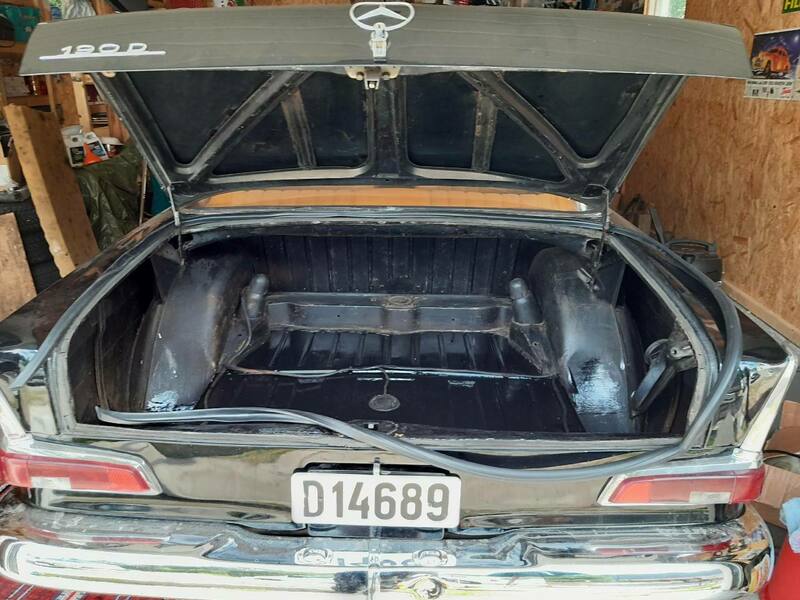

I've been thinking a bit and I think I'll try my hand at welding a bit more and especially if I can find out how to weld the holes after the pop riveting. Then I think I'll have to drill some holes of the same size in some plates and try. But one of my problems is that I have the world's worst gasless MIG welder, so combined with me, I don't have much hope, but I have to try.
You could open up those holes you found (maybe with a big drill bit)  in an attempt to get rid of the worst of the rot, then simply treat and paint the remainder.  I think the metal prep stuff that comes in the POR15 kit is phosphoric acid which is pretty good at stabilising rust before painting it.  If you're going to be getting a permanent repair done in the future then there's probably no point filling it. Just cut out the worst, treat and paint.
I used to be against using gasless MIG on cars, but recently I've found it a lot easier after getting hold of some 0.6mm flux core wire.  I'm really surprised how well this works on sheet metal and have done the majority of my Amazon using it so far, actually in preference to using the solid wire plus Argon.   It's quite hard to find, but might be worth a shot?
Thanks for the good advice and will look into this. The reason I wanted to cover the holes was to prevent water from getting into the sills. But fortunately the holes after the pop rivets are so recent that they haven't started to rust properly yet.
And I'll go out and check what kind of wire my welder has now and come back with more info.
Turns out I have 0.9 wire. Can I ask what kind of improvement I will get by going to 0.6 wire as I have no idea.
And these are the specs on my welder and it can take 0.6 wire.
I find it runs far less hot, reducing the chances of blowing through thin panels.
The downside is if the wire feed on your welder isn't great, 0.6 can feed badly. But it's still worth a try?
You'll need 0.6mm tips as well.
Always thought the wire size you use depends on the thickness of metal you are going to weld. 0.6mm good up to 2mm thick metal. Along with the corresponding size tips you also have the wire inner liner to consider which could be a pain in the arse to change/ obtain.

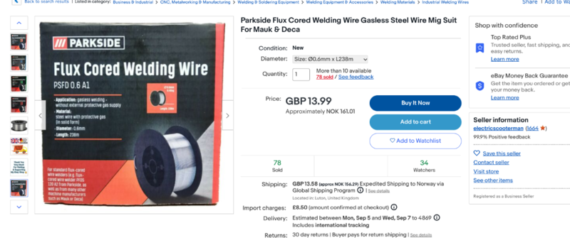

This sounds good as I can't find anyone in Norway who sells 0.6 wire, but I have found someone on ebay in the UK who sells exactly this wire. And 1 roll should last a while or should I buy 2?
671622574_Screenshot2022-08-2411_19_44.thumb.png.fdb1cfbb723012e5cdf2699e06072015.png
If all you have to do is the shelf and the bottom of the wing, then one will be more than enough.  On the Amazon I've done the whole bulkhead, scuttle, inner wings, A-Pillars and some of the floor with one reel of 0.45kg and it's still got some left.
Then I will  only buy 1 as it should last a long time.
I just noticed the shipping and import charges!
I wonder if I bought some here and sent it over it would be cheaper?

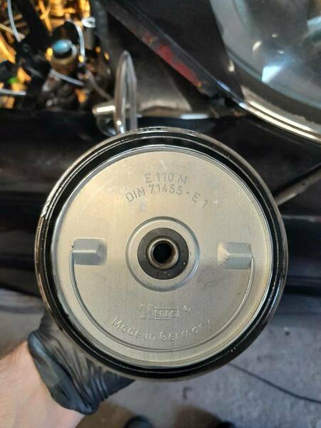

Got the oil filter and the diesel filter in the post today, I bought the filters that my main parts supplier could get the fastest. And hoped that these would fit.20220825_103832.thumb.jpg.826be6f2411b04acc5c3865285f67a32.jpg

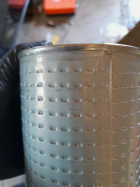

And started with the most important filter, the oil filter. And the holes on this were surprisingly small, but the engineers probably know what they are doing.
But will it fit in the oilfilter housing? Yes it does!

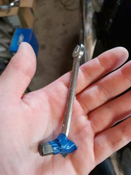

Then the next thing was to attach this to the engine again. And the location of the oil filters on these is not something I like this together with this type of filter and this is not a fun job and there was a lot of swearing but I got it on in the end.
And since it's tight here, I had to use my imagination when it came to tools and this was the only thing that worked with the bolt for the oil filter.
So I hope I have managed to tighten it up enough. Then next is the diesel filter.

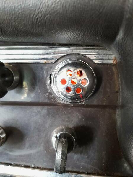

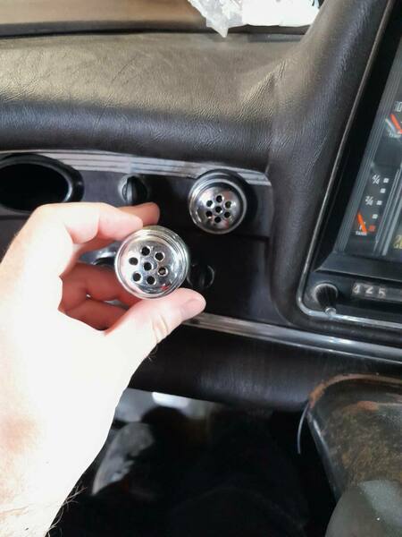

The next thing was the glow light / heat resistor or whatever it's called for the glowplugs in the dashboard, this doesn't work. And a new part for this is no longer available, so I bought a new one for an International tractor instead.
I don't think there are any differences between these and both are 12 volts and the bit inside is the same thickness.
And with a new one, it works again.
But the first time I tested the new one, there was a little smoke, which scared me, but this cleared up, so it was probably just something that had to be burned off.
But this system still doesn't work but I'm getting new glow plugs soon and that should fix it.

I've never seen one of those before, that's terrifying 😅

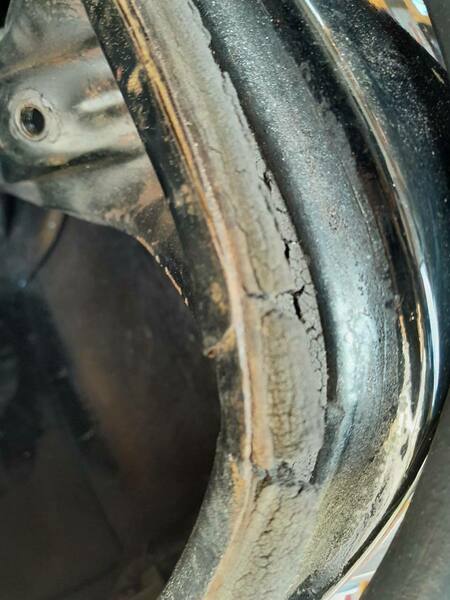

And I also got new seals / gaskets for the bootlid today as the old ones are completely ruined and let in a lot of water.
And the new one seems to fit.
So I tore off the old one which revealed some small rust spots that I need to fix so it will be a few days before the new one can be installed.
But I forgot the glue for the new one. But I don't know what to use, do any of you have any recommendations for the type of glue for this?
I haven't either, but I've known about them. And I was terrified the first time when smoke came out of it and that I discovered it was getting hot, which I now think is normal. These are strange things, a normal lamp/light would have been better.
