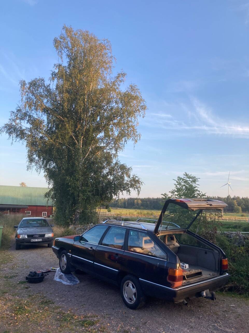

Bonus picture of all the Audis and the grey Aygo.

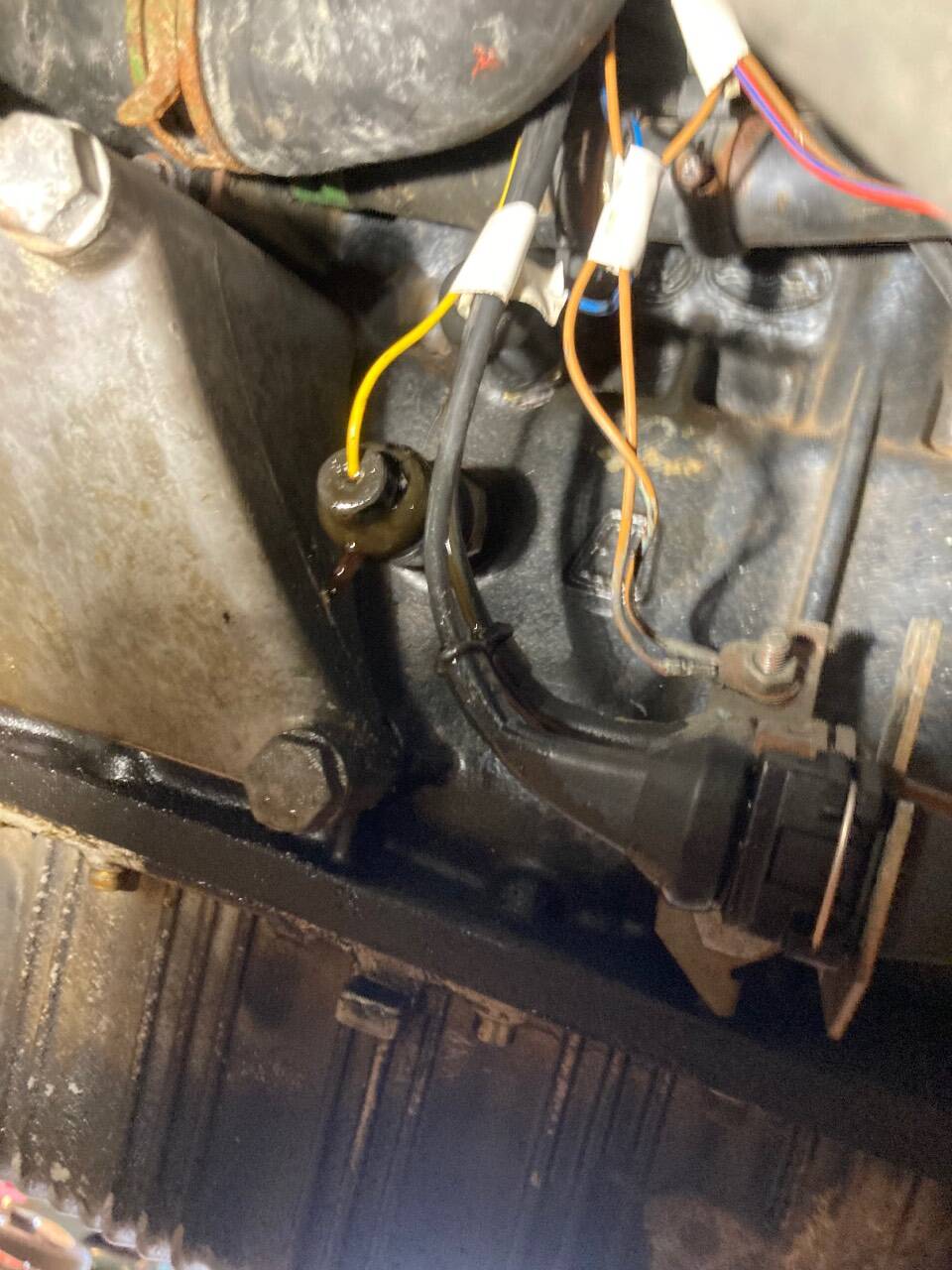

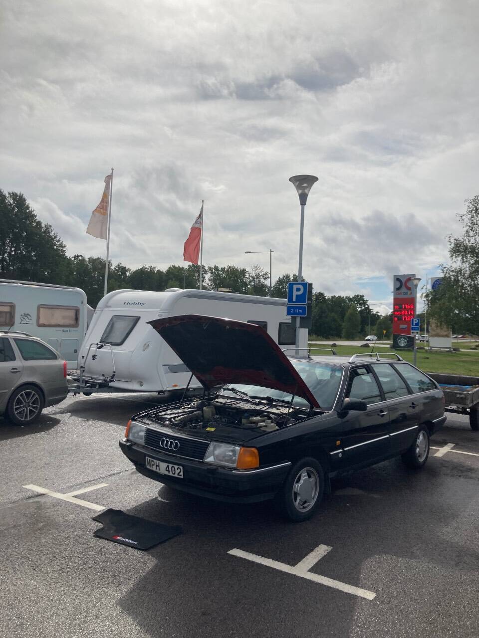

Those of you who followed my latest car collection might remember the tow cars thirst for oil. I had to stop every 45 minutes to top up the oil in the old VW T4. I had bloody nightmares about why, but it turned out to be a cheap fix.
The reason was a leaking oil pressure sensor. So I changed the washer and everything now seems fine. Hope it stays that way.

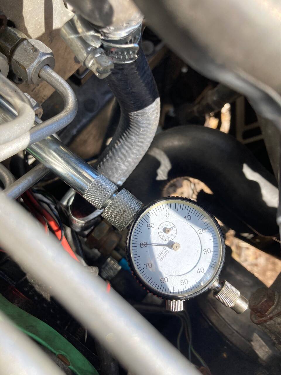

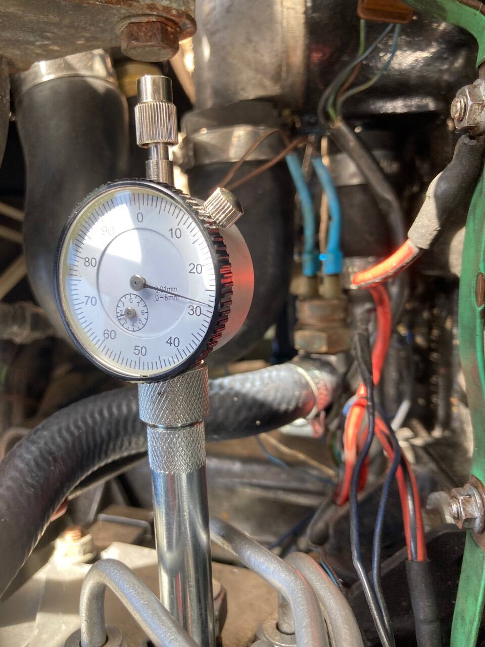

Audi 100 Turbo Diesel: Timed the pump today. IMG_4628.jpeg.980a632edea9f1919718f9d38561b0f4.jpeg
Tools getting prepared.
First reading. Injection point was too late.
After a bit of faffing about with the belt and pulleys to give the pump more space to move, I achieved the by Volvo established value for the D20 of 80. D20 is what Volvo called this engine when it lived in the 5-cylinder version of the 240. Must be a rare combo as it was only for the Finnish 🇫🇮 market.
Engine now runs fine, but it’s still hard to start. Glow plugs are the suspect, and that is after a conversation I had with the former owner.

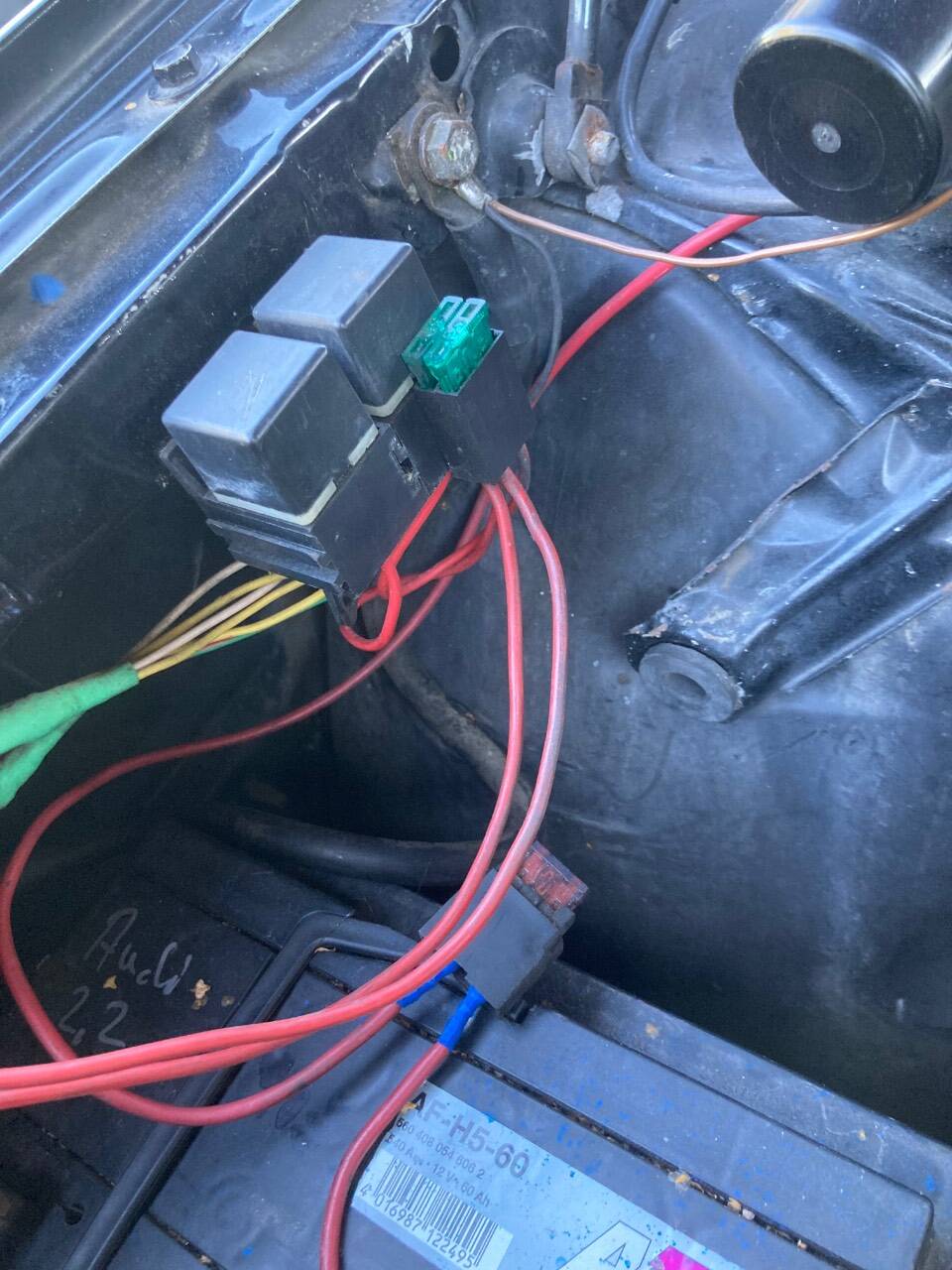

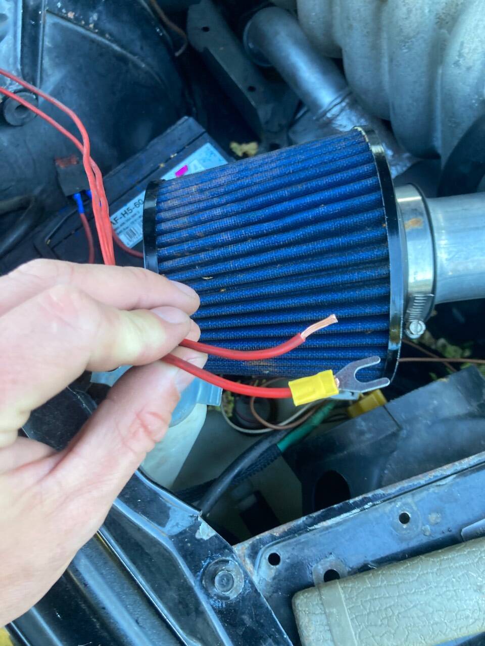

The former owner had made a quite clever new electrical system for the main light. The relays a big enough for additional lightning and he put in connectors for that. I just had to finish the job.
New battery was fitted. It was a bit too big, so I had to manufacture a new battery fastener. The battery is really tucked in tight under the air filter.

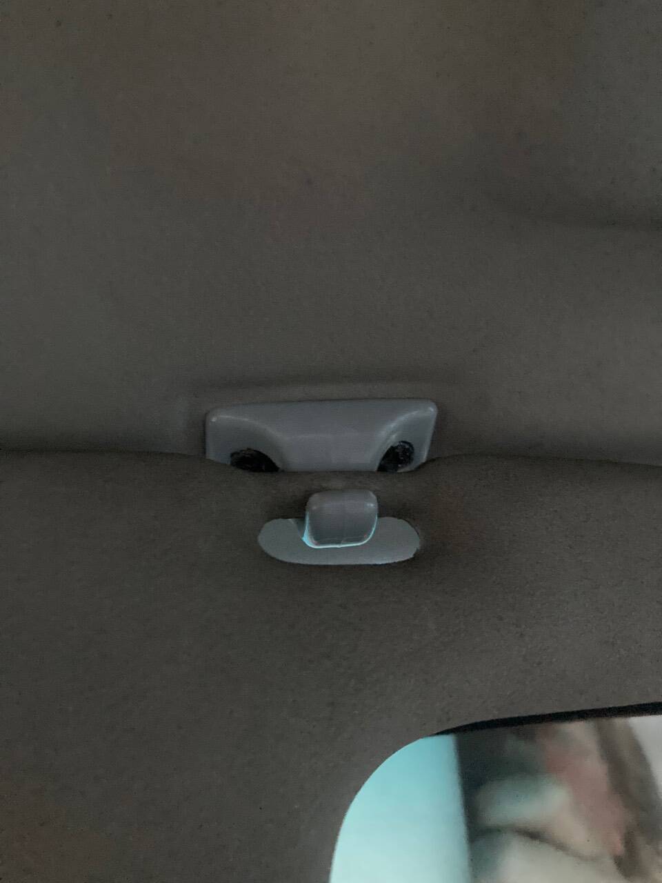

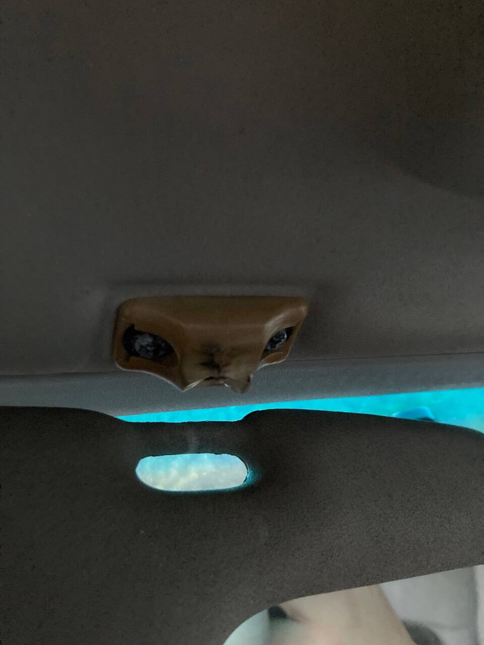

I also changed the sun visor fasteners. Available on Ebay.
IMG_4650.jpeg.8a97561a663b4c08537c4e1227c6561b.jpegIMG_4649.jpeg.dab3a9809154207de5822c1675a6a5f7.jpegI also sorted thru all the boxes that came with the car.

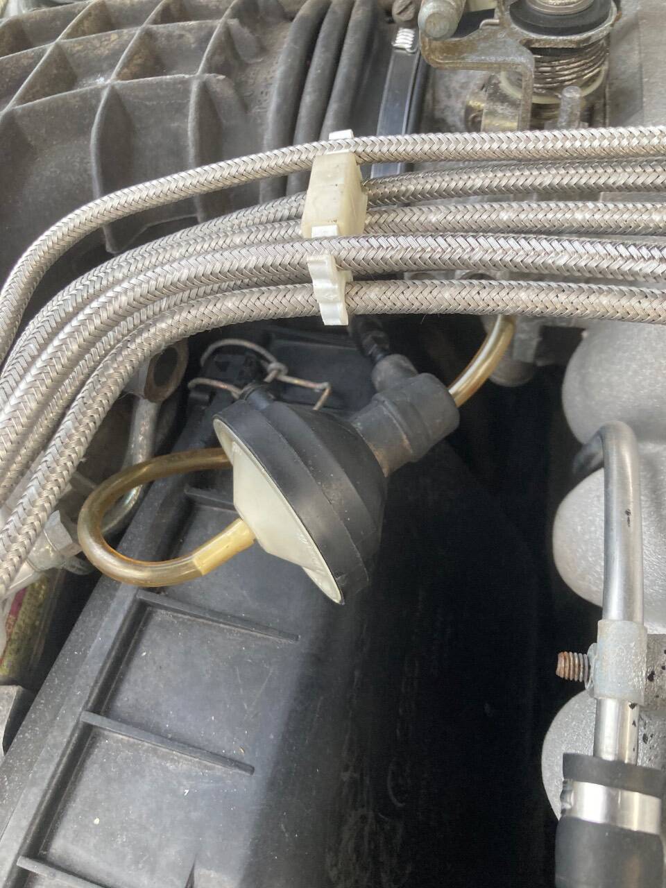

Audi 100 Turbo Diesel: treated the engine twith new oil and filter. Probably no oil change since 2016 and the engine had been subjected to quite a lot of cranking over with a wrongly adjusted diesel pump. So the oil was probably quite rich on diesel content.
As a thanks for my concern over its well being it started to leak diesel from one of the injectors and thru a high temperature warning in my face on my way home from work yesterday.
The high temperature warning came off when switching the car off and then start it again. But the car was a bit low on coolant, maybe an air pocket or it’s loosing coolant somewhere…. Just great! Diesel leakage may hopefully be from a return line. But it’s hard to tell.IMG_4708.jpeg.1b670fc39db72b12f0da27ba9cb0ed03.jpeg

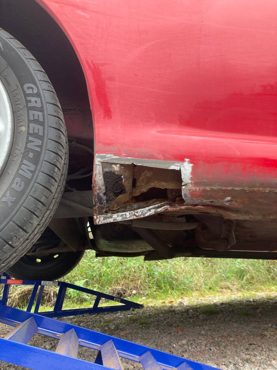

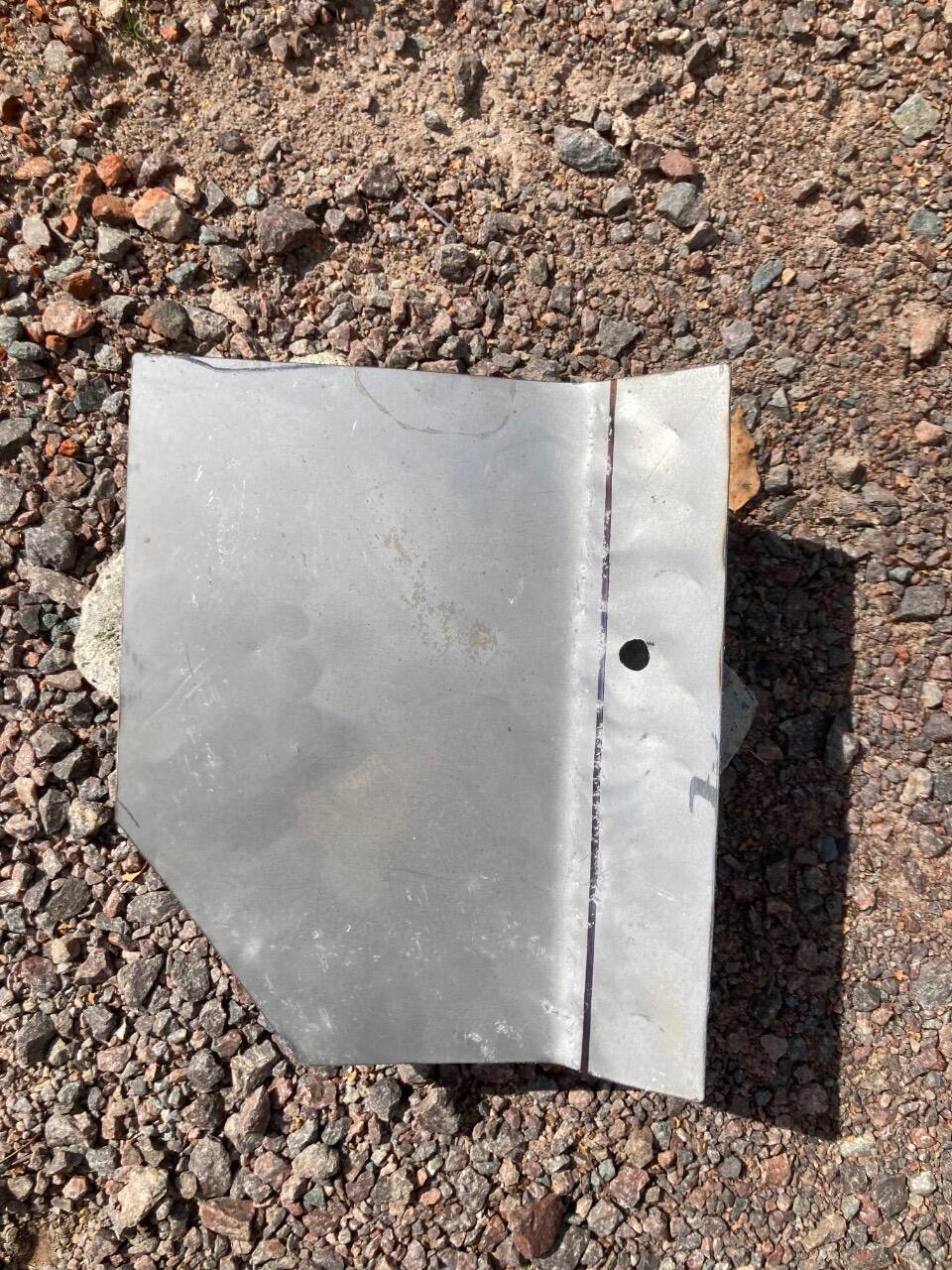

Aygo number one has a rusty sill.

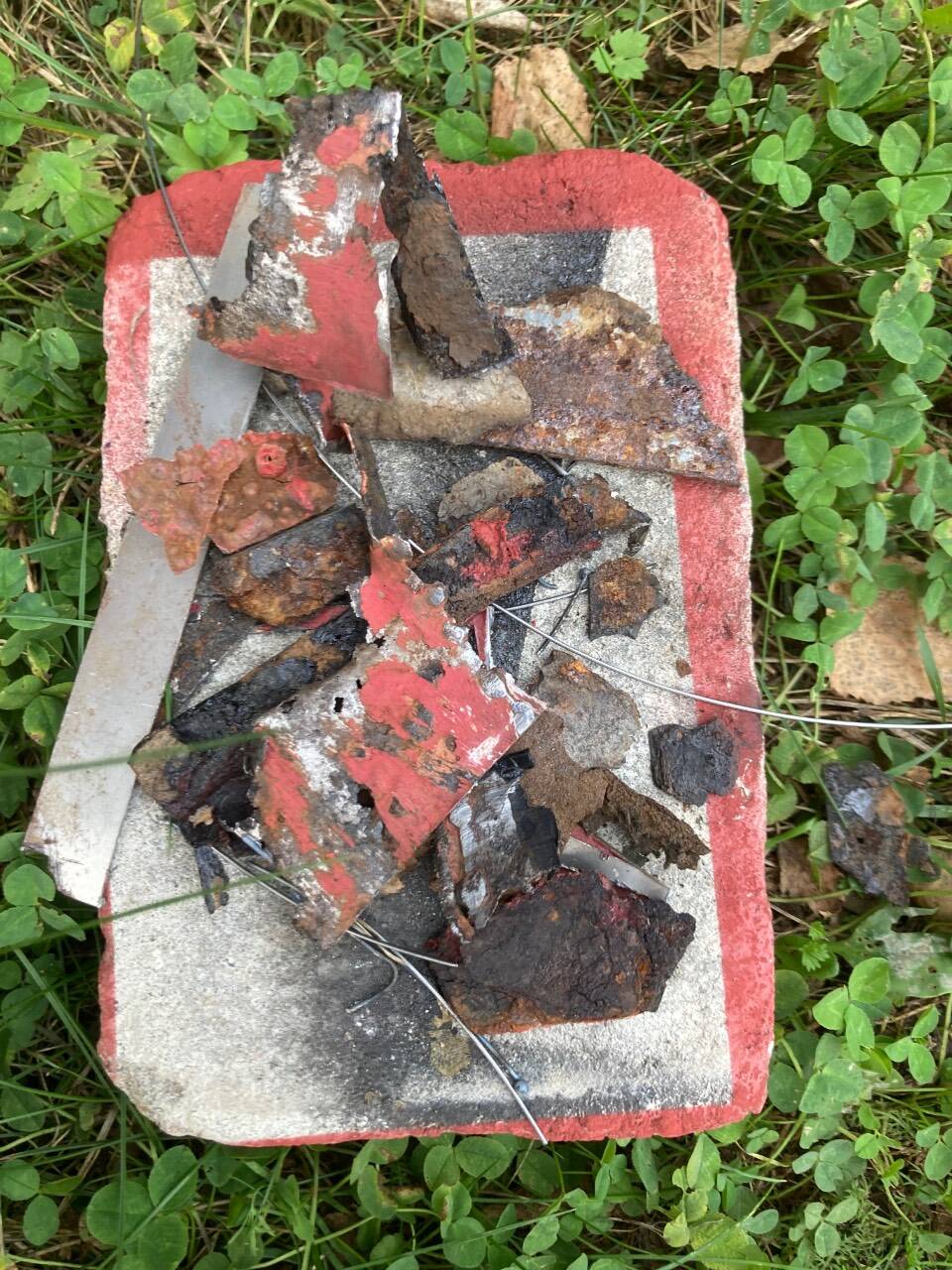

Easy fix! So I started changing the piece that is rotten. Wasn’t planning on saving the car, just wanted to give it 14 more months on the road.
After 2 hours of work and while beating the new piece of steel with a hammer a piece of the floor fell out. So I poked my finger in the new hole. Within seconds I felt the unpleasant sensation of crumbling metal, a 40 centimetre long hole had opened up. Had a poke on the other side and it’s not as bad, but bad enough…
The hole is located between the sill, the mounting point for the rear suspension and what I think is the mounting point for the rear seat. So a decision was made, I will take it in for MOT. Get one more month of driving out of the car and then scrap it and find something else 😥

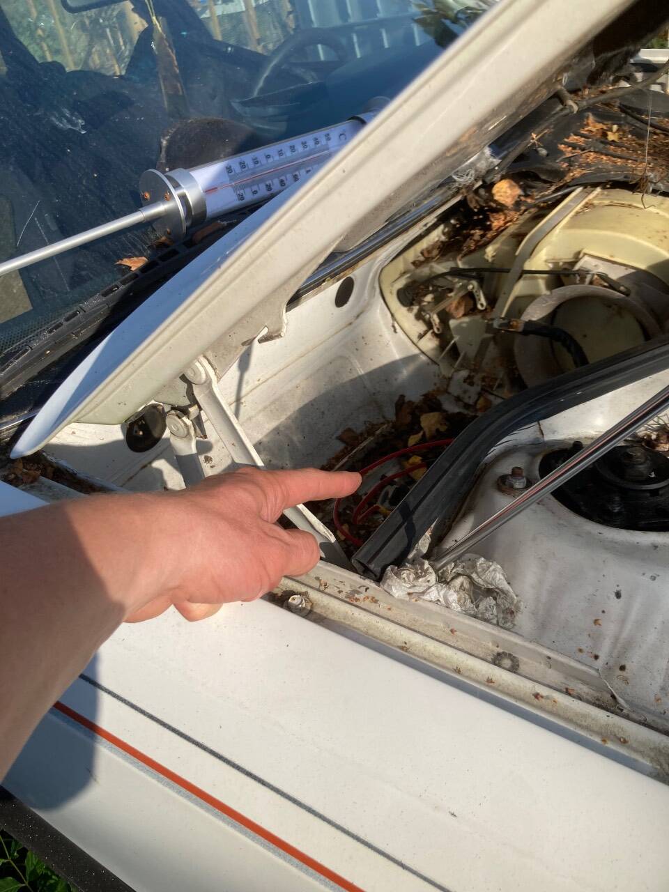

Toyota Avensis 1,8 Entry as it’s called in the papers has been put into service. But first I did try to rustproof it or at least slow down the corrosion. Drenched the undercarriage with a home made concoction and let it dry for almost two weeks. IMG_5067.thumb.jpeg.97c9b6f4c928339aa07d6a8f37d14642.jpegSince then we have done around 2500 quite boring miles. But it’s practical and I must say I quite enjoy to have a cassette player again.
