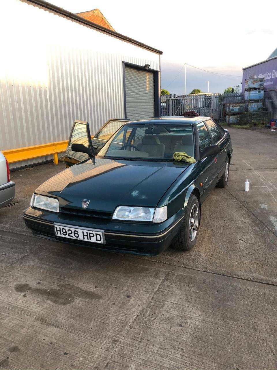

As most of you on the forum will know i own a fleet of Rovers all of which i have rescued and restored ive had all sorts of different models over the years but more recently focused my efforts on Mk1 800s. Owned about ten in total most of which were 827s of various specs with one or two 820s in the mix but ive never owned one of these.
275915390_382765193353977_4618845440686005988_n.thumb.jpg.f14a939e5cd94677f3c9a998cc13d66c.jpg
Its an 820i Fastback

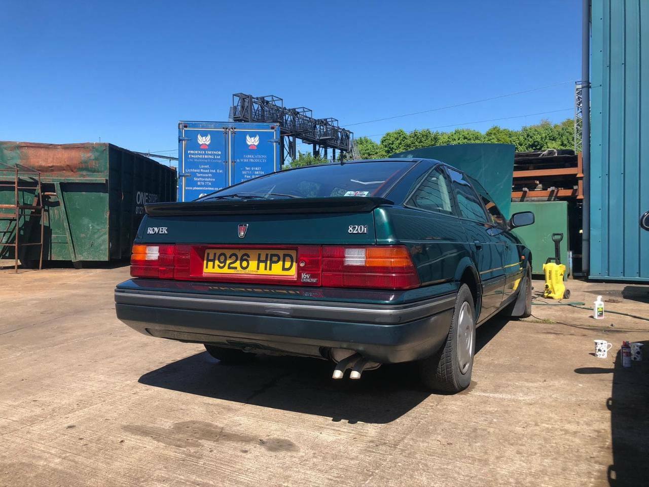

Mk1 800s are rare as a whole nowadays but the lower base spec 800s such as the E and i are even slimmer on the ground due to a large number of them being used as fleet cars back in the day. Infact i only know of two in the owners club and i am pretty sure one of them is a saloon ive also never seen one in this colour before.
275726351_356637426346182_2332818137821749718_n.thumb.jpg.08ee9033d3150d8e39bae4ad8120378d.jpg
The car has been offered to me fairly cheap and ive arrange to pick it up in April it looks to be a good solid car with it only needing a few minor things to get it through MOT. The current owner has had it for a few years now with all manner of work being done on it including an engine rebuild new exhaust system and gearbox service. However he doesn't have the time to finish it off and i suspect its grown out of favor with him as he also owns an 827 Vitesse which even i can testify is the better car.
