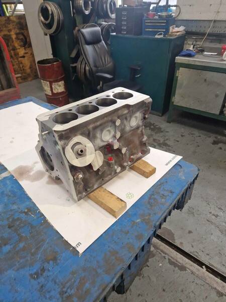

New core plugs fitted
20231208_115019.thumb.jpg.b93e2de18bb7ffc466b747b8996fb487.jpg20231208_115022.thumb.jpg.33f504e37eeeaa8a7db34856a3a3e6fd.jpgmasked (god that took a while)
20231208_130818.thumb.jpg.cc5c51bd2f35a148e1583038a5f223e8.jpg20231208_130824.thumb.jpg.9f977bbfad78ac8323f2ad13f4629a99.jpgpainted
20231208_142130.thumb.jpg.d7802b4a4da6c383c61da5a5b80eba5c.jpg20231208_142137.thumb.jpg.d23cdb0690d01b8c21d617ab4fe3cf3e.jpg

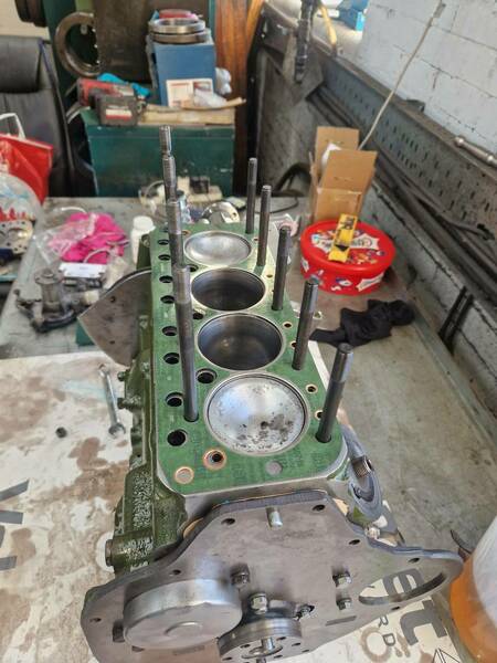

Bit of a cheat. I was 3 conrod nuts short so sumps only on with 4 bolts so I can go back in when the nuts turn up next week and finish the job.
Also no starter, alternator, dizzy as they are being taken from my current 1098. As is my complete rocker assy as it has forged rockers. So heads not pulled down yet either. My car needs to be mobile still to go to the unit to do the swap.

As an aside. For the Eagle eyed. Yes I know that the crank pulley is buggered. I will be buying and fitting a new one before use. Not much of a harmonic balancer when bits of it are missing 😕

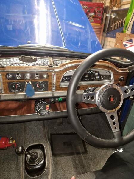

I've also started putting the tachometer in. Was going to make my own mount but a pod was only £16 from minispares so it seemed a lot of work for nowt. I've managed to get it in the car without drilling the dash shelf so happy with that. I never want to do owt to the car that can't be put back. I think it looks bloody ace. Just like I pictured it.
20231228_201312.thumb.jpg.3bfe388895ac4a5ed9360877fcd2ccb7.jpg20231228_201333.thumb.jpg.ce9eb420ef80c070734a4da82ae41d58.jpg20231228_201346.thumb.jpg.b44b0570124e3c76528cde78b713e887.jpgNot wired in yet. I've started pulling a loom through but I'm short of a few bits and I want to borrow bosses gas soldering torch.

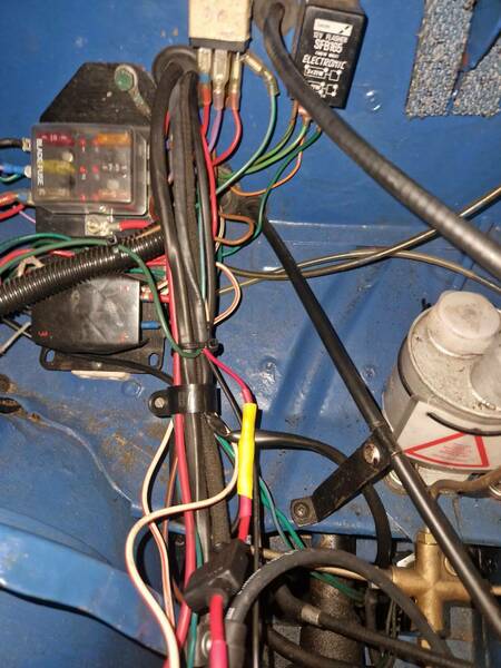

20231225_223128.thumb.jpg.b8e99f3ea6307d16ddefc0daa9fd6fa9.jpgFinally got round to putting it in the car.

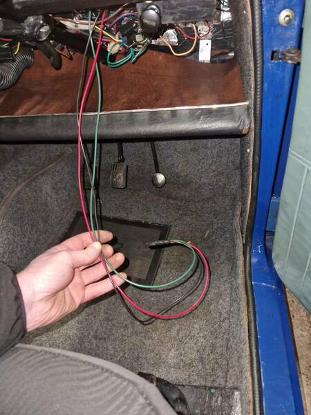

20231228_201800.thumb.jpg.2ae91580ebaa0c597e090428876e449a.jpgBit of a loom pulled through
20240106_131619.thumb.jpg.a914ef9e3980c2ec2cf83bbe88637357.jpgLoom taped
20240106_153643.thumb.jpg.71f90a63ef4d1769c2bd10749c7d22e0.jpgSafety first! Fused link made up with a 10amp blade in it
20240106_155754.thumb.jpg.811c1390a853ca226e505321f996f99a.jpg20240106_155801.thumb.jpg.8186cfff6a971a7a6630ed7eeafe1094.jpgEngine end. Fully insulated connectors and plenty of heat shrink. Still cant solder worth a wank 😄
