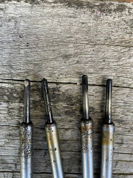

JJ0063 Posted September 16, 2022 Author Posted September 16, 2022 That was easy, heard horror stories about glow plugs snapping and seizing but all bar number 4 were easy to get out. 4 was stiff to turn but came out easy enough and in one piece Not sure if there’s such a thing as a visibly bad glow plug but here they are anyway Will have to give it a few days to see if it still does it. I will also get the battery tested hopefully tomorrow mercedade and Dyslexic Viking 2
