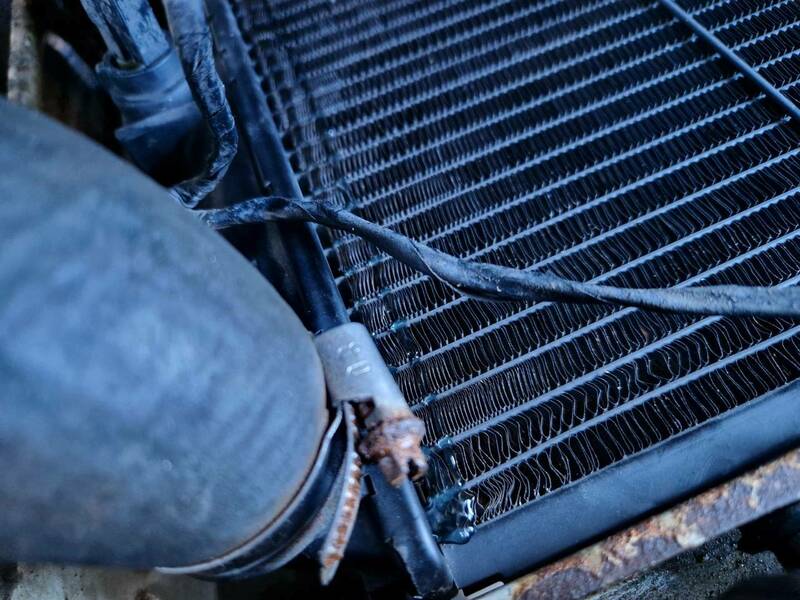

Shortly afterwards I found out why. A small puddle had gathered under the radiator.
Believe it or not, I'm counting this as Good News. I pounced on a NOS rad when one came up last year, so there's one waiting in Stores which I'll fit tomorrow.
That does mean draining the coolant again but hey, I'm nothing if not practiced at doing that now. I even filtered it through an old pair of pants last time - like a pro.

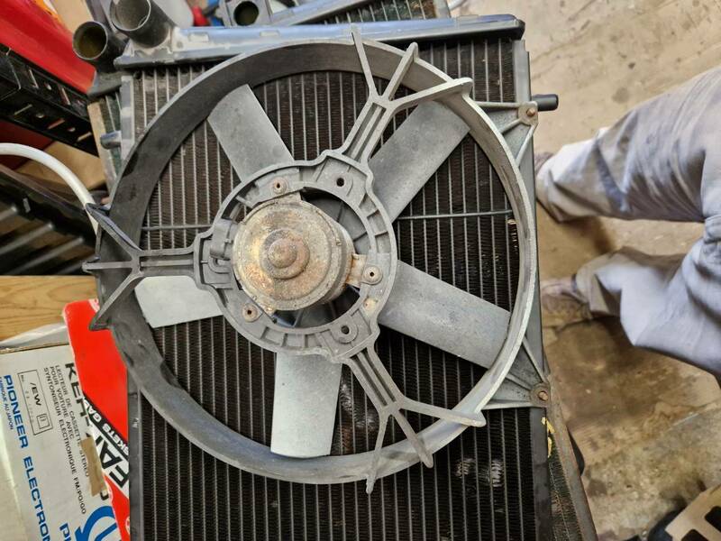

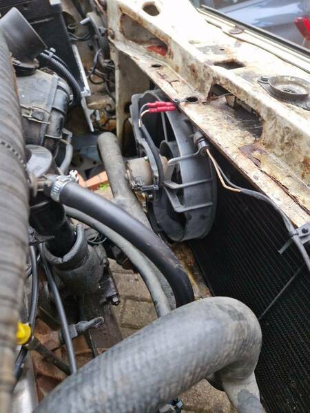

Well I dug out the spare radiator from Stores but it's totally different. Well nearly totally different.
Same width across the car. Maybe 2-3mm less depth.
More importantly the mounting bosses for the cooling fan are on the wrong side, and the mounting bosses are in the wrong place.
I decided that bodging it on was the way forwards. This involves:
1) Drilling some new mounting holes in the slam panel assembly and lower front panel. I don't really want to go butchering these but they're quite rusty anyway and you can't see the holes once it's in position.
2) Mounting the fan on the back of the rad instead of the front. I've also turned it around 120° so the connector sits more favourably.
3) Reversing polarity of the radiator electrical feed. Obviously with it on the other side I don't want it pushing against the incoming air, so my GCSE physics says swap the connections to swap the direction.
4) Clean up the mounting threads for the slam panel and the mounting screws.
5) A general spritz of Lanoguard in the areas exposed by the removed radiator. The area by the rad bottom hose is pretty crusty, I'm not poking around there yet as I'll only find holes. One for another day I feel.

  • grogee changed the title to Grogee's spannering (Puma, Maestro , Corsa & Avensis). MAESTRO RADIATOR RHUMBA
As if by magic, here it is. Undecided whether it's permanent or not. I think I'll keep it there assuming it cools sufficiently, and keep an eye out for (another) NOS unit. Or investigate the MGF option - apparently it's a similar size and can be made to fit.
Not shown in the pics but I wrapped some foam tape around the rad hose where it fouls on the motor.

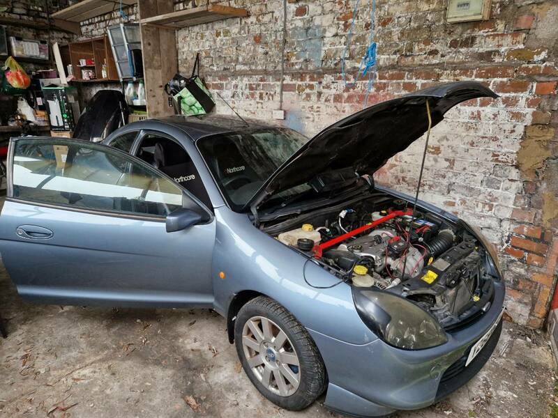

Back at base, had my tea, I'm pleased to report the Puma performed perfectly* (well as perfect as it was when I stored it six months ago).
When I first set off I convinced myself the wipers were broken but then I remembered that the bottom stalk position is 'intermittent', next one up is 'off'. Twat.
I was a bit worried about flat spots on the tyres but they seem fine, no vibration. I checked and set the pressures before setting off. There are some old-ish Pirellis on the front which are cracking, that'll probably earn me an advisory. But no money in kitty for a new pair and 2 birthdays coming up too.
The other faults I knew about including:
Exhaust blow around manifold
A few (aftermarket) radio issues
Rear washer n/s
Boot lock motor lazy (TADTS)
I've got fixes and cures for all these bits so it's just a case of finding some time to do it.

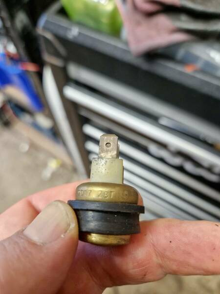

Radiator mod time.
Instead of glueing it into position I decided to do things semi-properly. The ideal way to reposition the support posts would be a TIG welder but Grogee Towers does not have one.
Next best was some DIY posts using aluminium U-section and a selection of bolts.
The good news is that I can revert to 'rad fan in front' configuration by using the original mounting holes. I can also fit the 2nd fan for maximum RACECAR points. I'm hoping the two fans run in parallel won't blow the fuse. I need to get a bit creative with the wiring but that's all doable with soldering iron and patience.
Bad news is I've got to take a brave pill and drill a 22mm hole in the plastic moulding for the fan temp switch. Amazingly I do happen to have a 22mm drill bit, but I'll be stepping up gradually and hoovering out the swarf as I go.
The 'seal' for the rad fan temp switch is a bit BL, just a rubber bung and a sort of cap that sits over it. Just hope it seals OK after my attempt to replicate the hole.
Link to comment
Share on other sites
15 minutes ago, Jenson Velcro said:
Does the switch come with a clip to help hold it in place? Is that what you mean by cap?
Kinda. It's a plastic collar that wedges under the plastic flats and pushes the sensor into the rubber bung.
