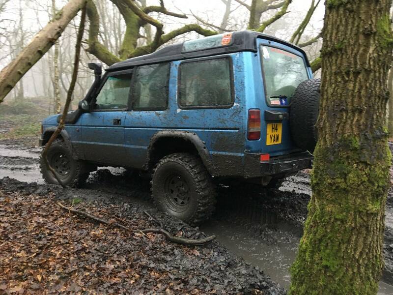

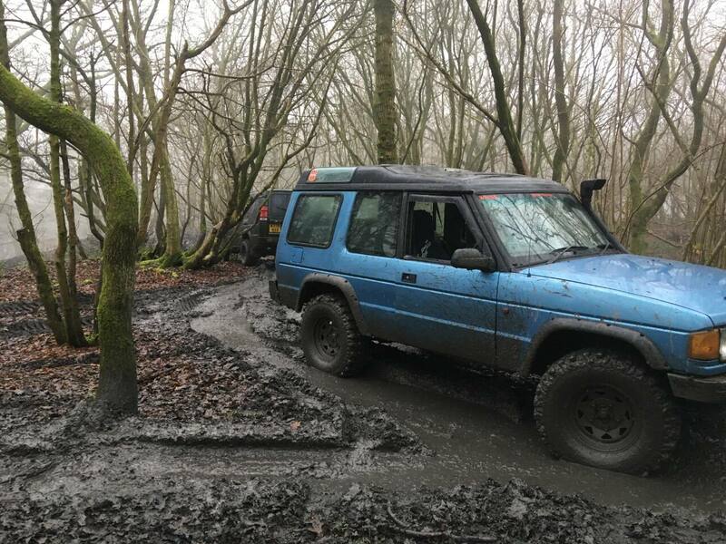

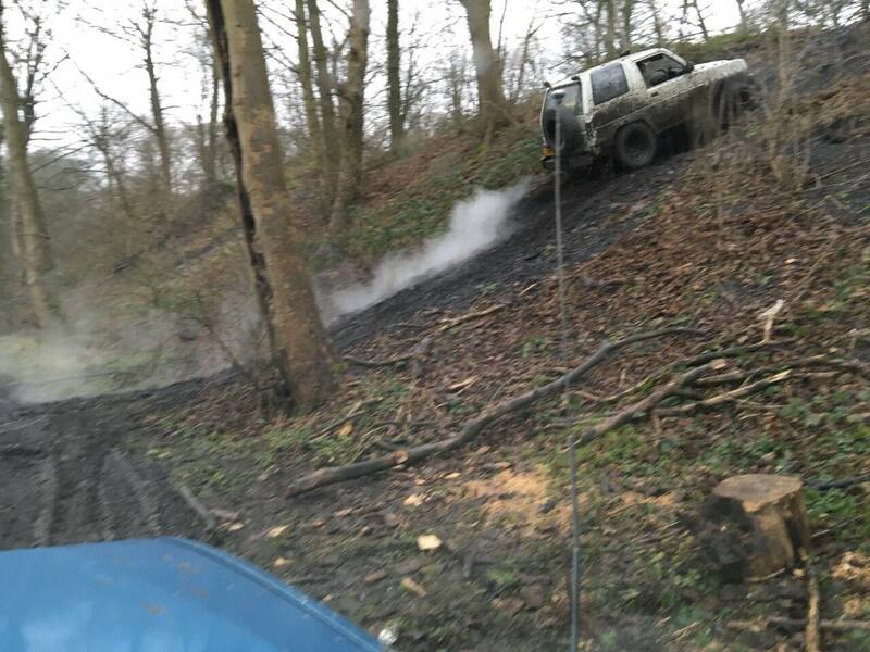

sutty2006 Posted January 16, 2022 Author Posted January 16, 2022 More discovery abuse carried out today, along with my mate in his dishatsu. Not many pictures taken as too busy driving. Winch still broken, going to buy a new one. Dan the van, Scruffy Bodger, paulplom and 5 others 8
sutty2006 Posted January 16, 2022 Author Posted January 16, 2022 1 hour ago, Dan the van said: What size tyres/lift you running?. 265 75 16 insa turbo special traks with a 2inch suspension lift, that’s all. Anti roll bars both removed for extra articulation, makes all the difference along with removing the tow bar that used to act like a plough. I’ve used Goodrich style braided brake hoses (longer) and poly bump stops, but shortened the bump stops by 50% so they don’t take the piss. Really need cranked trailing arms on the rear now as too much articulation causes the trailing arm bushes to pop out.
