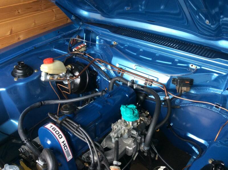

danthecapriman Posted April 17, 2022 Posted April 17, 2022 I’d concur with it being blue. I did this on my Capri’s Pinto, painted the block in black engine enamel and the rocker cover & timing belt cover in blue engine enamel, both shades from POR15 I think. They look a close enough shade to me. When you paint the rocker cover, avoid painting the inside surfaces. The paint is designed for being on a hot oily engine but I’m not sure about it being inside, if the hot oil ever did loosen the paint you don’t want it coming off and blocking oil ways etc etc. The mirror, I’d say fit one. I had this dilemma too! My Capri didn’t have one from new but I tracked down the exact right type and fitted it. It’s much safer having one than not and if you can get an original it won’t look out of place. Electronic ignition… personal preference I suppose. I was running points & condenser on my Capri and Mercury but found getting good quality replacement condenser’s was a ball ache! In the end I fitted electronic ignition to the Mercury and it massively improved running and reliability. It’s been fitted years now and has never needed adjustments or replacement. I decided to fit it to the Capri too and it starts well now, better than it did with old points. On both cars you can’t tell it’s fitted either unless you start looking hard! It’s a worthwhile upgrade imho, it’s dead easy to fit too. The points & condenser were always a weak point on old cars so if a bit of concealed modern tech can improve on them then why not!? JeeExEll, Shite Ron and Snake Charmer 2 1

danthecapriman Posted April 17, 2022 Posted April 17, 2022 I know you can’t tell 100% when it comes to colours from a photo, but here’s mine. I think it’s a close enough match. I think the POR paints do come in colours for the different manufacturers, the blue is Ford blue but it’s American paint and I’m not sure it’s the same as euro Fords? Shite Ron and DVee8 2
Wibble Posted April 17, 2022 Author Posted April 17, 2022 13 minutes ago, danthecapriman said: I know you can’t tell 100% when it comes to colours from a photo, but here’s mine. I think it’s a close enough match. I think the POR paints do come in colours for the different manufacturers, the blue is Ford blue but it’s American paint and I’m not sure it’s the same as euro Fords? Bloody hell that looks good! danthecapriman 1

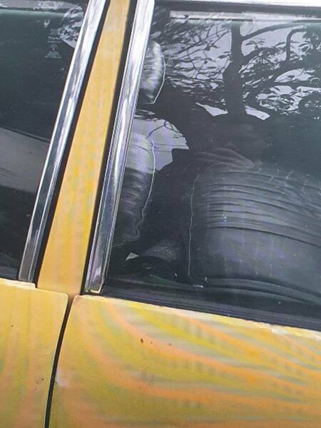

wesacosa Posted May 9, 2022 Posted May 9, 2022 I was back in Hull for first time in ages. The infamous yellow Cortina is still there. I would love to know the story on this uk_senator, danthecapriman, Dyslexic Viking and 4 others 7
Shite Ron Posted May 9, 2022 Posted May 9, 2022 20 minutes ago, wesacosa said: I was back in Hull for first time in ages. The infamous yellow Cortina is still there. I would love to know the story on this I would also be interested in more information and pictures of this car. I assume by it being on the road that it is still in use? It is great to see a Cortina in this condition still being used as it should be. I would love to see pictures of the interior as I believe the early mk4’s in Signal yellow had the option of green interior which would be fantastic.
wesacosa Posted May 9, 2022 Posted May 9, 2022 1 hour ago, Shite Ron said: I would also be interested in more information and pictures of this car. I assume by it being on the road that it is still in use? It is great to see a Cortina in this condition still being used as it should be. I would love to see pictures of the interior as I believe the early mk4’s in Signal yellow had the option of green interior which would be fantastic. I seem to remember it being brown. Its sat in the same spot for as long as I can remember (at least 15 years maybe more). I never saw it move but I have not lived around there for 20 years) I wonder if its just sat there since it went tax exempt (its a 1977) I think @Eyersey1234has also seen it so maybe he remembers more EDIT: Did you still need an MOT to tax exempt? I know its MOT exempt now but it wouldn't have been until recently and would be amazed if its been kept MOTd Eyersey1234 and Shite Ron 1 1

wesacosa Posted May 12, 2022 Posted May 12, 2022 On 5/9/2022 at 12:09 PM, wesacosa said: I was back in Hull for first time in ages. The infamous yellow Cortina is still there. I would love to know the story on this Found out a bit more info Its not MOTd but was up to 2019( I guess when it went MOT exempt). It is taxed. It seemed to do a few hundred miles per year until 2019 and is only showing 45k , unless its been around the clock. The leaves around under the car when I passed last week suggest it hasn't moved for a while. Could possibly have the green interior Dyslexic Viking, cbowditch, uk_senator and 1 other 3 1
Wibble Posted May 12, 2022 Author Posted May 12, 2022 That’s fantastic @wesacosa! Sounds like it’s still possibly in use and does indeed look to have the green interior. Last time I saw a Cortina in that condition still in use, was in the Republic of Ireland, before they introduced their MOT equivalent😀 wesacosa 1
