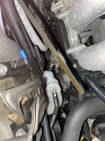

Wibble Posted February 13, 2023 Author Posted February 13, 2023 Thought I’d better give mum’s car a quick check whilst I’m here and check the oil level: The only place to have checked this is the main dealer that serviced it. Dad wasn’t able and there is no oil here for him to have used to over fill it anyway. Anyone think this is so much as to cause a problem? I have no tools with me so can’t do much about it now anyway. Despite it doing less than 2000 miles a year, he still got it serviced every year at a main dealer. I was going to tell mum not to bother this year but now feel this really should be corrected.
danthecapriman Posted February 13, 2023 Posted February 13, 2023 That does look a fair bit over filled tbh. Can you get to the oil filter? Maybe (carefully!) remove that and pour the excess oil out? Might need to do that, then run it, turn off and take full filter off again a few times though to get enough excess oil out!! Failing that it’s probably easier to just go buy a cheap adjustable spanner and whip the sump plug out quick, let it drain into cut open milk bottle or something. Or you could stick a thin tube down the dip stick tube and start sucking!😆 Ohdearme 1
Wibble Posted February 13, 2023 Author Posted February 13, 2023 8 minutes ago, danthecapriman said: That does look a fair bit over filled tbh. Can you get to the oil filter? Maybe (carefully!) remove that and pour the excess oil out? Might need to do that, then run it, turn off and take full filter off again a few times though to get enough excess oil out!! Failing that it’s probably easier to just go buy a cheap adjustable spanner and whip the sump plug out quick, let it drain into cut open milk bottle or something. Or you could stick a thin tube down the dip stick tube and start sucking!😆 🤣I’ve already said we need a long straw. I’ll have a look tomorrow, must be something here I can drain a bit into and I seem to remember dad’s “comprehensive” tool kit might include an adjustable. Cheers Dan👍 danthecapriman 1
danthecapriman Posted February 13, 2023 Posted February 13, 2023 2 minutes ago, Wibble said: 🤣I’ve already said we need a long straw. I’ll have a look tomorrow, must be something here I can drain a bit into and I seem to remember dad’s “comprehensive” tool kit might include an adjustable. Cheers Dan👍 I accidentally overfilled an auto gearbox once and needed to drain some fluid out, no drain plug either so I fed a length of screen wash pipe down the dipstick tube and stuck a big old plastic syringe on the end and used that to suck oil out. Slow but did the job! Low Horatio gearbox 1
Wibble Posted February 13, 2023 Author Posted February 13, 2023 Lol, that was going through my mind as I have some at home! I’ll have a rummage about tomorrow and hope the sump plug isn’t unreachable as I don’t have jack or stands. Filter might not be a bad idea if also accessible. Knew I should have brought tools🤦♂️ danthecapriman 1
adw1977 Posted February 14, 2023 Posted February 14, 2023 Can't say I'm surprised. A friend got her car serviced at a Vauxhall dealer and it turned out they failed to drain the old oil, just added the required quantity of fresh oil, so it had roughly twice as much oil in as it should have. Having admitted their mistake, they still tried to claim that the blown seals were unrelated! GrumpiusMaximus, Shite Ron, danthecapriman and 2 others 5
Wibble Posted February 14, 2023 Author Posted February 14, 2023 Bloody hell that’s shocking! I’ve drained a bit off mum’s now via sump with an adjustable. A bit messy but did the job. She’s going to get it serviced anyway as it has spent most of the last year parked up but it won’t be done next year and being honest, I think her driving days are numbered.

New POD Posted February 19, 2023 Posted February 19, 2023 On 13/02/2023 at 16:52, Wibble said: Thought I’d better give mum’s car a quick check whilst I’m here and check the oil level: The only place to have checked this is the main dealer that serviced it. Dad wasn’t able and there is no oil here for him to have used to over fill it anyway. Anyone think this is so much as to cause a problem? I have no tools with me so can’t do much about it now anyway. Despite it doing less than 2000 miles a year, he still got it serviced every year at a main dealer. I was going to tell mum not to bother this year but now feel this really should be corrected. You need the Lidl 12v oil pump. 20 seconds and you'd have that sorted.

GregZX Posted February 20, 2023 Posted February 20, 2023 On 2/19/2023 at 6:25 AM, New POD said: You need the Lidl 12v oil pump. 20 seconds and you'd have that sorted. It’s brill isn’t it? I’ve done 3 oil changes so far with mine. I reckon I’ve saved about £150 in garage labour costs so far.
