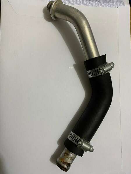

Wibble Posted December 6, 2022 Author Posted December 6, 2022 I suppose I should laugh really as, just when I thought the Senny was about ready for the road again, it’s thrown me another challenge. Water pump is done and heater matrix replaced when one of the feed and return pipes started pissing coolant. Of course these are also unobtainable: I’m now thinking of ways to repair the multiple holes or make up a replacement in copper maybe. I do so love* these problems😕 AnnoyingPentium, Shite Ron, Dyslexic Viking and 1 other 4
Bren Posted December 6, 2022 Posted December 6, 2022 16 minutes ago, Wibble said: I suppose I should laugh really as, just when I thought the Senny was about ready for the road again, it’s thrown me another challenge. Water pump is done and heater matrix replaced when one of the feed and return pipes started pissing coolant. Of course these are also unobtainable: I’m now thinking of ways to repair the multiple holes or make up a replacement in copper maybe. I do so love* these problems😕 Brazing?
Wibble Posted December 6, 2022 Author Posted December 6, 2022 7 minutes ago, Bren said: Brazing? That’s one option I’m considering but am seeing mixed reviews on the aluminium brazing kits. Really want it to be a permanent solution, or at least another 30 year fix!
Wibble Posted December 7, 2022 Author Posted December 7, 2022 Brazing is no longer an option. The pipe melts before the aluminium brazing rod, as I discovered today. I did email GM6 spares and they thought they’d be able to supply replacements but they’ve just confirmed they only have ones for air con equipped cars, which are different. I feel another long winded battle coming on which I could really do without. Dyslexic Viking, AnnoyingPentium and Shite Ron 3
Wibble Posted December 7, 2022 Author Posted December 7, 2022 Well I’m going to try with copper pipe. It’s getting the shape right and I’m not sure what tool you need to make the bubble like flare on the ends that are in the top of the photo. I’m sure a good plumber could knock some up but I don’t know one. Dyslexic Viking and Shite Ron 2
High Jetter Posted December 7, 2022 Posted December 7, 2022 Maybe use an olive, if there's a nut that tightens the shoulder onto the fixing?
Wibble Posted December 7, 2022 Author Posted December 7, 2022 1 hour ago, High Jetter said: Maybe use an olive, if there's a nut that tightens the shoulder onto the fixing? Thanks but there’s no nut. Think I need a bead roller to form the pipe end that attaches to the hose from the engine bay and maybe solder a suitable washer to clamp the other end to the matrix. Fun times ahead I think.
danthecapriman Posted December 7, 2022 Posted December 7, 2022 Couldn’t you use an off cut of radiator or heater hose to sleeve the metal pipe with? Slide the hose over the holed section then tighten a couple of hose clamps at each end to make it water tight? Might at least be a temporary solution until you can find replacement pipes. uk_senator 1
Wibble Posted December 7, 2022 Author Posted December 7, 2022 That’s along the lines I’m thinking but would rather a more permanent solution if I can but it may come to this! danthecapriman 1
Wibble Posted December 8, 2022 Author Posted December 8, 2022 I contacted a company today who say they can repair or replicate any air con pipe and asked if the could help. Yes, they said they could repair for around £250+VAT but to make replicas would be around £2500! Cool, better order an extra set for spares too!! After more thought I’m thinking of cutting off damaged section just above the 60 degree bend and replacing with a silicone hose 60 degree elbow. I’ll then use a piece of 15mm copper pipe, with an compression olive fixed each end to act as a bead and stick that in the elbow to secure to hose from bulkhead. A few jubilee clips and I reckon job jobbed. AnnoyingPentium, Shite Ron, Dyslexic Viking and 1 other 4
Jenson Velcro Posted December 8, 2022 Posted December 8, 2022 Are air conditioning pipes a universal size across different makes and models of cars? The end shape certainly looks familiar. If so can you get pipes from a different car and cut and bend to suit? Aluminium should be reasonably easy to shape even if you have to anneal it first.
Wibble Posted December 9, 2022 Author Posted December 9, 2022 I have trawled the internet looking for similar to modify but found nothing with same ends. Even Vauxhall/Opel don’t seem to have another model using same fittings each end. That’s why I’ve come to the plan above but I’m no engineer and someone could probably do better but I’m hopeful this will work, subject to there being enough space to accommodate the thicker silicone hoses. Jenson Velcro 1
Wibble Posted December 9, 2022 Author Posted December 9, 2022 On 12/7/2022 at 10:51 PM, danthecapriman said: Couldn’t you use an off cut of radiator or heater hose to sleeve the metal pipe with? Slide the hose over the holed section then tighten a couple of hose clamps at each end to make it water tight? Might at least be a temporary solution until you can find replacement pipes. Actually, you’re right. I’m over complicating it and will try this as should be simple. Thanks! danthecapriman 1
danthecapriman Posted December 9, 2022 Posted December 9, 2022 22 minutes ago, Wibble said: Actually, you’re right. I’m over complicating it and will try this as should be simple. Thanks! I’ve done a similar thing before with a weeping rusted power steering metal pipe, I used a short length of fuel injection hose slid over the rust hole and a couple of jubilee clips each end to hold/seal it tight. I also ran a bit of blue hylomar instant gasket around the metal pipe before sliding the rubber hose over it, just as extra insurance against leaks. It never leaked ever again! Shite Ron, Wibble and AnnoyingPentium 3
New POD Posted December 10, 2022 Posted December 10, 2022 10 hours ago, danthecapriman said: I’ve done a similar thing before with a weeping rusted power steering metal pipe, I used a short length of fuel injection hose slid over the rust hole and a couple of jubilee clips each end to hold/seal it tight. I also ran a bit of blue hylomar instant gasket around the metal pipe before sliding the rubber hose over it, just as extra insurance against leaks. It never leaked ever again! I was about to suggest something similar. Wibble and danthecapriman 2
Wibble Posted December 12, 2022 Author Posted December 12, 2022 Hopefully this will sort it: 🤞 mercedade, danthecapriman, Bren and 4 others 7
High Jetter Posted December 12, 2022 Posted December 12, 2022 Looks up to the job. Are the clips stainless steel?
Wibble Posted December 12, 2022 Author Posted December 12, 2022 14 minutes ago, High Jetter said: Looks up to the job. Are the clips stainless steel? Good question, I have no idea so I guess I’d better keep an eye on them.
High Jetter Posted December 12, 2022 Posted December 12, 2022 I haz my doubts. Mebbe worth doubling up to be on safe side.

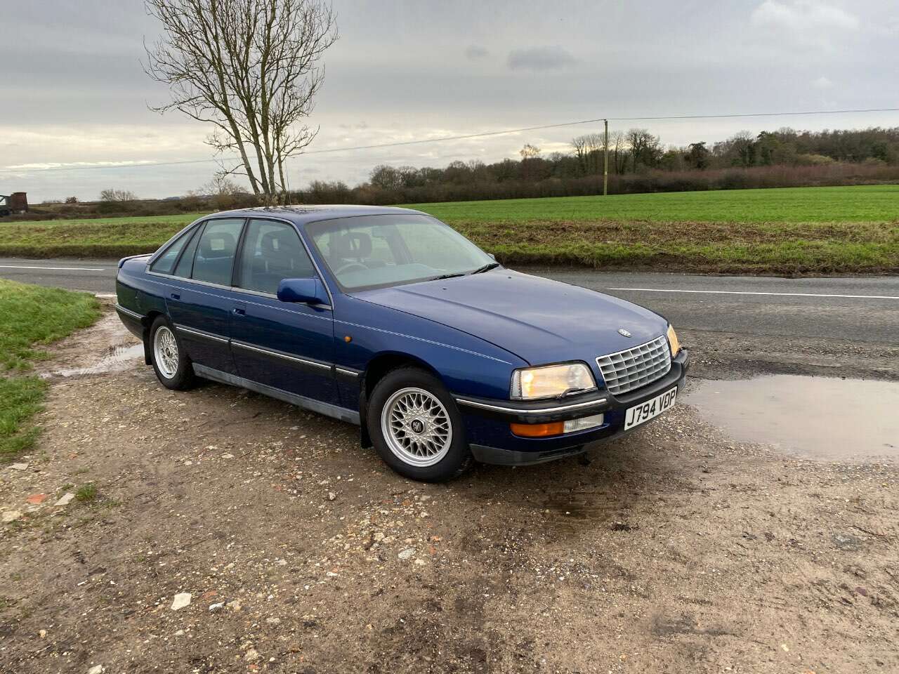

Wibble Posted January 14, 2023 Author Posted January 14, 2023 Delighted to have the Senny back with the straight 6 sounding sweet again with the noisy water pump replaced. Warm inside too, without steam! Have been using it today for normal duties and intend it to be my weekend car until spring, subject to extreme weather: Pleased to find the radio still working and it’s playing cassettes without eating them, so far! Driving beautifully, a good day today🙂 adw1977, cbowditch, Dick Cheeseburger and 14 others 17

danthecapriman Posted January 25, 2023 Posted January 25, 2023 On 1/14/2023 at 6:59 PM, Wibble said: Delighted to have the Senny back with the straight 6 sounding sweet again with the noisy water pump replaced. Warm inside too, without steam! Have been using it today for normal duties and intend it to be my weekend car until spring, subject to extreme weather: Pleased to find the radio still working and it’s playing cassettes without eating them, so far! Driving beautifully, a good day today🙂 Somehow I missed this post. That sir, is a damn fine looking automobile! Shite Ron and AnnoyingPentium 2
Wibble Posted January 25, 2023 Author Posted January 25, 2023 46 minutes ago, danthecapriman said: Somehow I missed this post. That sir, is a damn fine looking automobile! Thank you very much indeed sir. We’ve been together a long time now! AnnoyingPentium and danthecapriman 2
