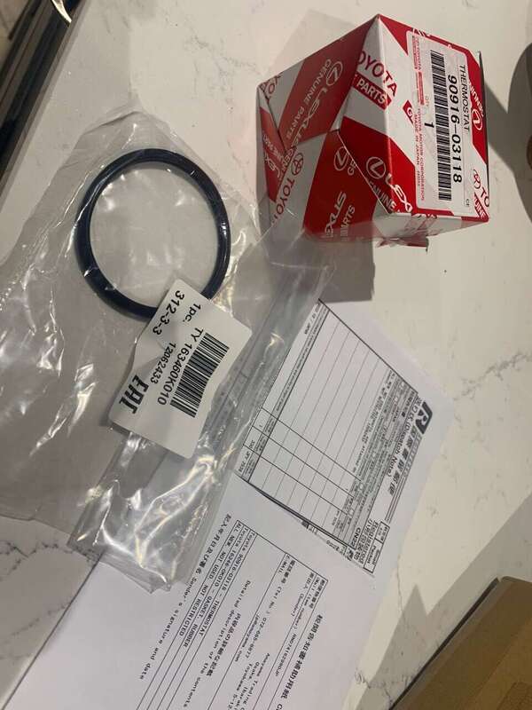

Thermostat arrived today.
All the way from Osaka. Quite, quite cool.
Saturday morning I’ll swap it over, along with with oil, filter and fuel filter changes.

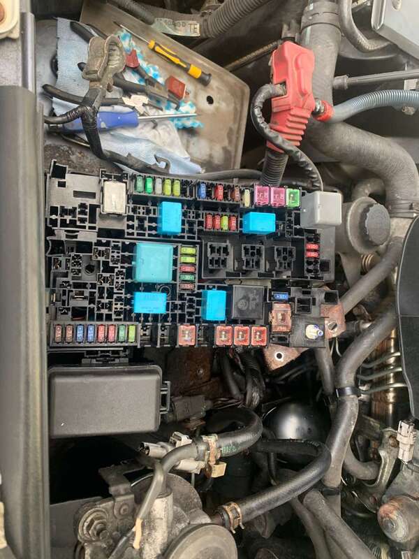

So the RAC man got a bit stumped as when he plugged the OBD2 in it wouldn’t work. Fuck all power to it. Fuck all power to the windows.
He found this.
That is a 140A fuse I’ve managed to blow.
And it looks like that because we couldn’t get it off. Having a read of it now, to remove it you need to take the fuse board out completely apparently.
I think its a Toyota only part and its about £30.
I've had a Google and it seems to be yet another cunt job with the fuse box out. But I'm still reading.
I am also hoping nothing else has gone bang!!!
Edit: Rush order, will be here tomorrow.

I'm sat here thinking there is not one of the above jobs that have been straight forward. Every job has been a cunt. Oil changes are a cunt. But though not as big of a cunt of a job as the thermostat. I can't think of an easy job on this car that makes it easy to do. Can you? I can't.
But I'm writing this on the back of changing the 140A fuse in the fuse box. Guess what type of job it is? What's that Danny Dyer? Did you say cunt? Then you're right mukka. It is indeed a cunt of a job. I have, maybe, broke the fuse box case in an attempt to free it off but that is all irrelevant. The fuse is in place. Helpfully two (not one) two bolts go through the fuse. Even more helpful is that the one facing the outside towards the fuse box case is a 10mm head, the inboard one? 8mm. Took a few minutes to work that out.
Outboard 10mm.
Inboard 8mm.
Space.
The fuse was replaced, started first time. Kept an eye on the engine as amazingly we've not burped it yet (although it has already swallowed one 5 litre jug). Little sticker on the cowling saying get the engine warm, then let it cool down and make sure the coolant is between low and full. I drove it around, it is slow to warm up so gave it a blast of the auxiliary heater first but then took it for a spin. Temp gauge got to half way without the heater on. I put the heater on and it dipped a little, turned the heater off just to make sure it didn't go north of half way (it didn't). Put the heater on MAX HEAT and drove a little bit. It's kicking out time for schools here so I was sat in traffic, heat was still hot. Got home and left it for a bit, heat was still hot at a stand still.
