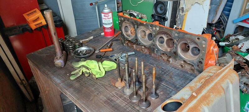

I've lost my valve spring compressor. Improvised with a G clamp but I need to make a cage for the top.
It then started to rain so I packed up and head in, out of energy.
Need new manifold gaskets.
Bought a tool at AutoZone because I couldn't find mine.
Valves all out, I'll start cleaning it up another night.
  • Like 6
Clean up commence. These valves are seriously ropey. The sealing faces were also all burned and I'm surprised I had any compression at all. They recieved a do-or-die reface and will be lapped into the seats.
Fun times

To my surprise, they all lapped in well.
That's that one done.
One more to go.
You can see how badly the valve faces were burned, with a gentle skim the divot is left behind. Easily two thou'.
Taken back down to flat.
And repeat.
I'll do the intake valves tomorrow.
Also, please note this isn't a permanent repair thing.
This engine is so far beyond trashed it's just to get it running. When I tried it before the compression was so poor all it would do was pop and burp a little. I had enough compression on only two cylinders to even make the starter motor labor.
In normal running now I would expect a couple thousand miles out of those valves at best.

This valve, stored underwater, didn't fare well.
It did clean up and I'm claiming now it's a performance part based upon golf ball physics; the pattern of dimples helps break up the boundary layer and allows for better gas flow.
Some were better than others. That can go together if time allows.

Still, managed to clean up the cylinder head. Next up, lapping in the valves.

That last valve would concern me, the pits are really deep and the head dropping off would spoil your day. Good shade tree mechanicking all the same.
That's all this is, yup.
I picked down into the pits and the camera made them look worse than they are. That's the intake valve so hotspots are less of a concern.  If the exhaust valves looked like that I would agree more.

Lapped in the valves, it got a bit late to be running the generator so I packed up and will refit the springs tomorrow.
