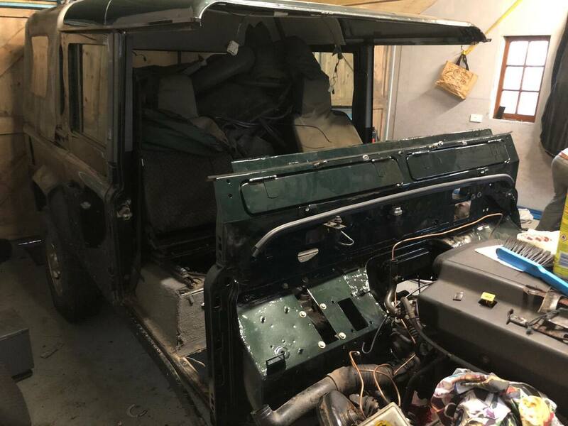

Then I popped around to a mate’s house where we are doing some major automotive surgery, changing the bulkhead on a Td5 110 crewcab. This is the galvanised replacement below,
The bulkhead on these is a lightweight largely single skin pressing. It wasn’t actually as much work as I thought to change it and it was interesting to see how similar the design was to say a late Series 3 Landrover of the early 80s. That said, a major issue was the amount of wiring, I can’t believe how much this needs compared to its predecessors. At least it’s all in multi plugs not bullet connectors.

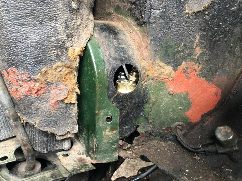

My Landrover had mysteriously gained a brake fluid leak somewhere. A dribble of fluid down the inside of the n/s front wheel gave me a fair indication that this was the offending article (the only wheel cylinder I hadn’t changed). I’ve bought a new wheel cylinder and also found a nice new flexible hose to go on.
Before I did this I also noticed that it was becoming increasingly difficult to change gear. Adjusting the clutch linkage didn’t improve matters and the clutch slave cylinder seemed  a bit stiff, so I thought I’d change this first. You can change this without taking the driver’s side floor up but I thought I’d make things easy for myself. The actuating rod for the clutch was on the wonk but still adjusted ok. All back together and bled through with my vacuum bleeding kit and it seems much better. Doing jobs under a Landrover in the winter is to be avoided so I was glad to sort this so easily.

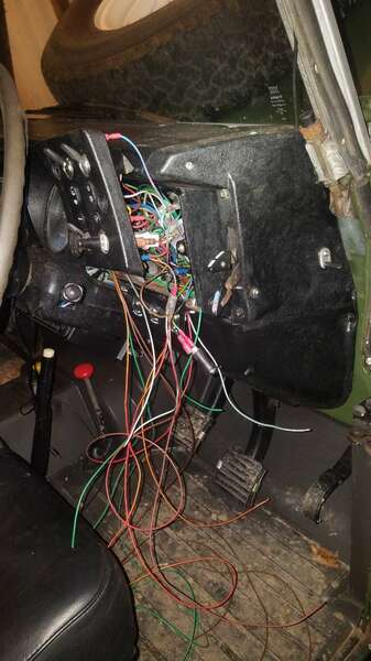

Just 2 years of amateur repairs and additions! I've added things like a fog light, HRW and rear wiper, as well as replaced a few of the spade terminals behind the dash.
That said, I'm following the route of the original loom, and matching the Land Rover wiring colours. The wiring behind the dash still looks very haphazard though!
My dad has designed a quick release system for the dash on his Series 3 so he can remove it quickly in case of a unexpected electrical fire.

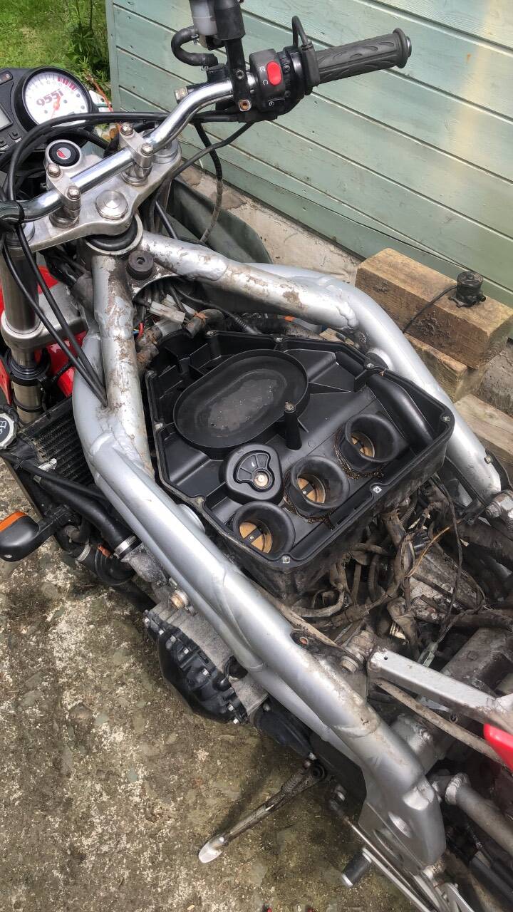

Undeterred I turned my attention to the main issue with the bike, very poor starting. I decided that I’d give it new plugs, air and fuel filter which involved removing the tank and air box.
The air filter was absolutely filthy so it was worth doing just to replace that. Removal of the air box allowed access to the plugs so I decided to renew them too (something often neglected on old bikes).
The fuel filter was located in the tank and accessed via a massive access plate on the side. I decided (having obtained a new one for a good price) to replace the pump and screen filter as well whilst I was in there.
Once the new in-line filter arrives it can all go back together. The plastic tank really needs rubbing down and re spraying but I’ll leave that for another day. Hopefully all this will improve the starting and performance.

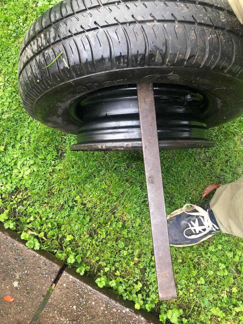

To remove the tyre altogether you now slide the lever across the wheel and under the lip of the rim.IMG_3119.jpeg.595ddf9741fd43ff073a9a572563e388.jpeg
You then pull the tyre slightly off the wheel with the lever to put pressure on the bead. You may need to lube the rubber (giggety).
You need to hammer the tyre near the rim to knock it off the wheel. NB I couldn’t find my lump hammer so I had to improvise (don’t do this).

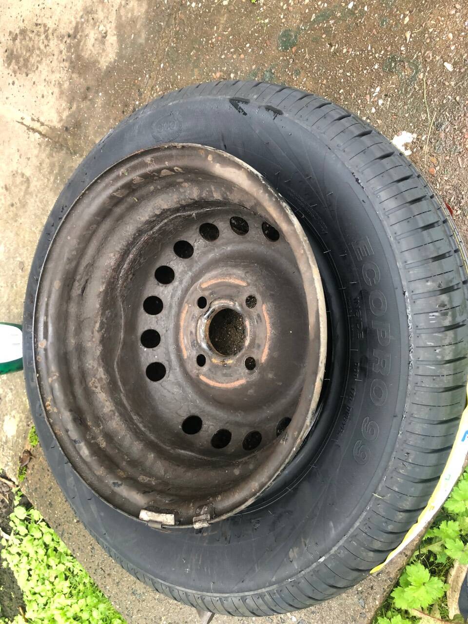

Check the new tyre is the right way round (inside upwards in this case) and wedge the wheel into it. Then use a single lever to wangle it on. This is usually quite easy.
The tyre is now on one bead. Time to flip it over and finish it off…
Start the tyre, then stand on one side to stop it slipping off.
I normally get so far then use both feet.
All fitted (took about ten minutes). I did realign the red spot to where the valve is.
These took ages to refit on the bead. I had to liberally lubicrate the wheel and tyre, remove the valve core and then gently revolve the wheel whilst adding air and squishing it up and down to get it moving on the beads. Mind your fingers. One took about 10 minutes before it suddenly started moving.
