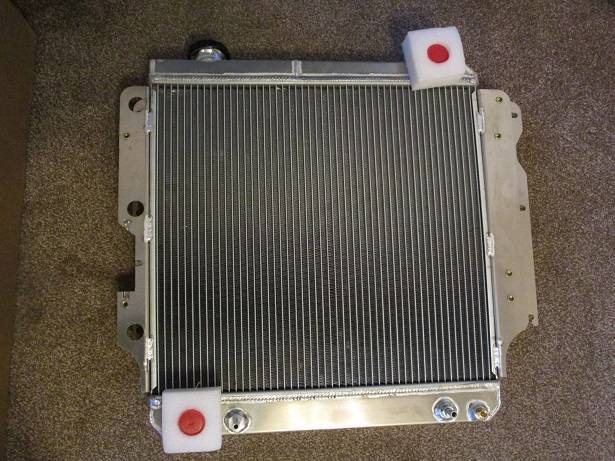

I could have got a cheap rad with plastic tanks for about £70, but I've had bad experience with those in the past. Decided to go all-aluminium instead (£160). It claims 30% better cooling than the stock rad.

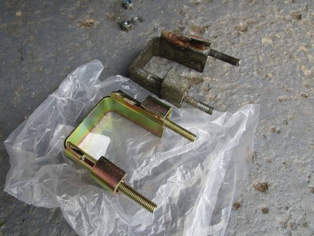

The rear track bar has been knocking the entire time I've owned the Jeep. According to the internet, I don't need it. So, while the coolant drained, I got the track bar out and binned it. I've been for a drive since and didn't notice any difference (other than the rear end being quiet!).
I didn't want to waste the coolant as it's barely six months old, so put it through a fuel filter like I did last time. Works very well - the coolant looks new after being filtered.
Right, back to this radiator. It was supposed to be direct fit. It wasn't.
One of brackets fouled a power steering hard line, so I had to shave the bracket with a grinder. The fan cowling is now held on with zip-ties because none of the bolt holes line up. Ditto the power steering reservoir bottle as the mount faces a different direction. Not impressed.

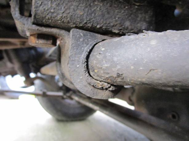

Ordered sway bar bushes as well. The existing bushes weren't causing an issue, but looked a bit knackered.
before:
After:

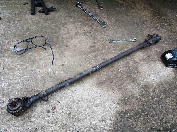

Next issue was the steer wheel - it's off centre and that annoys me.
There's a rod (don't know what it's called) that connects to the steering box pitman arm. You can set the steering wheel position by adjusting the length of this rod. In theory, once you loosen the locking clamps, you should be able to twist the rod (which is threaded at both ends) and adjust the length. As expected, it was rusted solid and had to be removed entirely.
After a torture session in the bench vice with a blow torch, I got everything freed up. The joints weren't loose, so I just replaced the boots and re-greased them.
I think I have it centred now. At least I can adjust it easily if I need to.

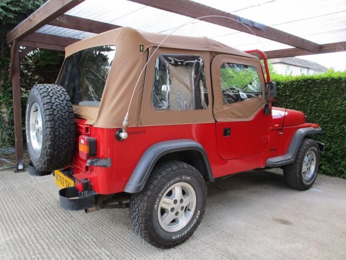

Lasting thing on the Jeep is a new CB antenna. I didn't like the two-piece version I had, so got a proper one from the States. Very happy with it aesthetically, just need to install the radio. It even fits* under the carport!

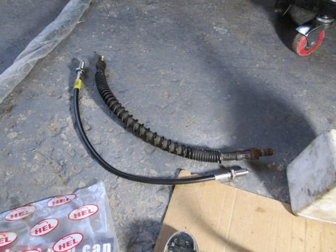

Mustang: back on the road. Passenger side lower ball joint creaks loudly (but no play). I hoped that using the car would either get it to quiet down or become worse and require changing. Neither happened.
Still getting some vibration under certain acceleration conditions. Not sure where to look next. Transmission mount maybe?

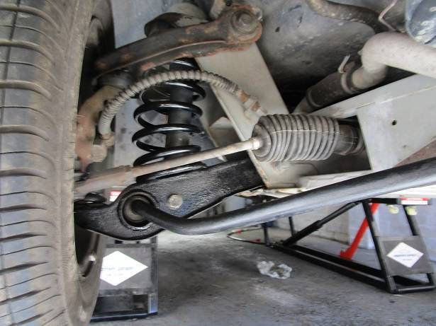

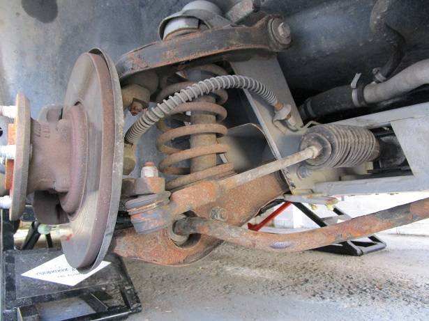

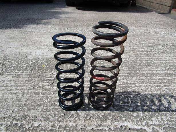

DeLorean: the front sits higher than the back, giving the car a slight nose-up attitude. I've never been happy with this. It's factory height, but deviates from the ride height Lotus engineered the car to have. Apparently, the front springs were changed to pre-empt US legislation raising minimum headlight/ indicator height (which didn't happen).
Anyway, this is what we're dealing with.
I could get a brick of cocaine full hand width in there.
Now, the repair manual says you can just disconnect the lower ball joint, and pivot the upper control arm and wheel hub assembly out of the way.
Lies. Time-wasting lies. The upper control arm needs to be dismounted and set aside with the wheel hub to have anything near acceptable access.
Eventually, I got the old springs out after doing the above, plus removing the stabiliser bar, shock absorbers, disconnecting the tie-rods, and re-positioning spring compressors multiple times for each side.
Here's a new/old comparison.
Did some painting to tidy-up and protect things under there before putting everything back together.
And here's the final result!
I was worried about it going too low, but I'm really happy with this. Just what I had in mind.
Jeep: as you can see above, I got the roof off. Very awkward and heavy - definitely a two-man job. I really noticed the weight difference when driving it though.
At the moment, I'm just checking the weather forecast before setting out in it. I'm in mixed minds about getting a bikini top for summer and just putting the hard-top back on during winter (cheaper option), or getting a full soft-top, frame, and half doors (year round solution and looks better, but costs a lot more).

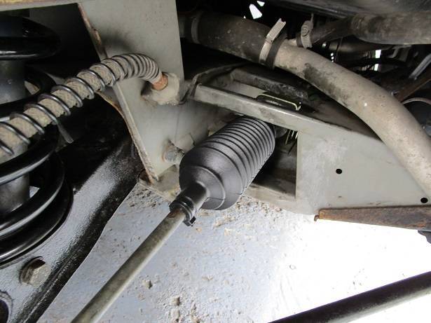

Steering rack bracket for the DeLorean arrived. Install was very straightforward - nothing needed to be moved out of the way.
I also replaced the steering rack gaiters as they were starting to split. This was somewhat less easy, but I got there in the end. Unforunately, I damaged the (recently replaced) boots on the track rod ends. I think I'll just buy new track rod ends. I need to get the wheel alignment done after lowering the front anyway.

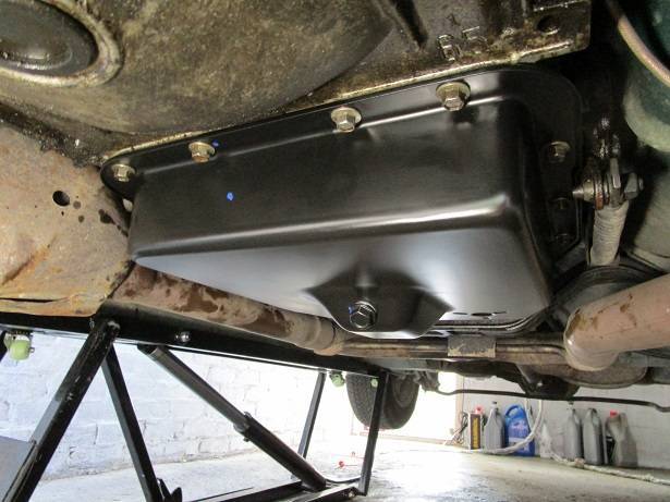

Mustang straight back on the lift. Changed the transmission fluid and upgraded the pan to one with a drain plug. The luxury of it!

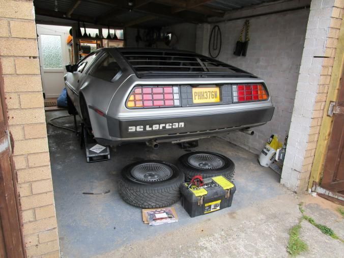

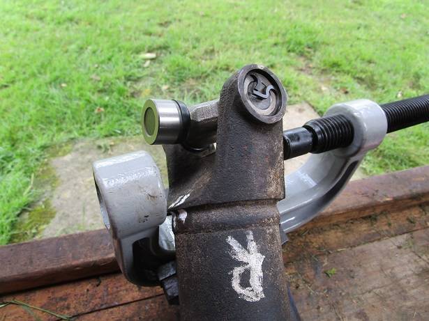

Had the day off work on Wednesday and luckily the Jeep's U-joint arrived that morning. To make things easier for myself, I also ordered a ball joint press which conveniently arrived at the same time.
Rear shaft is back in the Jeep with new joints. Still got the front to do, but no rush as the noise was coming from the rear. I've been getting squealing or sometimes rumbling from the rear when first setting off from a stop. Only seems to do it after I've been driving a while. Hopefully not the diff! Fingers crossed.

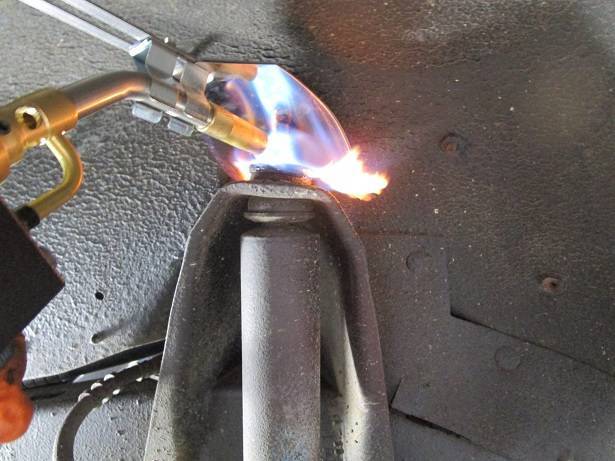

Install was as easy as it looks. The fronts put up a fight though - the top nuts were seized badly. No surprise really as they're quite exposed to road spray.
There's only a 6mm flat to grip the threaded shaft and stop it spinning. Even after heat and penetrating fluid,  I still managed to snap a spanner. I think that's the first time I've ever managed that!
Angle grinder sorted it out in the end.

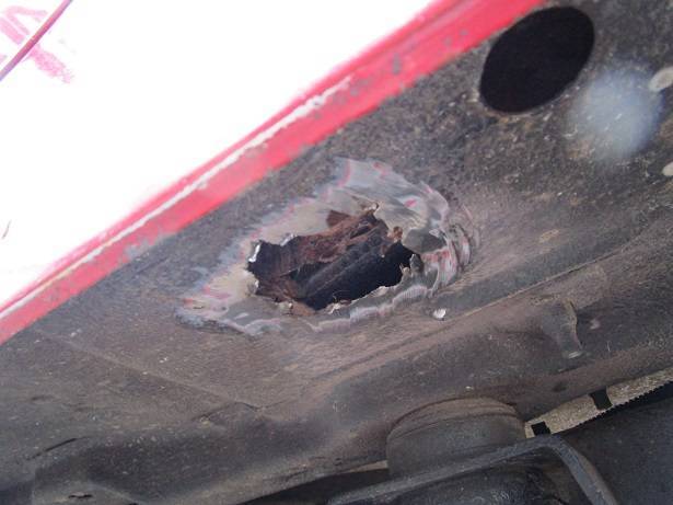

I procrastinated by attending to some minor surface* rust on the floor pan instead...
Nice, now I can add welding to the job list.

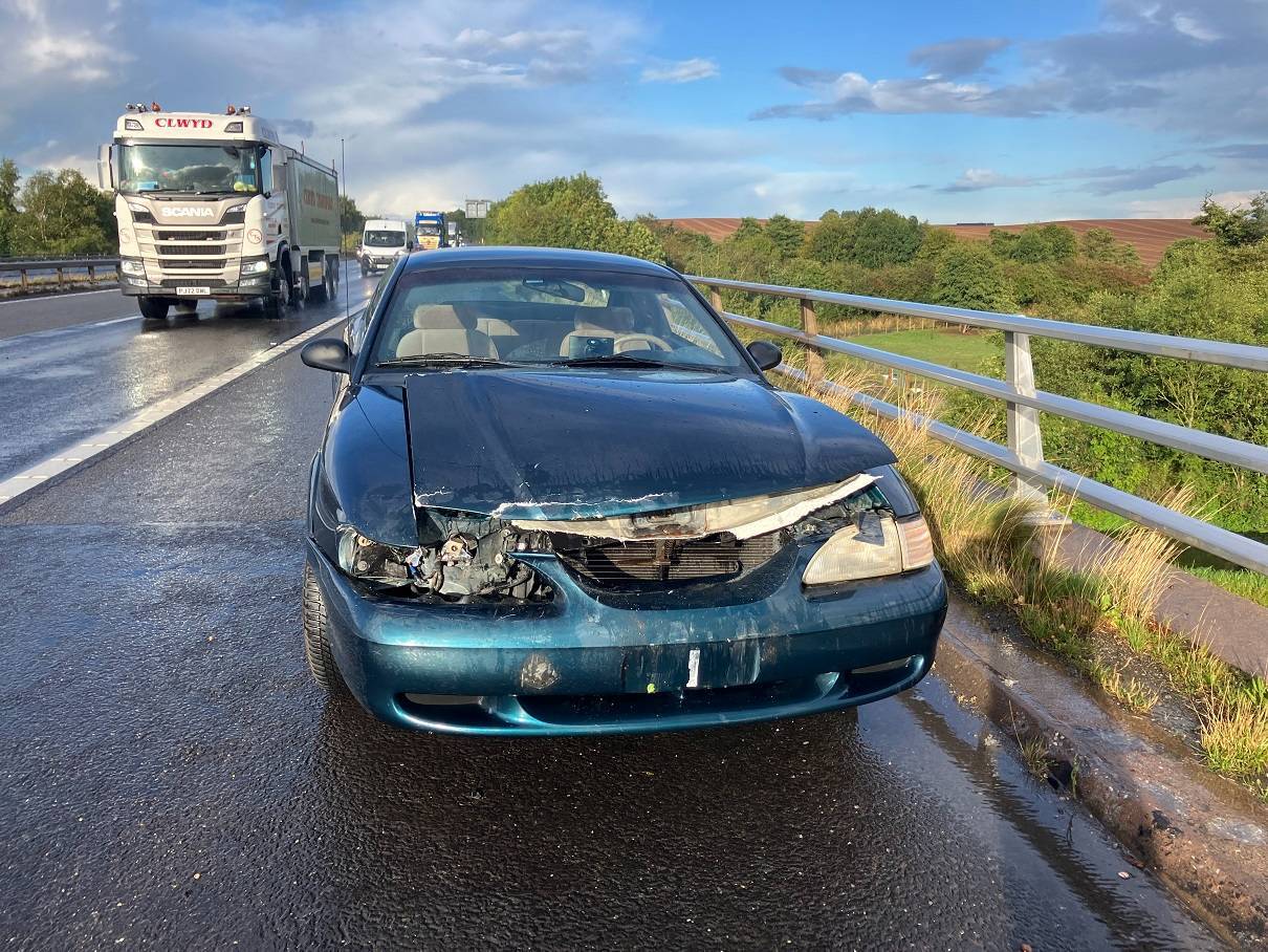

Turns out I had worse luck to come. This happened.
99% sure it will be a write-off.

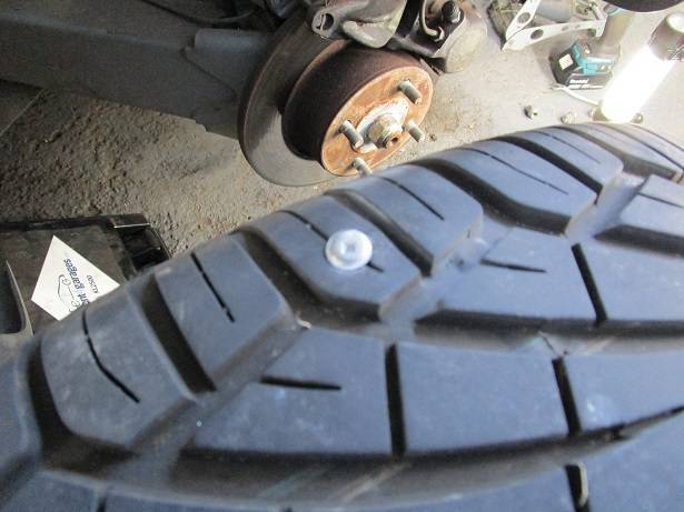

Just to complete my week of shit things, the DeLorean got a punctured tyre.
Just been catching up on your updates, top work that makes me feel a bit guilty for ignoring jobs I should be doing!
Shame about the Mustang, is it worth a buy back to repair?
The radiator shifted position, so unfortunately I think there's more than just panel damage. The car was only worth a couple grand. It will be worth it for someone to break the car for parts, but fixing probably won't make sense. I haven't had report back from the insurer yet, but I'd be shocked if they reach a different conclusion.

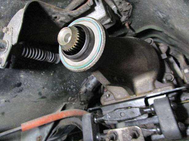

Diff bearings and seals arrived. I drained the oil and popped the cover off hoping not to find broken gears. Luckily, all in tact.
This was good news, but the amount of play in the axle shaft was so minor I thought something else must be wrong to cause so much noise.
I cleaned up what I assumed was an identification tag on the diff. It read "LIMITED SLIPP DIFF OIL ONLY". Weird, looks like an open diff to me. But then an energy-saving lightbulb started dimly glowing in my mind. I used regular gear oil when I serviced the diff, not LSD oil...
I had enough oil to fill the diff twice, so decided to put the cover back on a refill it, this time using LSD oil. Completely stopped the noise!
So in summary, I'm an idiot and caused the rear end noise by using the wrong oil.

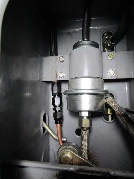

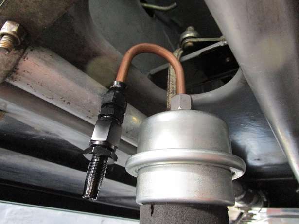

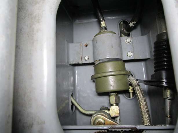

Crank but no start when warm. Suspicion on the fuel accumulator atm. This is what we're dealing with.
Green means it's original to the car apparently. Where's the forth bolt? Dunno. Built on a Friday I guess.
I ended up cutting the hard line seen here. It was giving me trouble and the other end was already butchered by the previous owner (cut then joined back together with rubber hose and lots of clamps). I've never been happy with it and decided now was time for it to go. Problem is, the hard line passes through the chassis here at the accumulator and re-emerges near the fuel filter. I can get a preformed replacement line with fittings but I'd need to sperate the body from the chassis to fit it. That can fuck off.
I thought about making my own fuel line in copper and forming it to an alternative route. I've read that long sections need fixed mountings at regular intervals otherwise the line work-hardens with flexing/vibration and fractures. I'm not convinced I'd be able to mount it securely enough, so I've decided to run most of it as braided flexi-line with hard line stubs using original hardware to interface with the accumulator and filter.
I noticed by chance that AN6 fittings would screw directly onto the accumulator!
Did it work? Of course not; pissed fuel out everywhere.
Back to the original plan then.
Made a 5/16 hardline to AN6 flexi conversion. It turns 180 to exit through a pre-cut hole in the rear Y section of chassis. It will follow the driver's side leg of the Y section toward the fuel filter.
Unfortunately, I over-tightened the 5/16 to AN6 fitting at the other end of the line and stripped it. I re-made that end but didn't have any spare compression 'olives'. I tried my luck re-using it, but nope, it leaked.
That's it for now. Waiting for more compression olives to arrive.
Update sooner than expected. I only paid 2nd class postage but somehow got the parts next day.
With both ends finished, this is what I've got.
Not ideal, but it doesn't leak. Also seems to have solved the hot start issue.

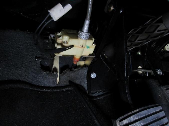

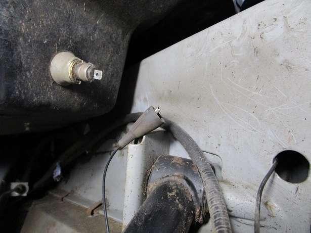

I've been having a lot of running issues with the DeLorean of late. Beginning of the month it developed a hunting idle. It had this problem when I first got the car because the air-fuel ratio was set too rich. I adjusted the mixture screw as this had been successful at controlling the behaviour before, but I should have thought more critically about why the ratio had changed. What ensued was a frustrating seesaw in which the car was either too rich or too lean. The car would seemingly change its state of running at will - even if I got it running well in the garage, the next time I used it, it would run different. After numerous adjustment sessions, I realised I couldn't get the adjustment set right because the target was moving.
I checked out the connections to the frequency valve (affects fuel pressure by allowing or restricting fuel return back to the tank) which seemed fine. I then disconnected the O2 sensor while the car was running just to eliminate it as a suspect. I had replaced the sensor with a genuine Bosch unit not even 18 months ago. To my surprise, it didn't make any difference to the idle suggesting the sensor was dead.
Replacement sensor arrived this morning and fitting it was a piece of cake. I removed the driver rear wheel and disconnected the sensor from its connection on the fibreglass tub. The sensor wire is pulled through a chassis cut-out to driver exhaust bank on the other side.
The sensor itself is accessed from underneath. There's insufficient room for a socket, but a spanner worked just fine.
The engine still idles slightly too high (not a new problem), but seemed to hold its setting and performed well on a road test.
Tentatively fixed, but I still need to get to the bottom of the high idle.

My DeLorean reached 10,000 miles! I don't think the high mileage club will accept my application just yet, but it's still a pretty big mile stone as it means I've driven the car more than any previous owner. The car celebrated this by breaking the speedo angle drive shortly after...
Replacement pictured here.
Did an engine service at the same time, hence the cans of oil.
The new angle drive came with a one-piece speedo cable that by-passes the lambda counter under the dash.
It's a primative mechanical service reminder that trips a light on the dash after about 30,000 miles telling you to replace the o2 sensor. Not really needed and it creates extra drag on the speedo cable, so it's been deleted.

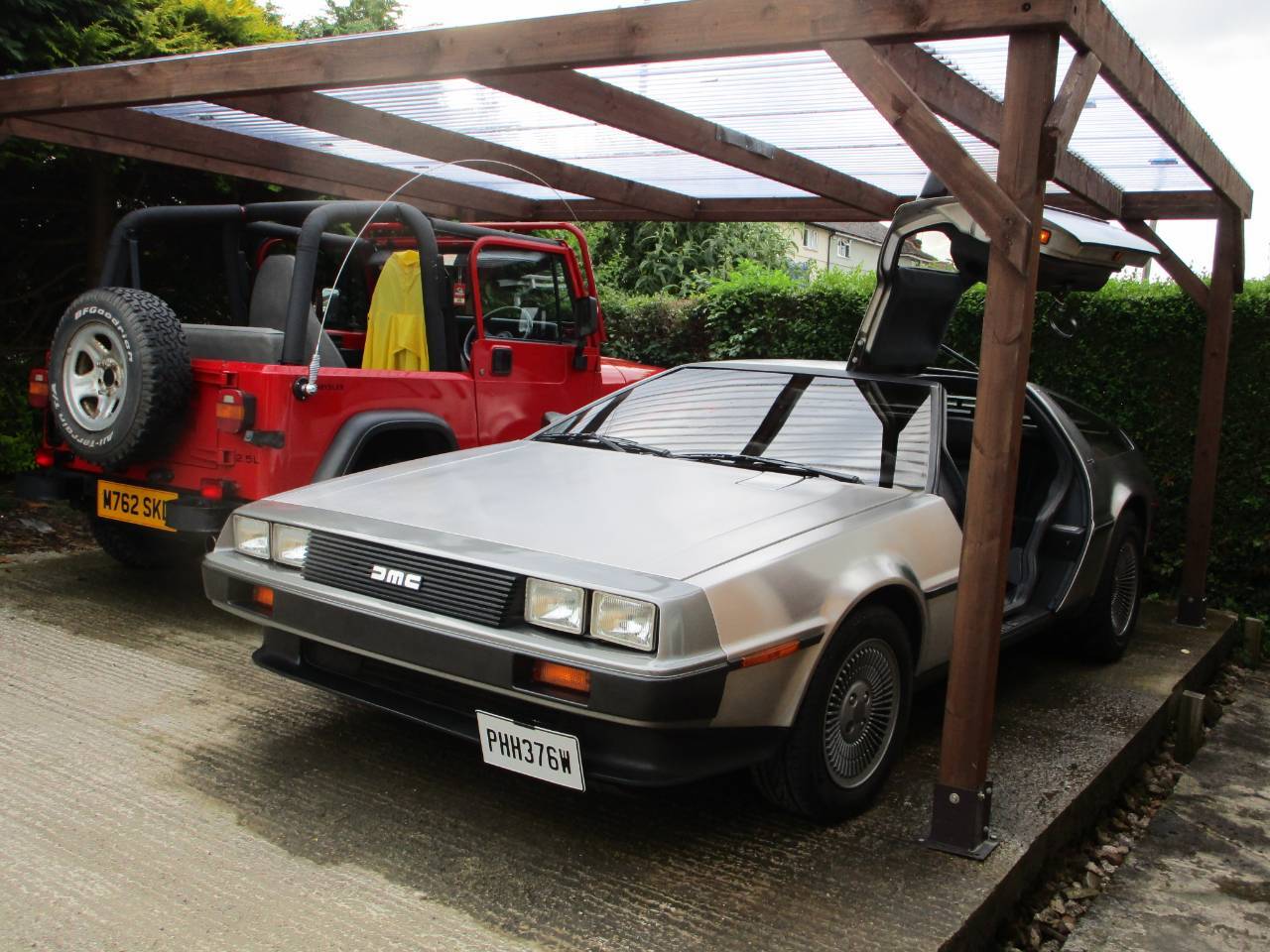

Big changes with the Jeep - I used the Mustang insurance money to buy half doors and a soft top. Looks great. Decent weight reduction, too.

Got a full set of braided stainless steel flexi brake lines for the DeLorean. The originals are 44 years old, and while they look fine, I don't completely trust them. Opted for black coated ones as I didn't want a 'modified' look.
Started with the rear lines as they looked the hardest. I wasn't wrong!
No swing room for a flare wrench to disconnect the hard lines so I had to use two different size crow feet plus extensions.
I stopped taking pictures as the whole thing became rather not fun. Progress came 1/8th at a time. Even once the line was disconnected, it was still seized in place. Because of the in-board position of the rear lines, you have to work underneath it which means getting dripped on.
The ends of the line sit inside a hexagonal retainer. It's supposed to stop the line from rotating when tightening. The new lines have slightly smaller ends, which means sometimes they spin. I'll illustrate below with a picture from one of the front lines.
Here I could wedge a flat head screw driver in the gap but there wasn't access room to do that in the rear. This resulted in many failed attempts where I could get the line 95% tight but then it would start twisting. Can't really say "fuck it, whatever" with brake lines, so had to undo it and start over and over again. I won't bore you with every failed attempt but banding electrical tape around that hex form at the base of the shaft ended up working.
The rear lines took me half a day. The front lines were piece of cake by comparison - both sides in an hour.
Bled the system with one of the those Gunson type one-man bleeders. Second time I've used one. Bit of a faff setting up but worked well.
