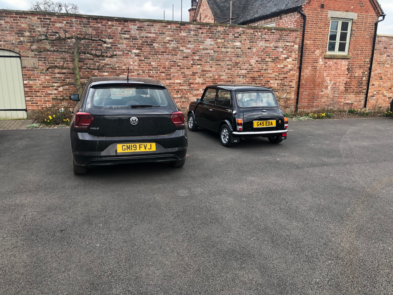

Also parked outside the office next to another small car.
