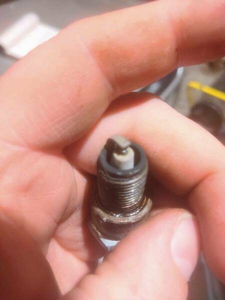

Wee bit of work on the Maestro tonight.
Treated it to some new spark plugs. Old plugs weren't too bad. But no idea of when they were last changed.
Not a bad colour on the old plugs either. Gapped the new ones to 1mm and banged them in.

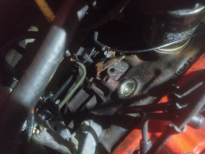

Oh here! Why can I hear a kinda trickling water kind of noise!?
Well that'll be a shagged core plug being the reason why.
Yeah, that's less than ideal.
But small confession time. Already knew the plug was looking suss. So I got five ordered up just incase one started it's pish.
Not hard to replace. Just a nip. But only I could make a simple job hard. Dipstick and dizzy were removed to give room to smack the second one in. I smooshed the first plug enough to not trust it.
Wee smear of liquid PTFE just to make sure it sealed fine.
Filled with coolant and ran up to see if was going to leak. So far it's all good.

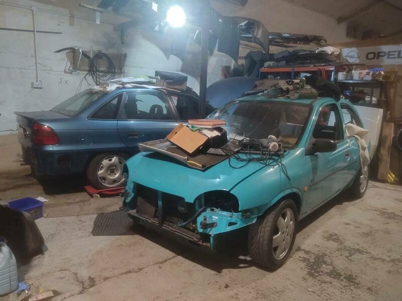

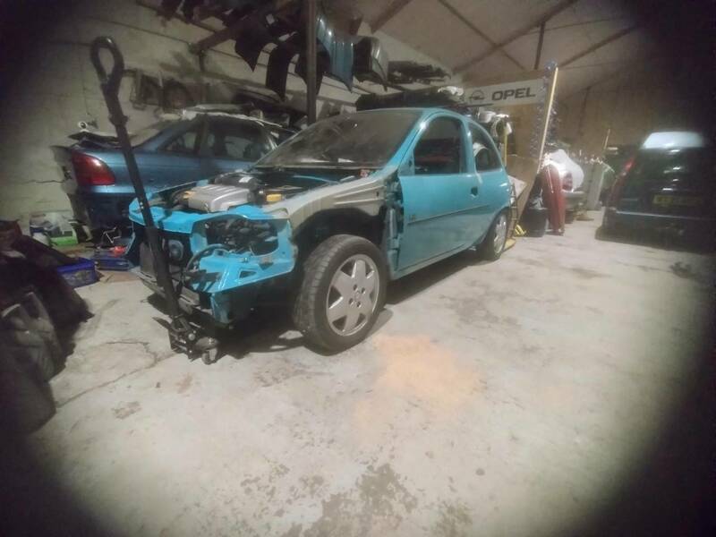

Little more progress with the Corsa.
Had a fella who runs a body shop local to me have a quick ganders.
He requested I strip the car down before he wanted to quote. Which is fine.
So far the doors and tailgate have been stripped. Not much left now. Leaving taking those off to nearer the time. Room is at a premium for me.

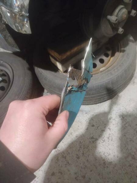

Also maybe a handy tip. Cheap knife was the perfect tool for getting the rear window out. Only good if you don't care about marking up the paint.
Did find this while poking about.
To be expected, I suppose. It's double skinned there. So a good reason for not chucking out left over bits from the repair panels you use.
Anything else will be made from sheet steel.

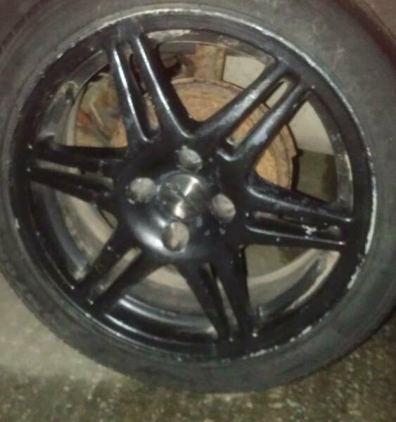

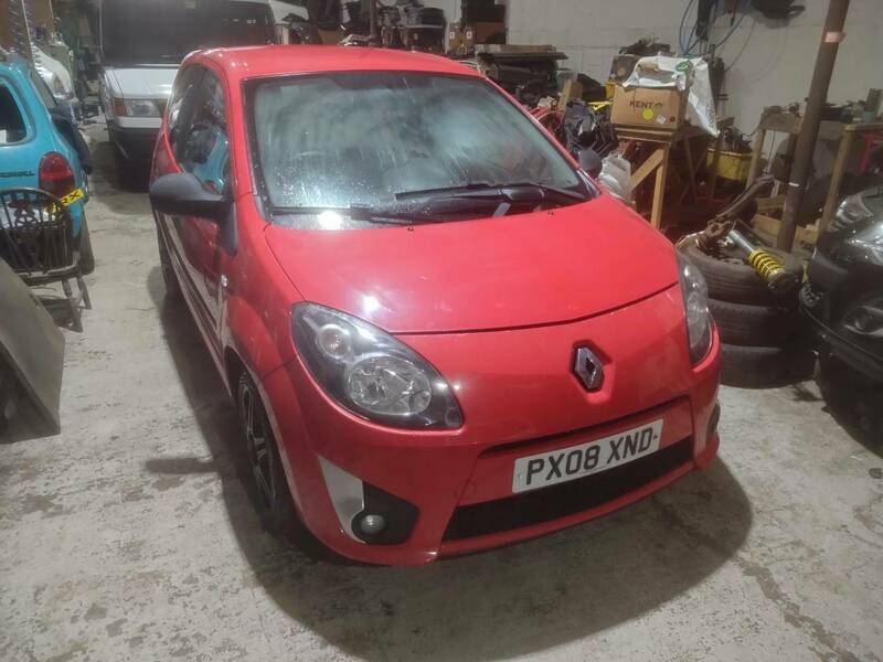

Now own a '08 Twingo.
Pal had bought this and an Astravan. I immediately wanted the Renault. As it was sat on these wheels.
16 inch Speedline Chronos.
Had planned to throw the car away and keep the wheels.
Ach why not give it a quick wash to get the crap off it. Looked not to bad.
Garage it came from said it wouldn't turn over. Maybe the engine was seized?
Hmmm. Lets cut the alternator belt off and see if the alternator is the cause. As I've seen the same thing happen due to a locked up alternator.
Yep, engine now moves. Good start.
Tomorrow will see a new battery and starter bought. Can't hurt to try, end of the day I'll get the money back from scrapping it and keep the alloys.
Fitted a new starter and battery.
Good enough to see if it'll start.
Which it did! Phew!
It drives too. Came out and then backed the car into my bay all under its own steam.
There is other issues, which may relate to the lack of alternator. It's also a bugger to start, but will start and rev up. No weird noises when it does run, thank goodness.
Ah yeah, need an exhaust. Blew the guts out the back box.

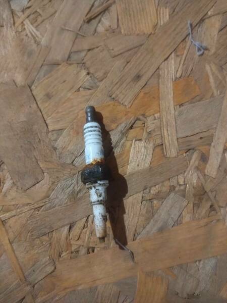

Twingo is now a three cylinder.
Rest of the plugs came out no bother.
Also have to wait on an alternator, Expensive little bugger too.
It's not putting me up nor down really. Just added hassle. The remains of the plug should come out with a square easy out.
Hopefully Amazon shipping gets me out of the shit 😅.

For the Twingo.
That broken plug is not coming out, at all.

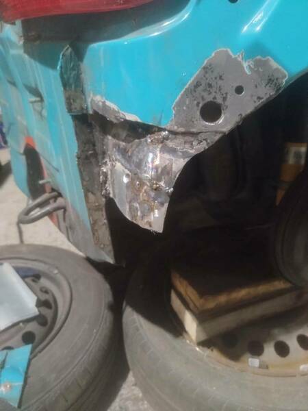

Got on with the lower arch corner.
I couldn't be bothered chasing rust. Just whacked the lot out.
As you'll see why. Two layers that have been rusty for sometime.
Made a new inner piece. It was a bit lumpy looking here. That was due to me making that from several pieces to get the curves close.
Welded on the outer and tried going with smaller holes to plug weld with. That worked really well.
Then ran over the welds with the grinder and fingerfile to get here. Overboard maybe, but not a bad habit to have.

That looks really solid.
Any plans to inject wax in between the skins? Would help stop it rotting out in the same place again.
Absolutely.
I'm going to fill the hidden areas full of wax. Thankfully I can get to those areas from inside the car.
Really don't want to have it rot out again in a couple of years.

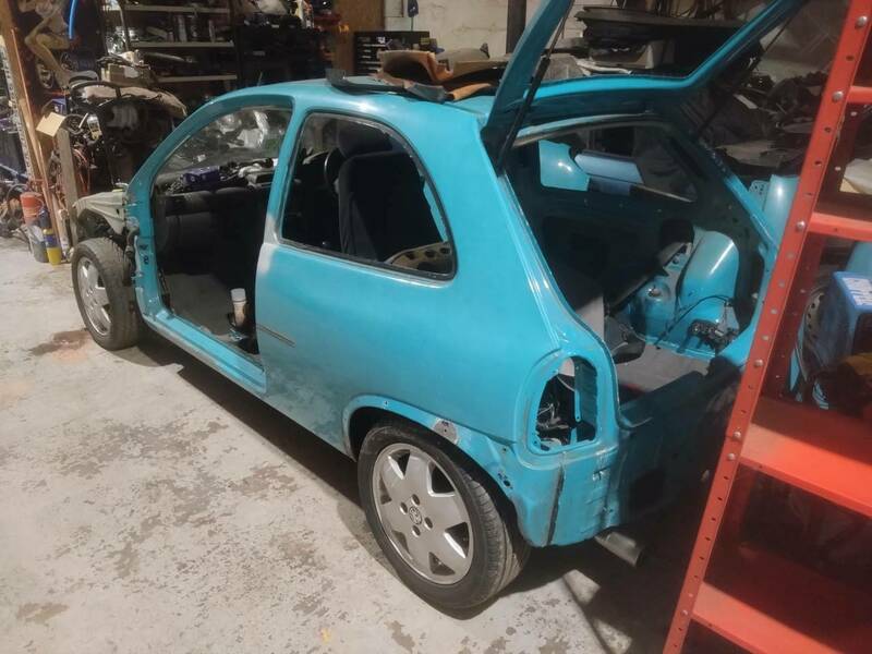

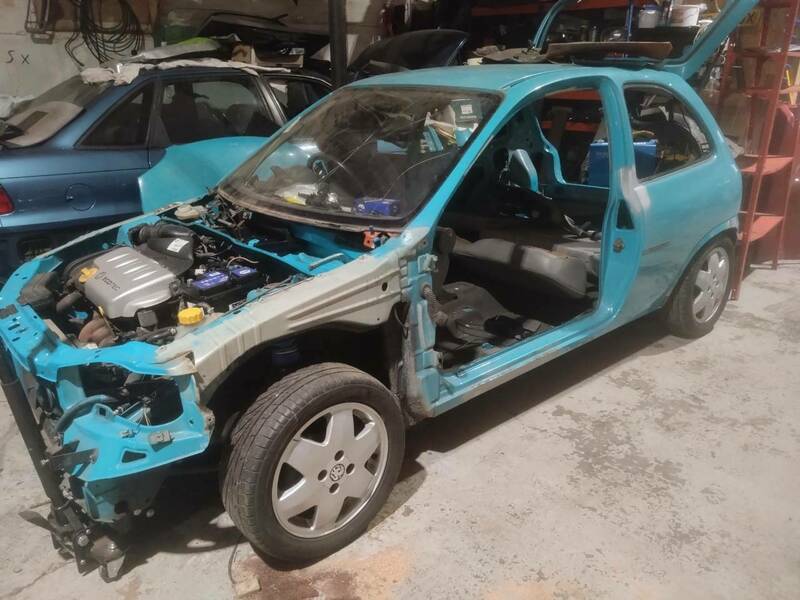

Began stripping the Corsa down.
As the the body shop fellas have been down. Price quoted and rough date for getting it in sorted. They thought it was a cool wee thing.
I have imposed myself a deadline too. Should be doable if I don't fanny about. This year's VBOA show at Sywell in July. Except I want some shakedown time of at least a month. So hopefully end of April it'll be mostly there.
Edit - but of course that'll never happen. I'll be thrashing like hell the week before and STILL won't make it 😆.

Am I right in thinking that engine is non-standardly large for a wee Corsa? And the wheels and ride height a little... provocative
Having seen it in the flesh, I can confirm it's the stuff dreams* are made of.
