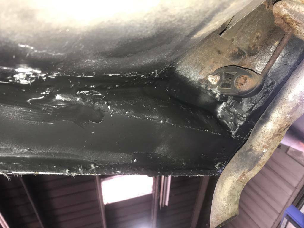

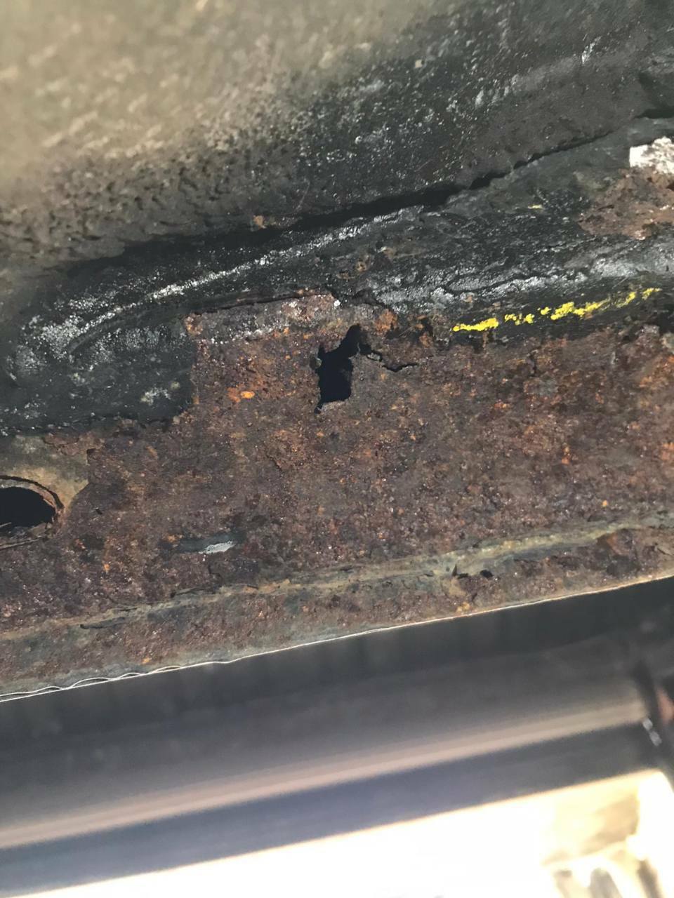

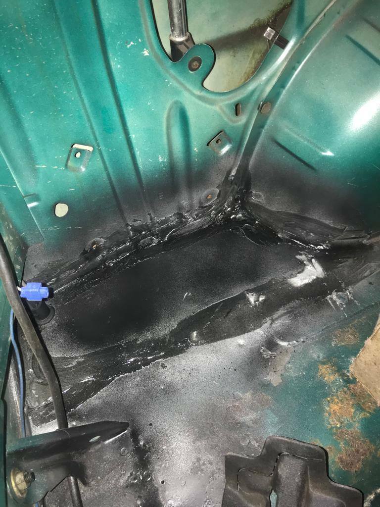

I got the Cav welded up nicely in the end.
Rear crossmember was rotten.
IMG-20210409-WA0004.thumb.jpg.0b227a0607e73e96b8dc3ab5faa7d3c7.jpgIMG-20210409-WA0005.thumb.jpg.9de0d872eac581d5c70e7d69600cc97d.jpgIMG-20210409-WA0008.thumb.jpg.3213f355338e560a426aae7df86746a0.jpgIMG-20210409-WA0007.thumb.jpg.3e55b7ed54d758faadc0d2433c11e889.jpgIMG-20210409-WA0006.thumb.jpg.c754582b6f974ac46e5ff64c0f6583da.jpgIMG-20210409-WA0010.thumb.jpg.c6b49b01afca3a5f0dfbd7885ff89410.jpgIMG-20210409-WA0009.thumb.jpg.3f4d1e17ae97e596df330d99662e69fa.jpg
Welded up.
Boot floor.

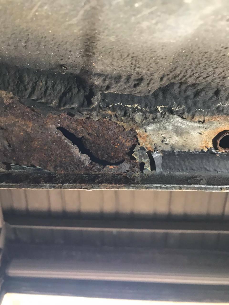

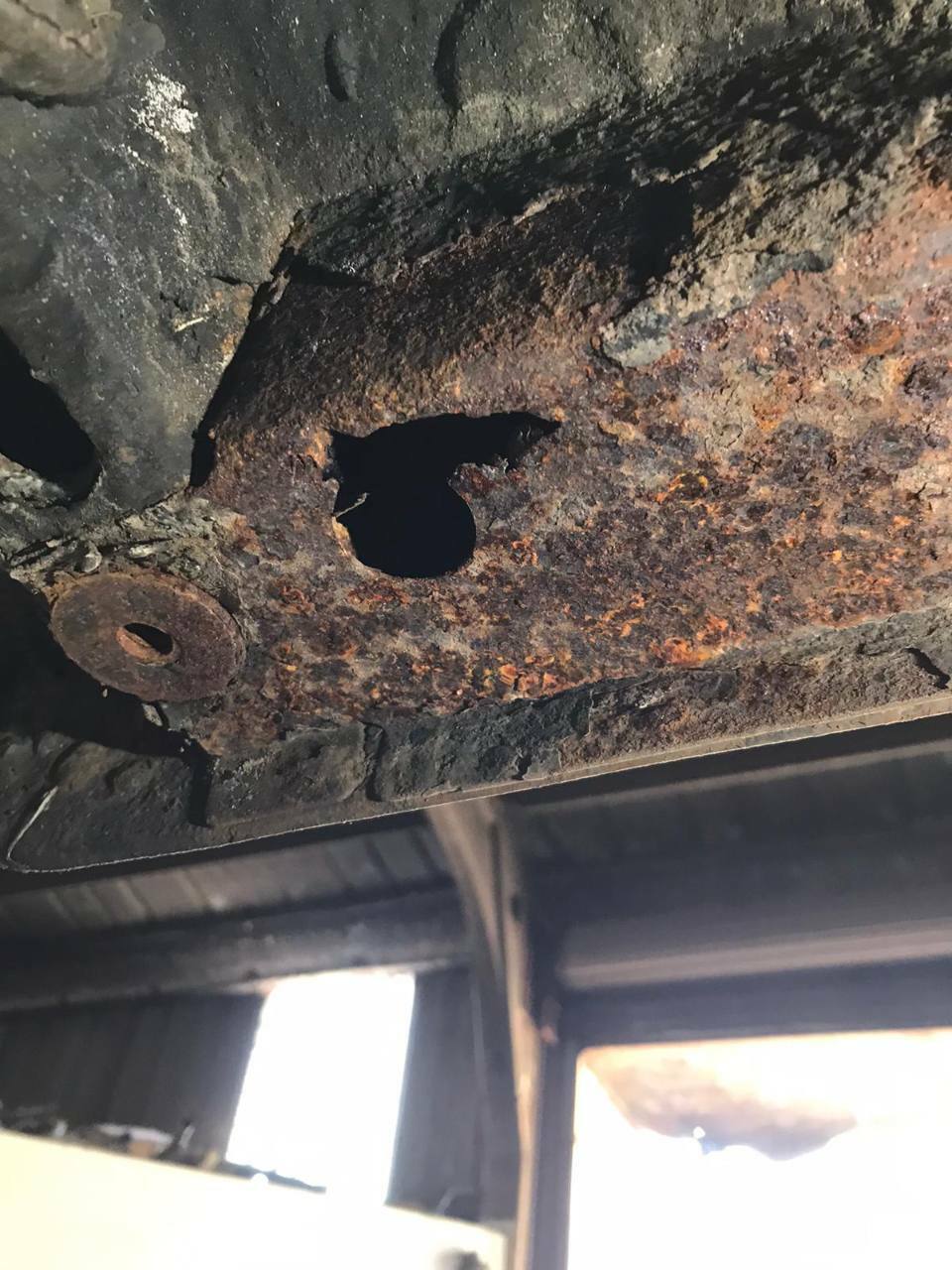

Welded a hole in the rear sill. Well it started out as one, but became 3 big ones, as I expected! (After the faff of finding a welder last time I learned myself)
