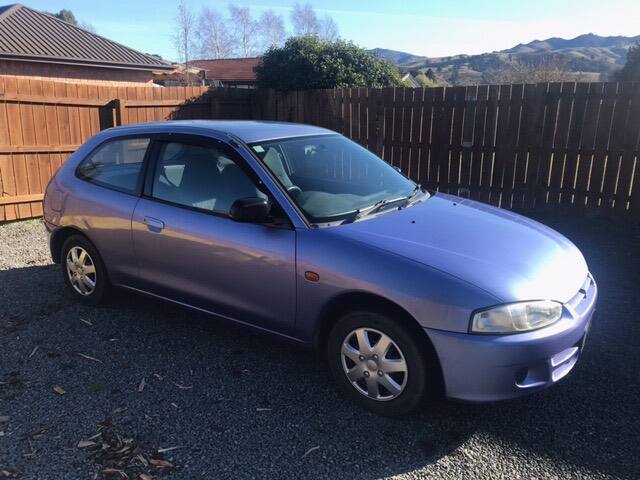

Anyhoo, this thread is nothing without pics so here is Mitzi Kaput as she sits today.  I have attached a vid too, not because I want to do a walk around but because there was an excellent bird singing and I liked it, that’s all.
Passenger door badly let’s it down.  Some DIY paintless dent removal YouTubing is called for
