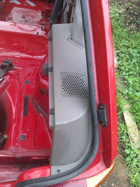

At the back, I was still getting water coming into the boot.  I knew the rear light cluster was one culprit still as I could see water inside it, an inspection of it revealed that there was quite a large gap between the red and amber lenses on the top edge of the cluster, so I stuck some butyl tape in it.  I also removed half the butyl tape I'd used to seal the unit to the car so it fit better.  Removal of the light cluster highlighted that while the butyl tape is incredibly effective at sealing things up, it's also very difficult to remove the light cluster, so eventually I will likely replace it with some suitable foam or rubber tape instead.
I'd run out of enough Arbomast to seal up the whole of the tailgate screen and some was still appearing on the inside of it so I had my suspicions about that.  However, I also saw that water was getting in past the bumper bolts, so it was more butyl tape for that which highlighted that there were indeed gaps water was getting in and the water isn't getting in now.
Happily, after all that effort and some rain later, the interior of the car was staying dry!  I could finally put it all back together and enjoy not having a damp car.

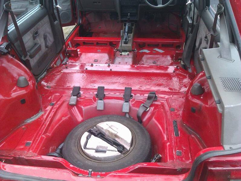

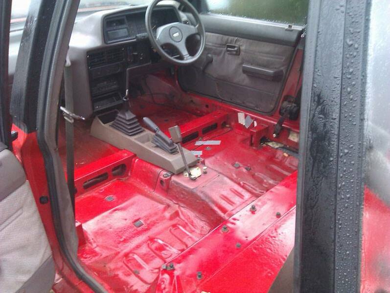

In my quest to find the cause of the water leaks I thought I was doing rather well.  The front footwells were finally staying nice and dry and victory seemed assured.
Then I went and accidentally left a window open all night.  When it was raining.  A lot.  Now the inside of the car was absolutely soaked and the rain wasn't letting up even a little bit and the only way to dry it all out would be to strip out the interior, a job I ended up doing with every car I own and a job I planned to avoid on this one.  OH WELL.  At least the Maestro is easy to take apart.  The front seats are held in with four torx head bolt things that I'm not a fan of, slide the seat back to get to the front ones, and then slide the seat forwards to get to the back ones, lift the seat free and you're done.  There's no cables or seatbelt pretensioners or whatever to deal with on this car.  I used a T30 bit.
With the front seats removed, the rear seat is even easier.  There's four bolts along the front edge to undo, then you roll the seat forwards and can get to the two hinge bolts underneath the seat.  It then comes out of the car no bother.  The bolts on the outer edges at the front have little metal tabs, the sole purpose of these seems to be to prevent the large plastic sill trim from warping and lifting up.
In the middle of the car you need to loosen the centre console, there's two screws hidden under the little black tray that pops out at the front of the console, and another two that go into a bracket at the back of the console.  The two screws at the back aren't really necessary to undo if you've remove the front seats since the bracket the screws go into is held down by the seat rail bolts.  With that loosened, you can then undo the seatbelt bolts and remove the carpet.  Unless it's this car in which case the first problem bolt I've so far encountered is for the passenger stalk which will only undo so far before the captive nut is clearly spinning.  Fortunately, the bolt does tighten back down properly.  Had I got a longer console that covers this bit I would have just cut a slot in the carpet to get around the stalks, I don't so I eased the carpet up over the stalk which it will just about do.  That way when the carpet is refitted it won't have a cut visible in it.  The bolt heads for the seatbelt stalks are hidden by push-on plastic covers.
With the carpet lifted there was a good amount of water in the driver's side, unsurprisingly, since that's the side I'd left the window open on.  There was also a lot of water under the rear seat bench which I initially put down to rain getting into the car through the window.  The nice thing is the vast majority of the floor is solid, there's a few little scabs here and there, but nothing that needs attention beyond the cosmetic.  What work has been done on the floor looks to have been done to a good standard, apart from the confusing use of masking tape and that old frozen mince packet.
I couldn't actually figure out how the centre console comes out.  I suspect I have to disconnect the handbrake and stand it up vertically, or remove part of the dashboard, since I can't see any other way of getting the clearance to move it far enough back or forwards to clear the lever.  Simpler to leave it in for now, you can refit the carpet without removing the console fully.  While I had the car empty I could watch for water coming in since there was nothing to obscure the view of it and discovered some leaks I wasn't aware of.  The first was the boot carpet and under the rear seat, which were both very wet.  I could see with the seats and carpet out that there was a trickle of water coming down the rear passenger arch and initially thought this was the window seal at fault.  To find out for definite I unbolted the seatbelt, and removed the trim which is held on with a single push clip.
This allowed me to see where the water was coming from more clearly.

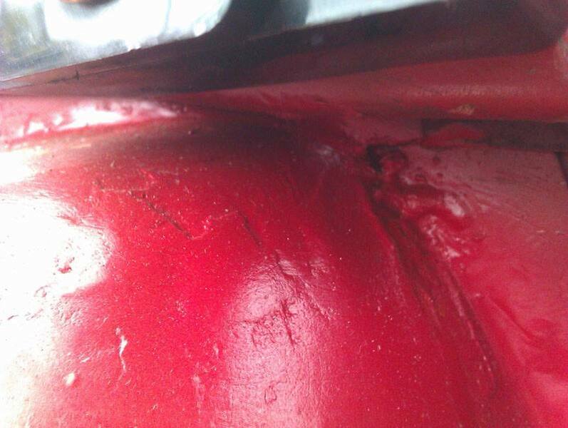

I still thought it might be coming from further up, so I removed the parcel shelf support, discovering some broken brackets that I'd need to fix.  The cause of the leak wasn't the window seal, which was something of a relief, it was actually an old weld repair that had a tiny little pinhole in it.  There's no rust staining, it just looks like a tiny little bit hasn't been sealed up, and the repair itself looks to be done to a very good standard.  A bit of sealant both sides will sort this out no doubt.
The other leak was a bit odd and appears to be a factory one since there's no repairs I could see in the area.  Water was pooling where the boot floor meets the inner arch and at first I thought it was running around from that hole I'd just found.  Turns out there was another tiny pinhole in the factory seam sealer.  Again, no rust to speak of and no rust staining, just a failure of sealant application.  This will also get a bit of sealant both sides and that should stop it.
A bit like the Spanish Inquisition, nobody expects where water is going to turn up sometimes.  These two leaks are a bit strange because you don't really think of water running down the inner arch when the car is stood, but we've had so much rain that the water is running down the body and then capillary action is dragging it up into the inner arches, aided by all the mud that's packed into the rear arches, and finding these tiny holes.  Once the water has a path, much like electricity, it takes the route of least resistance and keeps flowing that way until an easier route presents itself.  Without stripping the interior out I probably wouldn't have found these leaks so in a way, by leaving the window open I did myself a favour.

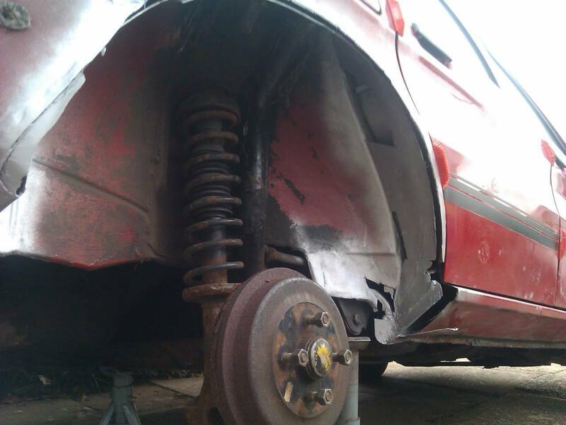

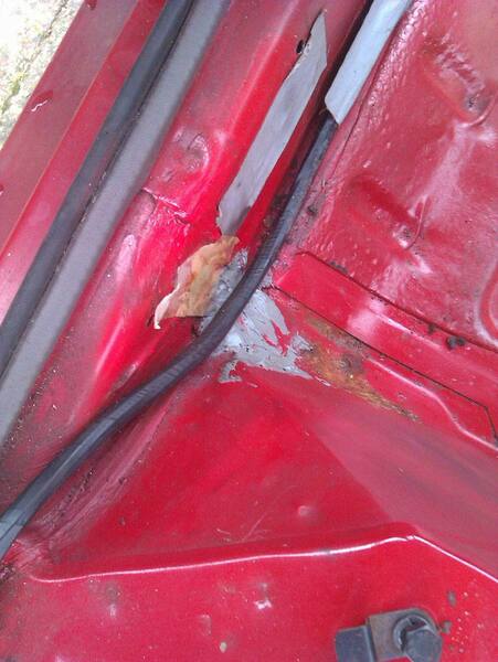

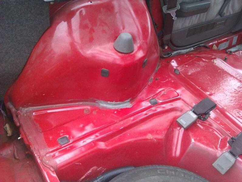

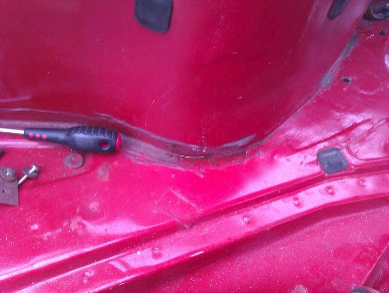

I'd already identified the key points water is getting in, now to try and seal it up.  First job was to pop the rear wheel off so I could see the other side of the pinholes in the arch that were letting water into the car.  Water takes very strange routes sometimes, you wouldn't expect it to run down the inside of the wheel arch when the car is parked, but it does, and then creeps into the car with the aid of capillary action.  Aside from the usual griminess, the inner arches are in pretty good shape.
There has been a patch let in very nicely to the strut tower a long time ago, absolutely no reason to revisit it aside from perhaps a splash of red paint and/or fresh underseal.  I have new rear shocks to fit, I've just been waiting on weather and motivation to get on with it since suspension is another of those jobs I dislike doing.  The springs aren't as bad as they look in that shot, a little time with high speed abrasives and squirty paint would see them respectable enough and I may do that when I do the shocks.
Sealing up then.  We did the little bit in the boot where there was a hole in the factory seam sealer.  I honestly couldn't see it on the outside of the car so just made a best guess where there was a bit of loose underseal, the water must have been taking a pretty odd route and none has got into the car through this spot since sealing it up.  I basically looked for where the inner arch was taking the longest to dry out to narrow down where the route might be, combined with some back and forth to figure out where this line is on the inner arch since the boot floor is higher up than the bottom of the rear inner arch.
The pinholes on the inner skin of the floor under the rear carpet I also put some seam sealer on.  This wasn't letting water in and I can't see this from outside the car, it appears to be double skinned.  So to keep any water from getting stuck in there if the inside of the car gets wet, this seemed a sensible precaution for now.
Up at the top of the repaired rear strut I sealed up the welding that had a tiny little hole.  No rust, just a small pinhole that had been missed when the repair was done in the past so this was more a case of finishing a job than an actual repair.  This one I could see on the other side of the car when the light was just so and got a blob on the inner arch too.
I then picked off one small area of loose sealant and, since I was all out of underseal to replace it, I used a little bit of seam sealer as an interim measure.  I do need to replace this arch once I have the welder up and running so  when I do that I'll be tackling the inner arch in full which is why I'm not putting more effort into painting over the seam sealer or dealing with any minor surface rust in here since I'll be doing it later.  For now it was a case of arresting any potential deterioration and getting the car as weather tight as possible in the brief moments between rain.
After that it was a check of the interior and leaving it overnight to make sure no more rain was coming in.  All of this was done at the end of February and since then I can confirm that the sealed up areas have stayed sealed up, the interior is back in, and it hasn't had any condensation or damp issues since even with all the rain.  I'll go into more detail on that side of things once the videos go up, no point jumping the gun on that one just now.

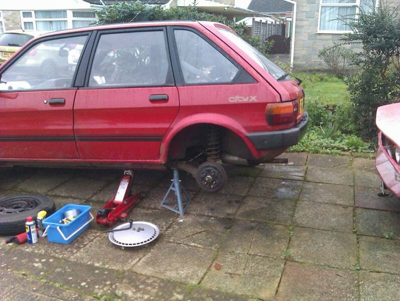

Wheel back on and car back on the ground again.  One very clean inner arch showing up all the others.
I will say one thing for this car, the underside is in surprisingly good shape for a car that's been holding onto water inside.  There's a couple of areas of bodywork that need attention like the scabby door corners and rear arches, all of which I now have repair pieces for, but it's in far better structural condition than reputation and mileage would suggest.

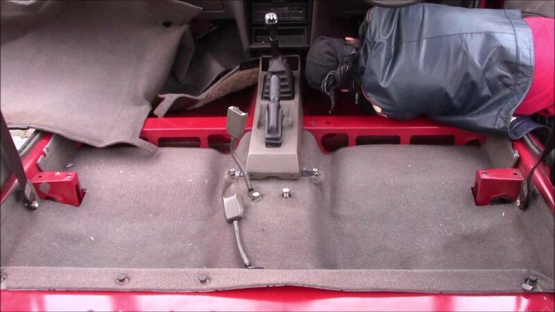

I'd got the car all dried out nicely and the rain was staying out with the exception of the tailgate which is rotten (we'll come to that later), so refitting the interior could be chanced. Start off by putting the carpet back in since it was the last thing to come out.
One thing I did change was to put new insulation pads in the front. The old ones were destroyed by the water ingress and I wasn't about to refit the blue carpet that was in there when I got the car. This stuff is great, it's a sticky-backed felt so you just draw the shape you want on the backing, cut it out, peel off the backing, and stick it on the carpet or the floor.
The feed the carpet from the passenger side through behind the dashboard to the driver's side and after some contortionism and minor swearing, it's all in.

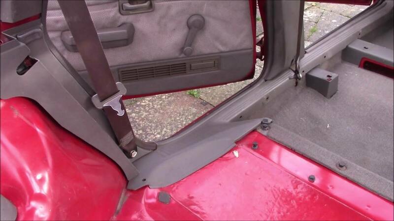

After that, it's the plastic trims. These have to go in before the seats since the seats and seatbelts hold them in place for the most part.

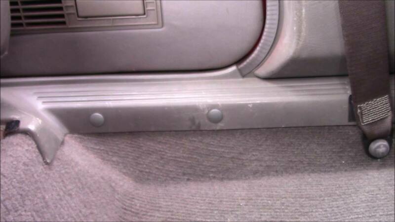

Then to the back of the car where it's the lower C pillar trim first, which is held in with a hidden push fit clip and the door seal and probably something else (I forgot, check out the video for full instructions).
After that it's the seat side trim which is held in with one self tapping screw, the door seal, the inner sill trim and one of the rear seat bolts that has a little shaped bracket on it.

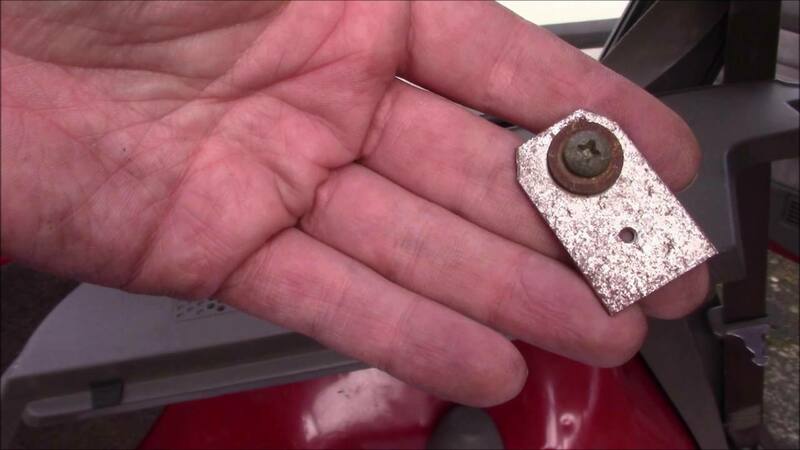

Then take a moment to marvel at the effort that went into the little bracket that held the broken pieces of the parcel shelf together. I replaced this by simply gluing the clean break of the bracket back together, a break so clean you couldn't even see the seam once glued.
There's three (I think) screws under the parcel shelf trim, and one on the rear of the parcel shelf trim above the rear light. It's a bit fiddly and was difficult to record since you generally can't really see what you're doing as you do it.
Last bit back here is the seat belt trim. This is supposed to be split, I later learned, so that it can slide onto the seatbelt. It then clips into the hole in the trim.

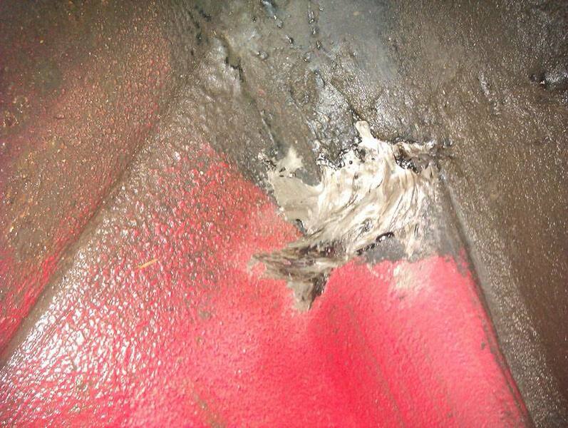

The inner arches had a lot of mud in them. Not the worst I've ever done, that particular award goes to my old Renault 6TL. I do wonder if it ever made it to roadworthy status. It was the car that convinced me I hate working on engines. Anyway, I digress.
After cleaning the mud out of the arches and the dirt off everywhere else, I could see a couple of bodywork issues that had got worse in the first few months of ownership. Namely, the cracks that had been opening up on the rear arches, particularly the driver's side. Back in April I decided to leave this be, the welder still wasn't set up and I didn't have all the materials I needed to repair it, hopefully it would hang on until I was ready to do the repair.
While I remember, here's a before and after of the worst of the inner arches, the driver's side rear. Knowing what I know now, I suspect this was deliberately left muddy so it couldn't be poked at MoT and it was quite a build up of mud in there.
I did knock a bit of underseal off and discovered a hole. A hole I did not poke because I could see it was going to become A Hole if I did. More on this anon.

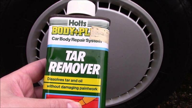

Worth mentioning the Quality Product I used on the wheel trims which is probably older than I am.

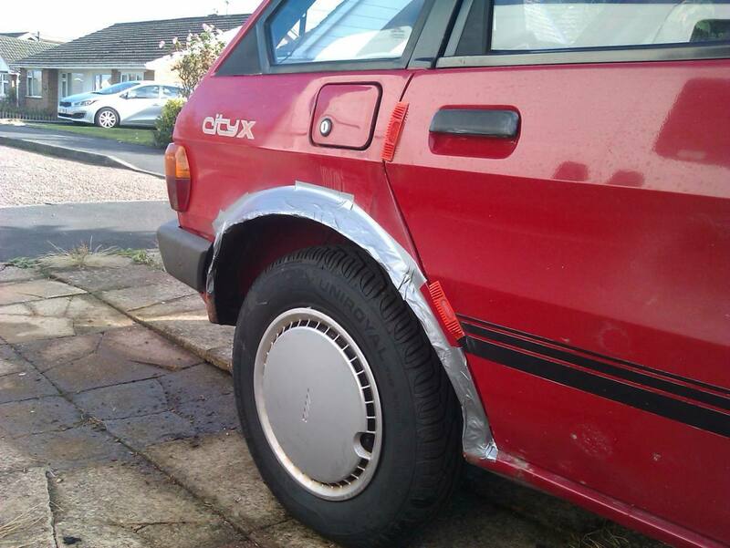

Specifically, the last time I washed the car earlier this month, with a hose and bucket just like in the video, I washed the rear driver's arch clean off. Literally.202108-04.thumb.jpg.99f9eeee79125ae1fa60af2f81e3b953.jpg
That was less than ideal. I'd actually ordered a new grinder and welding gas and it was due to arrive a couple of days after this happened but I still needed to pick the grinder etc. up and run a few errands so an emergency repair with NASA tape was employed for the interim.

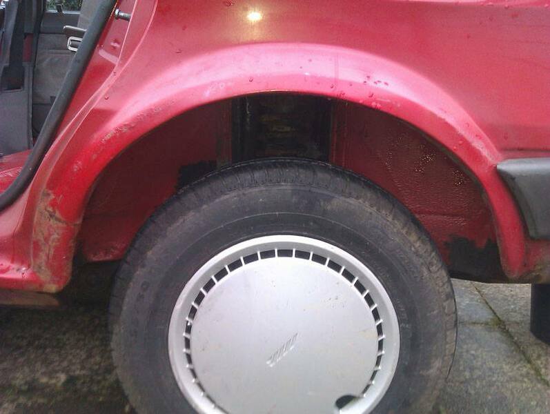

Then the choppy-choppy began when I was in a position to do so and there were MORE surprises. Namely, a sock. Remember the hole in the inner arch I didn't investigate further? This sock was in it and then fillered over crudely. An impressive bit of bodgery.
Repair panels for this side arch are difficult to come by (though I do have a lead from a fellow Maestro botherer...) and inner arch panels are non-existent so this is going to be a challenging repair. Happily, you can use a front wing from the opposite side to repair this and that's exactly what I'll be doing as a friend donated one to the cause that as in worse condition than the one on the car.
I'm also right on the verge of welding fresh steel in now that I've got all the rot chopped out and given a splash of zinc primer. Even though the repair is limited pretty much entirely to the arch itself, it's still going to be an awful lot of welding. This is hopefully the worst bit on the car, the passenger side doesn't seem anywhere near as bad, so I'm going to do this bit, clean up the sill on the side to eliminate the scabs, and then wash the passenger rear arch off and do it all again. At least I have a proper repair panel for the passenger side so that will make things a bit easier.
