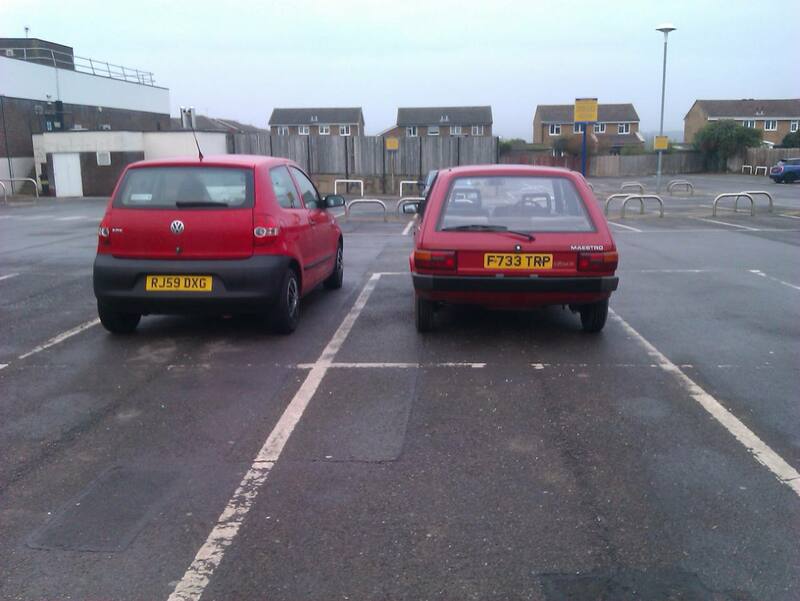

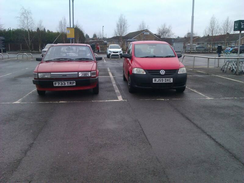

On 1/11/2021 at 7:22 PM, vulgalour said:
A boring base spec hatchback, and a Maestro.
Just look at the size of the windows on the Maestro compared to the VW ! Cars have really gone backwards in the respect of visibility.
Doesn't the Maestro now look so deliciously cool & 1980's. It was a good shape, IMO aged much better than say a Mk3 Escort.
