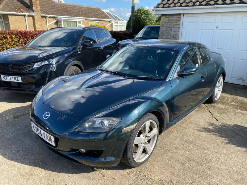

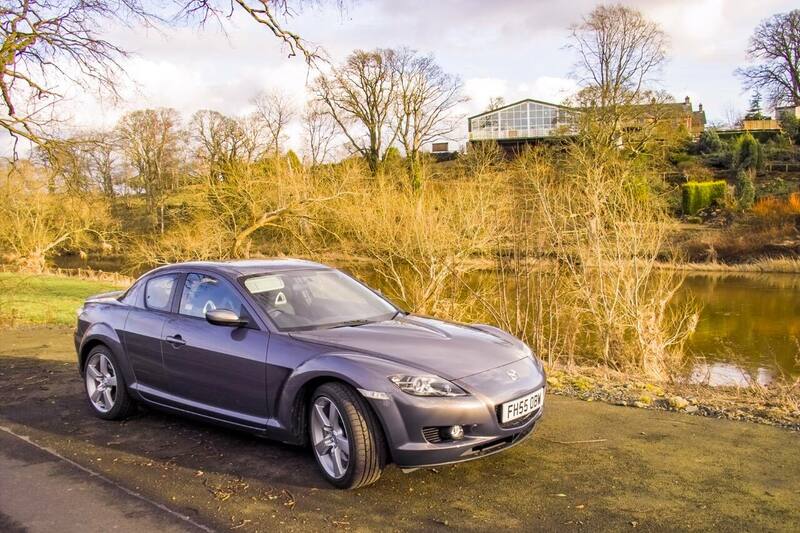

Bear Posted May 7, 2022 Author Posted May 7, 2022 36 minutes ago, Liggle said: Great buy, look forward to seeing how you get on with one, I've always fancied trying one! How many hundreds of pounds did it cost in fuel to get home?! It's on 1/2 tank and 148 miles. It took £80ish of Super Unleaded when I filled it at just above red-light roulette time... My old 192 used to return up to 33mpg, six port models are supposedly less economical, but I reckon it's not too far behind. The RX8 o.c. has a thing about '300 miles to a tank' which I was reminded of; my 192 would regularly get 325 between fills, and I once got 345. Gauges aren't accurate and there's no trip computer so we'll see where it is when I fill it up again. Also that includes about 40 minutes of 'idling + crawling' to cover 2 miles at Dartford where 40 minutes of 'working' would get me 30 miles... so that's a LOT of wasted fuel (thanks, M25). Thing is, like any car - use case. If you drive around towns, do short drives, it'll be awful. When I had my new one I never drove it to the shops - shortest trip it would do would be 15 miles on country roads, always allowed to warm up <4,000 rpm then warmed and beeped. It was more economical than my 1.6 Beetle Cabrio, which at (the legal limit for the roads honest) the speeds I drove in the Borders would struggle to deliver 30mpg. The eye-opener for me with cars/fuel was my 480 ES 2.0 auto. That could do 40mpg on a good run, but the live MPG readout was unusually clear. I lived 2 miles outside the town (Ednam to Kelso) and if I wanted to go to the shop, it reported 10mpg when first started and almost all the way to town, it'd creep up to 17mpg as the car began to warm up just in time for me to switch it off. I stopped shopping in Kelso and started saving my shopping trips for longer drives elsewhere... But likewise I had a Renault Clio, the round blobby 2000s one - 1.6. It did 24mpg when it lived in Birmingham and never left the city. It's why I'm so happy using a plug-in hybrid and quite happy to promote that solution for towns/cities, the 3008 does regular 1 mile to 15 mile round trips around Boston without ever starting the engine. Just wish they could make the car bodies lighter to compensate for the batteries. Of course all of these costs pale beside the Cruiser's tax. £53 a month! FOR THAT?! Liggle 1

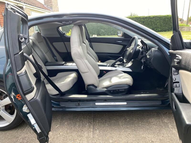

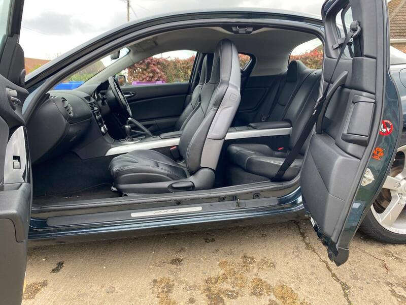

Bear Posted May 7, 2022 Author Posted May 7, 2022 Is that not one of the best "you could buy this for £20K" interiors of the mid 2000s? Poking around the engine bay: Liggle, DirtyDaily, Vantman and 2 others 5
DirtyDaily Posted May 7, 2022 Posted May 7, 2022 Is that not one of the best "you could buy this for £20K" interiors of the mid 2000s?Really couldn't agree more. I need to have a look at the classifieds. I think these RX8s are so severely under valued. If it was identical with a piston engine this would be worth S2000 money. Forums are really bad for my mental health seeing stuff like this all the time. Bear, gadgetgricey and Liggle 3

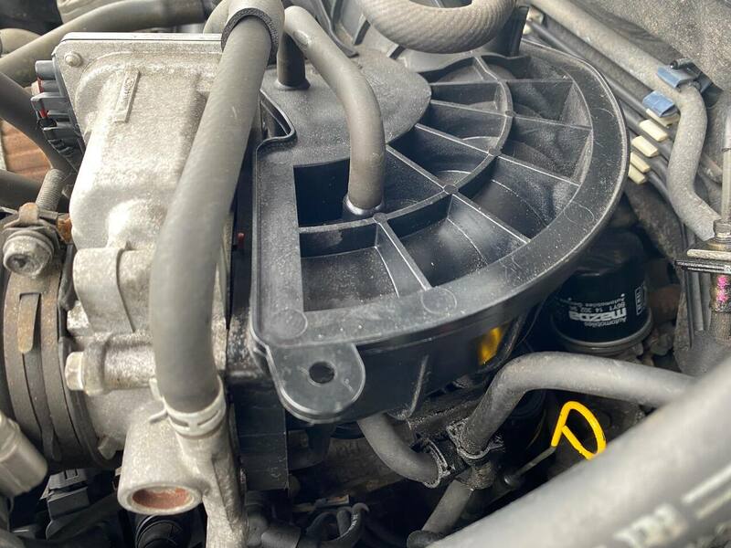

Bear Posted May 7, 2022 Author Posted May 7, 2022 I think I've solved the 'not sure if it's down on power'; codes 2008/0661 which both imply a problem with the inlet manifold valves; it's had issues with SSV in the past but they're vacuum solenoids so... I'm thinking replace some vacuum pipes and get some contact cleaner on sensors, and rag it properly for a while. It's TRYING to work - I feel a change around 5000rpm as it presumably adjusts fuelling, then gets the wrong airflow and winds it back. Either way, 'it's just stuff'. Tempted to get a garage to replace/rebuild the calipers so I'm not wasting time not driving it.

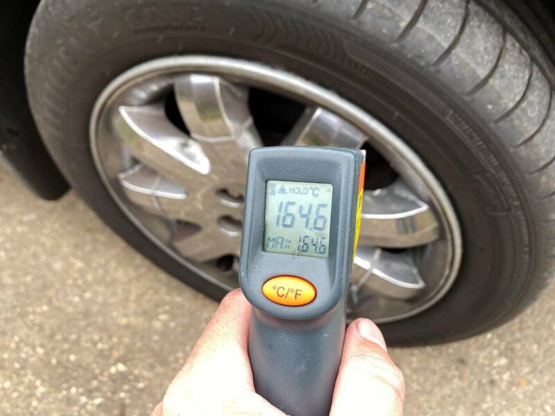

Crackers Posted May 7, 2022 Posted May 7, 2022 1 hour ago, RichardK said: Tempted to get a garage to replace/rebuild the calipers so I'm not wasting time not driving it. Seems to be a distinctly "2000s Mazda" character trait this. When their cars were so good to drive, why did they insist on making one of the most important bits ruin the fun? Bear 1

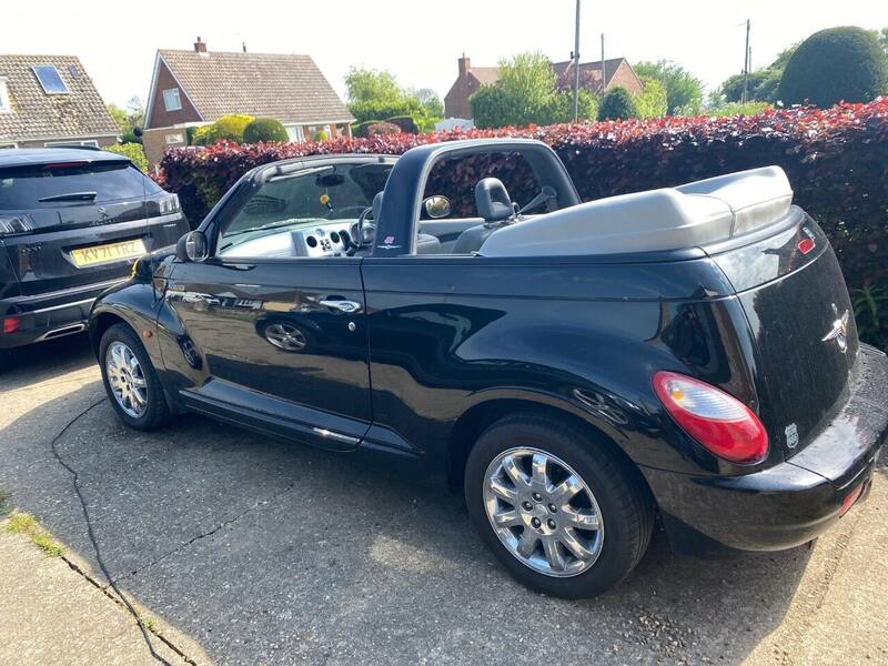

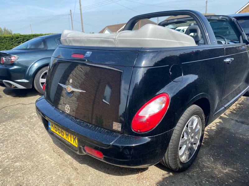

Bear Posted May 7, 2022 Author Posted May 7, 2022 Really cheap components 😕 OTOH really cheap car, so... The Cruiser got some attention: This car has had the same owner from 2009 to now, apparently. Always serviced at the same Derbyshire garage. It's had wishbones and bushes yet has a steering wheel at an angle and all the directional stability of a giraffe on ketamine, and guess what - if these plugs have been changed I'd be amazed, but two of them were spin-out by hand tight, two needed the "tap ratchet with palm" caution that experience of stripped alloy head threads brings. One looks like a replacement but it was the "easy to get to" one. I put Iridium plugs in with new leads and torqued "hand tight" as they don't have compression washers; will recheck after a few miles. New PCV valve but the (original) one still rattled so maybe didn't need to. Difference in performance and smoothness of idle is astonishing. It feels like a different car and much less "sickly". Slightly concerned by the oil around the plug body (that was one of the loose ones) but the sparky ends look okay. 13 years. Elderly woman owner. Many receipts. These plugs. Asimo, rainagain and Jim Bell 2 1

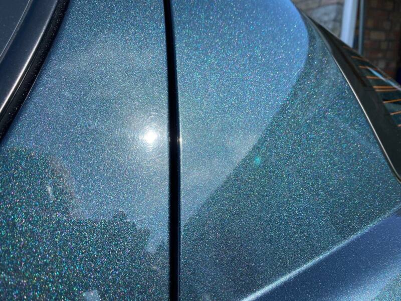

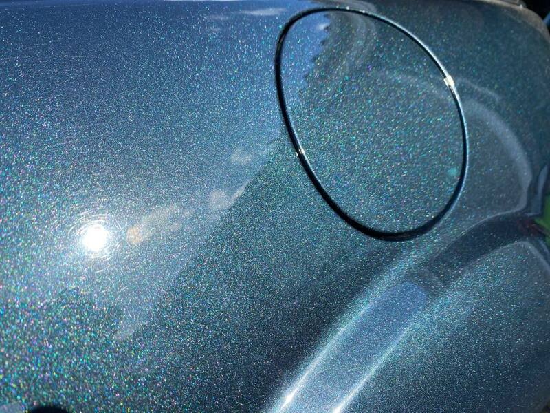

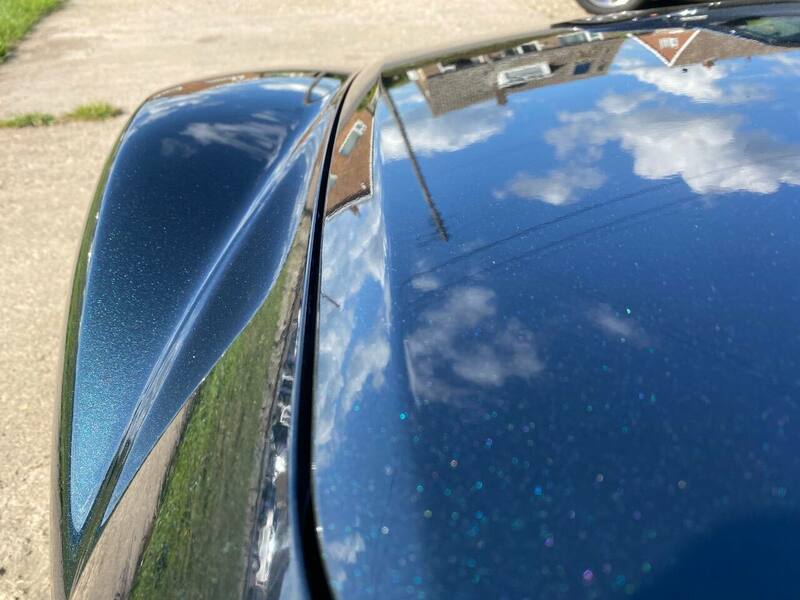

Bear Posted May 8, 2022 Author Posted May 8, 2022 Definitely needs a clay bar and deep polish day... rainagain 1

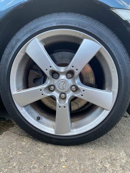

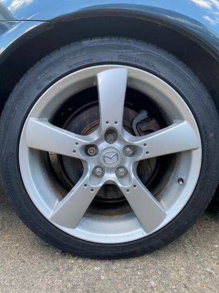

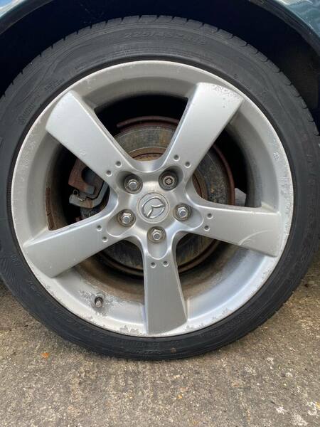

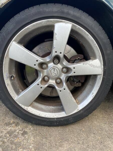

Bear Posted May 10, 2022 Author Posted May 10, 2022 I've made enquiries about getting someone to work on part of my car... Specifically getting the wheels refurbished. Because this: Looks so good like this: Until you spot: It looks like it'll cost £240 but that should be a very thorough job. Then I need to refurbish those calipers, they look terrible. EBC slotted/drilled discs and good pads will finish the job. And off goes the Range Rover. Here's why the RX-8 wins. 2006. rainagain, AnnoyingPentium, mercedade and 1 other 4

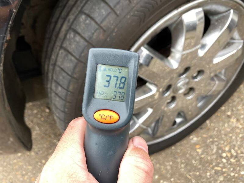

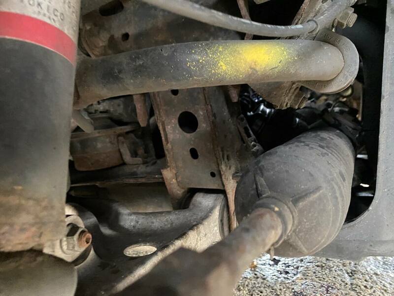

Bear Posted May 15, 2022 Author Posted May 15, 2022 Good news/bad news: Went to collect a bonnet. Stopped to put roof up, pulled away, car felt wrong. Very annoying. So I decided to grease the RX-8 steering as the last MOT advisory said "rusty steering components" and forum says "blast UJs with bike chain grease". This isn't what I was expecting to see. This car is really winning me over. Even the headlights washers work. Coprolalia, timolloyd, privatewire and 3 others 6

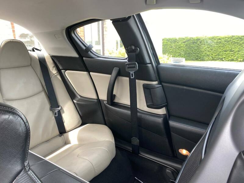

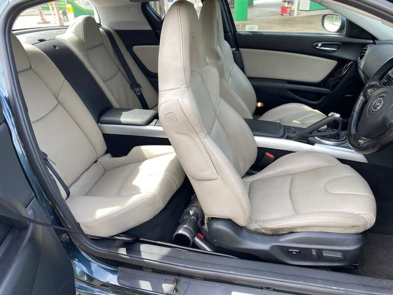

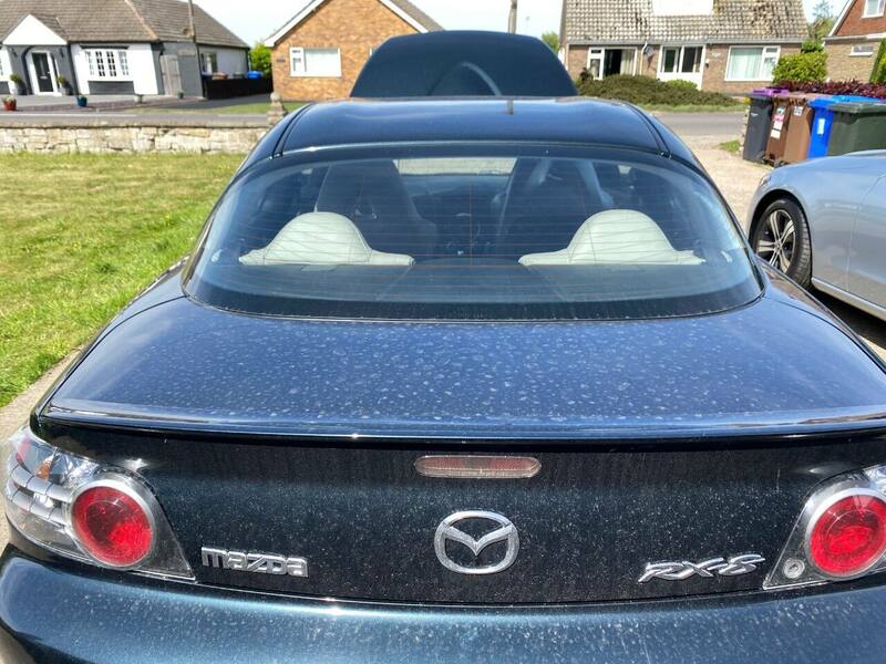

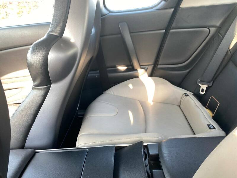

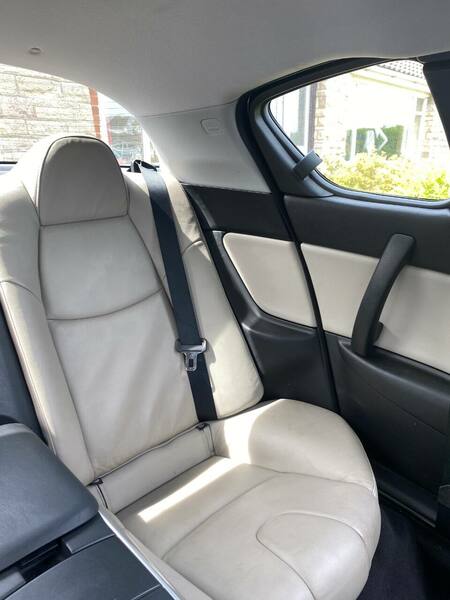

Bear Posted May 17, 2022 Author Posted May 17, 2022 So... I no longer have a car with a lovely light leather interior, this will not do. Spare wheel! Wish I could have bought three more like this... Clean first, then fit: Nordic green with stone leather. Not an option Mazda offered AFAIK but it is one of my favourite combos... Some body colour and new seat... Shite Ron, Liggle, privatewire and 1 other 4
GarageOfLuke Posted May 17, 2022 Posted May 17, 2022 You're working fast with that interior! Can't wait for the full photos once all in, it's a fantastic combination, as you rightly said. Bear and Shite Ron 1 1
Bear Posted May 17, 2022 Author Posted May 17, 2022 Fast is probably not a fair assessment with the rear seat bases, I've spent longer removing an ashtray! I'm giving the seats and clean and condition before fitting them, but if the car makes it to next week with black ones left I'll be amazed... thankyou for the chat, interior and wheel, it was great to meet you. Shopping for cats now, unsurprisingly!

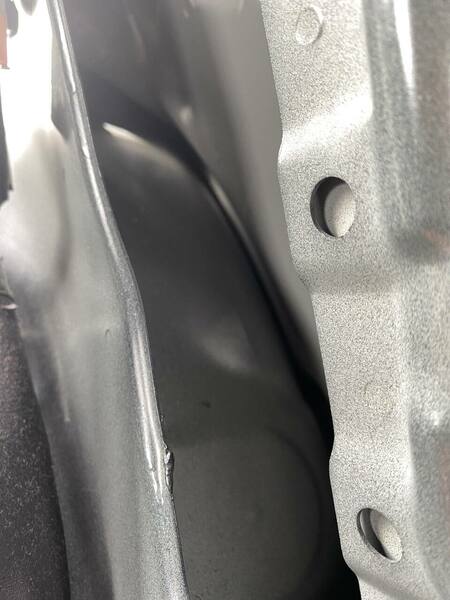

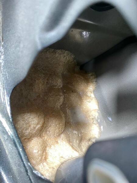

Bear Posted May 18, 2022 Author Posted May 18, 2022 After some adjustment of the mounting hooks, and some swearing at a trim clip that didn't want to leave home... Still need to do front: Why of course this is now full of waxoil spray... Except for the foam-filled sills. That's a wonderful* idea for rust, isn't it... Shite Ron 1
Crackers Posted May 18, 2022 Posted May 18, 2022 23 minutes ago, RichardK said: Except for the foam-filled sills. That's a wonderful* idea for rust, isn't it... If that's closed-cell foam and adhered properly to the e-coat it shouldn't* let any water through. Not to say that it doesn't, though.

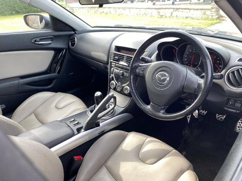

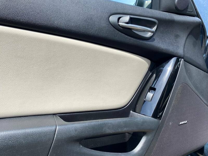

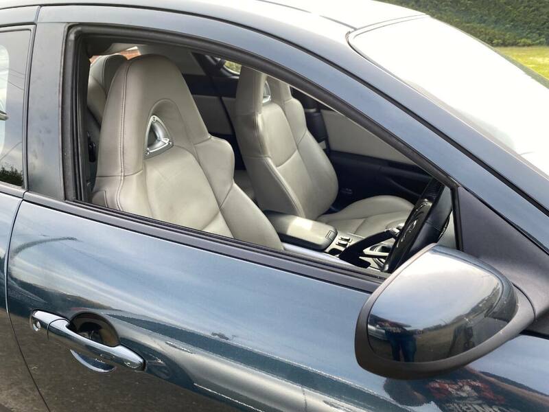

Bear Posted May 18, 2022 Author Posted May 18, 2022 Yes. I think that was worth the effort. Dirk Diggler, Zelandeth, gadgetgricey and 4 others 7
Zelandeth Posted May 18, 2022 Posted May 18, 2022 Absolutely. The black hole approach which seems to be the universal model for modern car interiors is something I really despise. That looks way better. Shite Ron 1

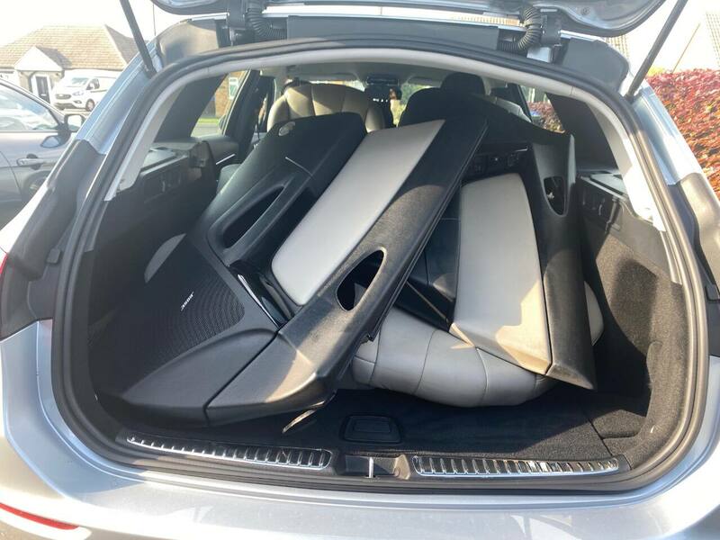

Bear Posted May 18, 2022 Author Posted May 18, 2022 Nailed it! 12 bolts - four per front seat, two per rear side - 12 screws (three per door). The rest is clips. If I weren't in pain etc I think I could strip an RX-8 interior fully and without damage in three hours. DVee8, gm, GarageOfLuke and 5 others 8
Crackers Posted May 18, 2022 Posted May 18, 2022 6 hours ago, RichardK said: That's a big if 😂 It should be, I'd really hope! Open cell foam wouldn't give half the sound deadening of closed cell. Bear 1
