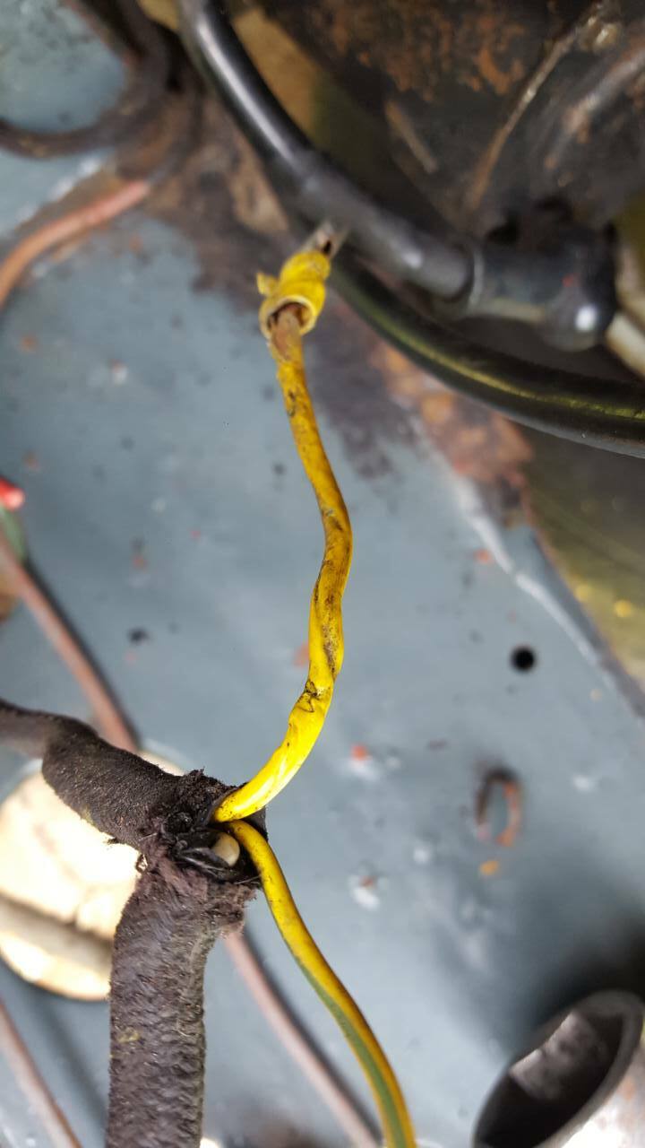

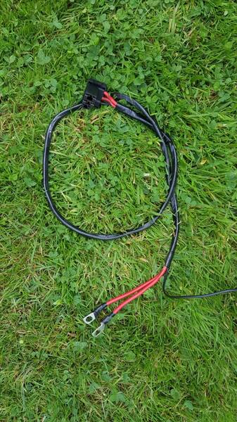

But i have had time to sort out the alternator wiring on Boris.
I purchased the correct plug and ran a fresh loom straight up to the battery via the starter solenoid terminal.
Much better me thinks especially as the original (dynamo) single charge wire was showing sings of overheating.
I think i need to look at fitting a good quality replacement fuse box too as the lucas one is very baggy and tired.
And as the dynamos redundant regulator is  now only used as a convenient juction box i may well do away with that too and fit a modern water tight juction box in its place.

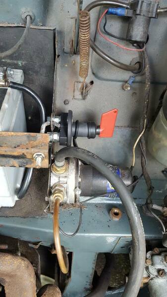

I am not a big fan of these battery cut off switches but i had it going spare and to save drilling mounting holes and finding another earth lead i bolted one of its terminals directly to the body of the car.
It can't hurt and might slow down a thieving shit a for a little bit (if i ever remember to use it).

I have replaced the redundant regulator with a small junction box instead (£5.00 from Tool station).
And i have a modern fuse box and some decent spade terminals coming to tidy up the messy wiring.

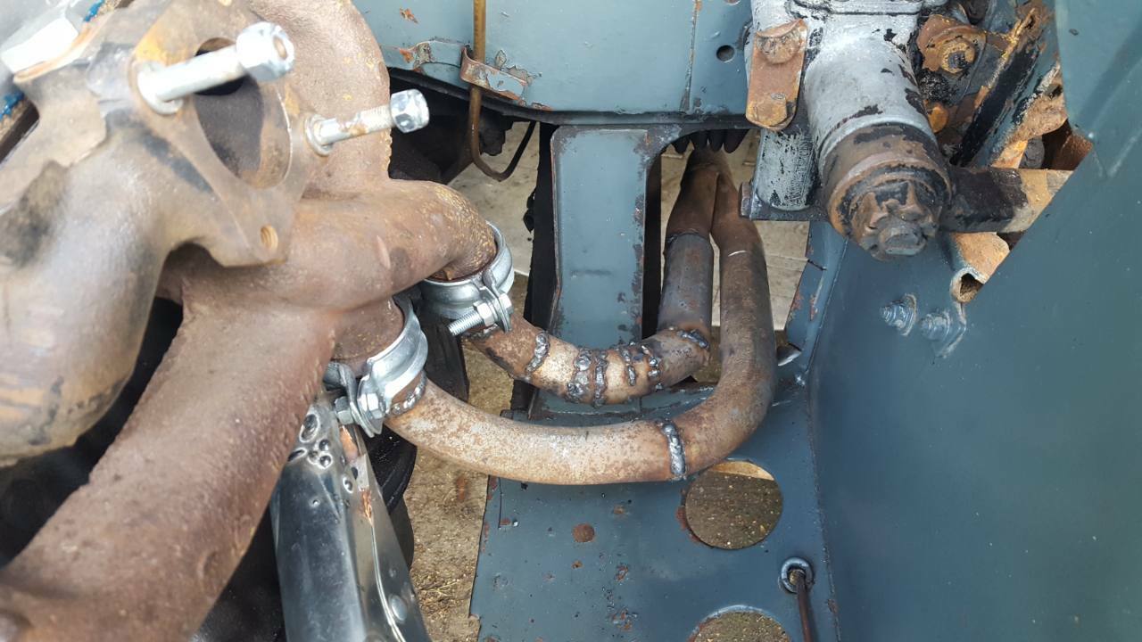

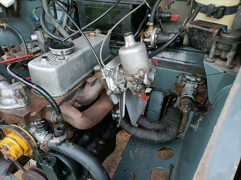

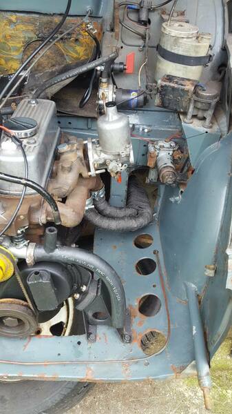

While i still had my arse in gear i made a start on modifying the Marina down pipe to fit the Minors engine bay.
The front downpipe was easy enough.
The rear one is being a right bugger but i think i am getting there now.
I will have a dig through the scrap metal bins while at work during the week to see if i can find any preformed bits of pipe to improve its appearance further.
Once i am happy with it i will put it on the bench and weld it up properly.
And i have some exhaust wrap somewhere to lag it with to try and keep the heat off the fuel pipe directly above it.

Well i completed welding the down pipe and it looked really scruffy so i dug out a long forgotten roll of exhaust wrap to make it look more presentable.
Stupidly i didn't cover my arms or wear gloves when handling it and so had the joy of stray fibre glass strands irritating my skin for the rest of the day.
And i need to find proper cast iron clamps as these cheap pressed steel ones are total pants.

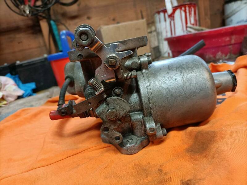

And i have purchased a bigger carb to replace the 1098cc currently fitted.
1 1/4" vs 1 1/2" SU carburettor.
My replacement carburettor's tag identifies it as originally being fitted to a 1275GT mini so it should do the job.
Ideally i wanted a later/bigger hif44 metro 1300 carb but they command around a £100 second hand and i won't pay that kind of money,looking in to the future i would like to have a go at doing a home brewed injection set up using a simple single point injector body from something like a 90's Pug 106/205.
I still need to find a suitable inch and a half carb spacer and mounting bracket.

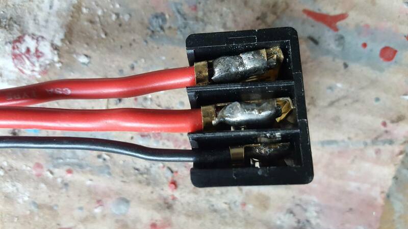

 Very neat.  You’ve pissed of Prince Lucas, he will no longer be able to bring darkness and smoke to that set up.
I purchased some flash spade terminals which crimp on lovely but need a 2000w heat gun on full chat to get them to shrink snuggly onto the cable.
That fuse box looks fantastic. I'm using a very similar setup in my Moggy but your install is far far neater. The junction box to do away with the regulator is an idea I will definitely nick as I also have an alternator :).
I'm not sure they're designed to shrink like that.

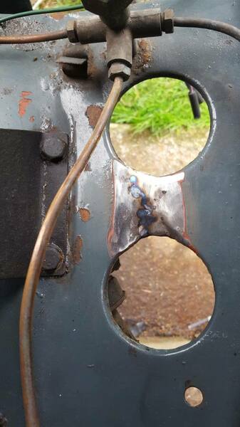

I've done a bit more welding to the floor and sill but then killed my phone and lost all my stored images.

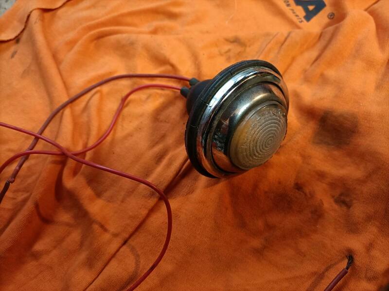

For ages I have been looking for a pair of cheap early Lucas side lamps to use as front indicators and recently found a pair and with an amber led bulb in them they are bob on and just what I was aiming for.

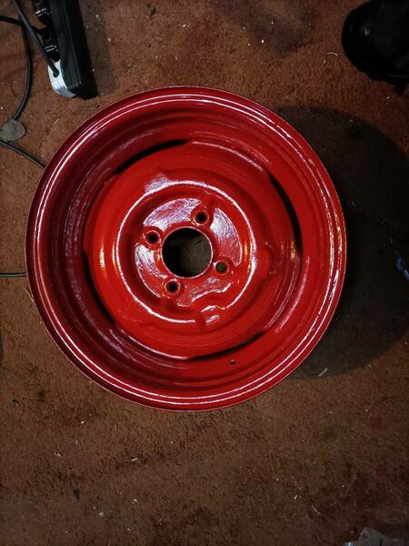

I have knocked up the final two Focus/Minor wide wheels and they just need better weather to get the Paint to flow out nicely.
And I didn't notice that the 1275cc mini carb I got from ebay didn't have a throttle actuator on it.
I kept looking out for a second hand carb to steal one from but they all seem to cost upwards of £30 now days and I am way to mean for that but then one day I was skimming through eBay and found a guy selling all sorts of SU carb bits who he had the correct handed lever for £8.

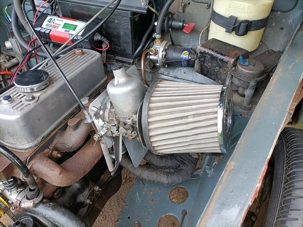

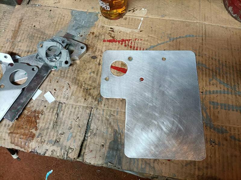

I have made a simple aluminium shield to protect the carb and fuel pipe from the heat generated by the exhaust.
I also bought a gauze filter meant for a Mini but it was really poorly made Chinese tat so I sent it back.
So a plan B was required.
  • Like 6
Plan B involved fitting an old aftermarket Toyota Supra Cone filter with a 70mm flange on to a carb with an inch 'n' half orifice.
A couple of bits of 1.2mm Zintec and some cutting,drilling and weldage produced a half tidy adaptor.
