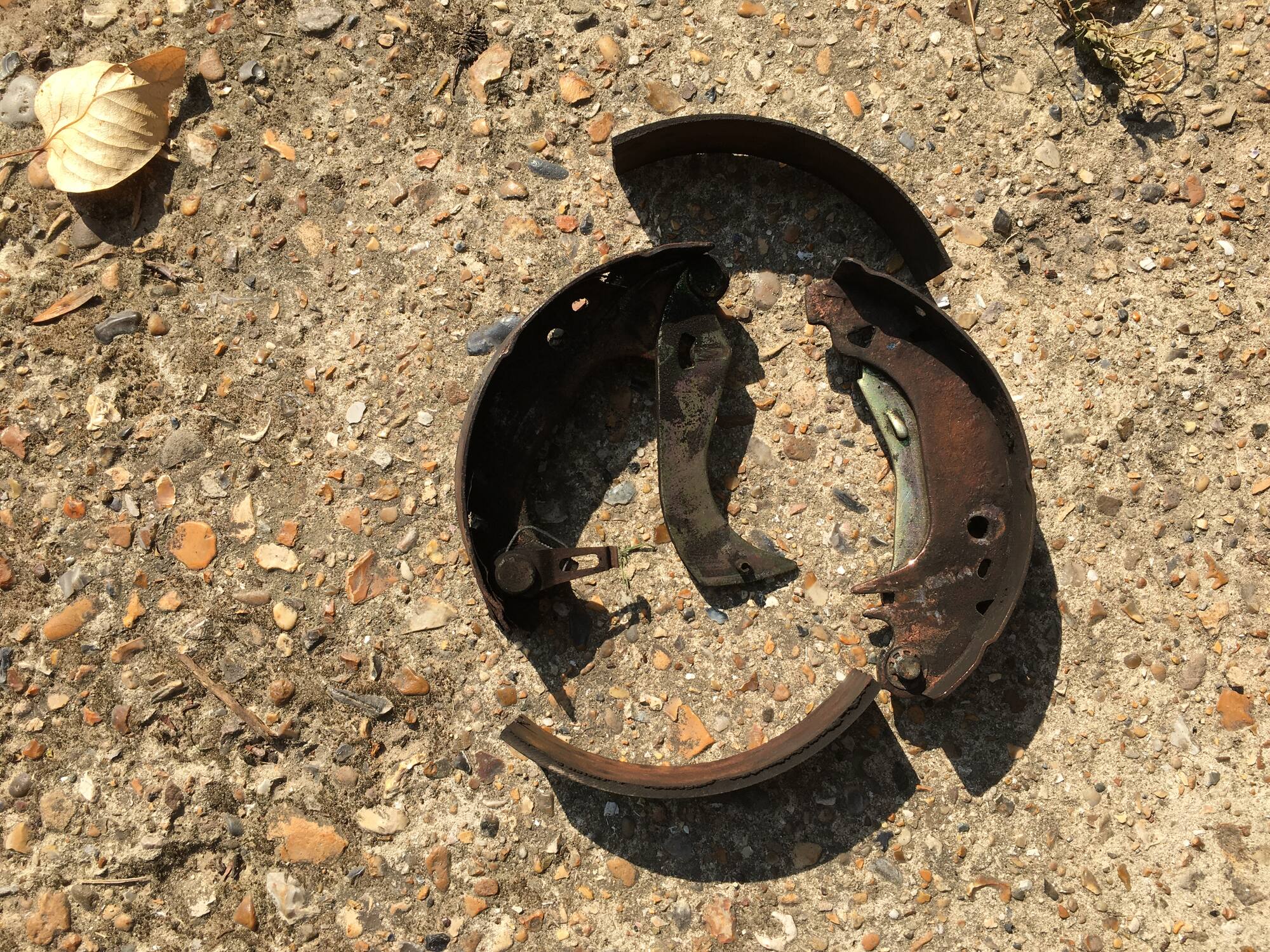

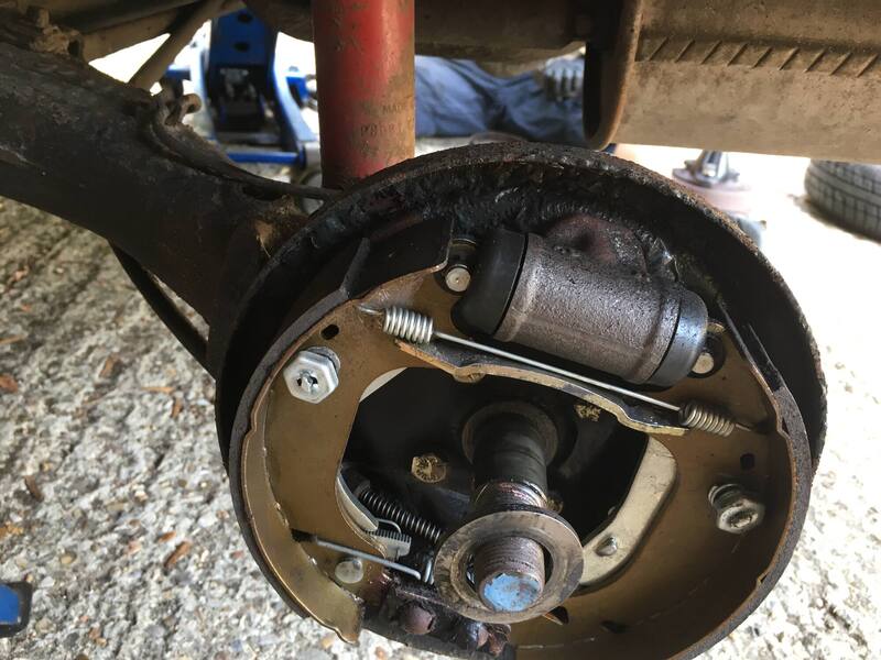

Err....no....problem solved............took one wheel off to discover new brake shoes, wheel cylinders and other shiny stuff. Spiffing..............
Removed other wheel, drum came off with a fight, to reveal very old brake shoes, in rather more parts than was originally intended. Found three boxed sets of brake shoes in the boot, one box containing only one shoe..
Conclusion........someone decided to do the rear shoes, did one side, then couldn't get the drum off...and gave up. The friction material separated from the shoes, which was floating about in the drum, causing the intermittent and horrible drone.........
Stupid Previous Owner Trick.
