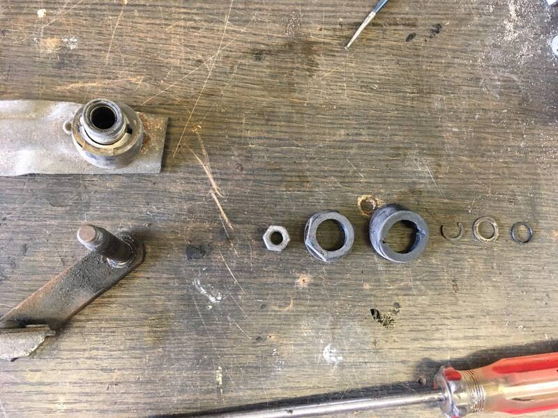

The spring sits in the propshaft sliding joint against the gearbox output shaft. Most people don't expect to find a spring in there and they end up on the floor being  found after the car is back together and drives okay. This spring preloads the short propshaft in the axle extension housing against the pinion shaft thrust mushroom (engineering porn!). Some cars work OK without the spring, others knock like buggery over bumps and it's the short propshaft floating around on the donut mounted bearing hitting the extension housing and thrust mushroom.
I too did not see a spring...... this may be something I’m going to have to source 🤔
I’m fairly certain my 16v doesn’t have one, and that’s fine. But like you say, some are ok some are not.
edit. Just had a look on Edelschmiede website and they supply the spring for 4 and 5speed transmissions. €9.95, plus €18 postage! So I’ll save that until I need a few more bits.

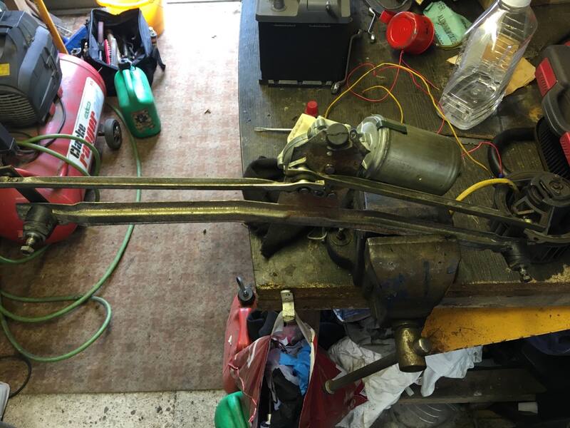

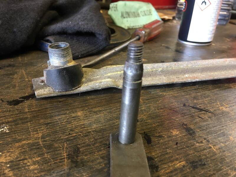

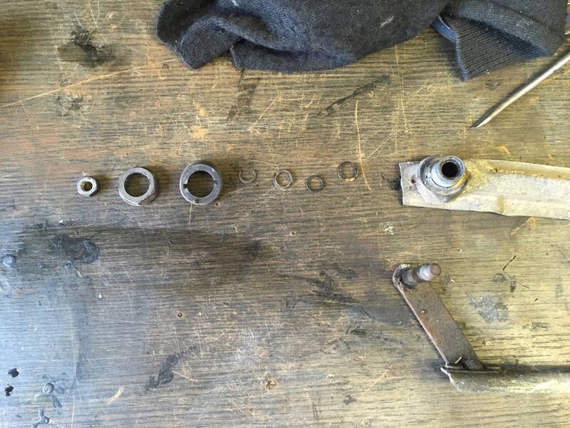

More work done today. Stripped and cleaned the wiper linkage spindles. Fitted the NOS motor and bench tested it. Works a treat.

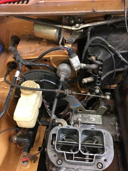

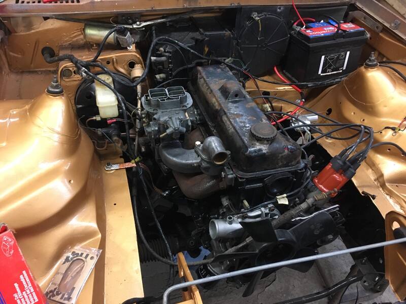

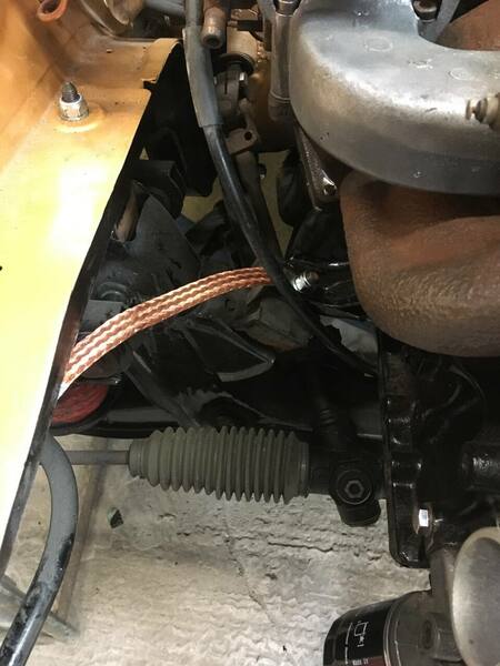

@sutty2006 That photo brings back a lot of memories,  good & bad! I'm not being picky, I don't remember ever seeing an engine earth connected where you have it. I may be wrong, I think they went directly off the block near the front to a captive nut under the chassis rail in front of the suspension crossmember. Looking good though, easy to get disheartened with projects and I've been there many times, even ones I'm paid for!
While its  feels demoralizing Sutty you are making progress  and it's way better to find out these snags now  than at the last minute, especially with the clutch cable. Far easier now than when its nearly all buttoned up and you have to take bits off, out or apart (again)  Have a like especially for such a nice clean engine bay.
I think you’re right there. I couldn’t remember where it went, and remember when I built my red one back in 2007 it didn’t even have an earth cable, so it found it’s own earth through the original clutch cable so I chucked one on there. Will have a look for the captive nut in the chassis, if it’s there I’ll relocate it.

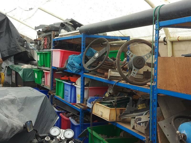

You can't see half of what's in there let alone the loft! I'll post a sneak photo of the Manta later, it's in the Carcoon at the moment.

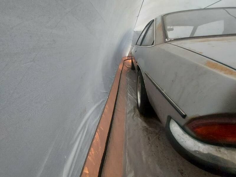

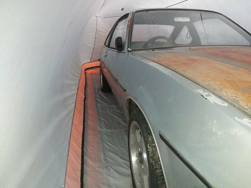

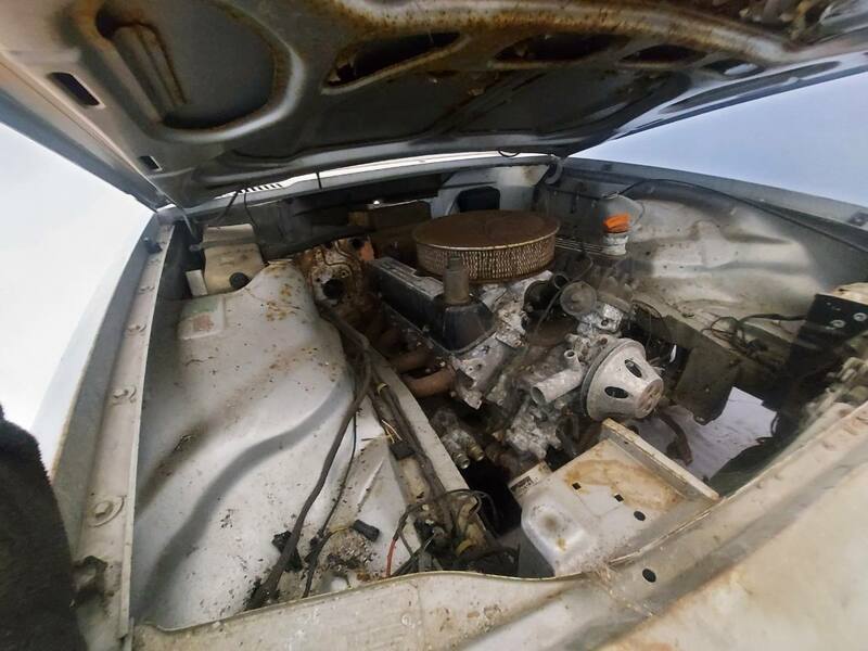

I climbed in and took photos as it was raining, really needs the top off but then you have to vent it to keep the damp out but you get the idea, a rusty Manta Coupe with a V8.

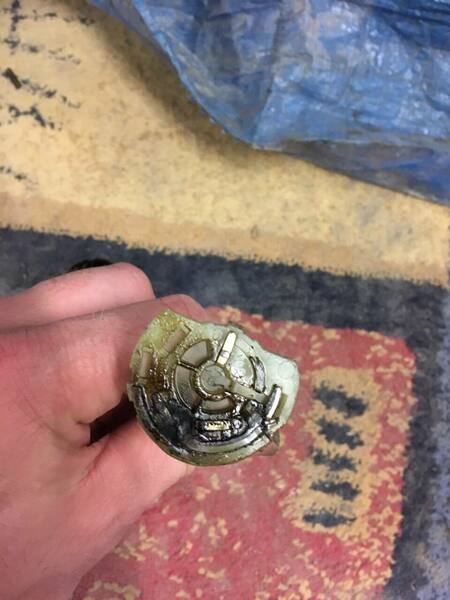

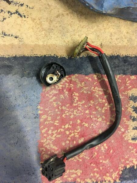

Fitted the ignition switch. Connected battery up to see if ignition comes on. Nothing. Attempt a crank (oooooo errr) and it went click then nothing.....just smoke out of the dash. Ignition switch locked open in the crank position inside the sealed part so that’s busted. Two more switches now en route.
also attempted repositioning the earth cable. Unfortunately it’s too short to reach the block. Disappointing as it’s bought from a company that make parts for the manta, so not pleased.

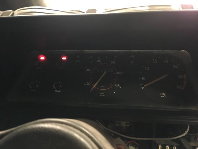

ive got another ignition switch and fitted it. Then cleaned up all the earths and we now have the engine turning over by the key. Grand.

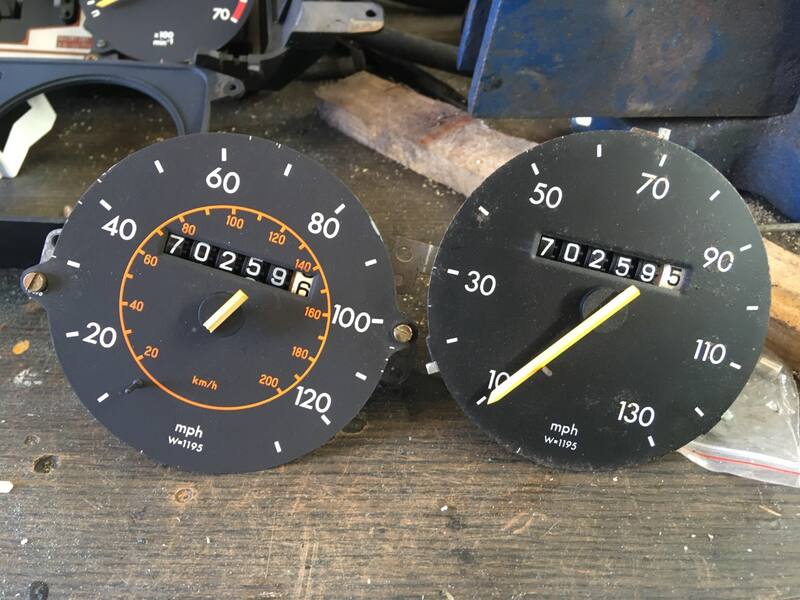

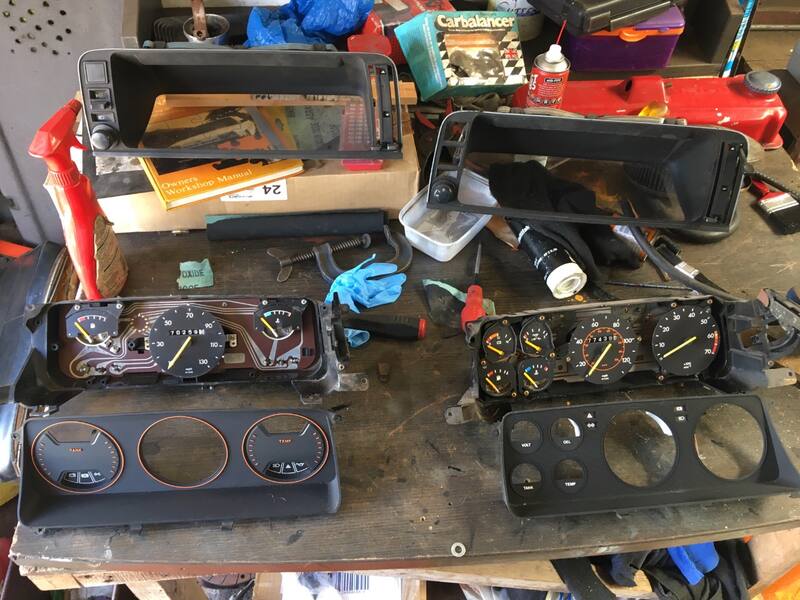

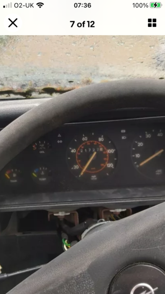

but I didn’t have any ignition lights. I thought long and hard about the parts that I’d been using. Wiring loom came from a blue berlinetta (that the drivers front wing came from). That model was a 78 which had a 6 dial clock. My original clocks were phased out after 12 months.
original
and the later ones

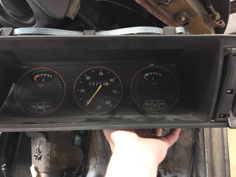

so I knew I had a shit load of clocks up the unit so I went up this morning to look, and found a set of the 6 dial clocks. Bingo! Fit them in and connected up the battery and you guessed it! Ignition lights came on. Happy with that. And only 7k miles different to the original clocks. Do I strip the older clocks and put the original mileage barrel in? I think it’s worth it. EDAFE2E5-D3E0-44E5-BE58-39A782E346DA.thumb.jpeg.09953f0a72e8c4b1a6f47439c4ce5ec8.jpeg
It is possible to fit a 6 dial dash to a base model car by swapping the plug pins around and adding the extra plug for the tacho.👍
Going well, keep up the good work. 😎
Yeah I thought it would be fairly straight forward, however somehow I managed to break a couple of pins off the back of the clocks…..no surprise really as the whole thing was covered in rust, and I did what I could to resurrect it with parts from another dash. I’ll keep hold of it for now, just in case.

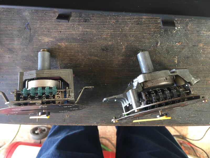

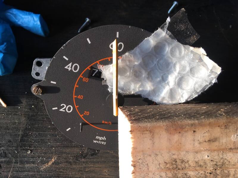

I’ve started to strip the two dash clocks down. Aim was to swap the barrels over but they are different. The original tachometer won’t fit in the later clocks. So it’s time to wind the mileage back to match the original one.
I was unable to swap the mileage barrels over, they look slightly different. However the newer barrel roll pin came out far enough for me to attach a battery drill to, and put the miles back at half drill speed. Took the 7k off pretty easily. Then I broke the speedo needle off. Bugger. 54373ED5-D60A-476F-9157-705DCE95E9FE.thumb.jpeg.38462f48d22ff0998f6d0d35e0238894.jpeg
so that’s now in surgery. Can’t get the needle off the old clocks, they’re well tight, so I’ve had to fix this one using a cocktail stick on the back to keep it in position. 14773017-9C6A-46BC-BE5B-9B145A03EDF7.thumb.jpeg.ac79f8442ebb6e1461fcad4cda69b6eb.jpeg
