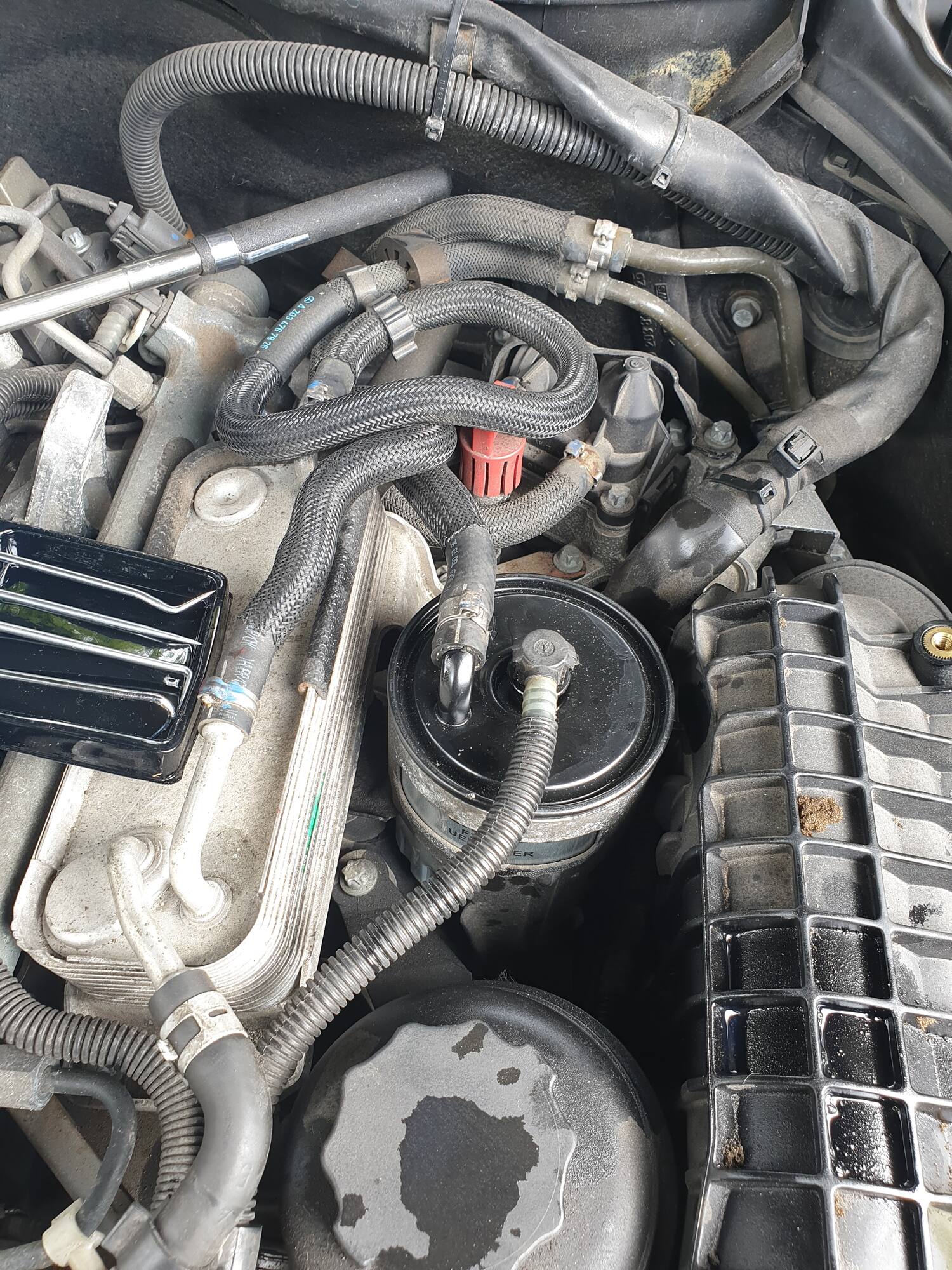

So I gave the Merc a service this morning.
Engine sits quite far back so after removing one underway the words "Goddddammmn!" Were uttered and a secondary slight further back positioned underway had to come off. All held on with 8km bolts which came undone lovely. Has anyone seen the underneath of one of these?? Everything is covered with plastic covers!! I thought engine bays were bad enough these days!!
Initial injector inspection was good. No black death here and the injectors were spotless as was the area around them. Ken had ordered new copper o rings and stretch bolts on my recommendation for that inevitable occasion they do go and to do them all but I said to just leave in the glovebox for now. Do not disturb them!
Oil filter was unscrewed, and the 3x small o rings changed.
Air filter also changed. Judging by the state of the existing one I'd say it was definitely due a service...what d'you reckon??...
Fuel filter also changed. Funny one these fuel filters.....impossible to gauge how old/long ago they were changed just by looking at them. I marked up the new one with today's date and current mileage.
Old one...
New one once fitted....
Plan oil and filter change every 5k and fuel filter and air filter change every 10k. Simples!
Looked clean inside the filler cap...do love these OM611 engines.....the air filter housings are sat on little rubber bushings! RESPECT for over engineering!!

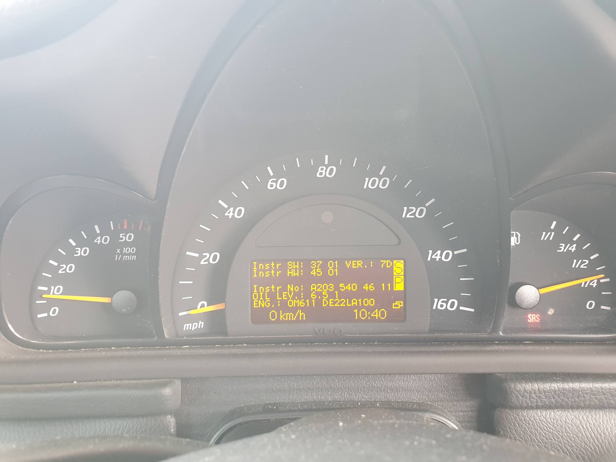

Oh and one other thing I forgot to mention was the business of filling her up with fresh oil. I knew these engines to take approx 6.5 litres of oil from back in the day when I had a load of w210 e class' as well as my Sprinter which is fitted with the same engine albeit with a different map. These c Class' being for economy whereas my Sprinter probably for torque/power given the fact that it's a van.
No DIPSTICK bar the one in the driver seat!!
So a trick way involving a sequence of ignition on/off and holding buttons for varying periods brings up a hidden display on the dash that once the engine is started brings up the quantity of oil in the engine via a live readout....
