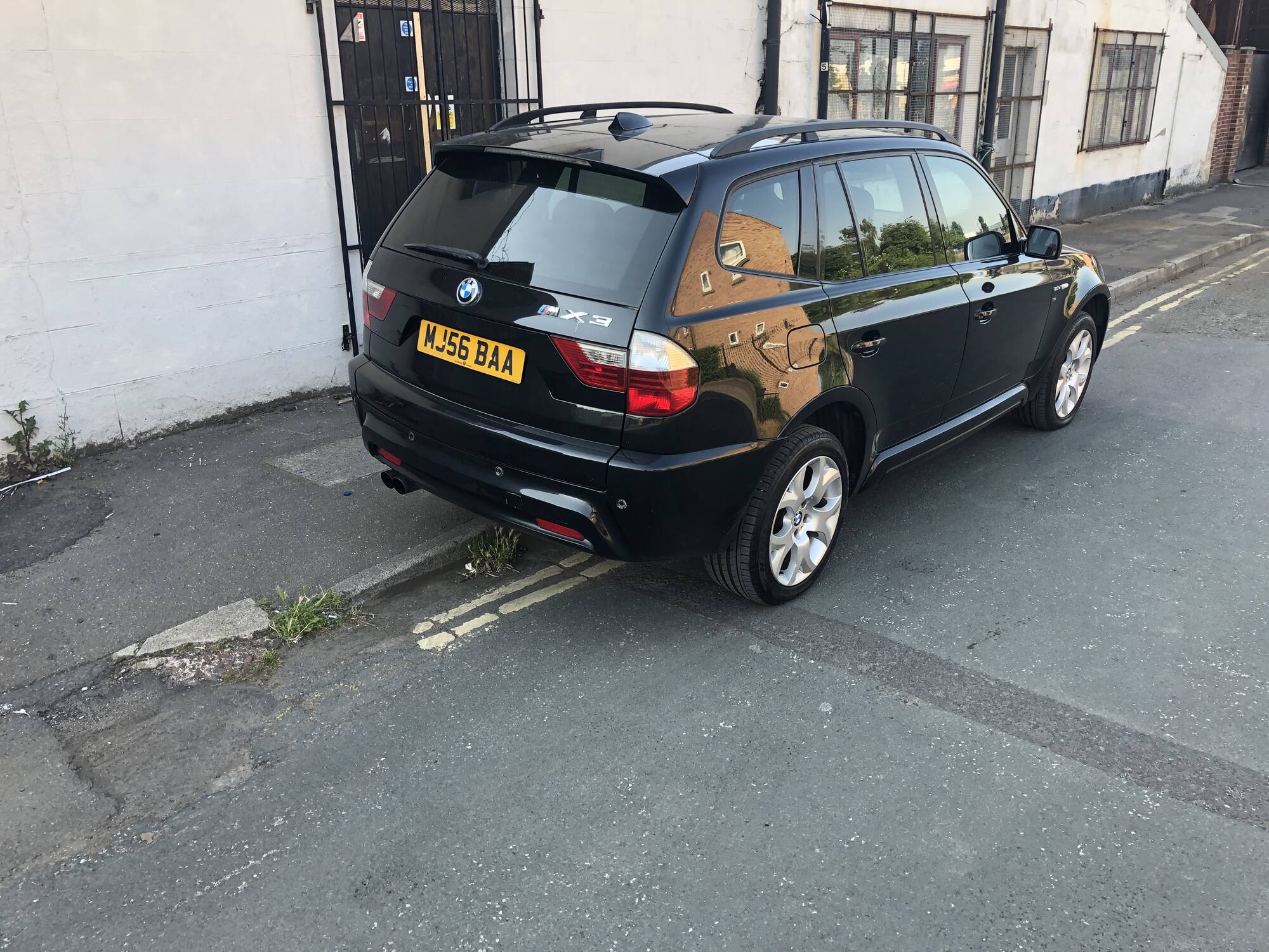

Was talking to the sister who made mention of swapping her car to something a little more sensible, cue an evening border raid across to North Wales to collect my new purchase.
Really didn’t need it as space is already at a premium, but it was very cheap, has minor* faults and is quite a rare model for a still common car.

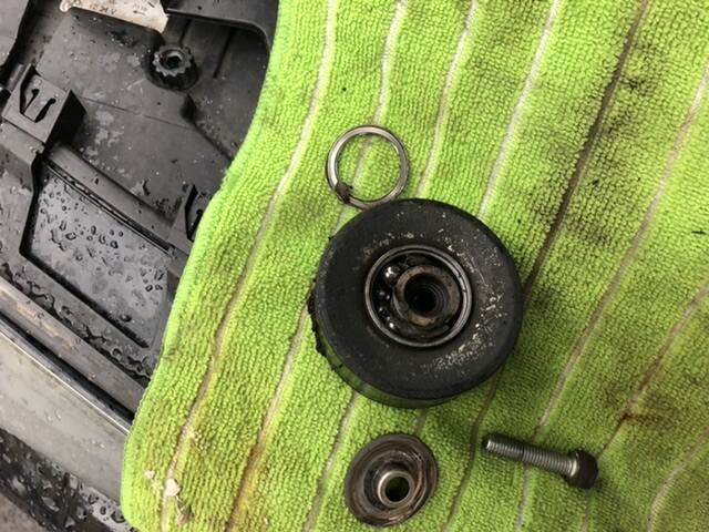

Shite journey back as just about every road was closed for road works and we were limited to 60mph due to a knackered wheel sensor causing issues with the 4wd and abs. The ungrateful thing then properly spat it’s serpentine belt out meaning no water pump or power steering for the last few miles ?
Anyway, it’s probably not really autoshite but I’m quite looking forward to getting it sorted in the next few weeks.
Oh, the interesting bit - 3.0 dizzler with a rare manual box and good trim level (plus swirl flap & dpf delete and remap ?)
Having driven it in the past I was genuinely surprised just how quick it is, as well as still being fairly economical.
Fairly minging inside and out, but sure there’s a reasonable thing in there with a bit of work.

This is what’s left of the idler pulley, just have to work out how to get the tensioner off as well - looking at it I think that will mean dropping the alternator off as well.

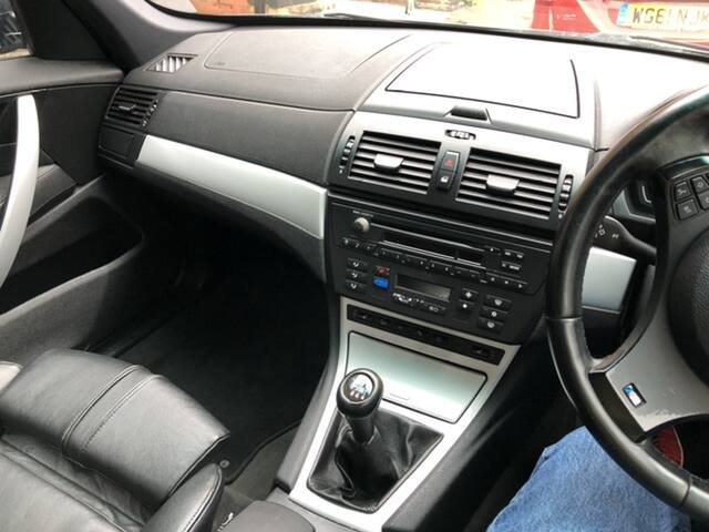

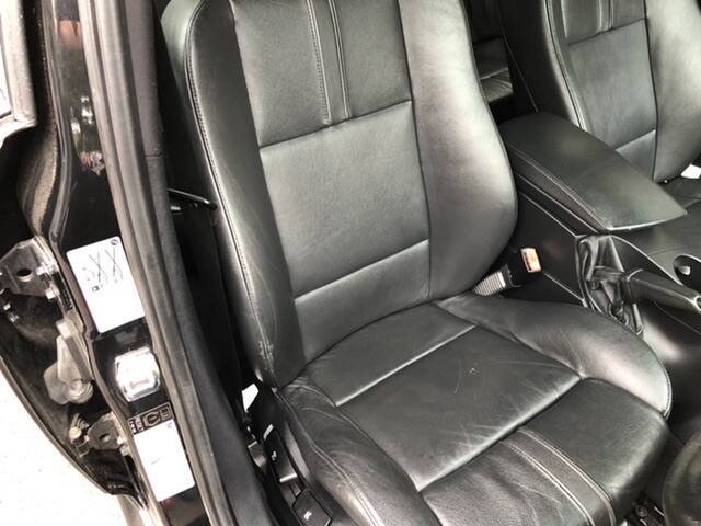

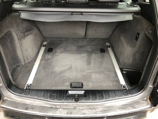

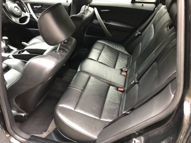

Did manage an hour or so on the interior and it’s not come up too badly. Slight bit of wear on the drivers seat, the passenger leg bolster keeps fully extending and an air freshener leaked and took the finish from a section of the heater controls. I already knew about this and have invested £15 in a replacement.
All in all really happy. The only bit bugging me is the driver’s footwell. It hasn’t had a mat in it for the last two years, so I may yet go to town and give it a bit of a wet wet vac.

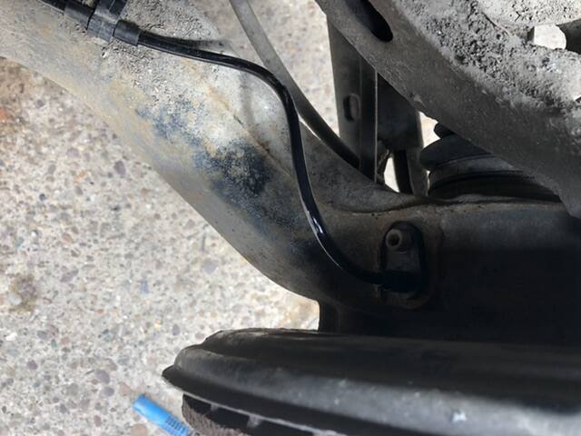

Hopefully just one wheel sensor left to fit!
I’d heard the wheel sensors could be a pain to get out so I drove to the unit, better tools for when things go wrong etc..
It was all done in 10 minutes, no broken bolts, nothing.
Cleared all codes and now have a light free dashboard ?. Being so easy I fitted the replacement heater control panel. It’s a slightly different colour, but I don’t think it looks out of place.

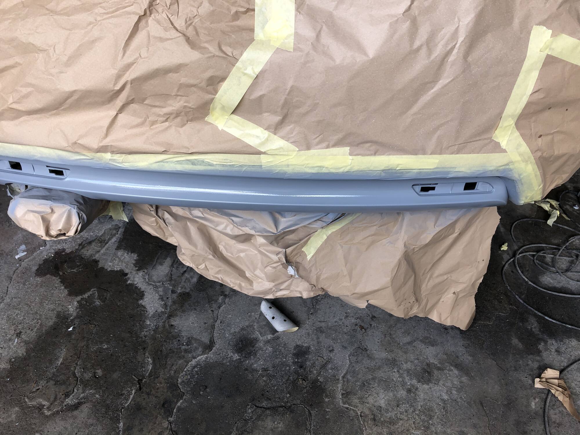

There were loads of dog scratches around the tailgate. Although I tried, things were a little too far gone so the satin black had to be brought out of retirement. While not perfect it didn’t turn out too bad!
All now done and doesn’t look half bad. There are a few pin dents on the back doors. I may get the dent man out to see what he can do, but that can wait until I know for definite there is no major drivetrain damage.
