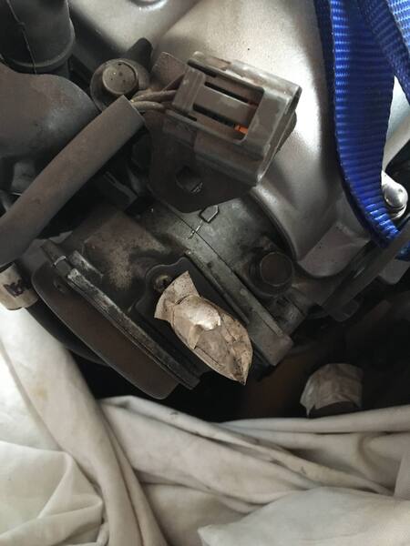

O2 sensor swap. It'a in a nice and accessible position. My 15mm compression nut spanner fit the sensor and refitting it was easy.cf369ee1d6bf995aecb3559f5c0dd942.jpg3a5974c95d53d91f1311e52484dbeb9b.jpgf3fddb783207fc1056ea155ff14e3d65.jpg

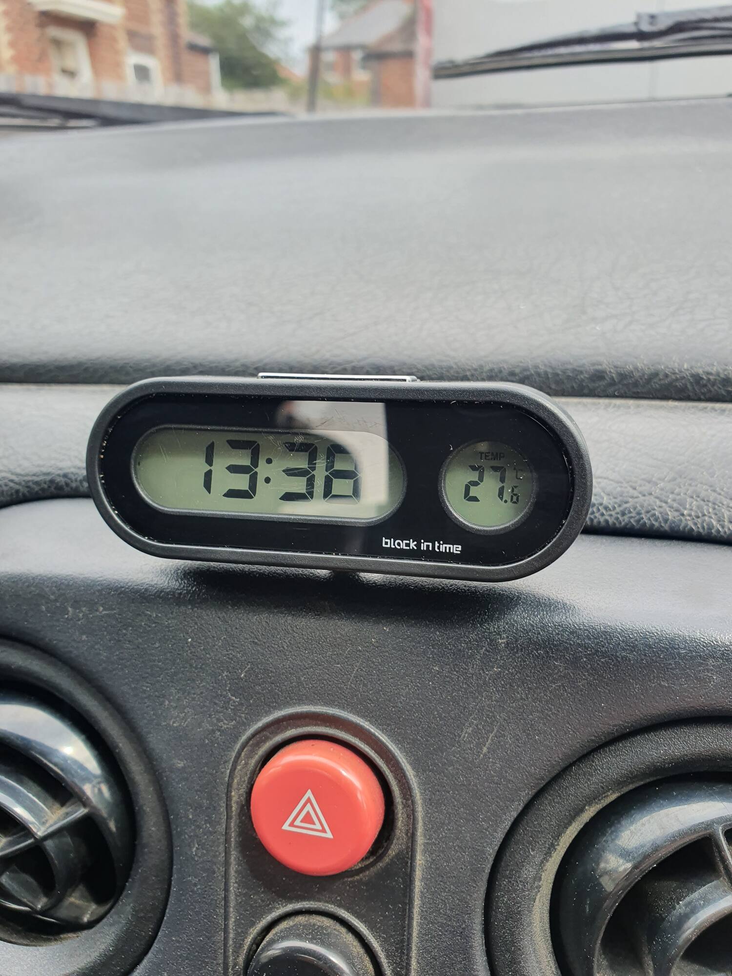

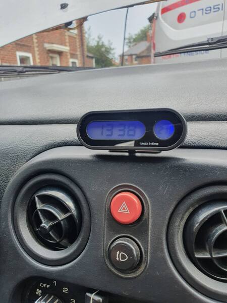

The lack of a clock situation was getting on my wick but easily rectified.
I put one from a Mondeo in mine.
After I ordered it, I found the radio has a clock if you press the display button. Typical.

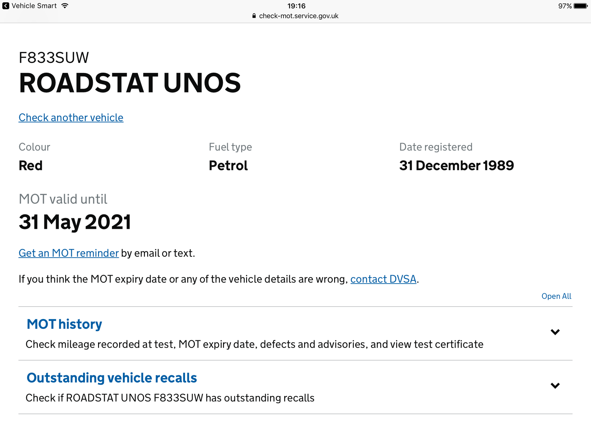

I found one of the first Eunos's made earlier on the internet which was an F reg! I always thought they started at G?
So did I. I've never heard of an F reg. Although early '89 was 'F'.
I forgot to add pics. Doh!
Oh that's grim
It’s in the for sale section on ‘The MX5 Restorer’ site.
Different clock
You were really lucky there to get that out without a fight!

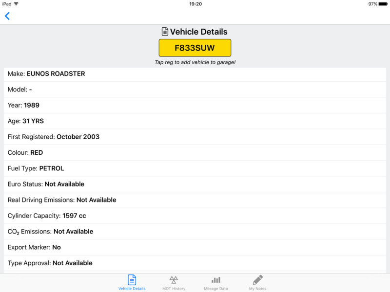

The F reg one above is an import, curiously registered in 2003 as a "roadstat unos" !

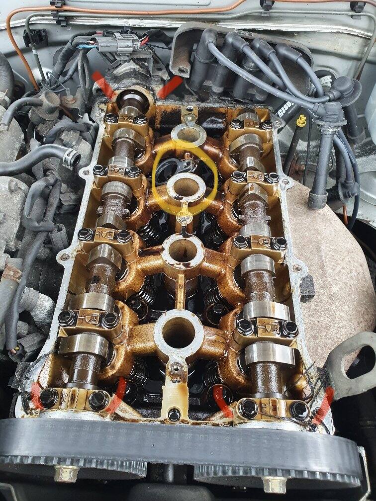

Attempting the cam cover gasket. Rain stops play. I'm unsure how to change that O ring at the back left hand side. I'll have to google it.
The rocker cover came off easily enough and the old gasket is rock hard and falling to bits.
EA159644-8A37-4370-8C47-6E4ACBAF32B1.thumb.jpeg.405c7e4381a3110b84b7a4a82d210b9f.jpeg89267ADC-238F-4C09-8CEC-FE3B687AA95D.thumb.jpeg.e417329c44a33a9323ebb85c3318750a.jpegLoosen off the two nuts on the ‘saddle’ over the cam angle sensor, on the back of the head you will see the bolt that locks the location of the sensor, mark the position of the sensor before removing this then the whole unit will slide out. Swap the O ring and slide it back in, line up the position with your mark you made earlier and your timing will be set correctly.
You’ve probably spotted it but there’s a rogue piece of gasket lying just next to your intake cam - mind to get that fished out :)
i usually put a wee dab of sealant in each corner where the gasket goes over the humps on the front and back.
