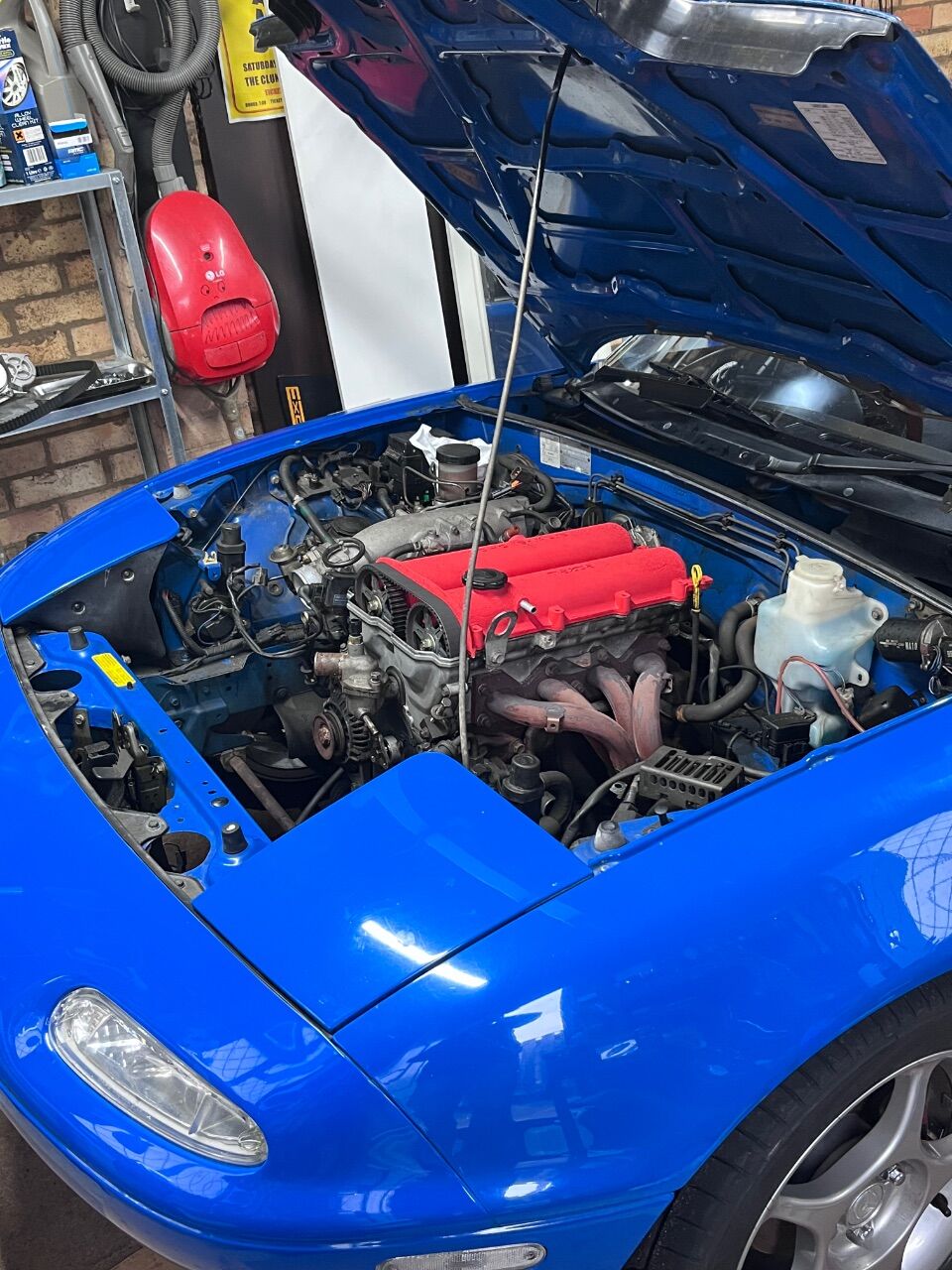

gm's unhealthy obsession with mx5s - must be summer - the toys are back :)

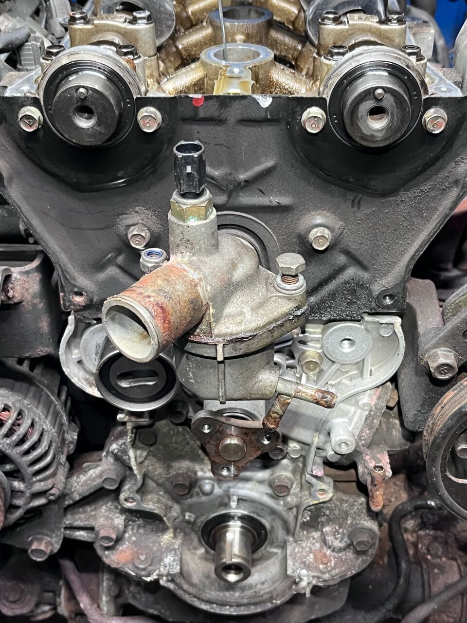

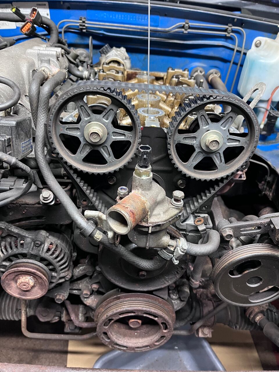

but if we're doing the cooling system, we might as well do the waterpump
and if we're doing the water pump, we might as well do the timing belt

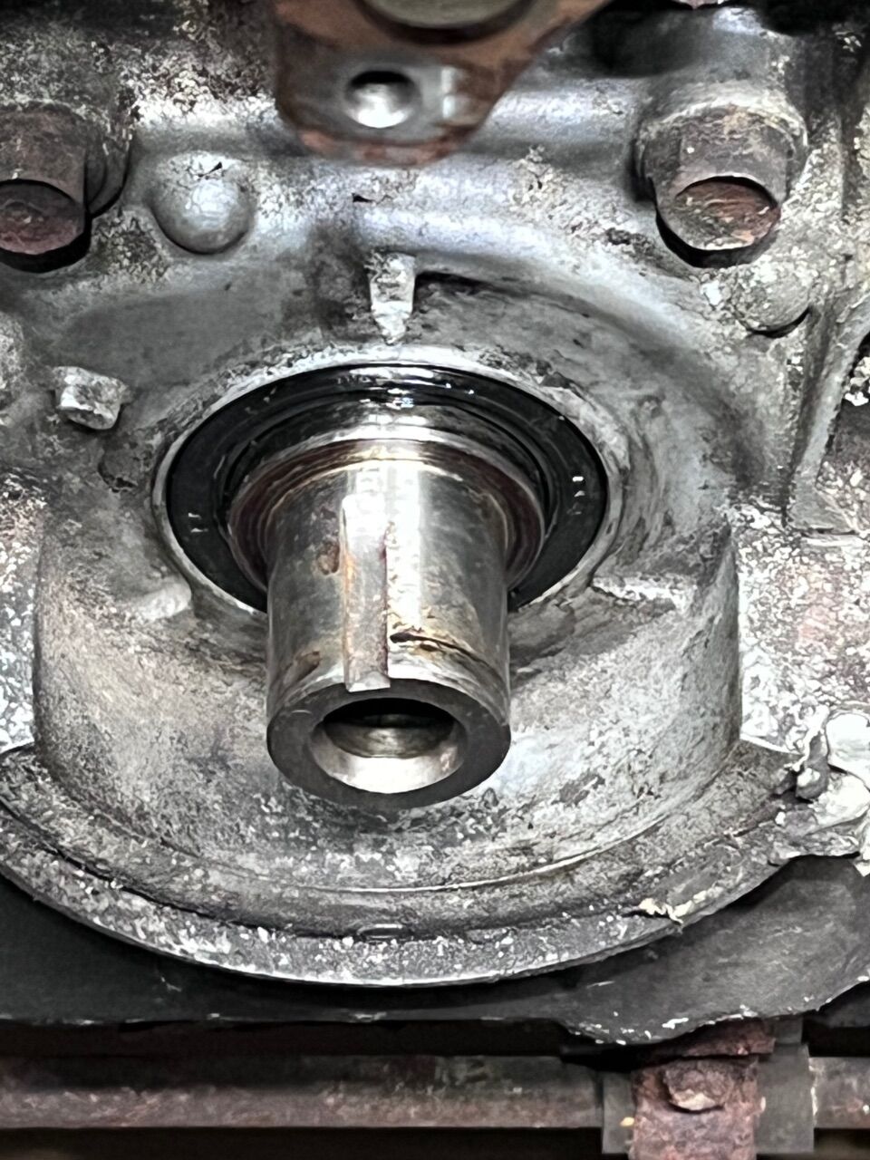

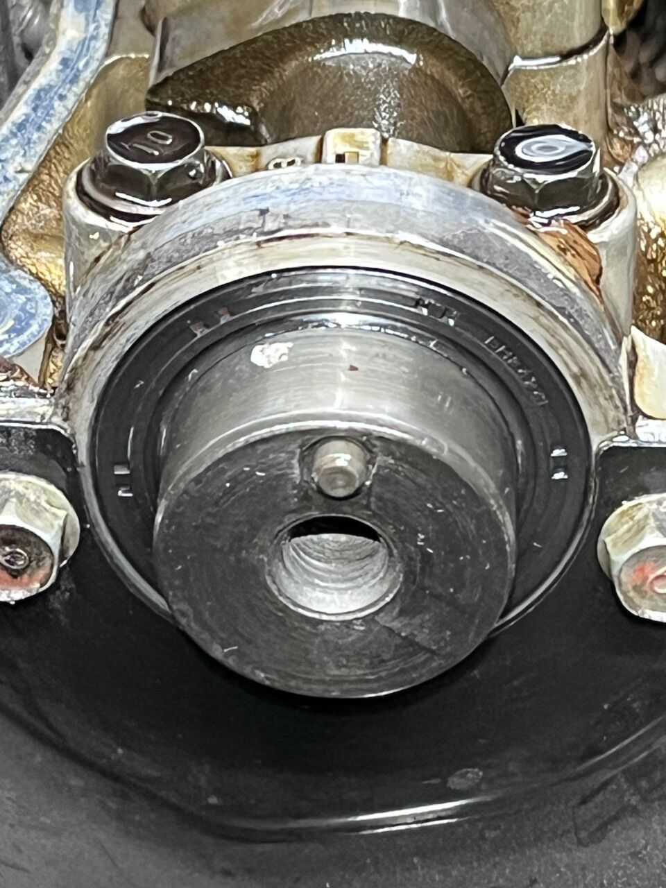

and if we're doing the timing belt, we might as well do the cam and crank seals
and that thermostat cover needs a clean up too

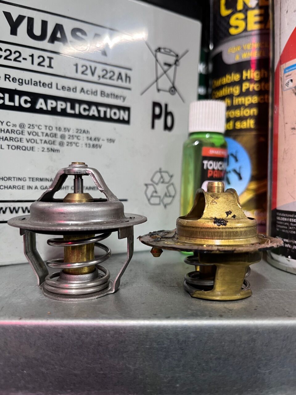

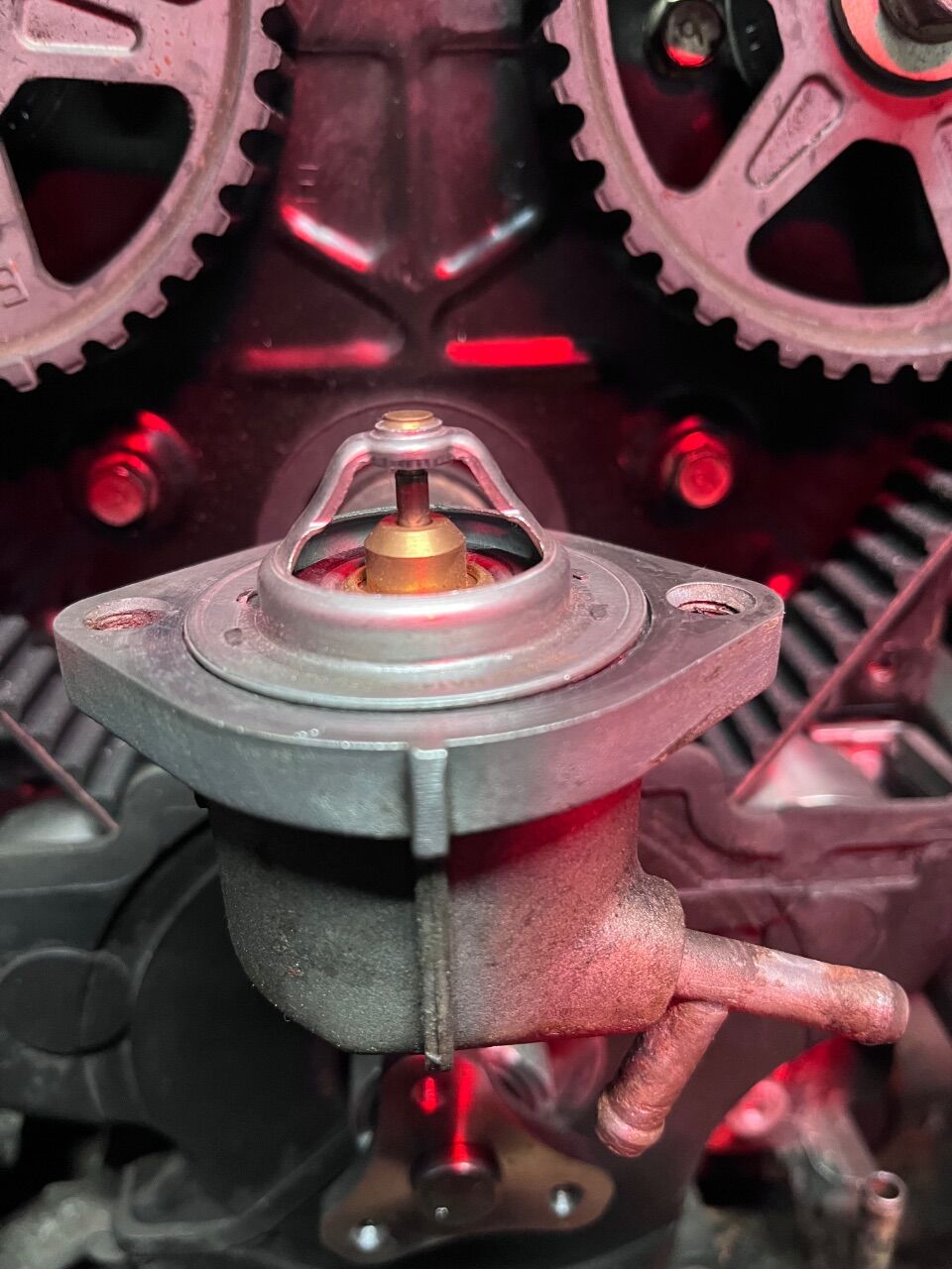

I've been accumulating parts for a while now, so had a thermostat ready to go in
anyone spot the problem ?
I emailed the supplier for advice, they had a quick look and found that I had ordered a 1.8 'stat, not the 1.6 that I needed. being as that was back in august, I didn't dare ask for an exchange so just ordered a new one

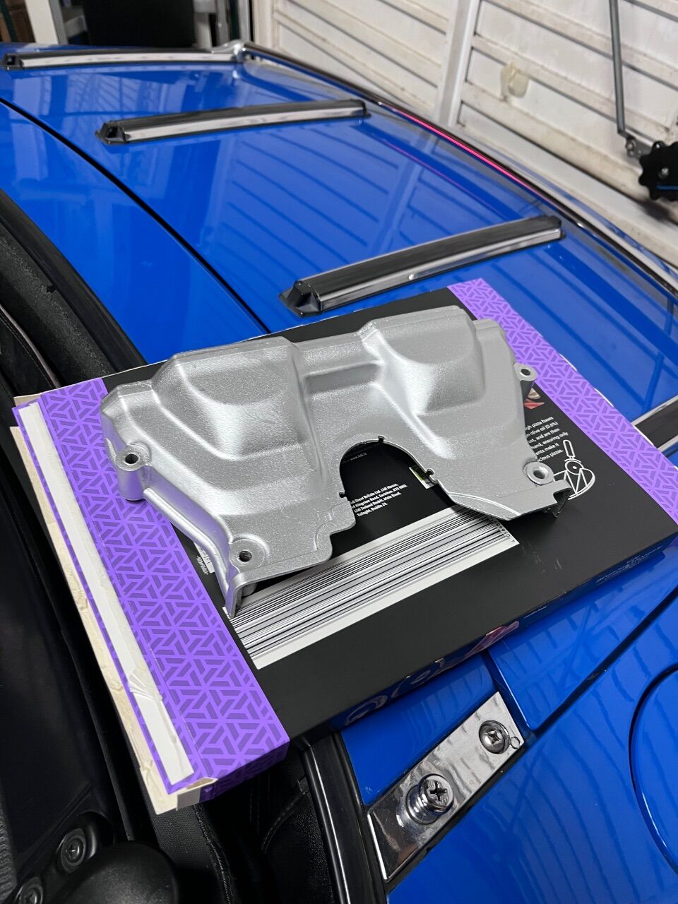

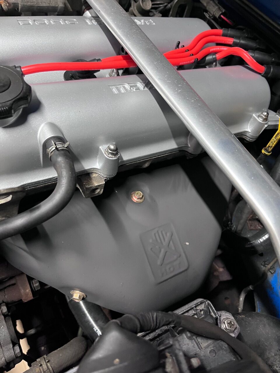

in the meantime, I stuck my spare cam cover on to keep the dust out
while I cleaned this one up
a few coats of wheel silver and that cam cover is looking good
my goldilocks 'stat arrived
and I got to stick everything back together again

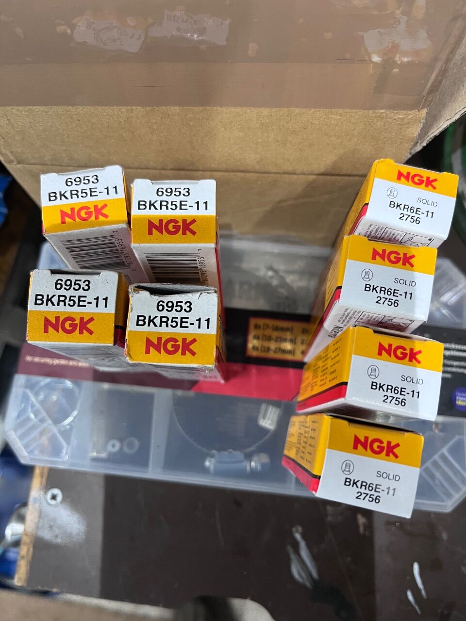

a rummage in my parts box turned up two sets of plugs - but which ones to use ?
I'll just use the same as what came out, just much much cleaner

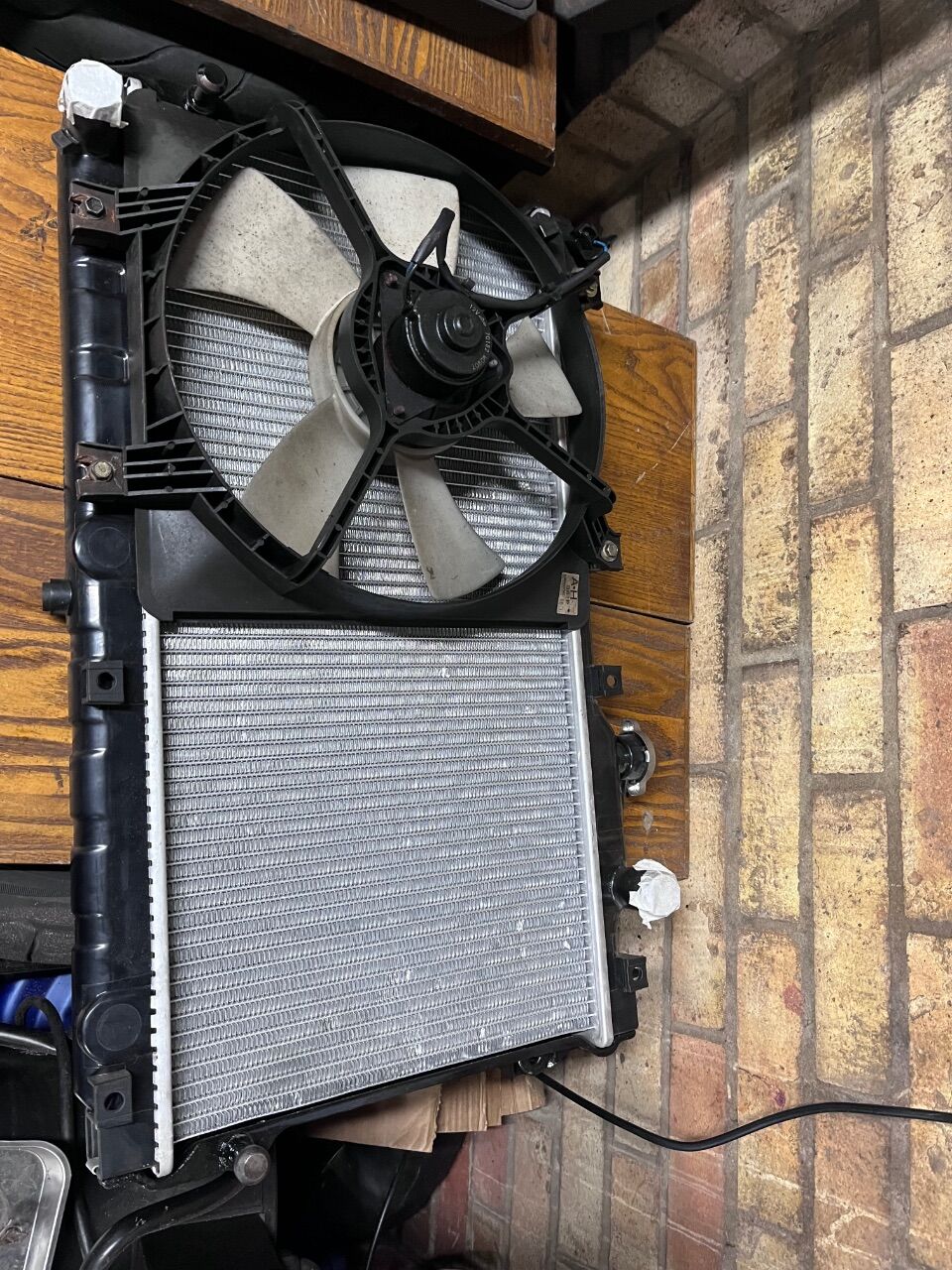

add a replacement radiator to the shopping list
and don't forget the oil

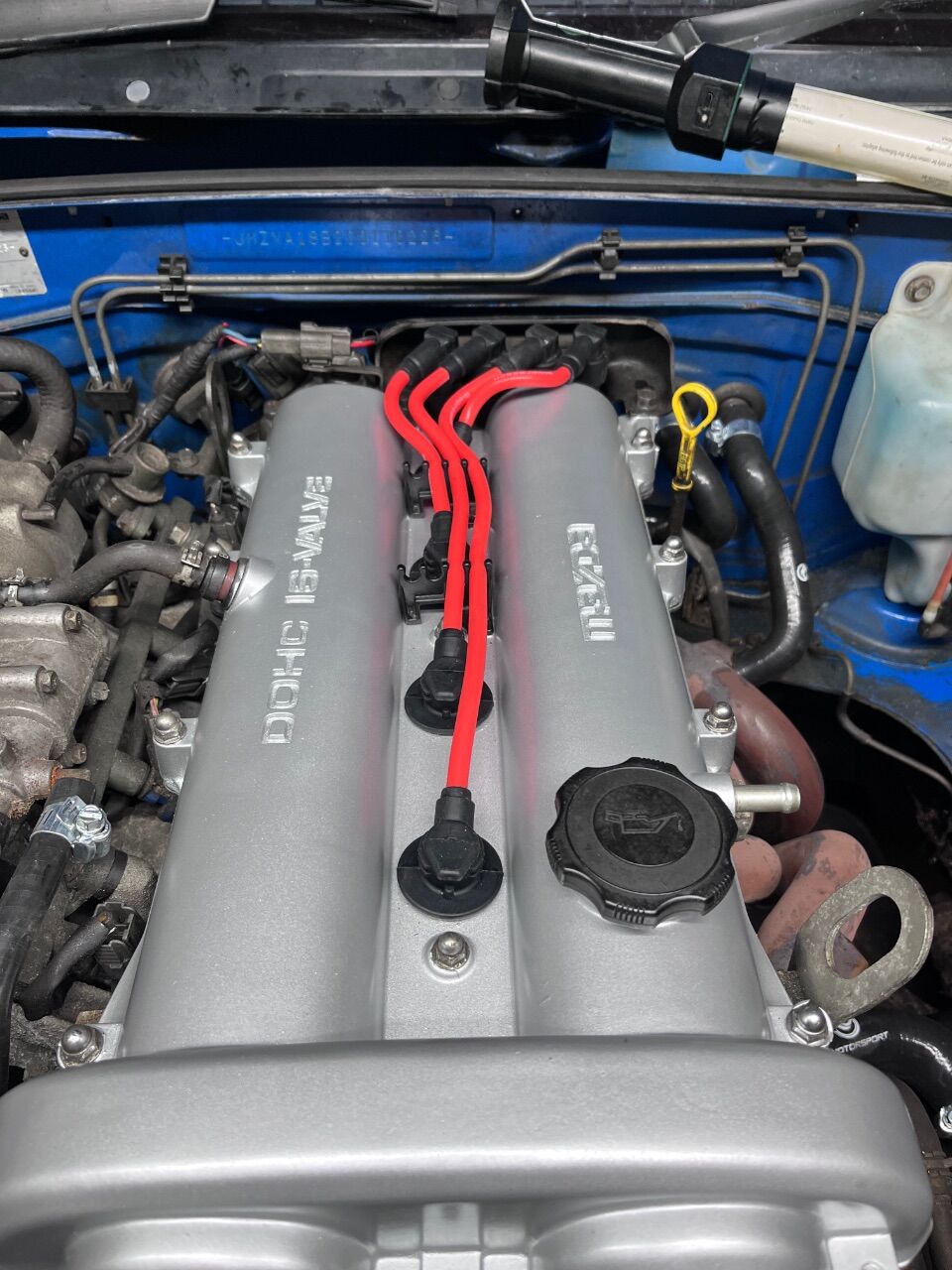

a new set of leads went on
the exhaust heat shield got a coat of high temp paint (wonder how long that will last ?)

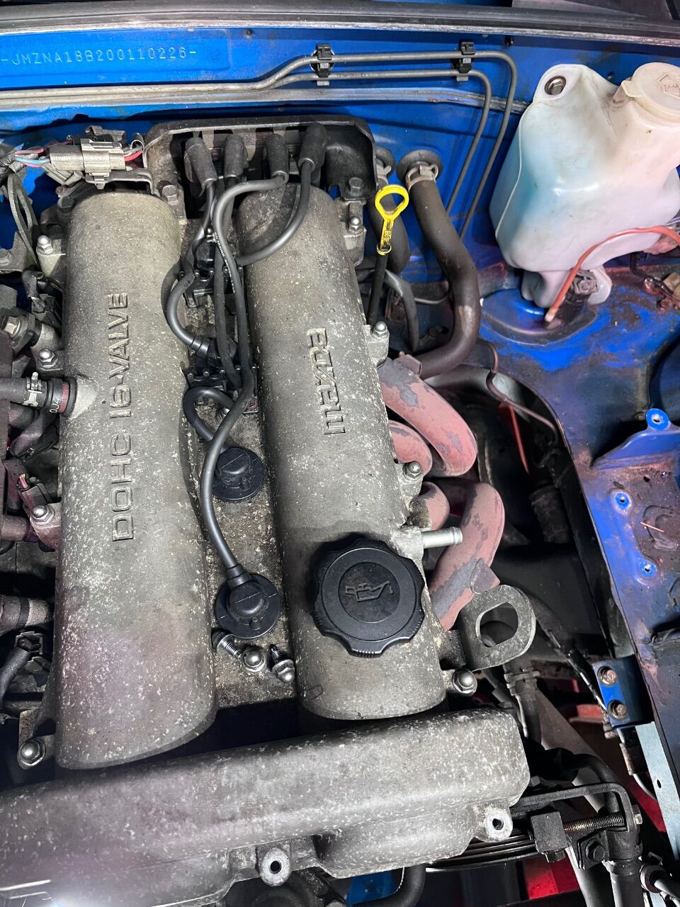

I gave the block a flush with the hose and filled with fresh coolant, checked over everything and turned the key.....
started first time :) big relief
there was a rattle from the water pump pulley that I'd forgotten to tighten but it quickly settled into a smooth idle

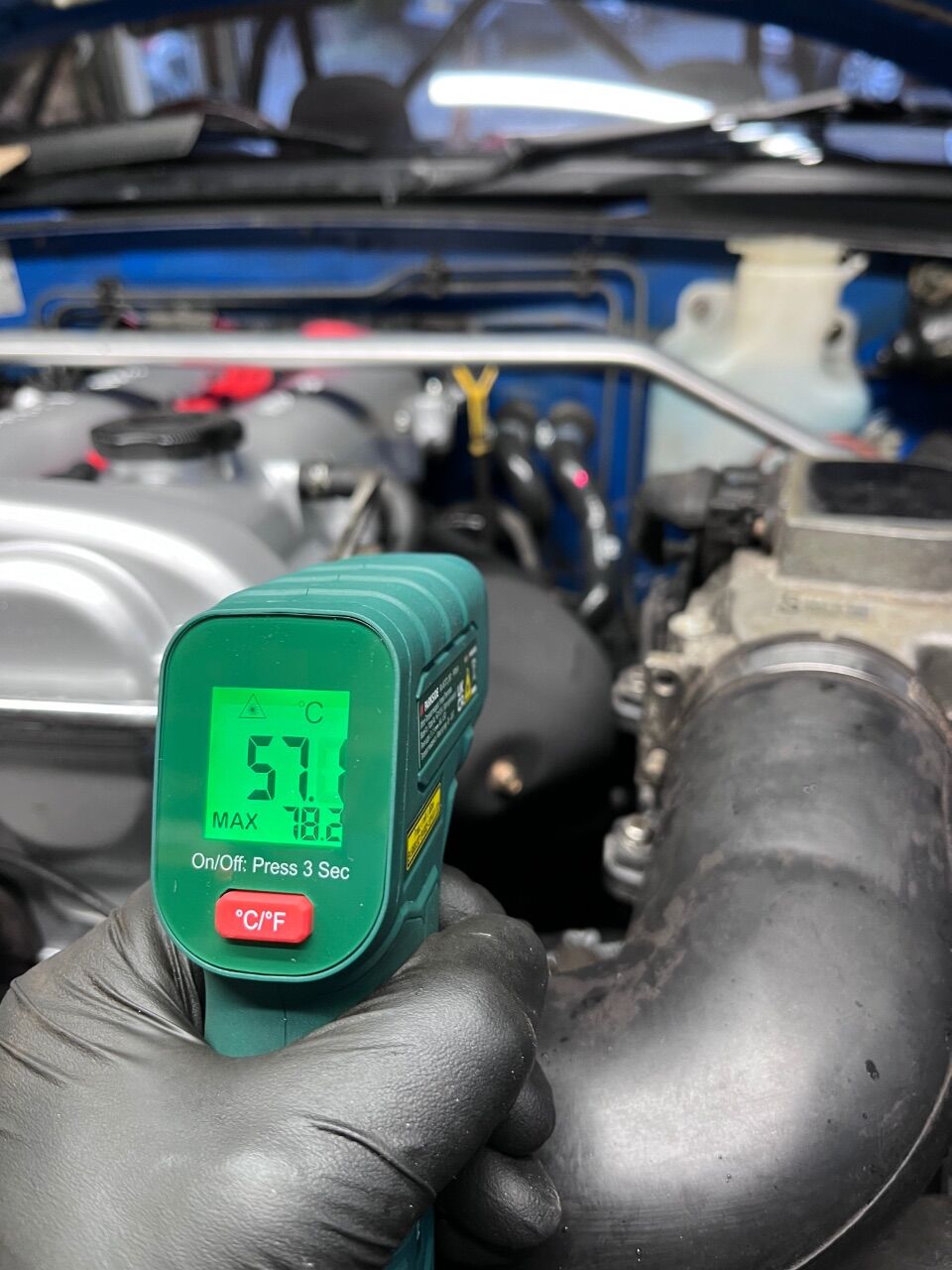

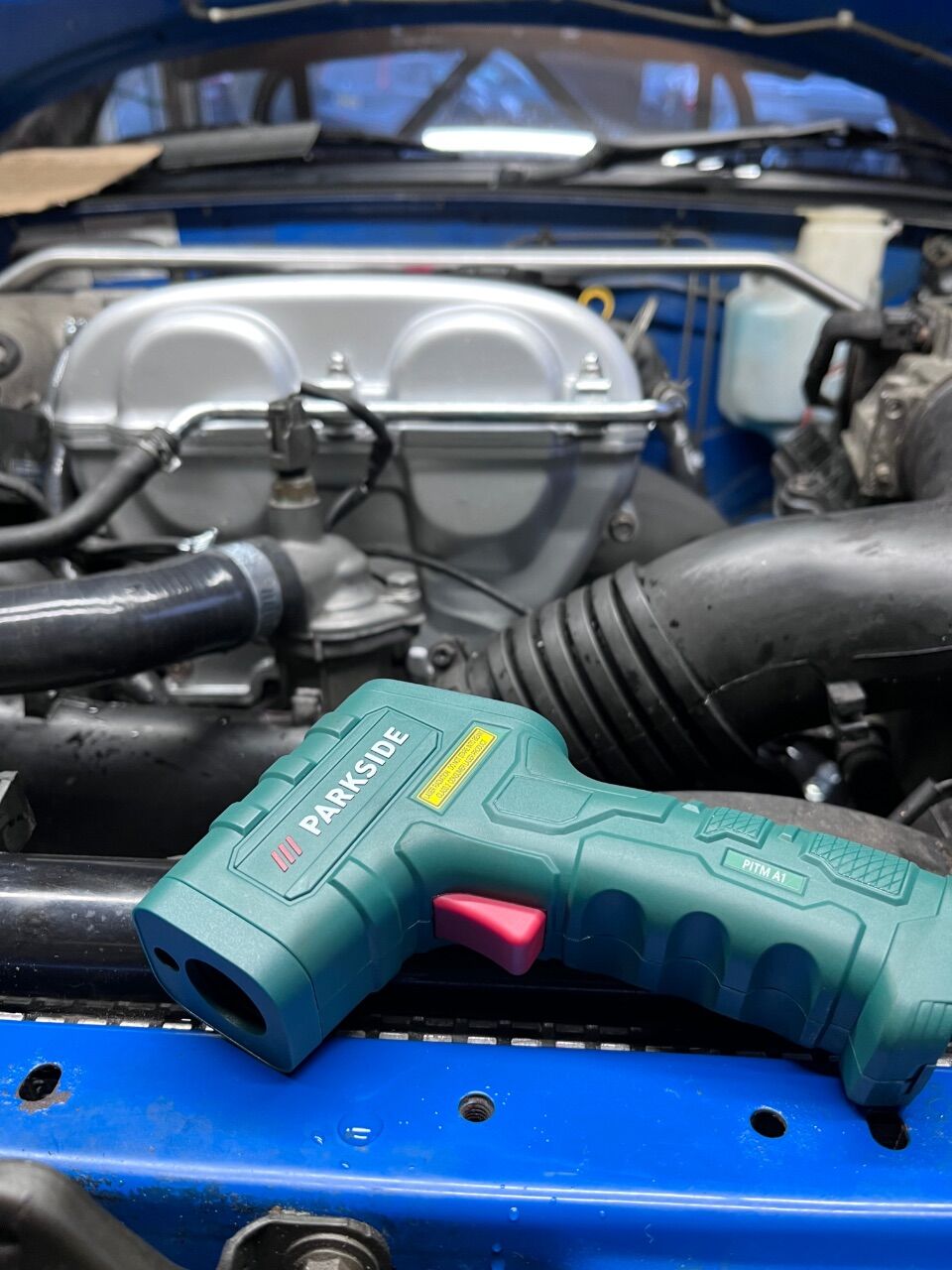

time to test my newest gadget
coolant is circulating nicely
into the heater matrix
and out again
I'd say that was a pretty thorough engine service :
oil & filter
spark plugs & leads
water pump, thermostat, radiator, coolant hoses, coolant
air filter
timing belt & tensioners
power steering belt, alternator belt
crank and cam seals, cam O ring, cam cover gasket
and it's running beautifully now.
still needs a clutch :(

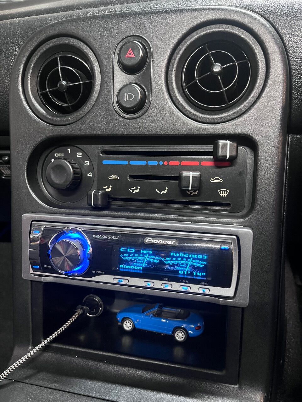

being as the mazda desperately needs a clutch, I got on with some important jobs
new stereo and usb socket fitted

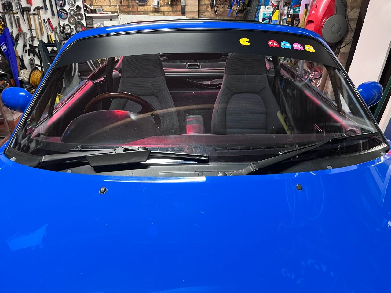

and a £1.99 sunstrip off aliexpress
hmm, looks a bit plain - needs some sort of finishing touch
that's better :)

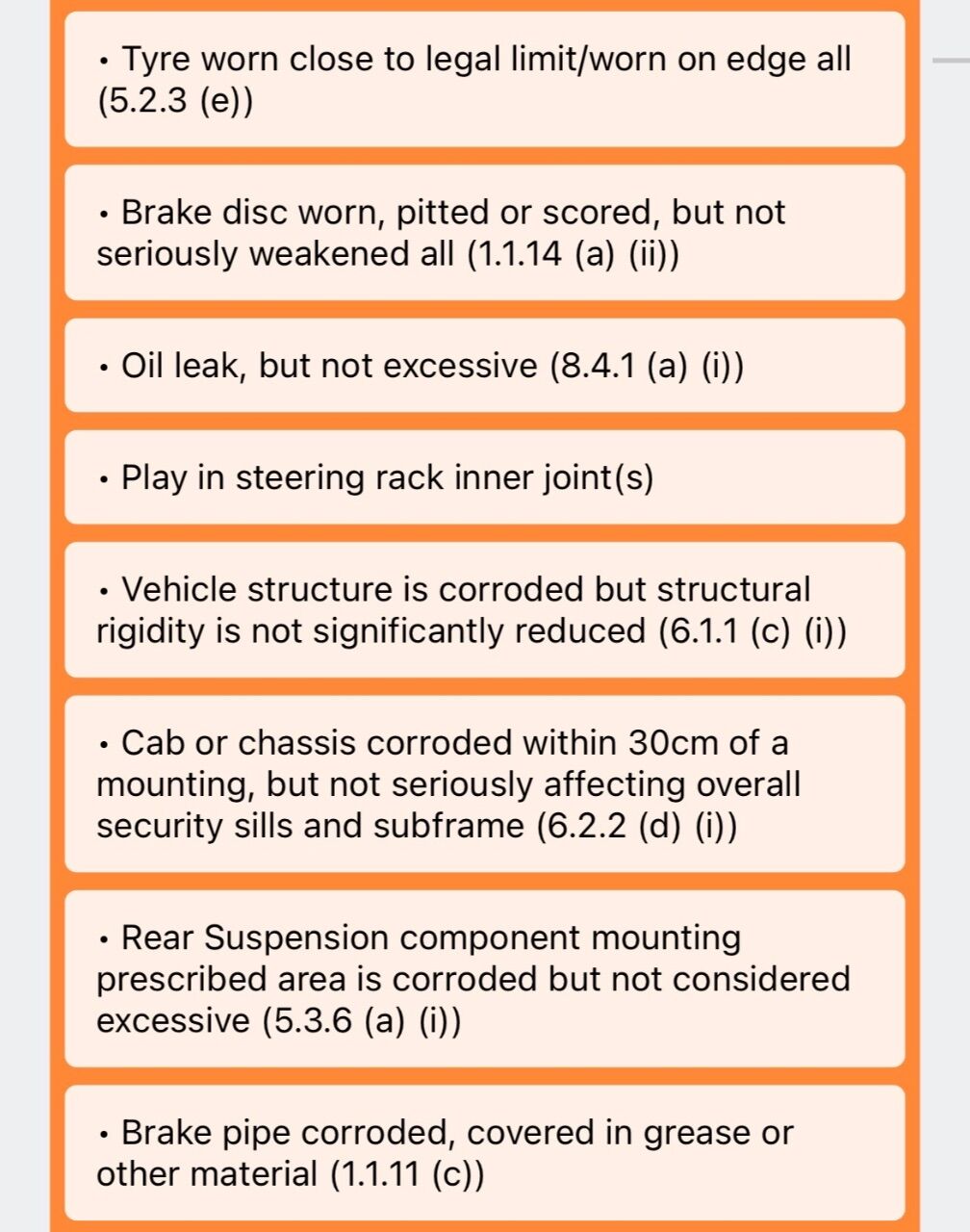

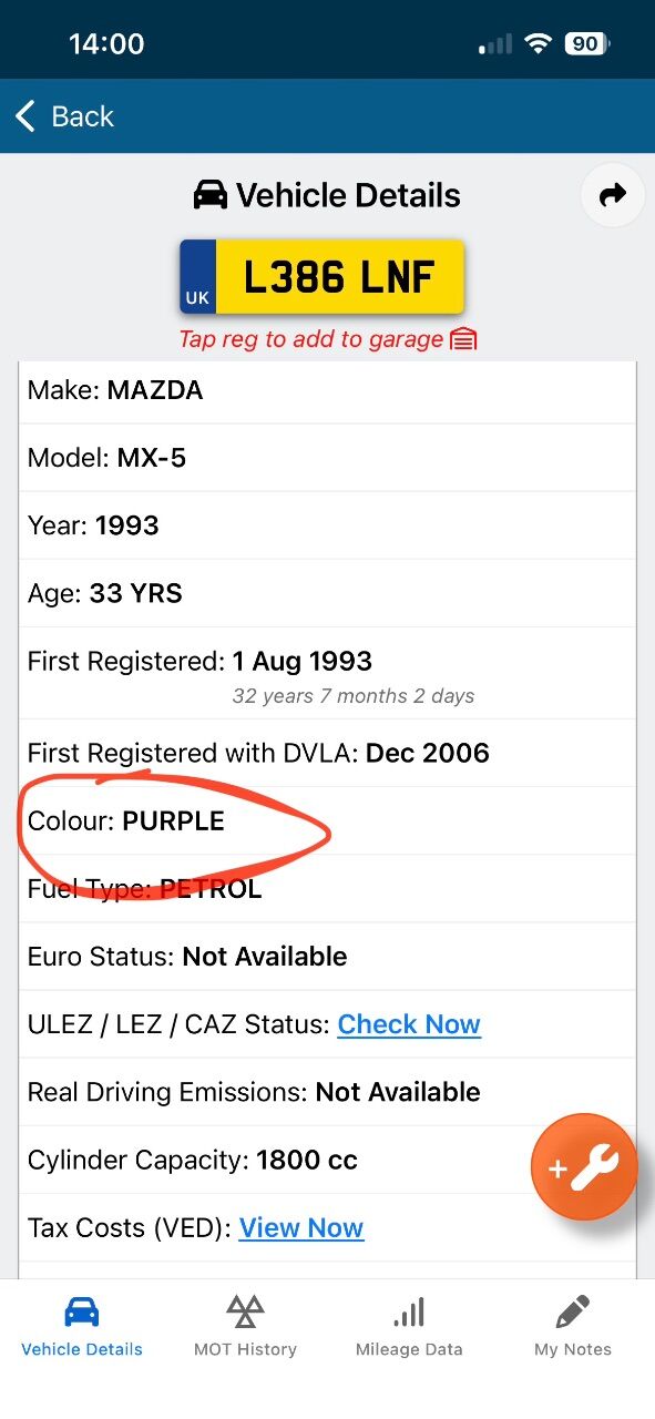

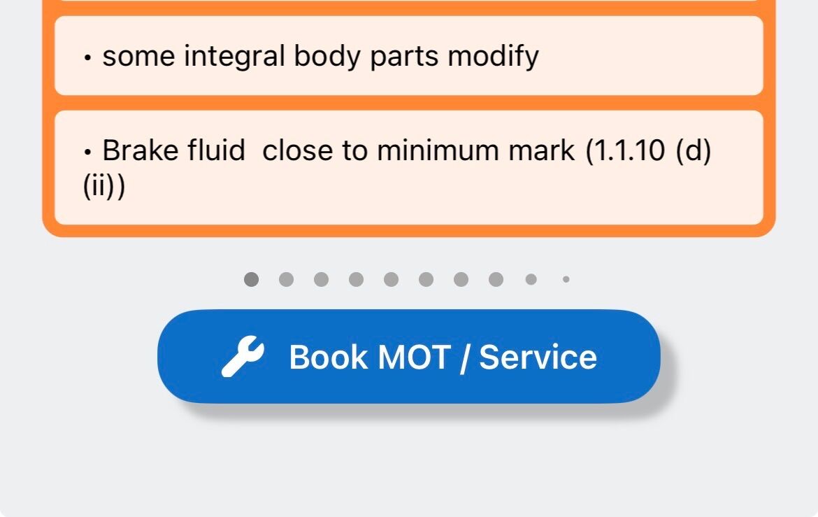

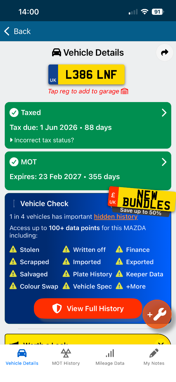

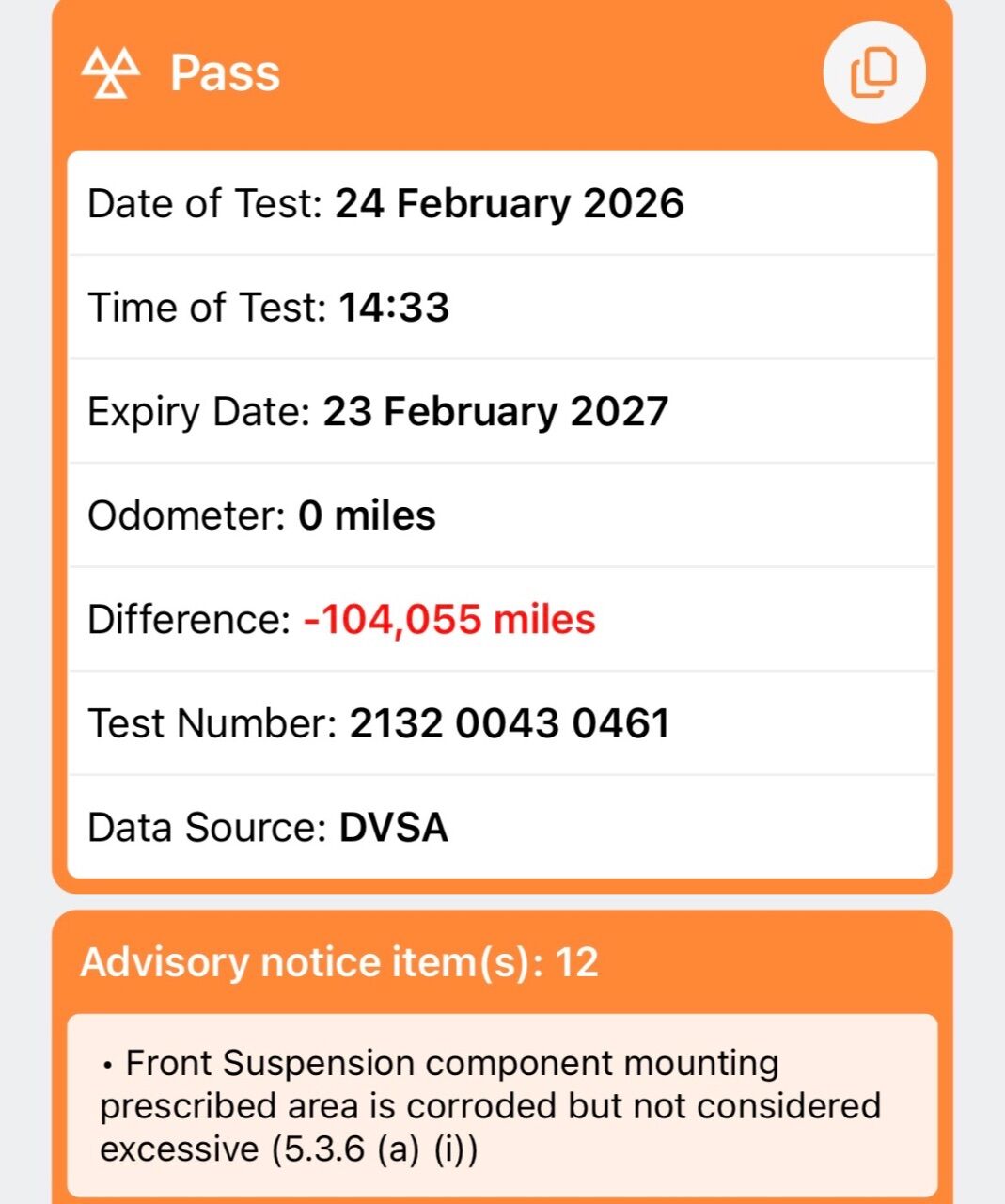

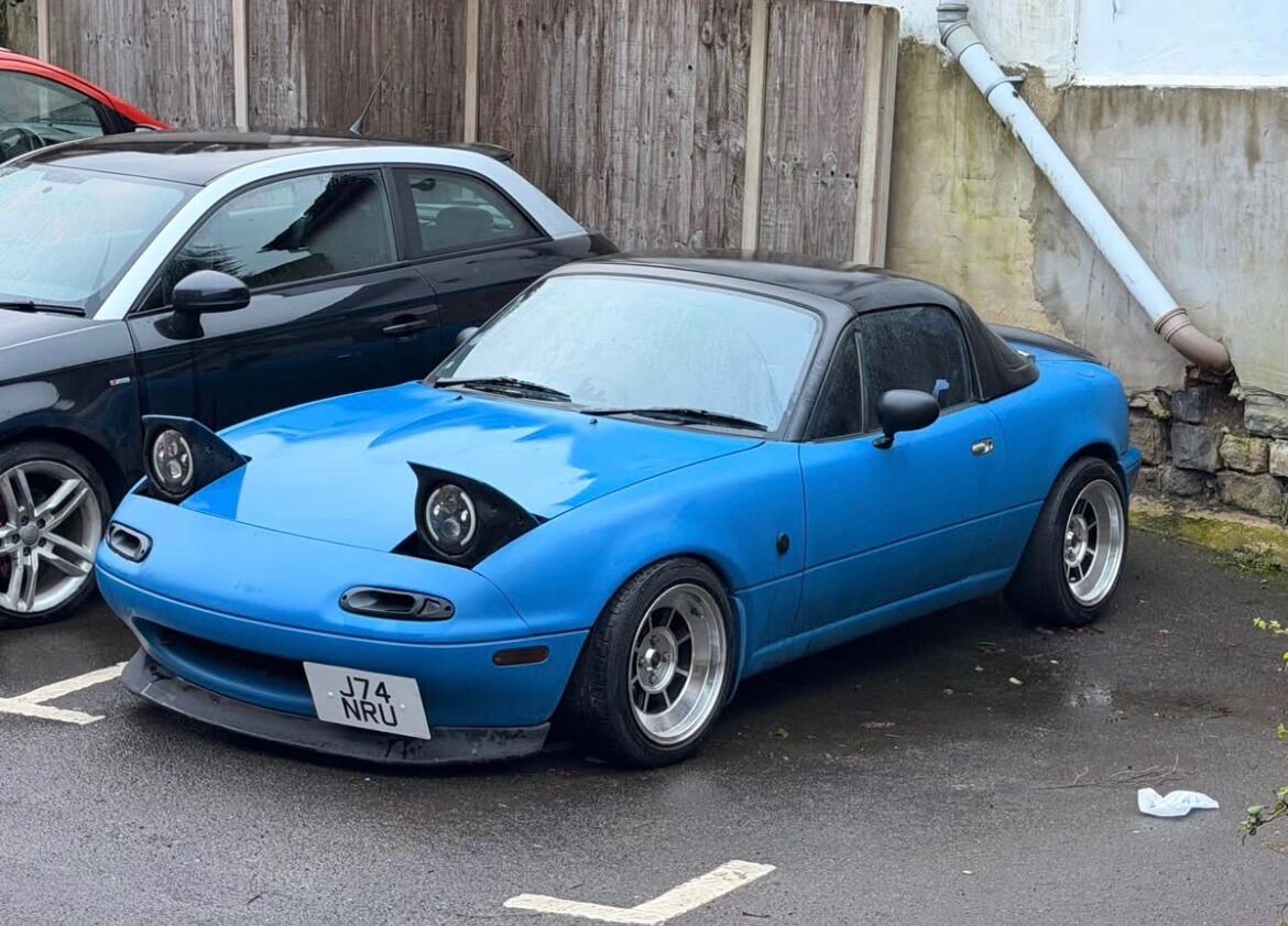

the thought crossed my mind that my old mx5 must be due for an mot soon - i should look it up and see how it got on
last year it only just scraped a pass with plenty of advisories for corrosion
so this came as a surprise
 scrolling down the page i noticed it seems to have a make over
plenty of advisories again
and zero miles recorded - which is odd as last year it had…
something quite strange going on here, it’s been tested each year by our very own @scaryoldcortina who suggested last year that things were getting “a bit grim” on the underside :)
good to see it’s still on the road, it may have been a scruff but it drove so well - long live the mighty mx5 !
It's got two test histories and two different vin numbers on the system (one with a dash and one without) so this tester must have picked the other record to the one I used for seven years!
That is one way to fix sills and other rusty bits hide rust

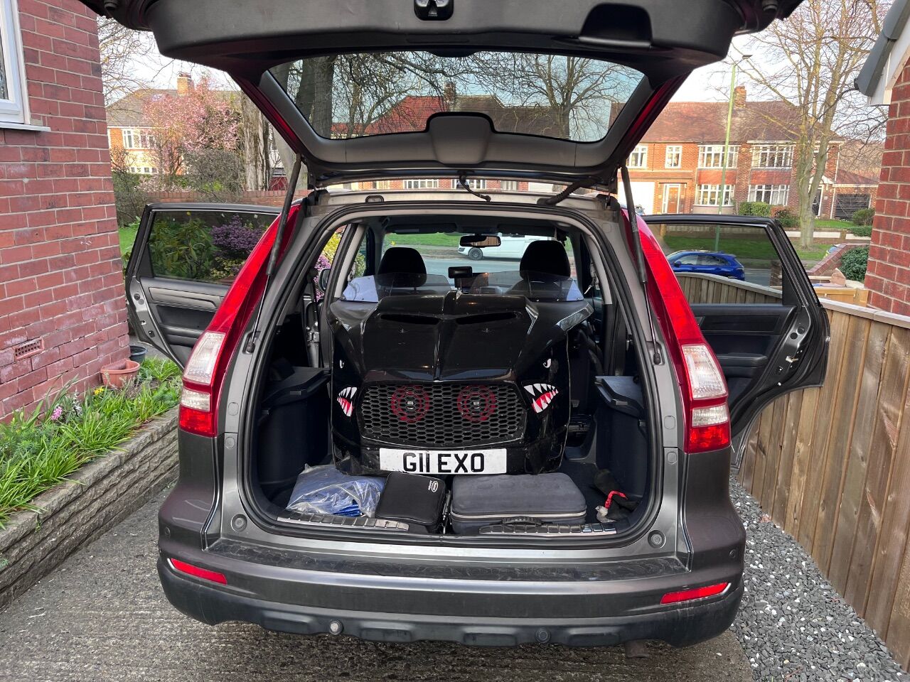

exo news

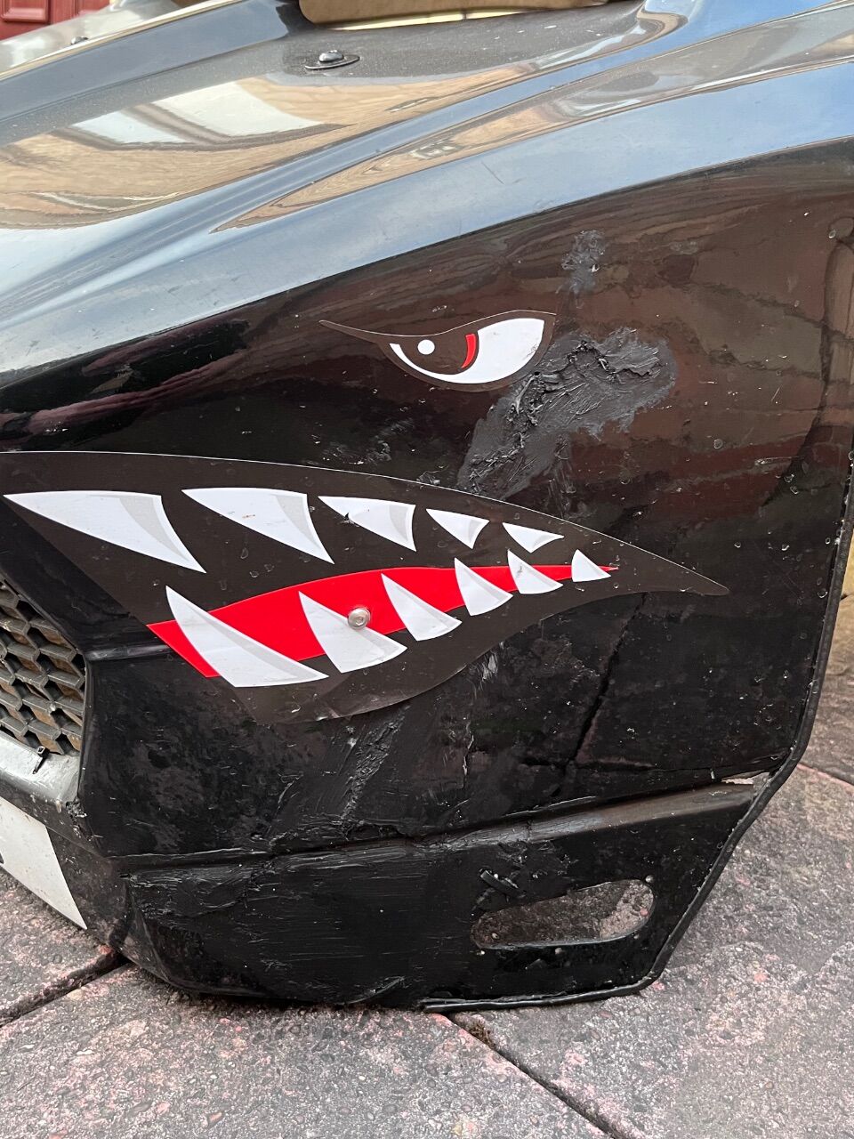

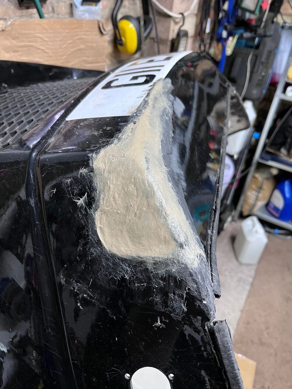

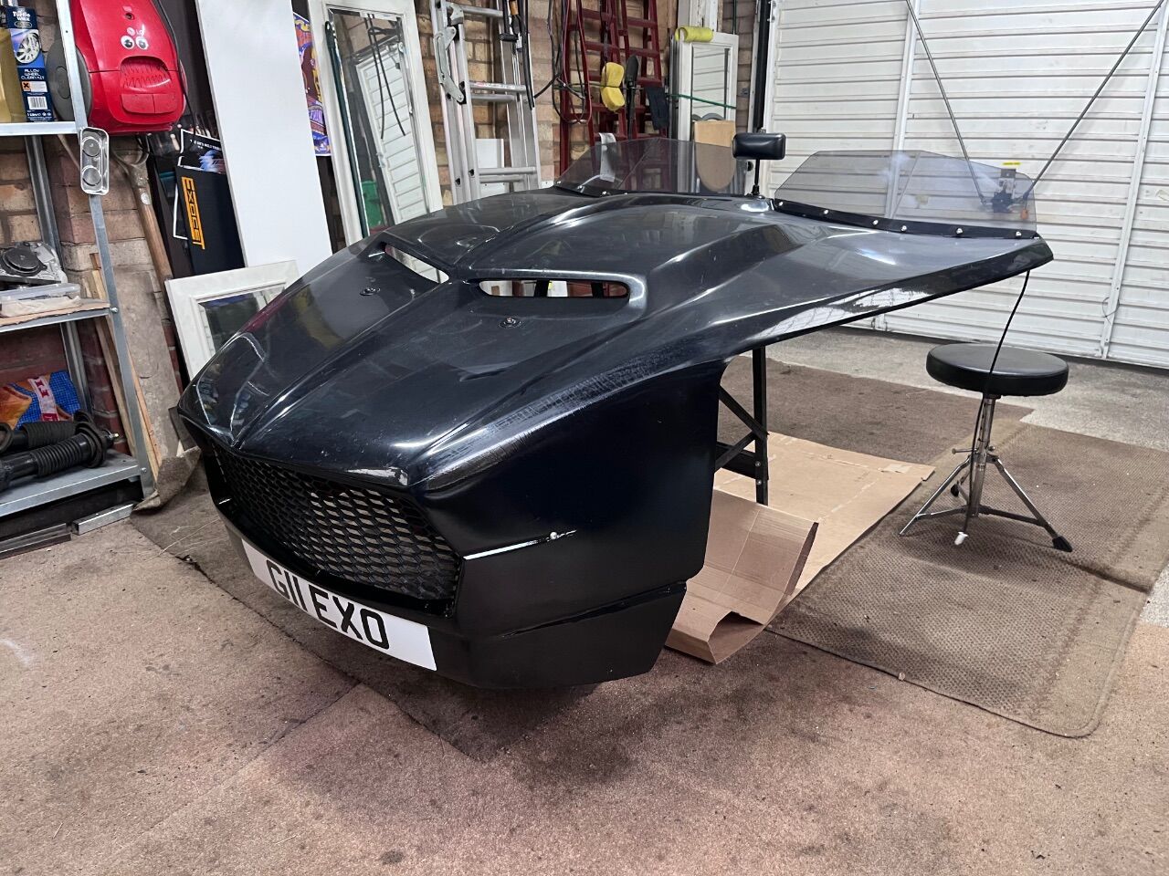

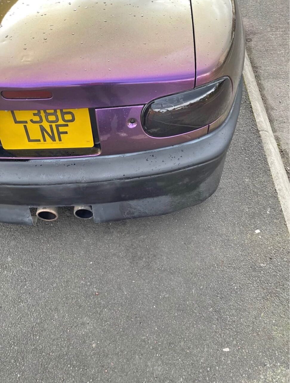

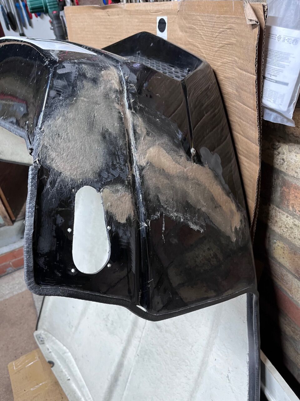

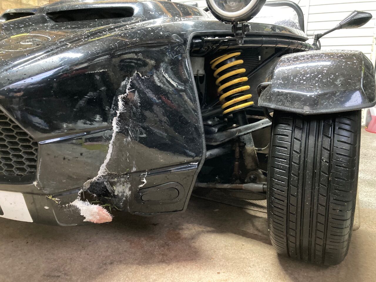

you may recall that a few years back, there was an "incident" which caused a bit of front end damage :(
which was skilfully* repaired using some scraps of aluminium and PU adhesive
and cunningly disguised with a set of shark teeth

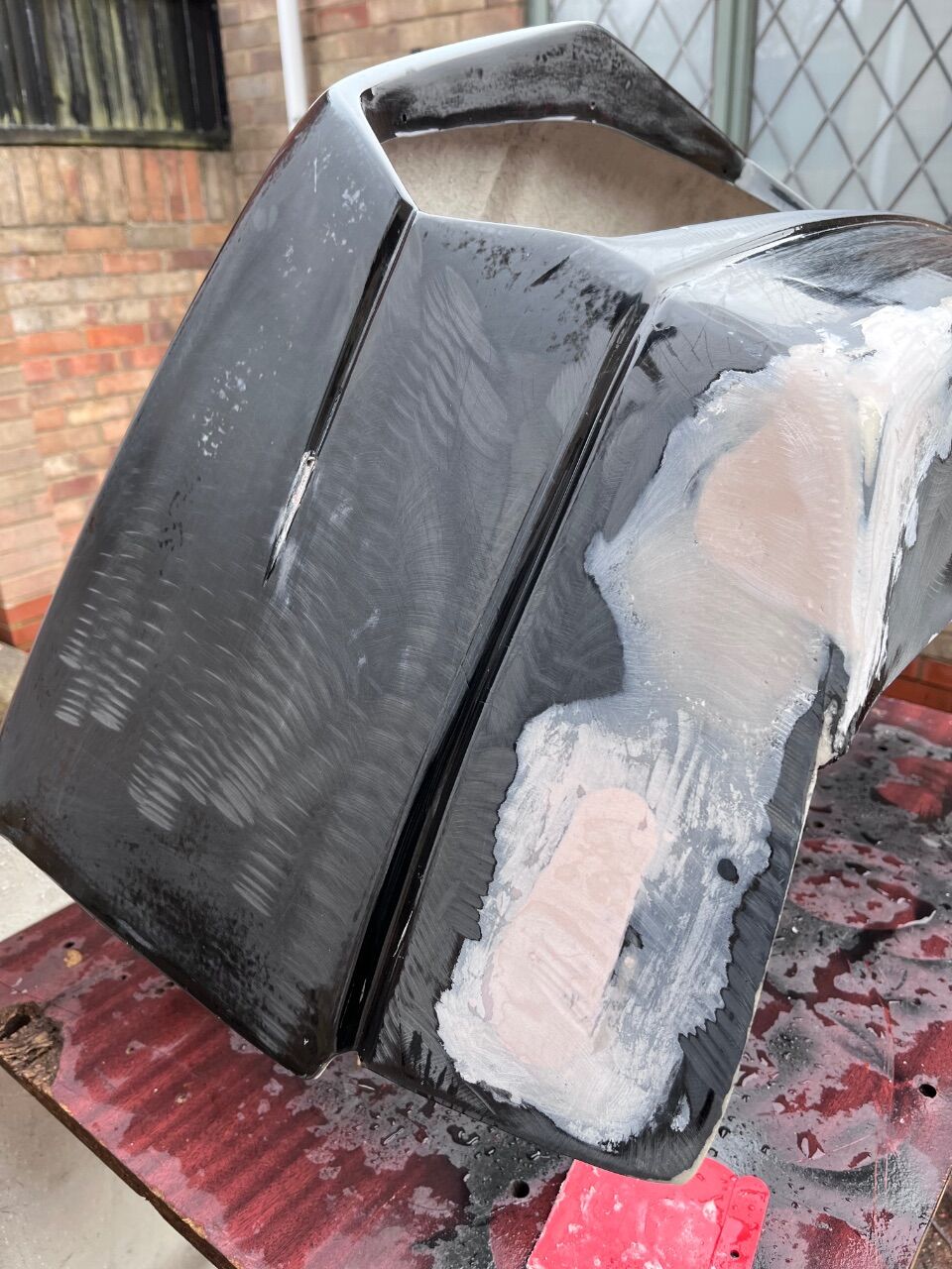

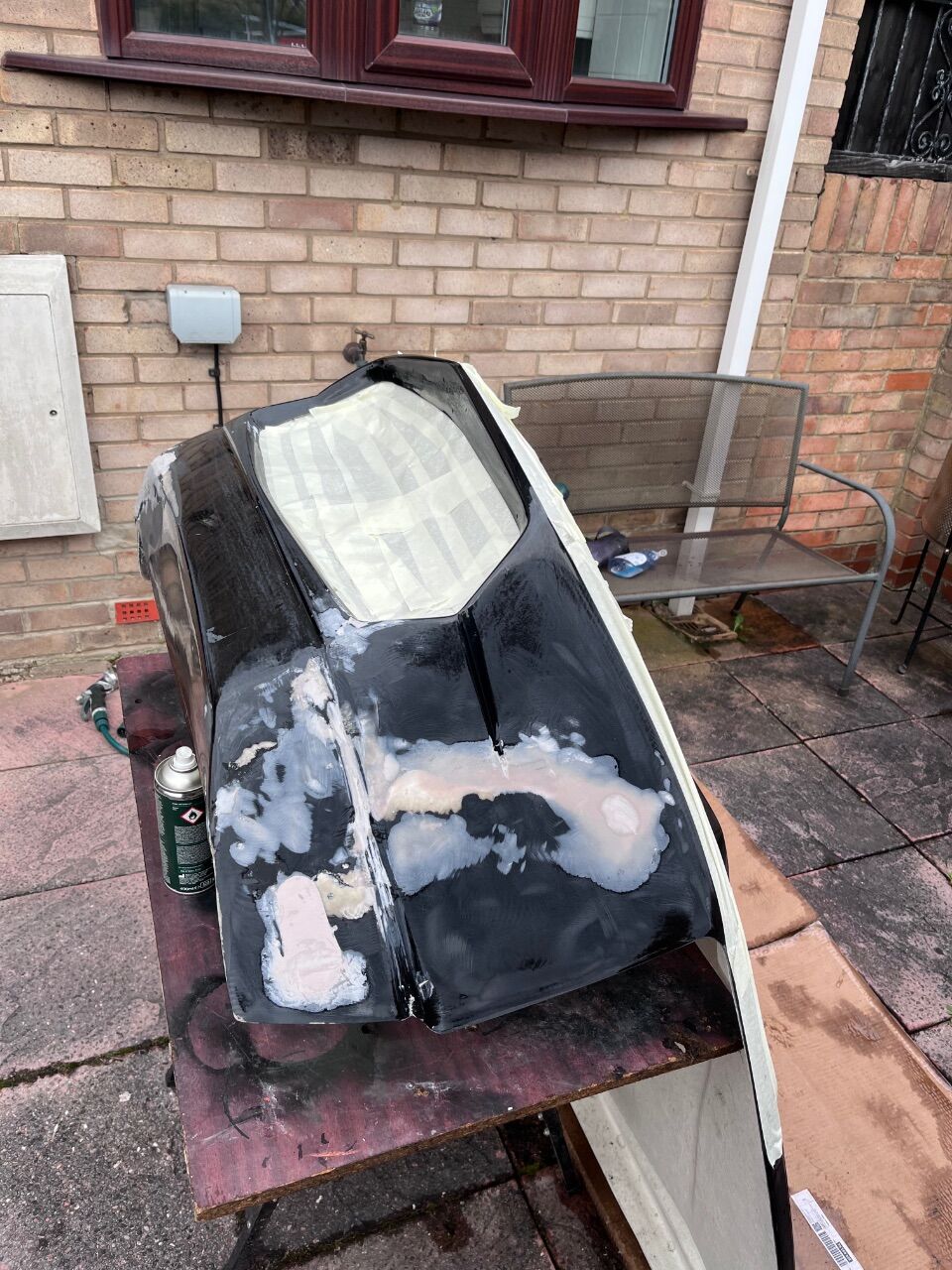

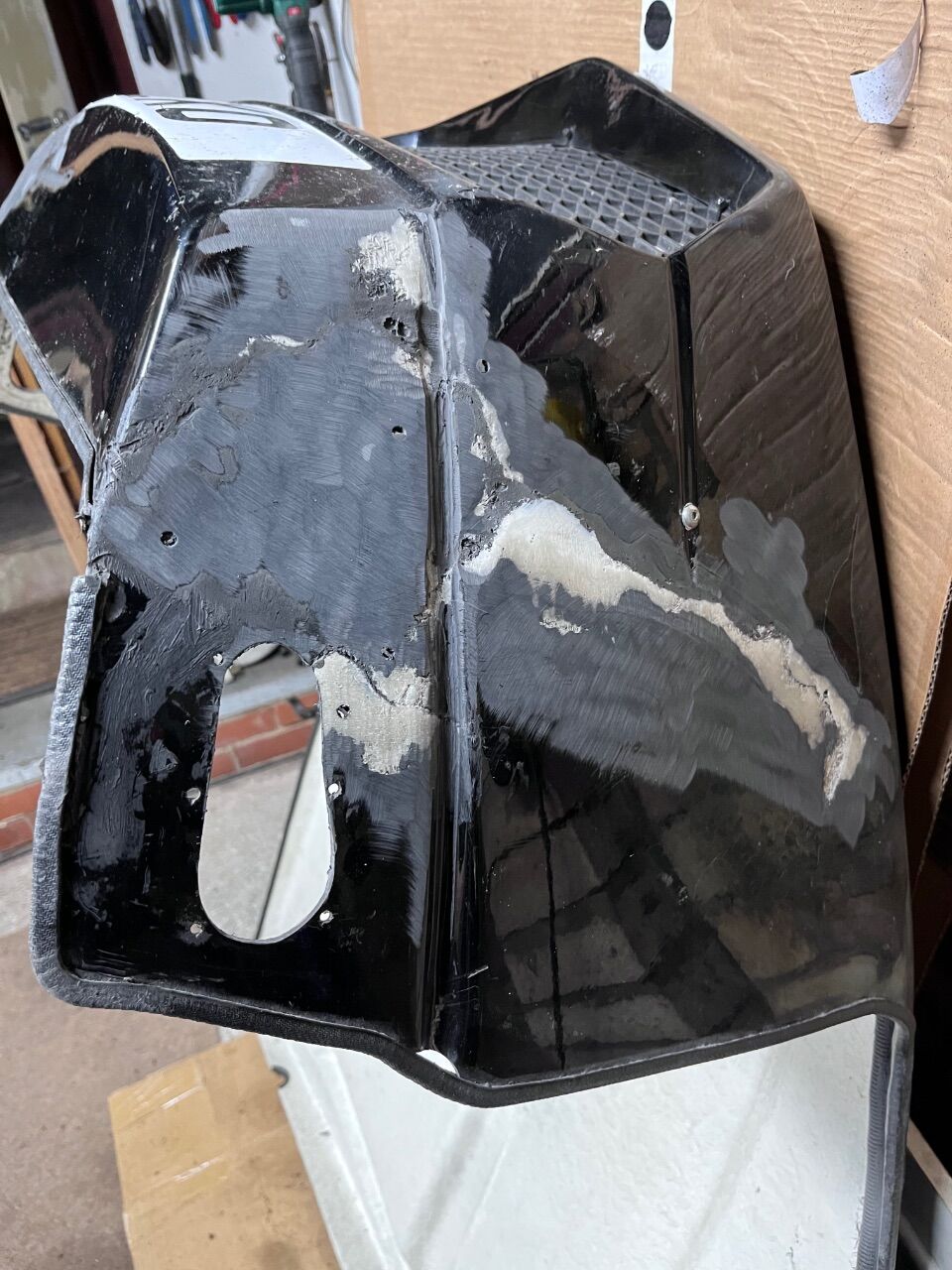

three years on, I thought it about time to do a better job
nice practical motor, this here 'onda

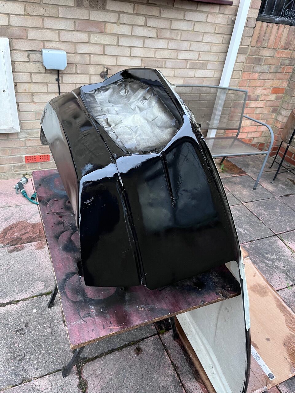

and brought it home for a bit of sanding

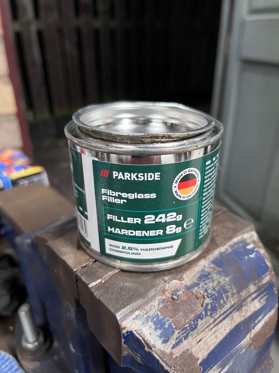

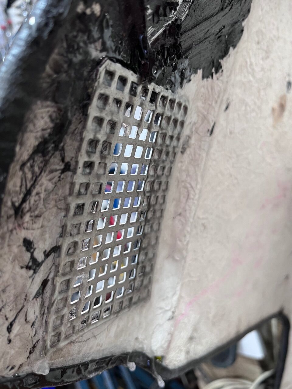

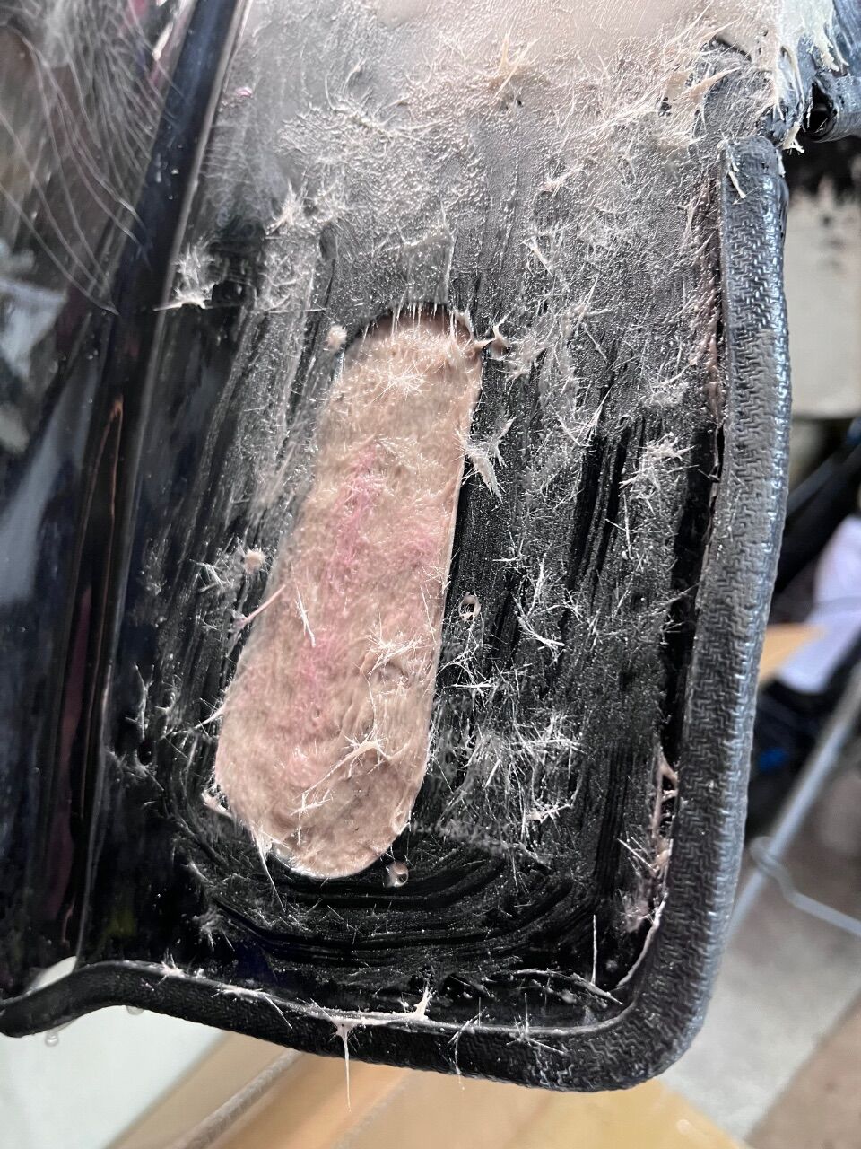

a tin of lidls finest bodge
and more sanding

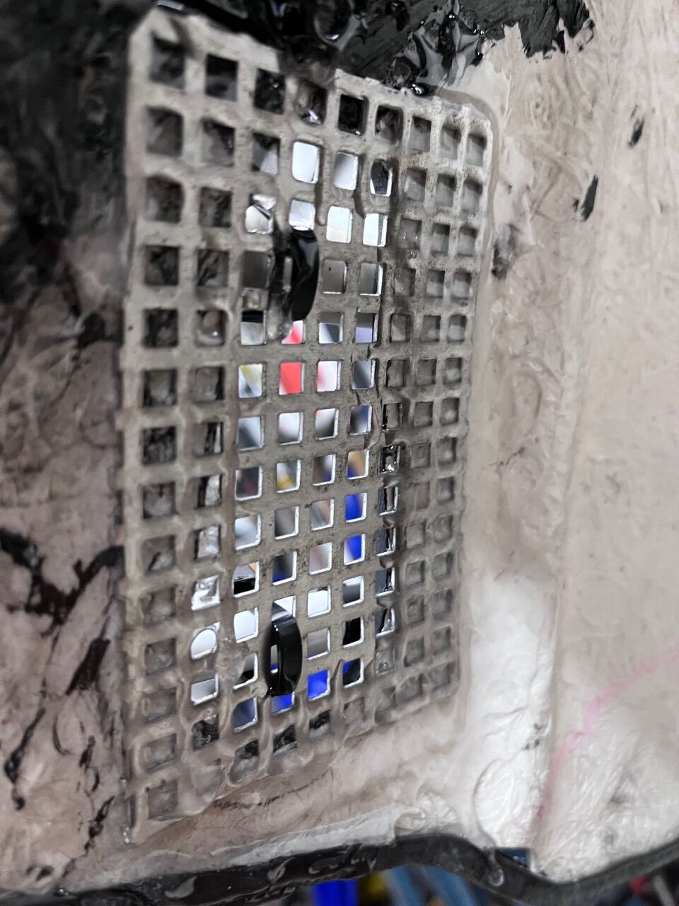

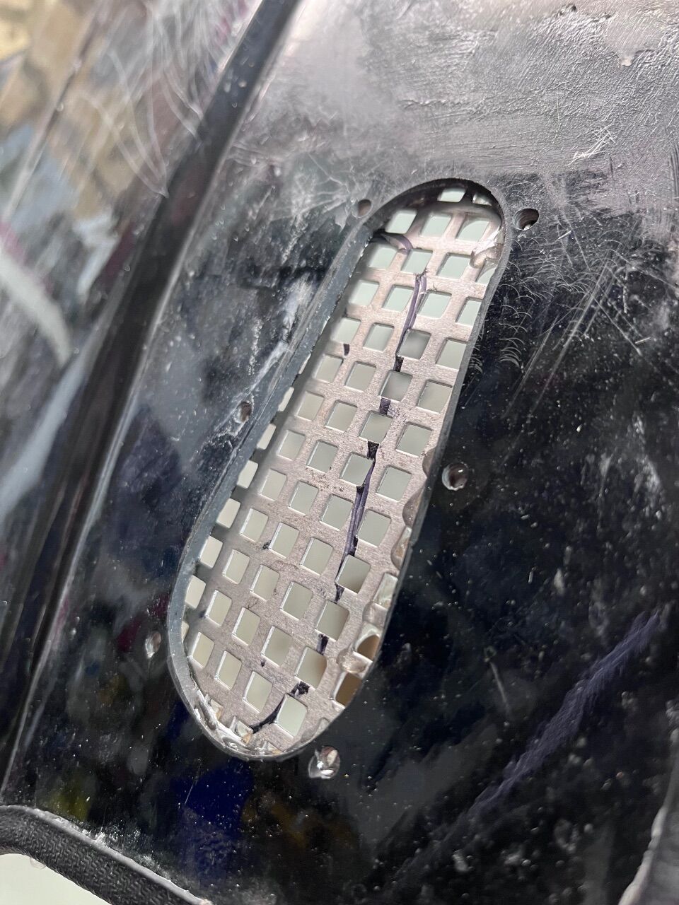

the cut outs for the aero-catches won't be reused so might as well fill them too
a tube of poundland epoxy was used to fix the mesh
set solid overnight
time for more bodge
and more lidl bargains
sand, fill, sand, fill, etc
not too bad, lets fling a bit of paint at it
oh dear, not exactly my best work
a few more coats and it's improved a bit
needed a new numberplate too
and stick it back on the car ready to come out of hibernation on 1st april
looks so plain and boring without the shark teeth, I've ordered a new set :)

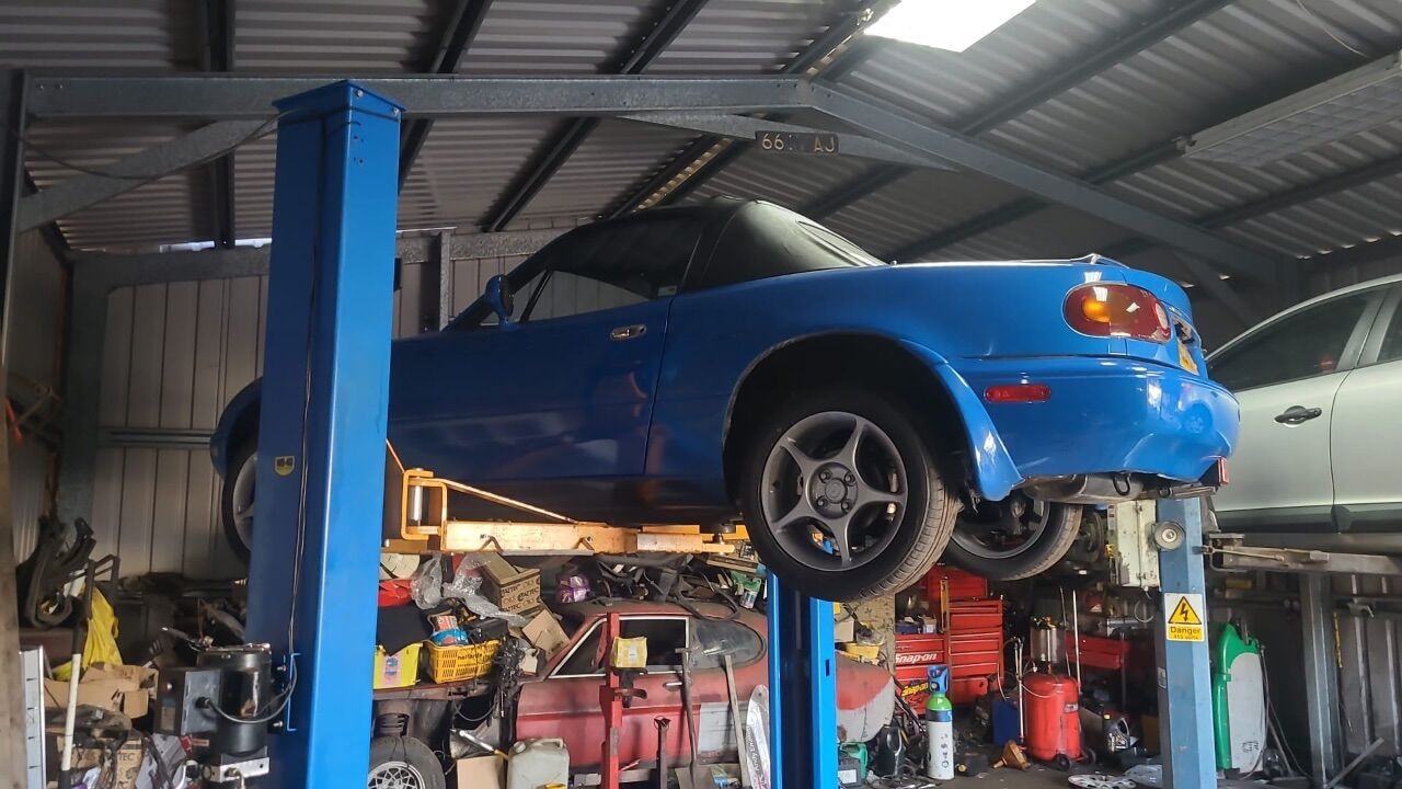

the prospect of lying on my back wrestling a gearbox into place filled me with dread so I arranged to drop it off at @scaryoldcortina's garage
but it was slipping quite badly by now :(
no matter, I arranged for my sister to follow me in the disastra (officially to give me a lift home but also just in case)
Andy's place is on top of one of the highest hills in the county, there is no easy route there - I chose one with least traffic and crossed my fingers
keeping up momentum I conquered the hills :)
with only a mile of flat roads to go, I my passenger thought it a good time to take a video of how bad this clutch is
which was a stupid idea because pulling away at the next junction, I lost all drive ! twat !
fortunately I had come prepared and the last mile was done on the yellow rope of shame
it is having a lightweight flywheel fitted at the same time plus a set of braided brake lines so should be a whole load of fun when it comes home :)

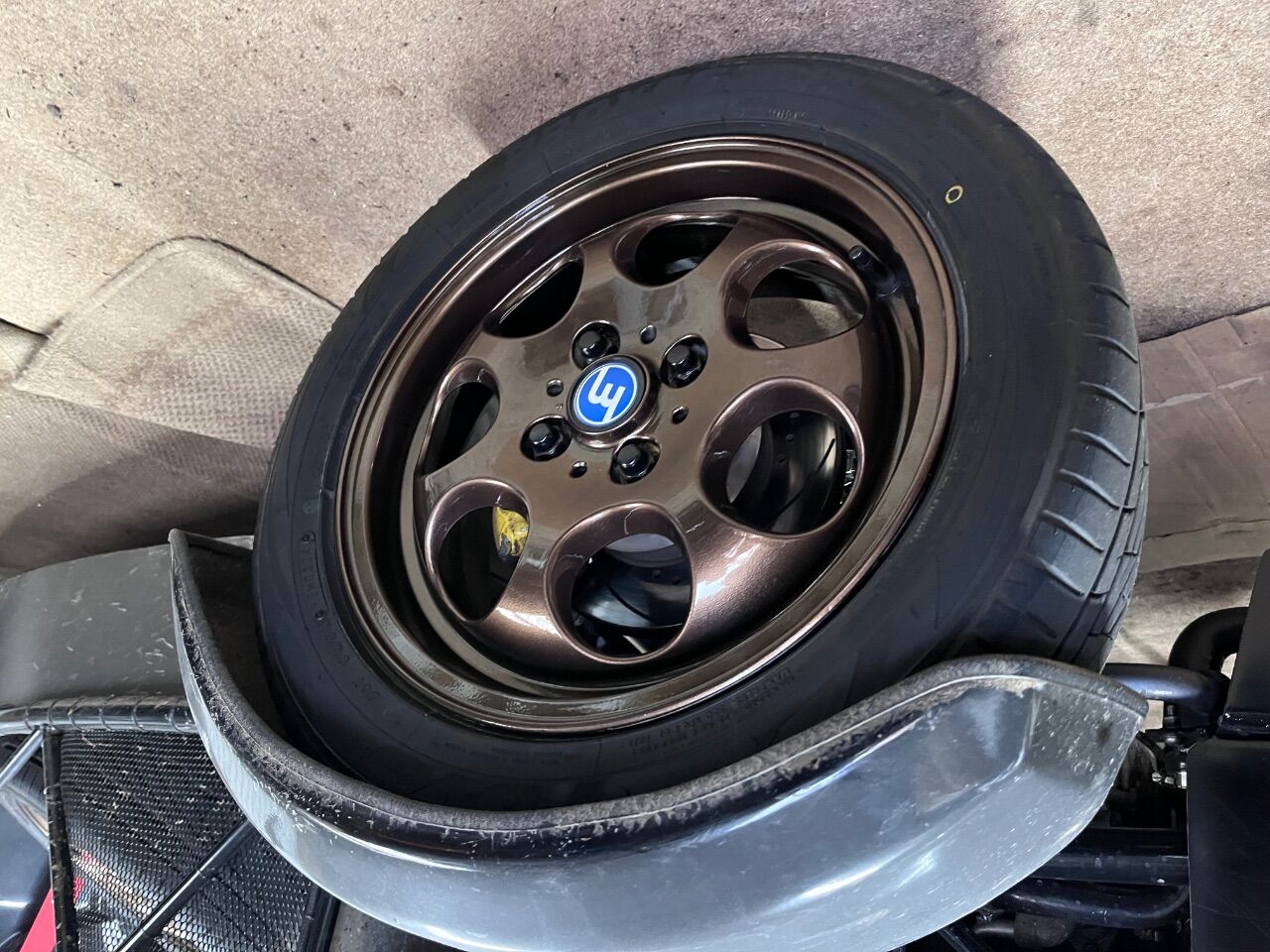

while the mx5 was away up at andy’s, i had no toys to play with so had no option but to rescue the Exo :)
i brought it home and gave it a quick check over, no obvious problems so time to put the pretty wheels on

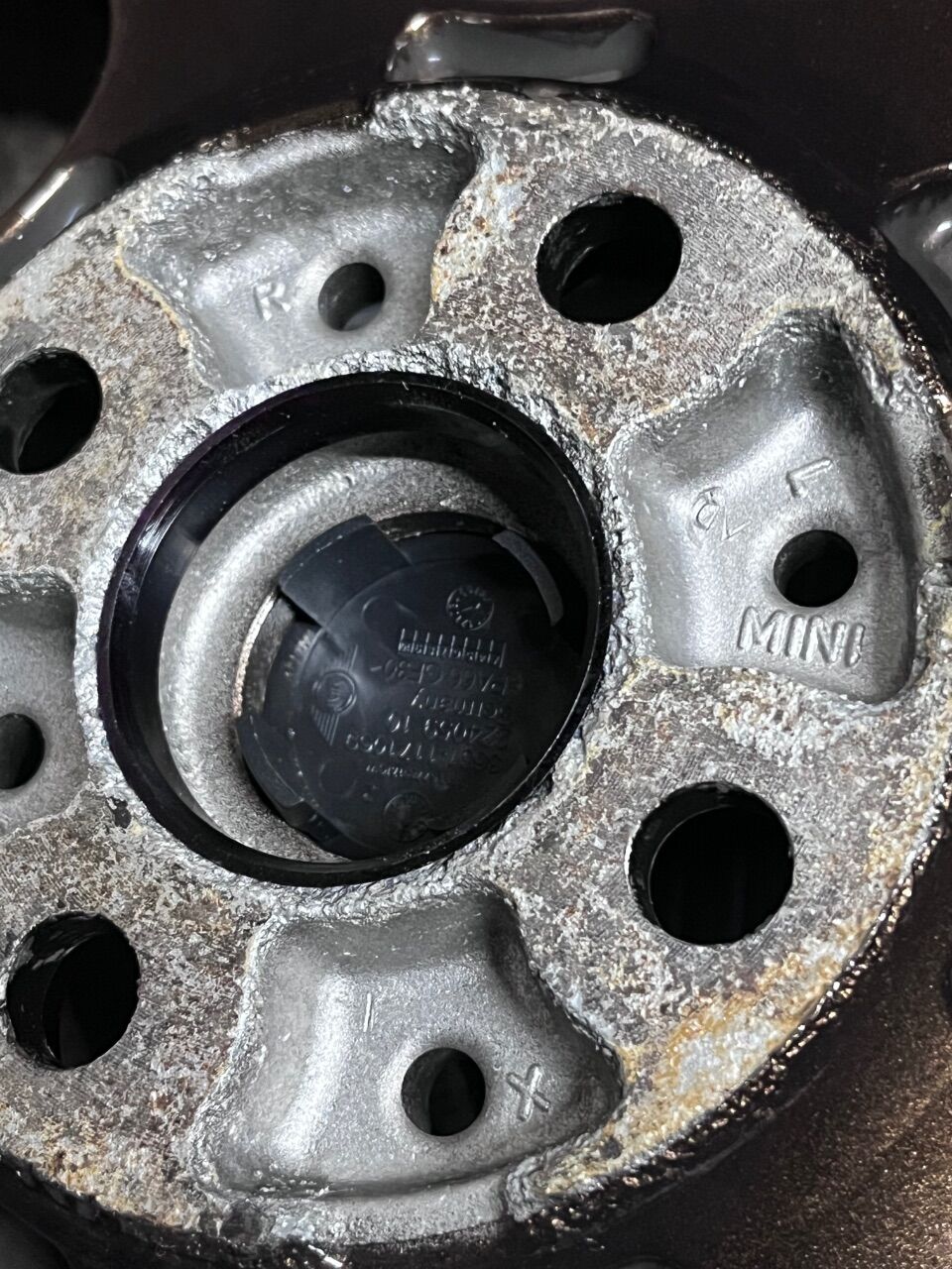

this time remembering to fit the spinach rings
i bought these last year but never got round to fitting - they’re only 1mm thick so not critical but no harm in doing things right for a change :)
looking good

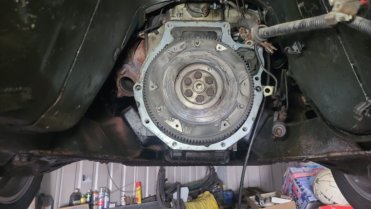

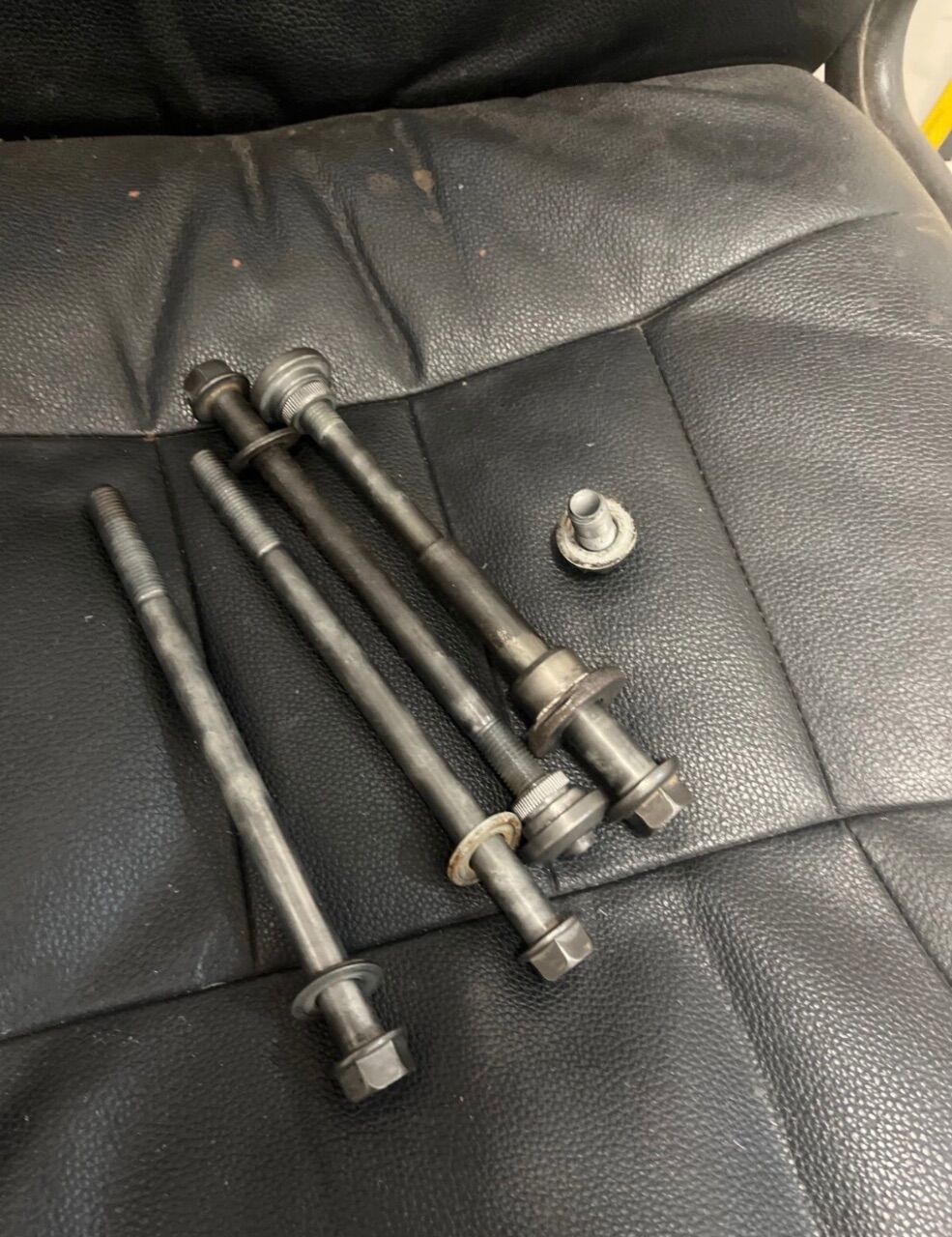

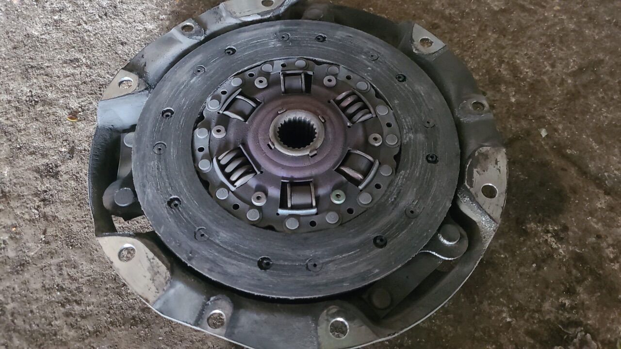

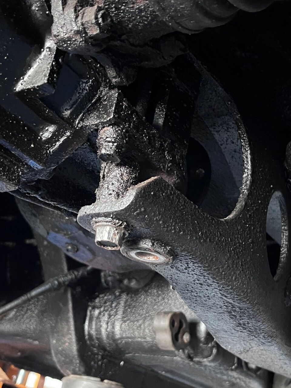

meantime, up at the garage, andy found someone had been a bit clumsy in the past
that bolt is about 10” long and wasn’t coming out without a fight - a replacement was obtained from the mazdadudes and battle commenced
andy 1 - knackered diff bolt 0
“jesus christ, who the hell has been driving this !”
unsure if that is the original clutch but the car is only on 70,000milos
a new clutch and a replacement lightened flywheel were fitted together with main and gearbox seals, a hydraulic clutch line and slave cylinder

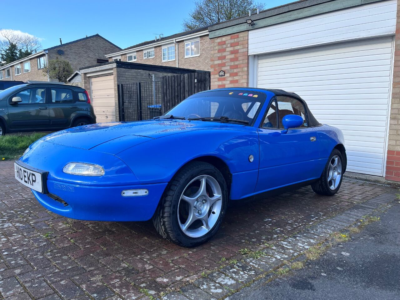

and she’s home
and driving very nicely

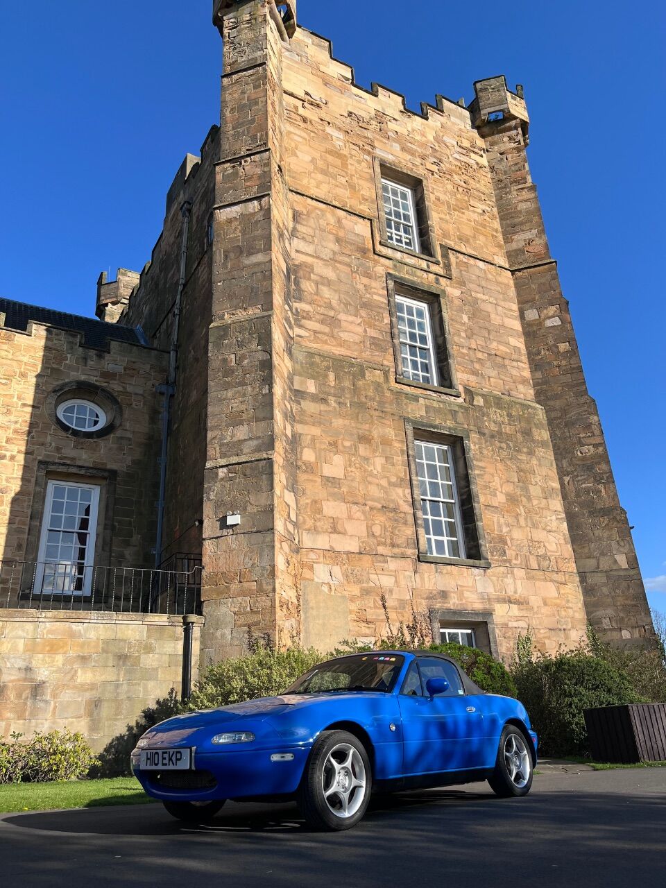

i gave it a much needed wash and headed to lumley castle for pretty pictures

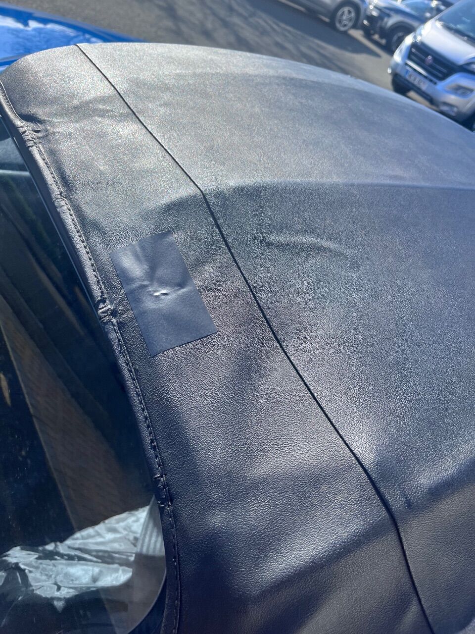

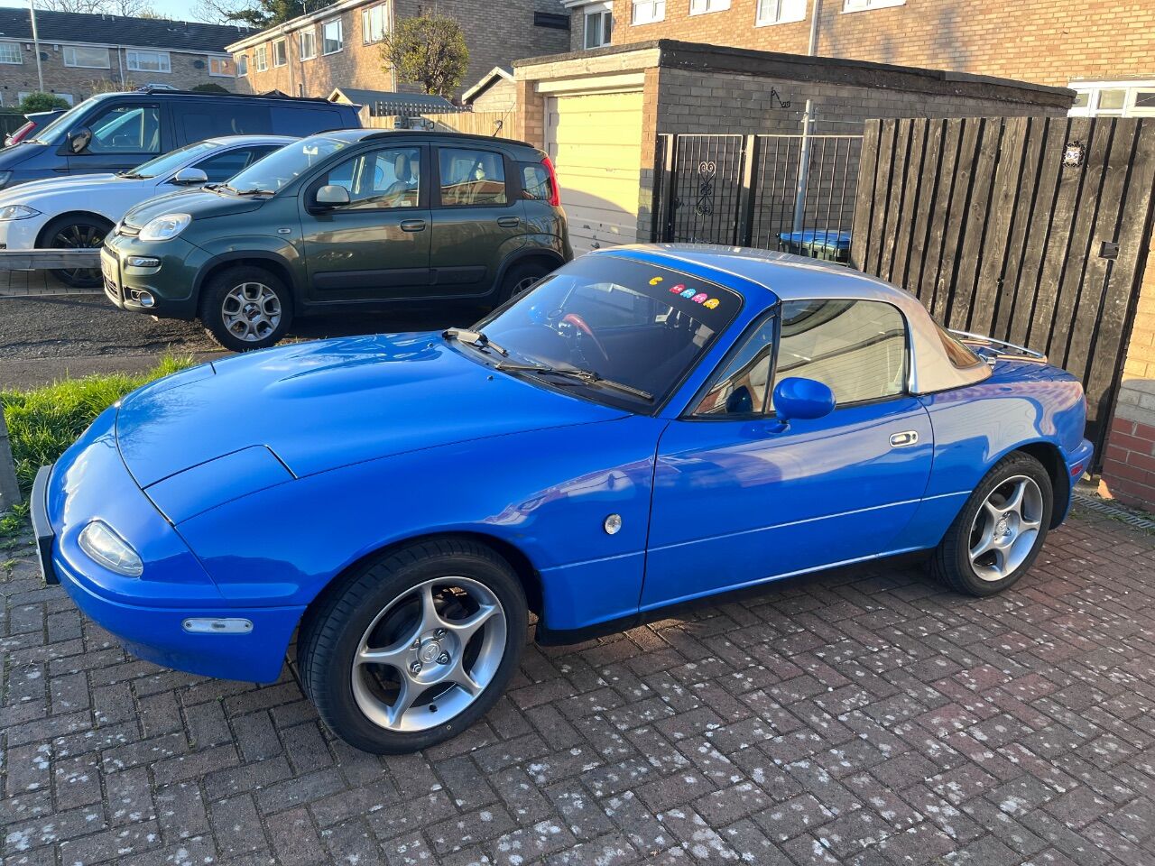

now that Exo has taken over the garage (also it appears to have shrunk !) the poor little mazda is demoted to living outside :(
this was not a problem last year as it came with a hardtop roof
which I sold as I was definitely going to replace the knackered soft top over the winter
hmm, six months later...

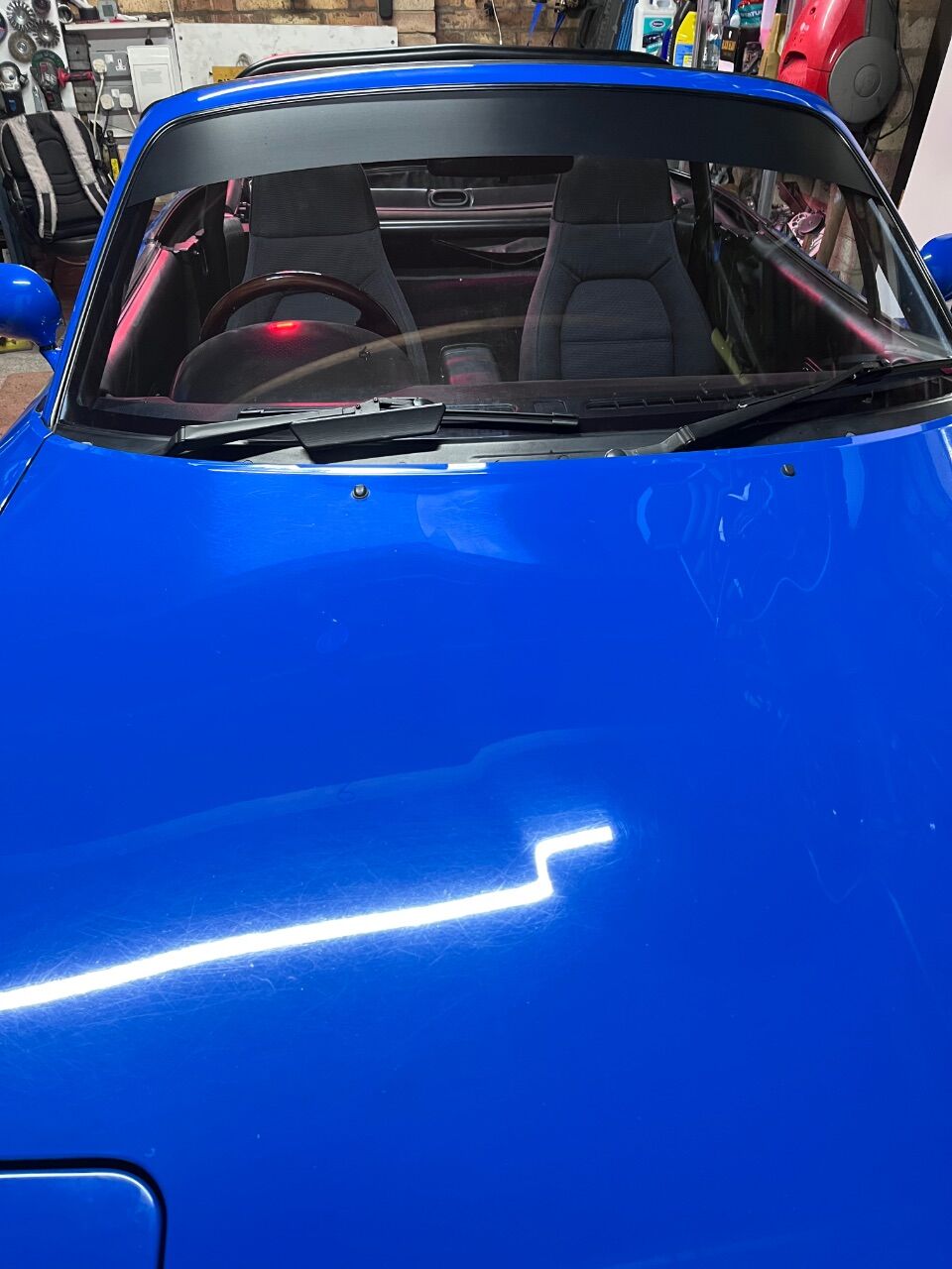

nothing else for it, bought another hardtop !
maybe I'll paint this one to match the car ?
or maybe I'll definitely replace the knackered soft top ?
at least it's watertight again :)

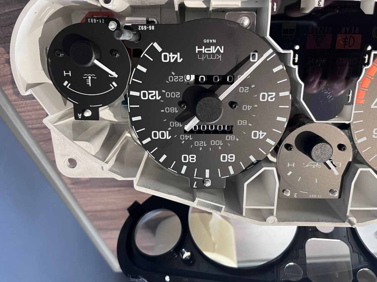

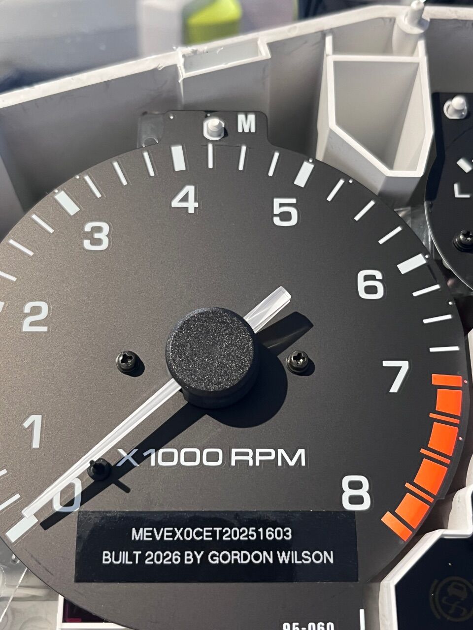

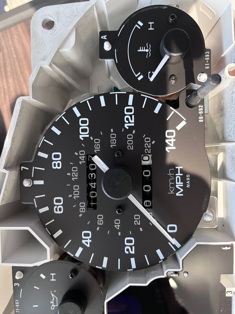

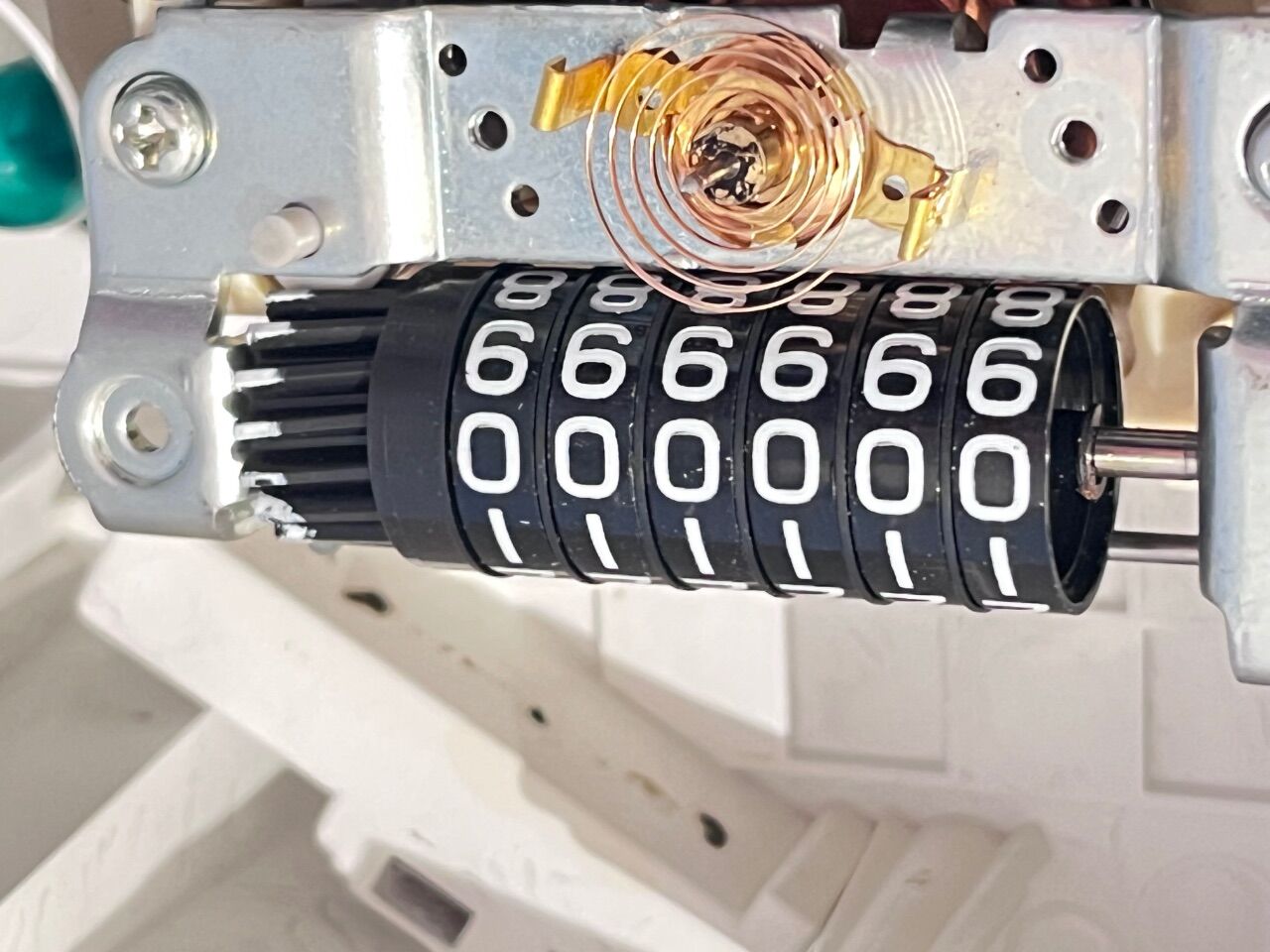

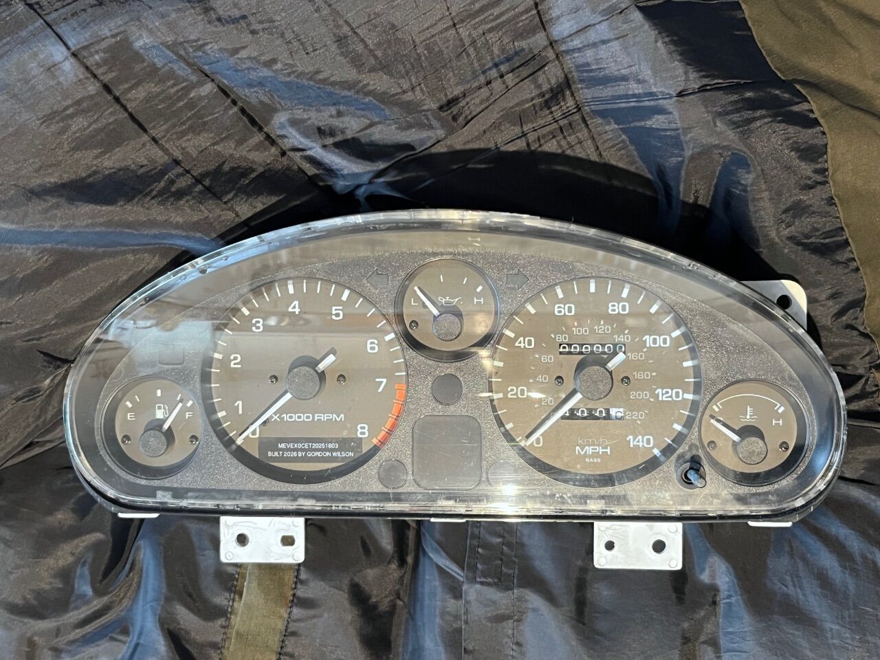

last time I was chatting to fellow Exocet builder Gordon, he asked me how I had managed to 'reset' the mileage on my speedo ?
so I brought his dashboard home with me and set about removing those 104307 milos
carefully remove that tiny circlip and chase it around the room
gently slide the tumblers along
and reposition as appropriate
sorted
and while I'm in there
looks great - he was thrilled to bits when I dropped them off and he spotted the sticker :)
he is now at the stage that everyone dreads and it's time to "do" the wiring - good luck, we'll soon have those numbers moving again !

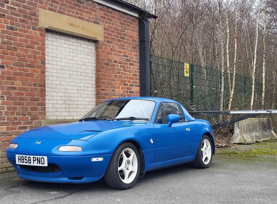

If you get the hard top painted, get it painted black. This way it still looks like a soft top and when you come to sell it, it will be suitable for any mx5 colour making it easier to sell.
not too sure on what colour for the hardtop, probably black but blue does look good.

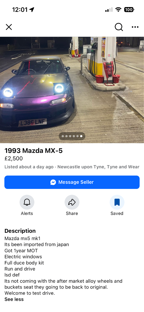

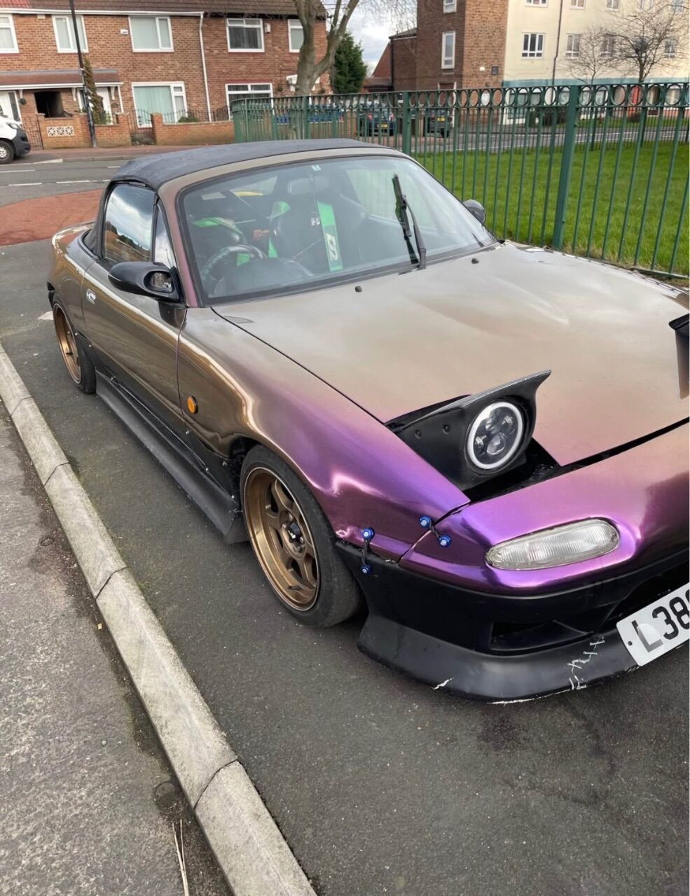

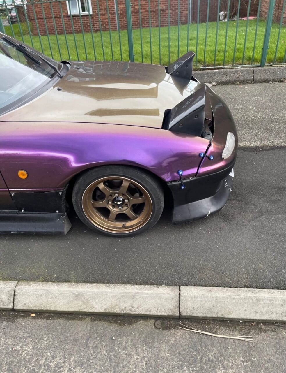

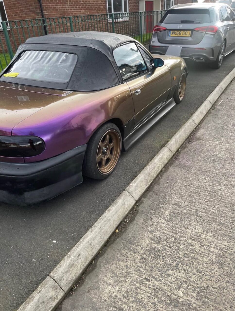

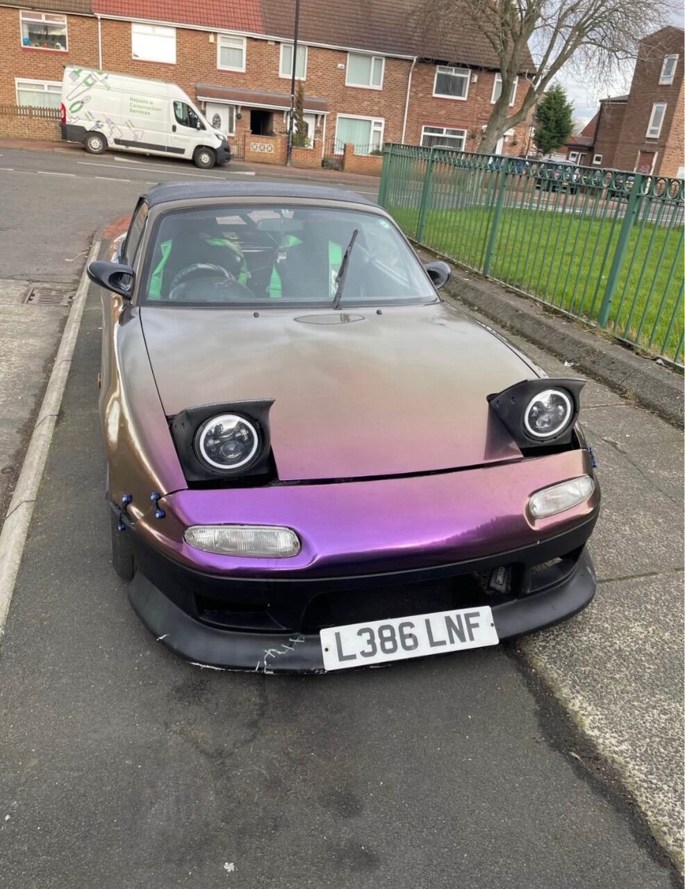

Please tell me that purple abomination isn't the same car I hurtled around Knockhill in with you?
This one on the BM8s along with a black hardtop is the perfect mk1, I reckon. One of my old mk1s came on a set of BM8s and it looked great despite the really rough paintwork.
