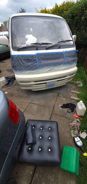

First attempt but plasti dip!
Bigman1207
Ohhh. Been tempted many times to try plasti dip.
Currently tempted to paint my project. Only worry is it still has the original Carrera decals, which would be a shame to peel off.
Is it easy to spray with out runs?
Link to comment
Share on other sites

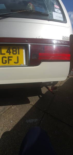

I use a small compressor with an hvlp gun running at 40psi thinned 50 50.   Not had a single run and it was my first go spraying.   They reckon it's better to use one of those Earlex sprayers but already had my compressor.  Settles really well and there are loads of stuff and colours etc.  Check out matt pack.  I bought the clearance product.
I did fuck up with paint reaction on the drivers side but I have managed to lightly sand it back using 800 grit wet so reckon any runs could easily be rubbed out.
Coverage is excellent, five light coats have covered a multi coloured panel, gold and exposed filler, and the front was a a deep metallic kind of brown
I'm no expert but I'm really happy with front and back.
