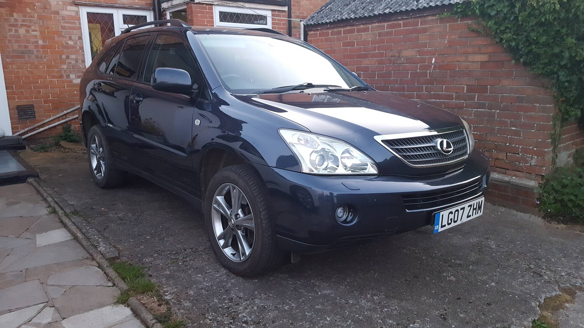

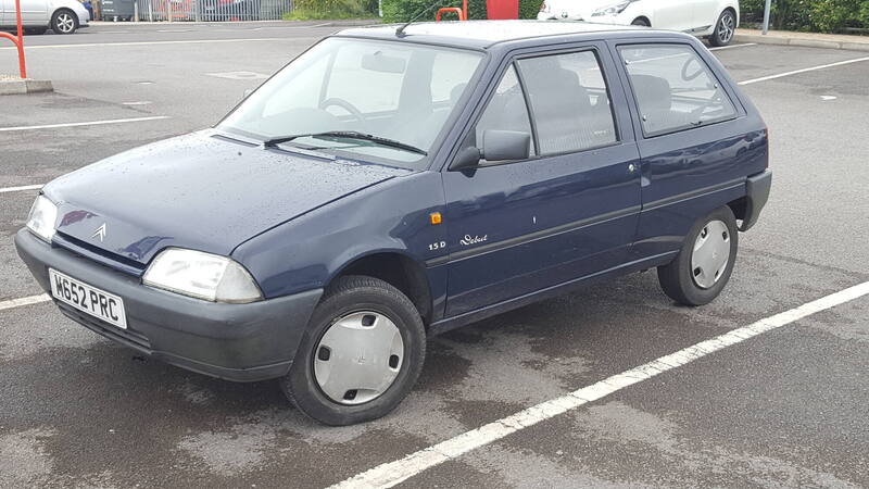

Tomtation Posted July 12, 2020 Author Posted July 12, 2020 So i complety failed to do anything remotely shite with this collection, the AX landed last Tuesday and is remarkably not shit. Sorry shiters, no woolard, pez shot or poo count (was 1 just incase you're interested). Transport device = Lexus RX 400h, whacked cruise on at 70 and just chilled all the way up there, munching scotch eggs, pasta salad and pork pies, jelly beans and grapes for sugary sustainance. Fantastically capable machine. Did it in 1 tank too, 37.4 mpgees (3.3 V6 hybrid ) AX Thoughts? Mildy disappointed. It isn't that slow and it isn't that rattly or clattery, it doesn't even smoke! For a 202000 mile AX? C'mon! It handled the 4hr trip home with aplomb, +1 for 5th gear. Bonus points for smoll (what i wanted) economonomical (indicated* 1/4 tank of dizzle for 235 miles!) and arm day workout steering. Paint? Awful, i likes a shiny motor and for the 1st time evva i MIGHT PAINT! I mean how hard can it be? ? Interior? Bloody lovely, Philip has treated it to GT seats and carpets which are luvverly, the dash and plastics are nice too. Has NEW GEAR KNOB, I likes me a knob so all is well and good there, i can merrily fondle in the knowledge of new-knobbness. Has the standard AX oil leak, plus perhaps another or two - to investigate. Tyres are cracking in places, GT alloys under investigation. Bumpers pale and interesting, GT bumpers also under investigation. Has Saxo rear beam = stiffer rear but not rot and has many other important maintenance and upgrades performed. Would recommend Philip aka AXplug as seller, top feller and top service provided. Tea, kitkats, facilities and tour of enviable shite included, awesome biege thing tucked away that looks lile a Triumph Stag but isn't, can't remember what it was with all the excitement. Only foto i have of it yet, a flattering pose whilst dripping oil onto Toyota's nice tarmac hehe. Dog 1 approves, baby dog 2 yet to experience. Keeeeeep shiting! Coprolalia, Ian_Fearn, LightBulbFun and 6 others 9

Tomtation Posted December 7, 2020 Author Posted December 7, 2020 I had a quick look at the AX last night, all lights and electrical items appear to work at their normal rate, but i didn't find the multimeter and go prodding cos dark and cold. I did see that there seems to be a significant fuel leak, which is washing the oil off of the engine and distributing it underneath the car nicely! Looks like leaks from around at least 2 of the glow plugs, hopefully these just need tightening but maybe also seals? Injectors look ok. Looks a bit dramatic! I topped up the oil and coolant too whilst i was there as these were on minimum levels, again. lesapandre 1

Tomtation Posted December 9, 2020 Author Posted December 9, 2020 So I am at home today and thought i'd just tinker with the AX. Turned the key and the bloody thing turned over! Very very slowly though, maybe a revolution every second, but enough for the little beaut to fire - it is a keen starter this. Perhaps the battery is a dud, ordered an Ancel BA101 battery load tester to find out - should be a useful piece of kit for the other vehicles too and fun to play with. I've done some shopping, apart from top-up oil and tax etc it'll be the first money i've spent on the AX ever! Ordered rocker gasket, sheets of cork make-your-own gasket and some engine cleaner so I can try and attempt to see where the leaks are coming from. Water leak 'Clean' side Less clean side! This was after a 40 minute each way motorway drive to see my sister, it didn't start the next morning. The tyre and pretty much everything else down here is covered in oil/fuel. I've been under here before and not niticed this. Not sure if the injectors and/or glow plugs are leaking fuel or not, there is a fuel leak as i've seen fuel drops behind me after parking it. I'll give the front of the engine a fecking good clean and see what I can see. I was hoping to take it upto Worcester on Friday to collect a new gearbox for the Hearse, it's 130 miles each way... Dare I? spartacus and louiepj 2
Axplug Posted December 9, 2020 Posted December 9, 2020 As PO I’m sorry to hear it’s blotting it’s copybook with leaks........I think I said when we met I thought the starter was on its last legs as it had just started doing what you are experiencing with me.....it shouldn’t be the battery as that was a new one from Tayna a few months before I sold it... the starter i think is probably feeling it’s 200 k miles as I didn’t touch it so the brushes may well be worn which may explain the intermittent nature of the problem. You could try tapping it with a hammer to see if it makes it work when it’s playing up but I would swap it over I don’t think it’s hard to do . I did the rocker gasket myself in the same attempt to find the source of the oil leak which made no difference......! I think you will find the leak might be head gasket related as I think I read that TADTS. .....which I never had time to get around to.....I noticed the oil around the tyre and thought it was the engine oil leaking and being thrown around by the cv joint. But it’s quite hard to see whereit’s coming from as you say a clean might help! The other leaks I am afraid must be new ones ! All the best in sorting it anyway ......
Tomtation Posted December 9, 2020 Author Posted December 9, 2020 Nice to hear from you Phil! I hope your getting on ok with your shite, did you get anywhere with your 1.0 AX? I did read about the HG TADTS and hoped the rocker hasket at least in part wasn;t helping. I;ve ordereed one, so may aswell go ahead and fit it/clean etc. I think I saw an oil leak from the mystery item where the distributor would be in a petrol, so I might have that off too for a clean and replacing of gaskets. I remember our conversation about the starter and battery, i'll waity for my snazzy tester to arrive to OK the battery then look into changing the starter - might have to be a 2021 thing if it can hang on in there! The oily tyre might be something to do with the aux belt flinging oil about too. The coolant leak (at least the one I found!) should be an easy fix at least. For the fuel leak, I am using alternative fuel for the previous and next 2 tanks, so this may affect seepage etc.
Axplug Posted December 9, 2020 Posted December 9, 2020 Hi Tom hope you’re well....your plan sounds more likely to work than mine ever did.....yes I’ve still got the sister ax and it firstly needs the rear axle bearings done. I bought a ‘good’ axle off a breaker and after much hammering of the torsion rods it came apart and one pin was completely shot so I got another off eBay ( this could have gone on for some time) and that one amazingly is ok both pins are good so just need to rebuild it up and put on. (I did yours a while ago when it failed an mot and the pins on the one I put on that were perfect and well greased with genuine citroen bearings so hopefully yours will last a good while longer) I’ve been distracted by getting my citroen dispatch van going.....with the 1.9 non turbo and extra weight I seem to find myself going about the same speed as I used to in your ax! But citroen certainly can make decent Diesel engines that seem to last for ever...... 500tops 1

KitKat Posted December 12, 2020 Posted December 12, 2020 You're probably onto something with that alternator. Even if it isn't wholly the source of your starting issues, it won't be helping. If you have a few other vehicles - which it sounds as though you do - why not swap a known-good battery into the AX, run it for a week and see if it makes any difference?
Tomtation Posted December 12, 2020 Author Posted December 12, 2020 Hey Kit, i'm not sure any other the other vehicles has such a meaty battery tbh, the hearse has a tiny thing, the Lexus about the same (cos hybrid) - the BX's might have similr - i'll check it out. The AX battery has taken some good charge over the last 6 hours, there isn;t much more juice going in it so i'd guess it is a good'un. 6:45 tomorrow morning will tell! Will the dizzler start?!
lesapandre Posted December 13, 2020 Posted December 13, 2020 Cycle the heater plugs 2 or 3 times before start up to help it. Good luck. Tomtation 1
Tomtation Posted December 13, 2020 Author Posted December 13, 2020 Batt fully charged, tester results to follow. Starter fucked. Not a click or anything at all! Probably needs a whack but i can't be doing with that this morning. I'll get a new one ordered up today anyway. lesapandre 1
Tomtation Posted December 16, 2020 Author Posted December 16, 2020 New starter arrived today which is brill as I ordered it Tues morning ~2am. It is wet AF here though so im not going to be getting under there and fiddling, fingers crossed the weekend will bring better AX fettling weather! *checks weather forecast Sat afternoon and Sunday look much less wet, maybe even some sunshine! That'd be a nice change. Still no make-your-own-gasket stuff yet, might have to check on that as everything else I ordered arrived days ago. KitKat 1
Tomtation Posted December 20, 2020 Author Posted December 20, 2020 Starter motor replacement success! Electrical connections all nice Primer bulb replacement, i assume the old rubber leaked air and so the PO replaced it with a nice length of copper pipe. I was worried it wouldn't run properly on reassembly due to lack of fuel primage, but had nothing to worry about in the end. Not sure what the yellow connector is for, there are a couple of unused electrical connectors but the car has been converted from a Lucas (satanspawn) to Bosch pump by Phil, Axplug, thank bloody goodness too as I bet the Lucas wouldn't have fired up so nicely. You cannot believe how oily and filthy I got... It is gross in this engine bay. New (right) and old (left), book/judge/cover etc Took a few hours as was well fiddly, had to take the fuel filter off to access the 3rd bolt which caused some panic as the primer bulb has been replaced with a length of copper pipe. Old mechanic disel + air in fuel system = a bad time. But the old girl fired up instantly, although lumpy whilst the air cleared she purged herself nicely. I now have a good used starter installed, delivered for £29.98 and guaranteed for 3 months - feeling like today was a bit of a win! I didn't start till after lunch so ran out of light for the other jobs, but they can wait. The new fangled super battery testing toy said the battery was at 98% charge, 535 CCA (out of 540) and low resistance, there was also 14.6V going in from the alternator which sounds good - this was once the belt had warmed up a bit and stopped squeaking. I did a vid for those who like listening to old diesels and because I was genuinly surprised how quickly and nicely she fired up. Keep shiting folks. lesapandre, Fumbler, 500tops and 1 other 4
