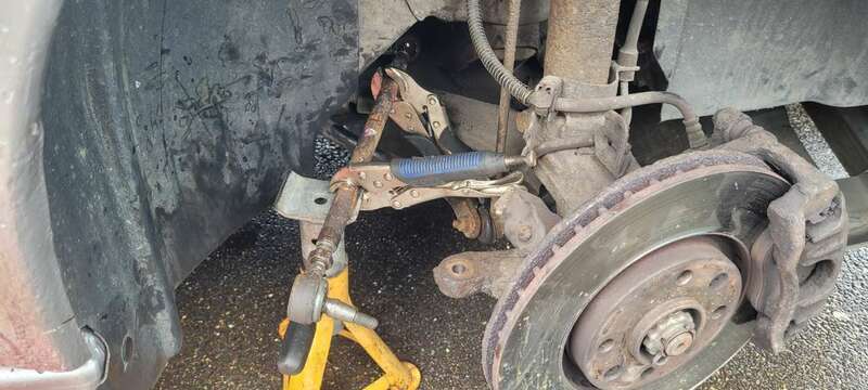

20230826_141612.jpgWell this isn't going well, I can't get the bastard track rod end off! And I'm failing to clamp the inner tie rod enough to do much else...
And it's raining!

put some heat on the tie rod, even a heat gun will do. Also get two hammers and smack them together with the rod between them. Shock and heat are your friends.
Once you finally get the new gaiter on if the access is anything like my 307 which I believe shares parts with the Xsara you won’t be able to get a cable tie tight enough on the gaiter, I used a jubilee clip and lots of extensions to reach in and tighten it. I couldn’t get a cable tie to hold.

Can you not pass the boot over the track rod end?
Put it in hot water to make it pliable then should be able to stretch it over?

I've given up for today. Before I damage anything I can't drive home on...
I think I've got to get an inner tie rod end for sheer ease. But I can't see any flats in the inner where it screws onto the steering box...
Do I just grip that bit and it cracks off? Driving home bootless too, best not do that too much
Link to comment
Share on other sites
3 minutes ago, grogee said:
Yes. With one of these. Other designs are available.
I've got one of those too, it tried it's best to twist the track rod end off. Was just expecting flats, the lagunas had them!
Will get an inner rod ordered. Tbh the old boot was fucked and in 3 bits, probably didn't do the grease in the joint any good

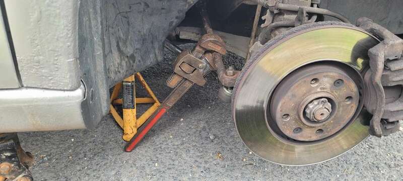

1 minute ago, Tickman said:
Got access to Stilsons?
They have worked well for me in the past where Vice grips just slip.
^^ this if there's no flat on the inner edge of the drumstick?
Funnily enough I bought two stilsons for my Laguna as I couldn't find any flats on that one?

I now own a stilson!
Told Grandad the story and he went 'do you want a blue one or a red one? Then out we went to the big shed and he gave me the red one as its not as chewed up!
Still going to fetch the inner rod tomorrow (and return the other gaitor I don't need) as it needs a retest Friday no matter how I bloody fix it and I'll give it a go when I've got the wheel off and try it!
Then I'll probably still replace both, the ball joint on the inner doesn't look too healthy after it's exposure to nature, but at least I'll know the stilson trick for next time 👌

OK, 3.30 I assumed the position again
And for a laugh did try Grandads stilson. Which did rock the inner rod around on the tre but was faaaaar too long to be of any use here.
So after smashing my thumb once and fetching the 2nd extension to make the removal tool sit straight we had progress
