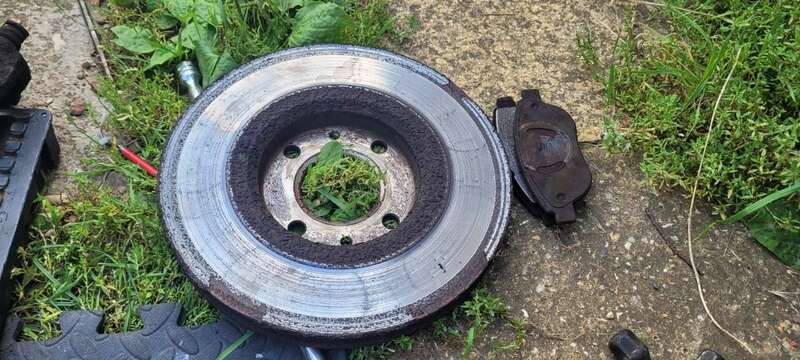

And on the passenger side at least, it all looks grim but not horrifying.
Took the pads and carrier out and ah, it doesn't look so pretty now...
Then one of the disc retaining screws started to strip. Luckily hammering a larger screwdriver bit into it worked
Then I turned the wheel and got the T55 torx bit and the breaker bar out
It went with a mighty crack on each bolt but came off nicely otherwise
All came off nicely and I gave it all a good clean up
Sliders were quite grim, and even after cleaning them up one is looser than the other, and the tighter one of the 2 feels quite stiff. But they do slide.
Had this tube of goop for years now, it's been very handy!
All was going well, and we're going back together! New disc on, retaining screws in and then the caliper bracket. I got the bolts started, and ran them in and gave them a few clicks with my small impact gun. I then went at the bottom bolt with the breaker bar and
Arse. A text to a local mate who said he had one and would text me later gave me some relief, and as I'd mildly ugga dugga'd the top one in imminent doom was not going to happen, and I can get to the bolt later so I carried on
Much shiny, more thick
All looks much better from this angle now
And I gave the wheel bolts a clean off with the wire brush and brake clean
They spin in so much nicer now! Currently paused waiting for a replacement T55 to be in my hand (and I'd best buy a new one so I've got it) then I'll finish off this side and do the other. It all certainly wants changing, which is good to see now I'm changing it!

My mate came round with his medium size impact and a T55 bit and in 6 minutes we went from this to this
He went home after this and I carried on with the pads, which went well until I noticed fluid pouring from the engine bay...
Obv this was the brake fluid pushing back out again and the pistons needed to go back alot 😂 Fired some brake cleaner at it, will do it again tomorrow in the daylight
I taught Charlie what down and up means and we got the brakes bled. They didn't need bleeding but I pushed 5/6 pumps through, it was a bit grotty

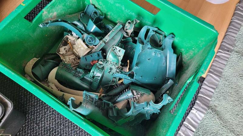

Currently refurbishing the green ones, anyone fancy a cheap REALLY good vacuum in a few weeks? Stripped and washed the floor heads, main bodies are next on the to-do list
