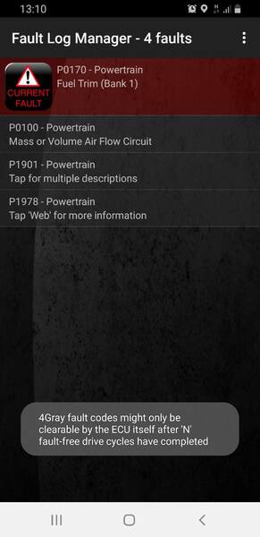

So on 3rd March  Shirley threw up an EML and 4 error codes.
EML went out next day of its own accord, but as the codes looked like a MAF issue. I ordered one.
Work is quiet today, so in a fit of enthusiasm, during a break in the rain, I headed out with my trusty 7mm spanner to replace this.
Disconnect the wiring
Loosen two 7mm nuts
Find that you can't get the pipe off the MAF, so disconnect the other end from the airbox to allow maximum force to be used for wiggling pipes that ain't been off, since it was on the production line.
And they are separated :)
In true HBOL fashion, refitting is a reversal of removal.
Plug in my torque pro dongle thingy to clear the codes.
Then rescan
Then cry 😢
Still no EML on and runs OK. Bit of hesitation when revving it, as revs start to drop, revving again gives the hesitation. Fuel pump?
Any ideas folks?

Slightly blocked injector? Needs an Italian tune up? Or if its fly by wire maybe a throttle sensor?
Italian tune ups have not made a difference.
Not sure about throttle. Dont think its fly by wire, but will check

Ok. Weird. Took her for a spirited drive. The previous hesitation at 3k rim has now gone. So the new MAF has done something :)
But she now has 5 fault codes, instead of 4 :(
'Expert' on owners club has suggested that the first error code is likely to be failing 02 sensor.
The game of 'throw parts at it, till its fixed continues :)
23 minutes ago, Split_Pin said:
Quick google search says the same, 'experts' eh!
Lol I'm no expert - clearly - as my Google skills didn't find that info. Oh well at least she has a new MAF now
Well Shirley is booked into garage next week for investigation and possibly new 02 sensor.
Still runs fine, but does smell a bit petrolly, which may indeed indicate knackered lamda sensor - although weird its not throwing EML anymore.

You don’t have an air leak on the inlet side, so it’s struggling to get the trim right due to the excess air? Might be worth a spray if wd40 or the like around the inlet manifold and any joins to see if it affects the idle.
Shirley now has a new 02 front sensor and no error codes :)
