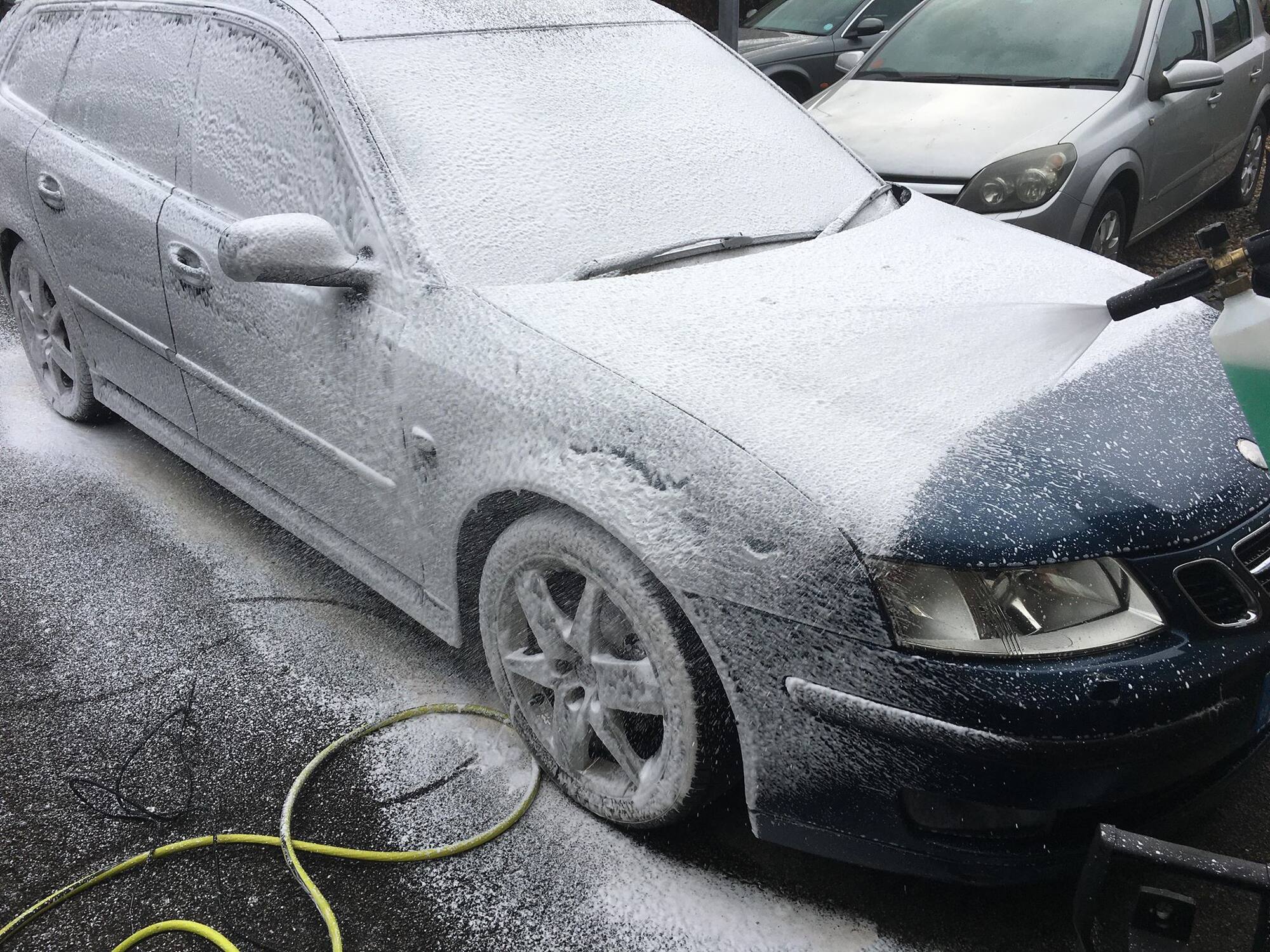

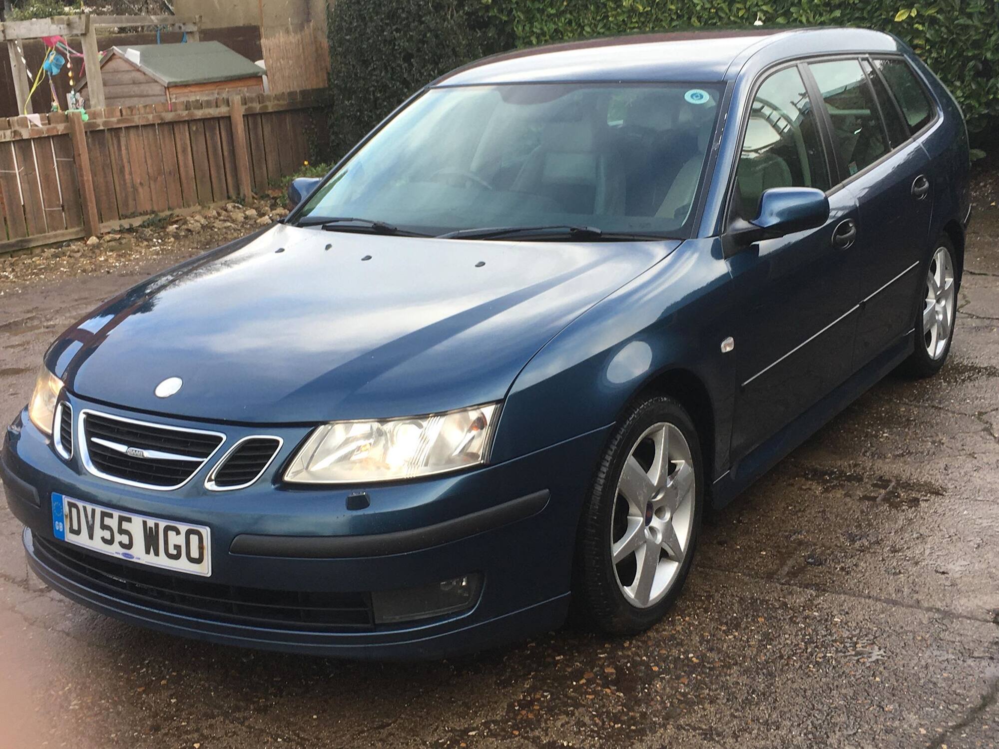

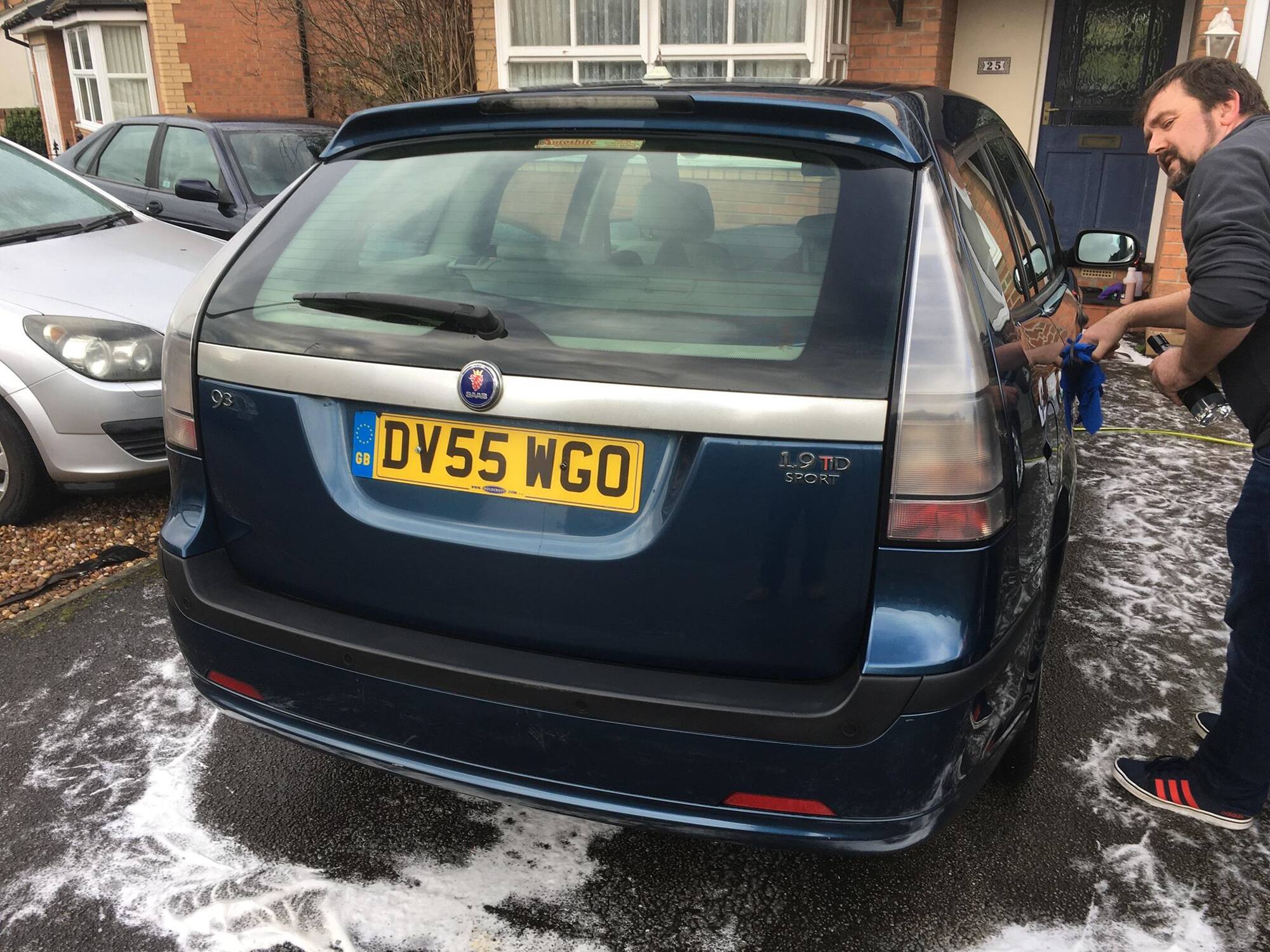

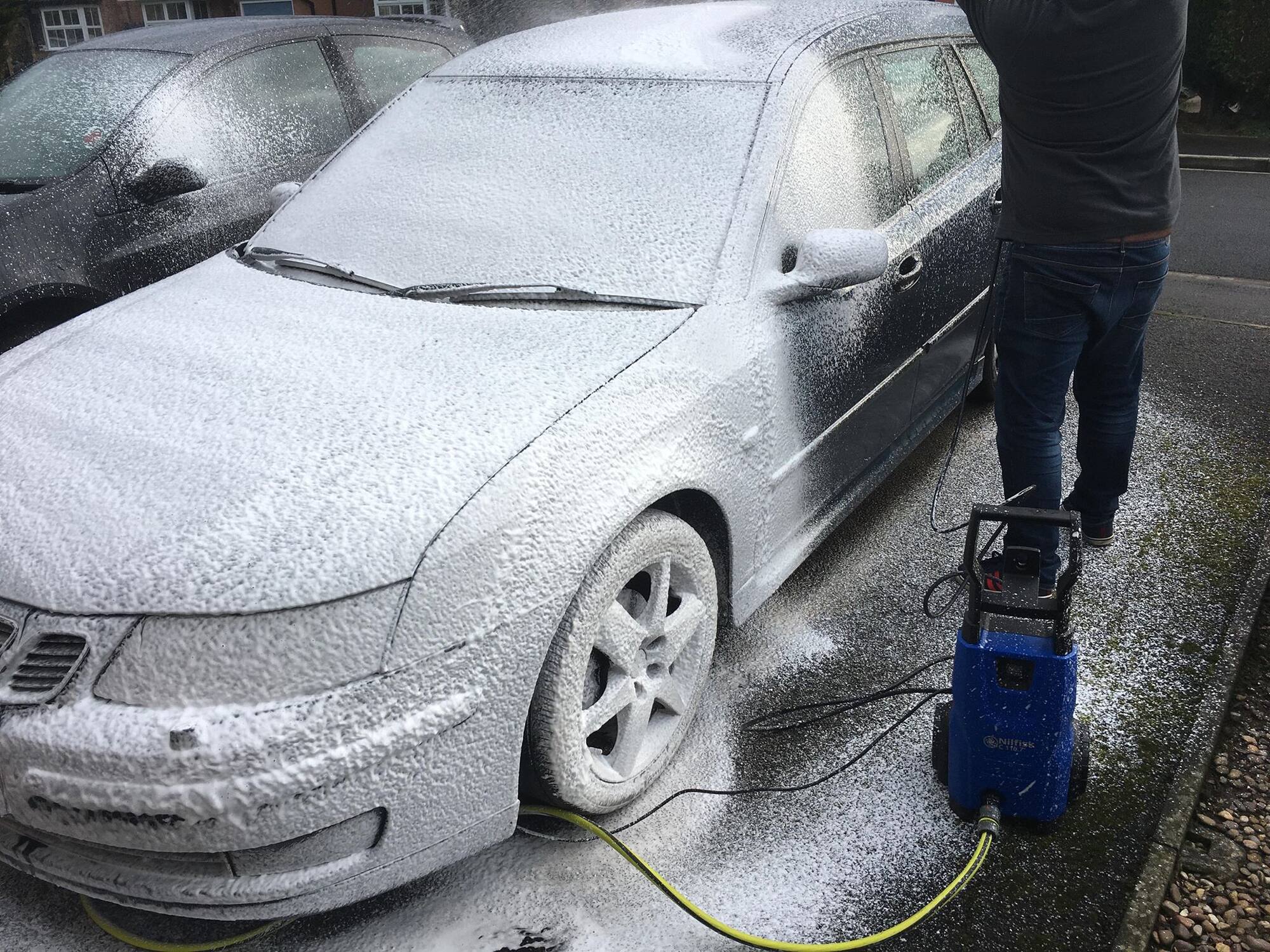

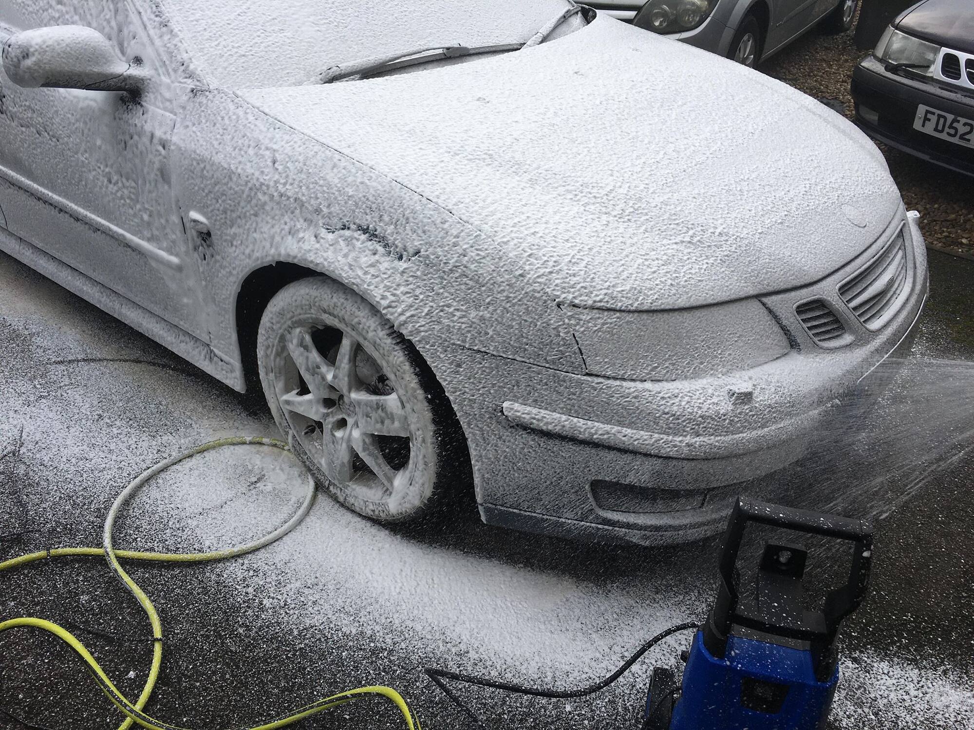

Another update I guess.
Shes been shown some love today.
What do you think? Does she look brand new or what?
83341336_610743746405887_2450503894359343104_n.thumb.jpg.cd00f445a5b7fb445dff2ac3056b7ce3.jpg83316875_222274728770366_1262840107237376000_n.thumb.jpg.d4db684f208173b54609859c6364feca.jpg83304212_478029519794017_4475394491238318080_n.thumb.jpg.3ea771f86b313260ca64f9f2d26a9412.jpg83231508_510002582966279_4777551578020184064_n.thumb.jpg.a68a50a1d0f5d4191069aa72671de47c.jpg83194796_2508183119439138_4985224396516884480_n.thumb.jpg.e967c3866bad02bdeccfd7299ecc3e31.jpg83187605_247611726227472_8503243090901860352_n.thumb.jpg.77f68324044bad50754797dac9c357be.jpg83171325_195224658339083_2986037211809447936_n.thumb.jpg.180f113aa8402238ddac276c0bdc801c.jpg83003604_2733392863417359_4540161408356057088_n.thumb.jpg.9b7c6835e3de81a6b36c3951eab9519f.jpg82997249_115384826523993_7049984882746851328_n.thumb.jpg.d56ffbc879a81e067c7cb71d99b51a0b.jpg607573912_82997249_115384826523993_7049984882746851328_n(1).thumb.jpg.b5e60753a425435613328f9f65eb2e35.jpg82975427_490702044837532_6489870900526055424_n.thumb.jpg.3202eccf5edf38ded9f04a3d3f481637.jpg84348814_1109456606067527_7430779599493005312_n.thumb.jpg.6e828177abeaa6596776dfe45b1db718.jpg84022343_410476053078980_1447258430900273152_n.thumb.jpg.fbfd1b51a59378791c733655172053ea.jpg83996537_115483963174057_5624724282199244800_n.thumb.jpg.28379c6029ff50e54be5e34da9c7312c.jpg83896891_235611067446484_3022711396384112640_n.thumb.jpg.1f9ccb21a30eea9a8df00c943c0ef456.jpg83868044_516665285644882_5836794464307249152_n.thumb.jpg.fb5d1ac923ee9a025b62fe457d78b245.jpg83659838_192240885326458_3284293295760474112_n.thumb.jpg.a9c432e85e6ca335ffb62078c3b5802e.jpg
Interior is still yet to be done as I ran out of time today! But shes still looking great!

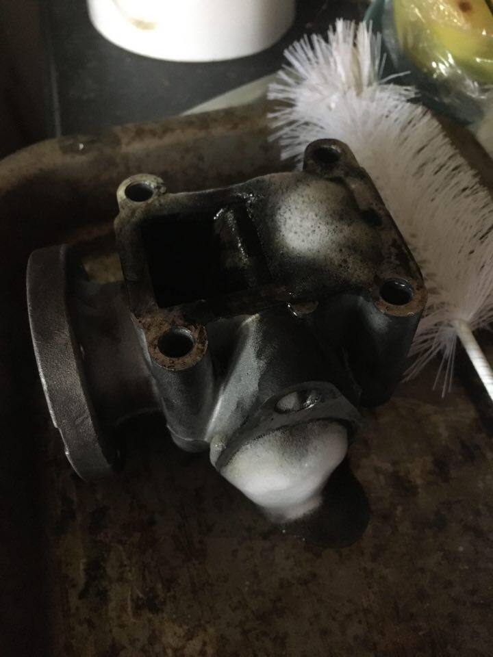

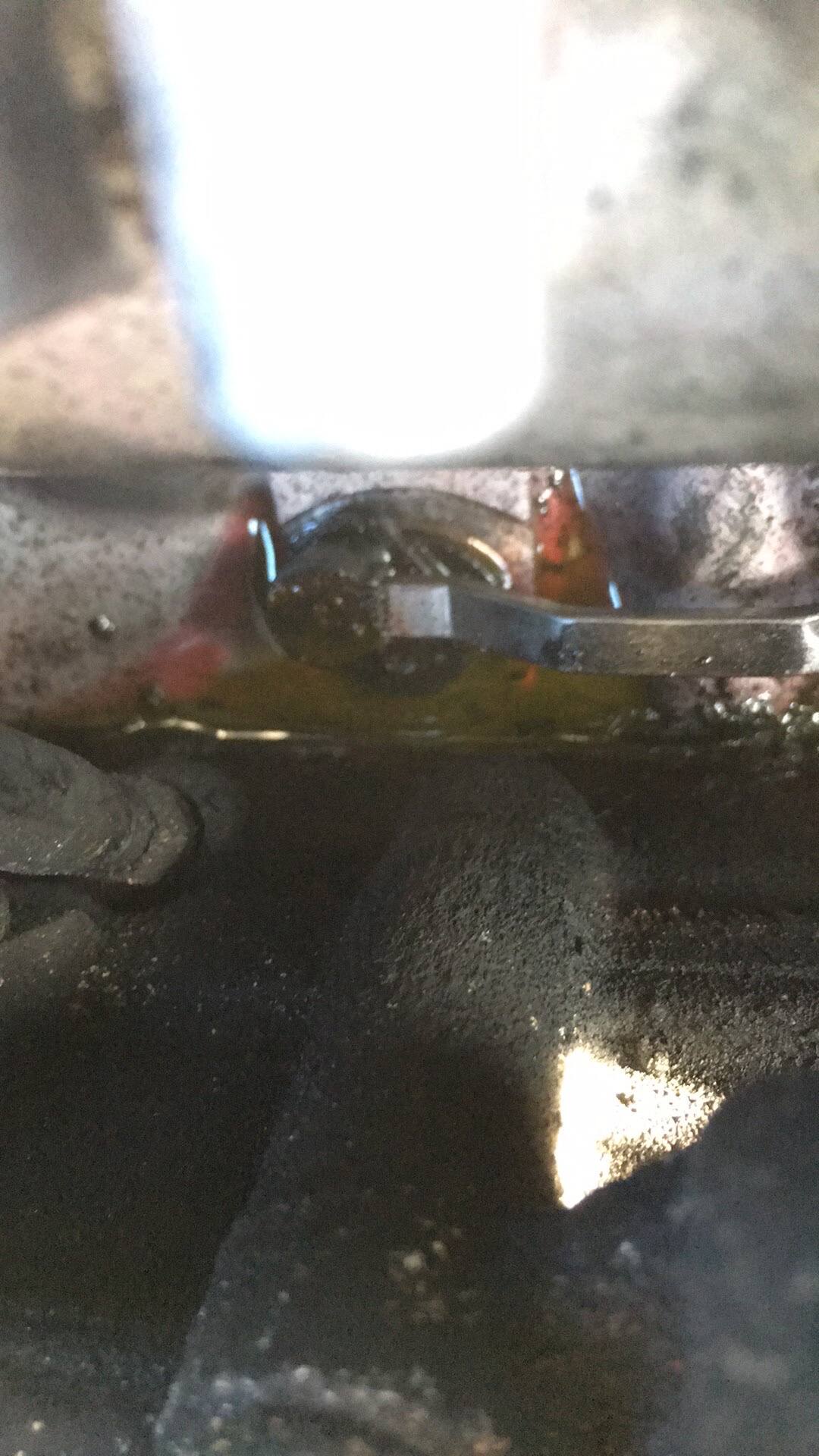

EGR Valve is causing the low bogging down issues with power - So here it is soaking in a vat of EGR and Mr Muscle Oven Cleaner.
The original plan was to blank it off but the garage have told me not to, it'll mess with the DPF and shit itself. Those where the actual words lol.
So I'll use the gaskets I have in the blank kit instead.
I will replace the EGR valve but I want to see how this goes first.

May ell have done, but its cacked up to shit to the point hwere I have done a leak test and it is letting by because its not seating correctly on the piston - therefore bogging down.
This is an aftermarket one, which dontlast very long but I am going to buy two or three new ones and keep them handy for when it cakes up again.
manifold is ocming off next for the same soak treatment.
@cpjitservices the EGR was replaced a month or so after the MoT so June-July last year, but as I had stated previously it had 3 or 4 during my ownership of the car. The wiring connector was always dicky on the EGR and (was before I bought the car in 2015).
Before you whip the manifold off, get a set of the blanking plugs for the spare one and give that a clean up and then de-flap it, then you can just swap manifolds. It was my long term plan to do that if I hadn’t got the Suzuki.
Are you doing the manifold removal yourself?
Yeah I think EGR's are just a piece of shit lol.
Yeah ill whip it off myself at some point and see what I can do - and maybe de-flap it - I may get the garage to do it for me.
I did the manifold change over a weekend, you don’t have to remove the cam belt but you do need to line up holes in the injector pump pulley and bolt it to the head to keep the timing correct and knock the pump out. It’s a bit of a ballache if you don’t have star sockets and allen drivers for a ratchet. Then again I have hands like a quarter pounder burger with 5 saveloys attached which didn’t help.
