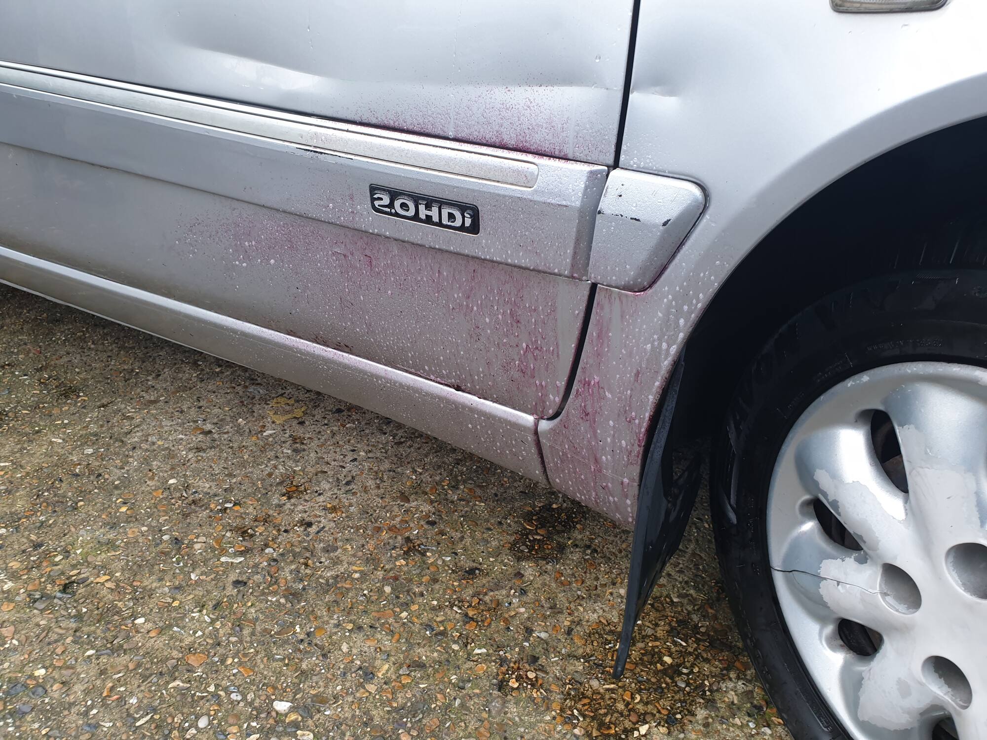

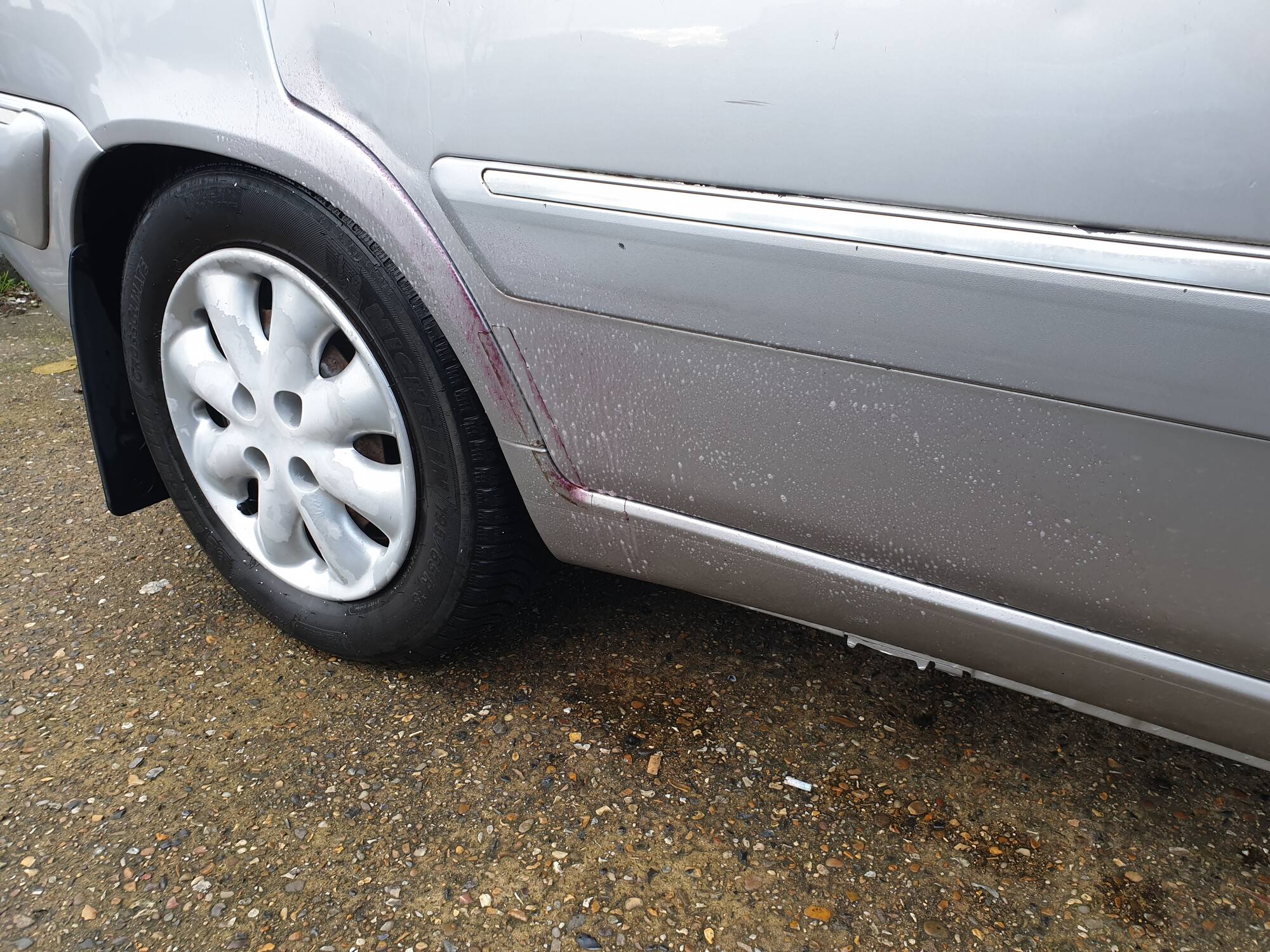

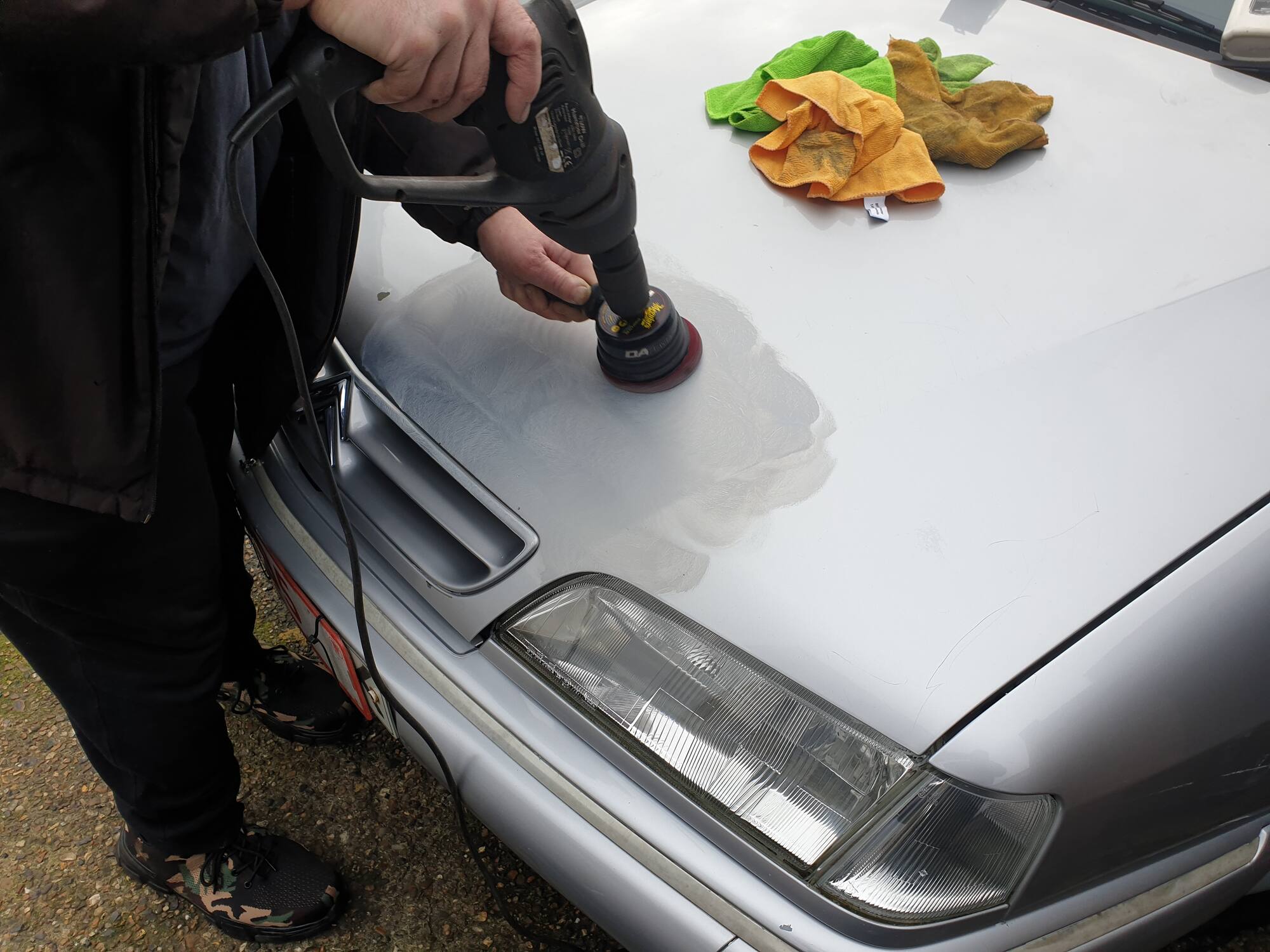

Iron Out was sprayed around the car and much purple residue was washed off.
Bilt Hamber clay was being warmed up and put to good use. A lot of lube was also used.

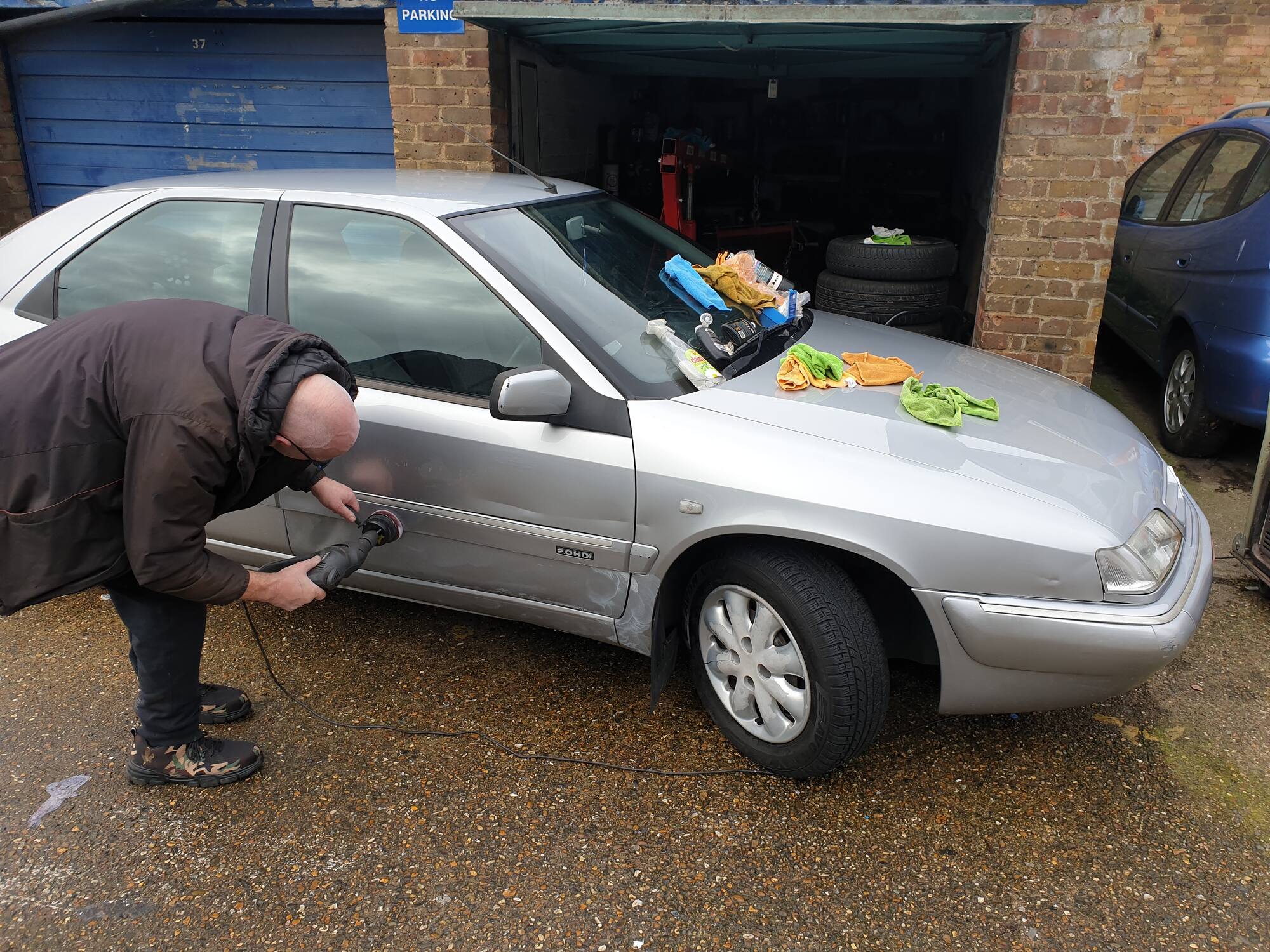

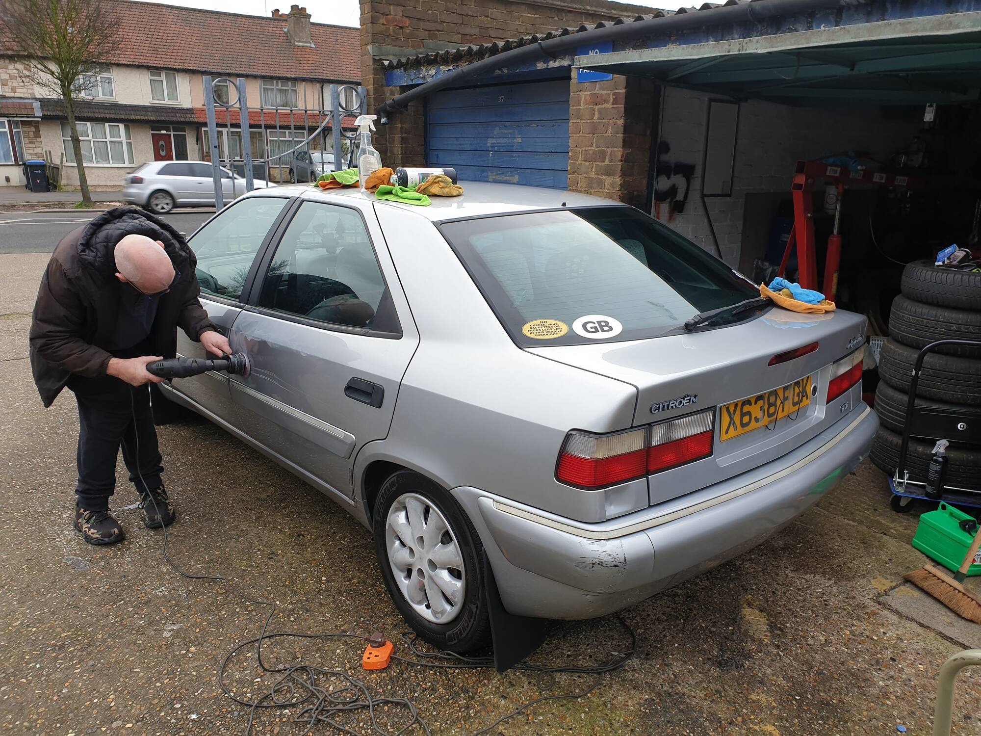

A shit load of contamination was removed from the Xantia's paintwork and already it was looking a bit more shiny.  The Big Genny was fired up and the Meguiars DA attachment was fitted to a 'lecky drill.  Various compounds were utilised to make the paint even more shiny and to try and remove the dozens of scratches (of varying depths) from a lot of places on the Citroen. There was a fair bit of success, sadly some of the scratches were down to the base coat and beyond the capabilities of the drill orientated DA. However, it gave a good account of itself and the results were pleasing to all concerned.

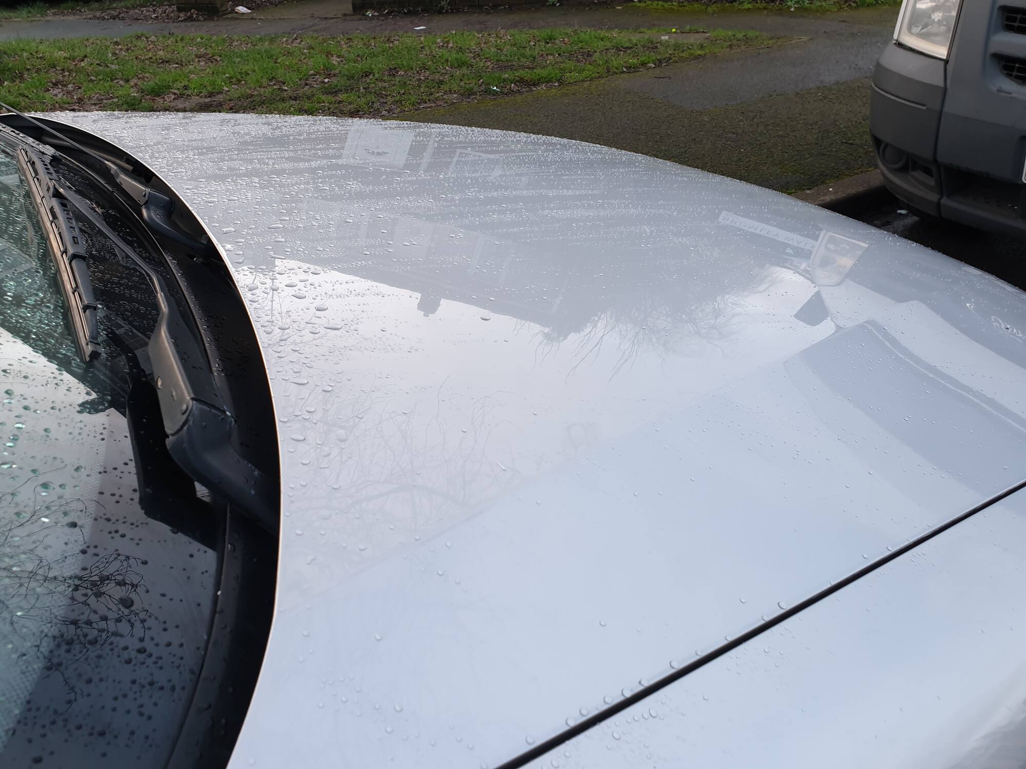

The paint was polished using Auto Finesses excellent Tripple polish, a little really does go a long way.

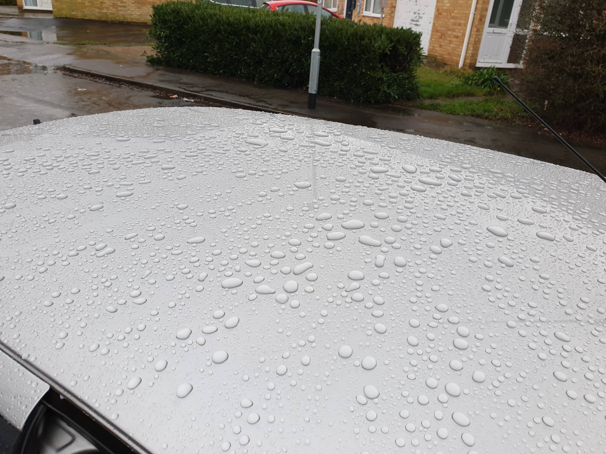

Next up was the Meguiars ceramic spray. This was entirely new to me. Thankfully it went on easily and polished with a microfibre cloth with hardly any effort. The paint really did look great.

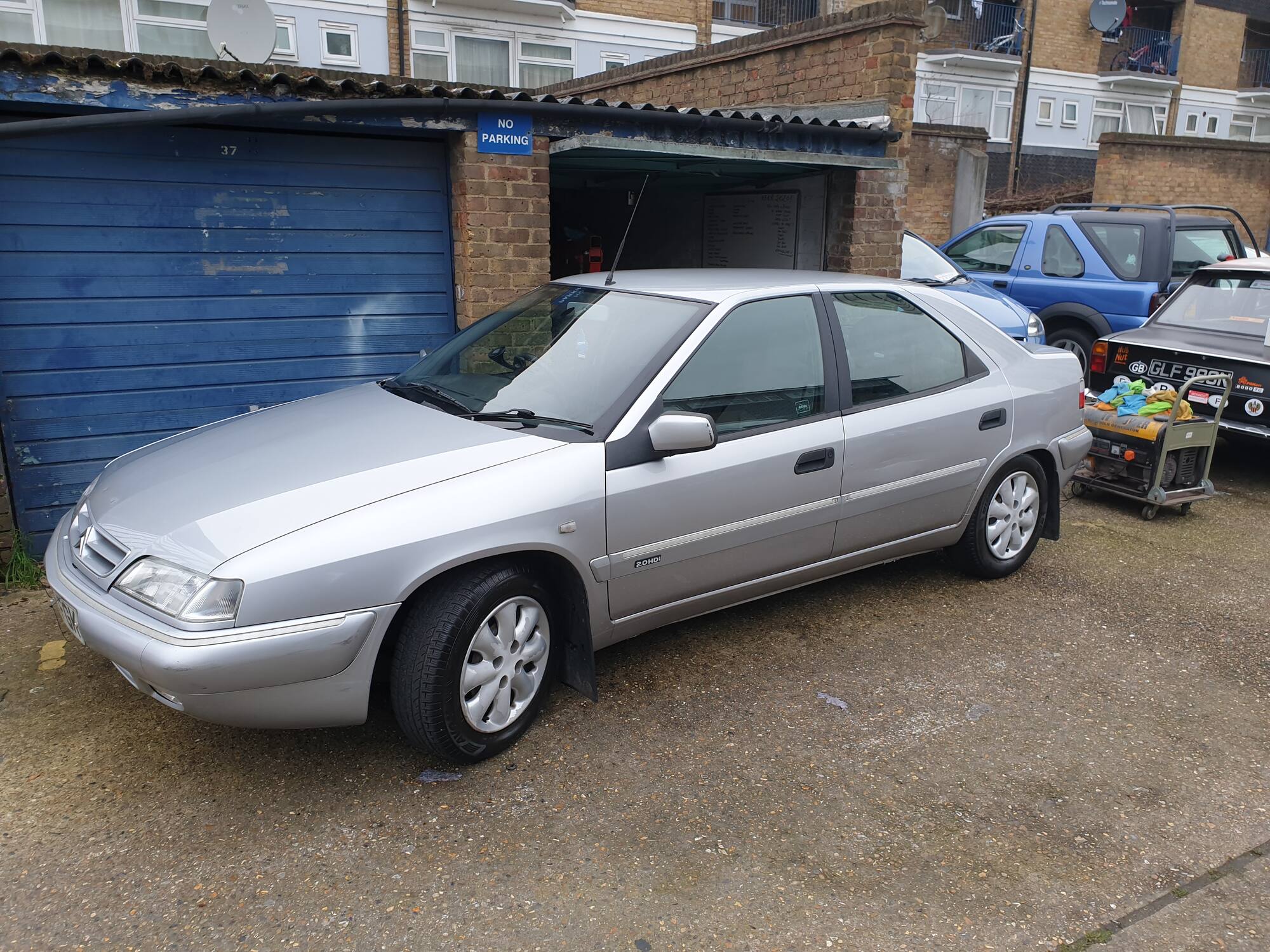

A long and back breaking day but it was worth it for the look on Wingz123's face when he looked over the Xantia.

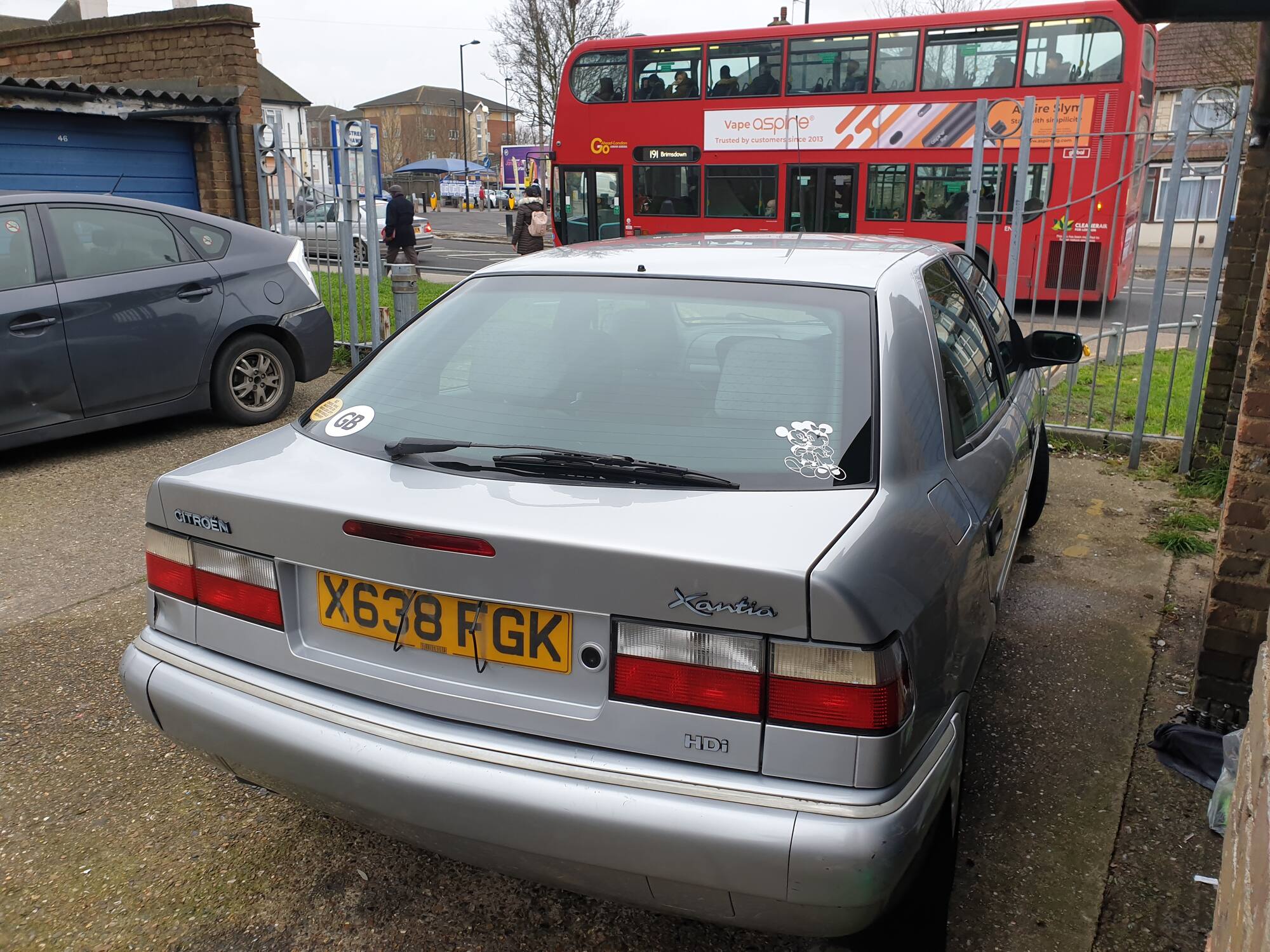

Here we have a couple of before pictures...do bear in mind pictures are taken on a Samsung S9 and not one of your 10megapixel fandangoes...so it maybe a little hard to pick up the difference all this work has made to this french chod... @bramz7 would have done a better job ???☝️
This is Iron-Out by Auto Finesse (you can buy this stuff from Halfords now!)
It creates a 'bleeding' effect which is the chemical reacting with tiny metal fillings stuck to the paintwork impossible to remove during your average car wash...

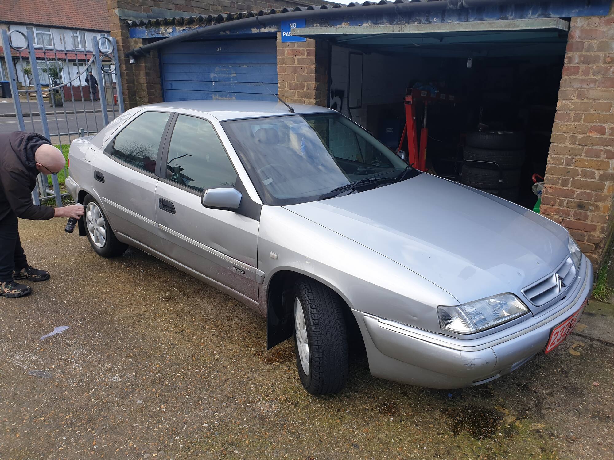

Ken hard at work. Today he taught me ALOT! thank you Ken!

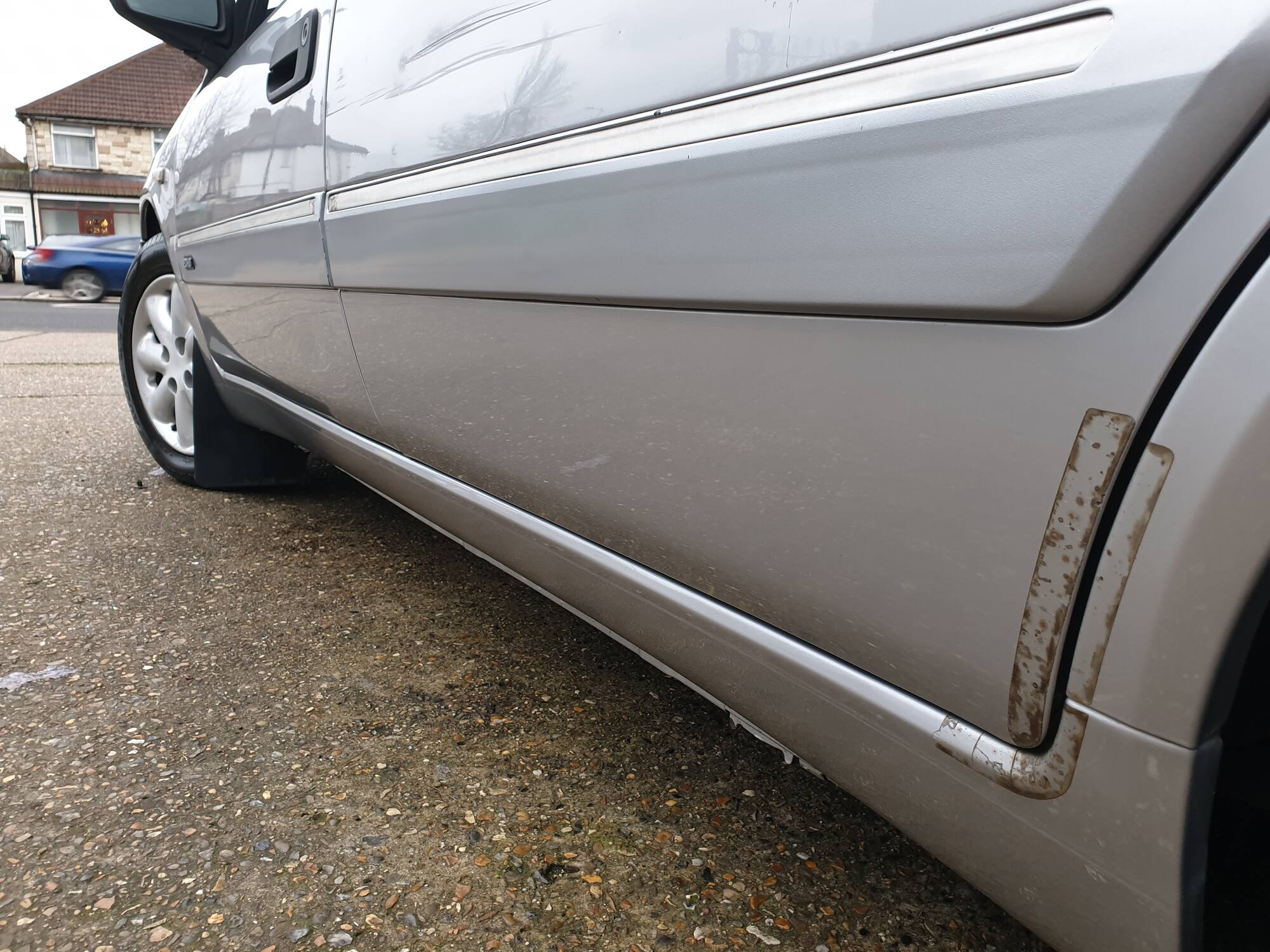

As you can hopefully see the paintwork is a lot brighter and silky smooth to the touch!

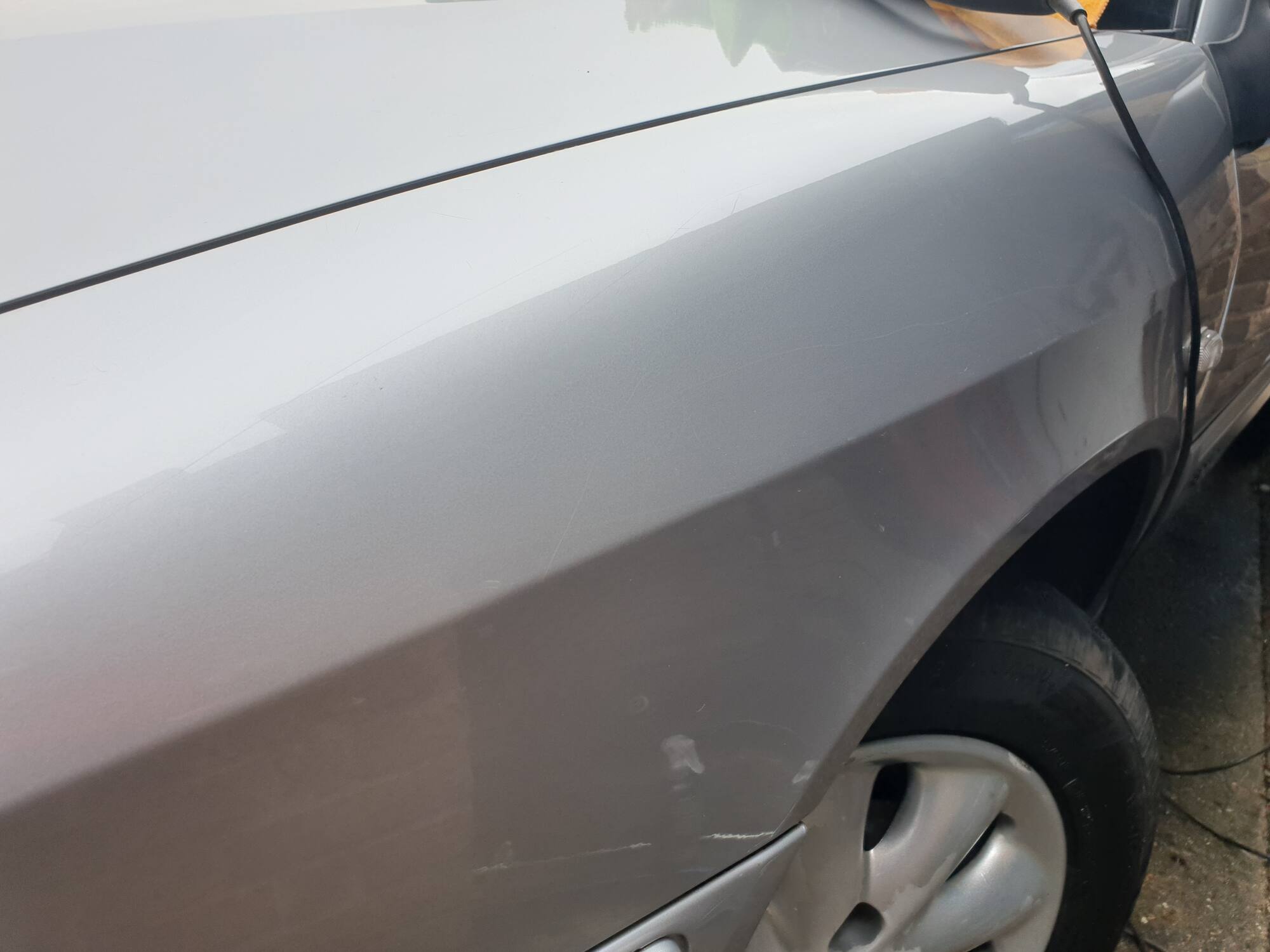

The mini DA did a lot better than it had any right to really. Sadly a lot of the scratches had gone through the lacquer but on the whole the scratches were improved upon. Shame the DA couldn't rectify the dings.
The pictures don't quite do the finish of the paintwork justice, it just glowed :)
It was a pleasure meeting you today mate and am glad that you now feel confident about doing paintwork stuff yourself.  Made the day worthwhile in itself I reckon.
Very nice and congratulations about Spain and back. Shows just how hardy and well engineered these so called 'unreliable' Citroens really are, even when they are in older age.
