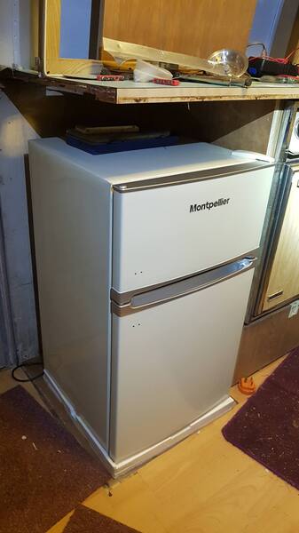

I think I've already mentioned that I needed to replace the fridge, so started to remove it to find it was a structural part of the 'van it seemed! Sturdy steel frame all arpund it which the worktop and cooker was screwed to. To give back some rigidity I cut some 19mm ply to match the curve of the shell, bonded it in place and screwed it to the cooker frame.

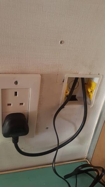

Also shown is the replacement UK socket to power the fridge. I'm no carpenter, so own very few woodworking tools - this was cut with a chainsaw!
Still, I'm pleased that it's come out ok, and will be painted in due course. Less pleased about the worktop, which has rotted due to an old water leak.

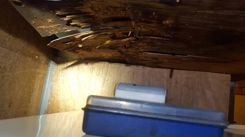

This will need to be replaced, but annoyingly is 25mm thick so thinner than most normal UK worktop. Anyway, the new fridge is in, and the plan is to build in a wine rack below it, and also re-panel the end on the left hand side.

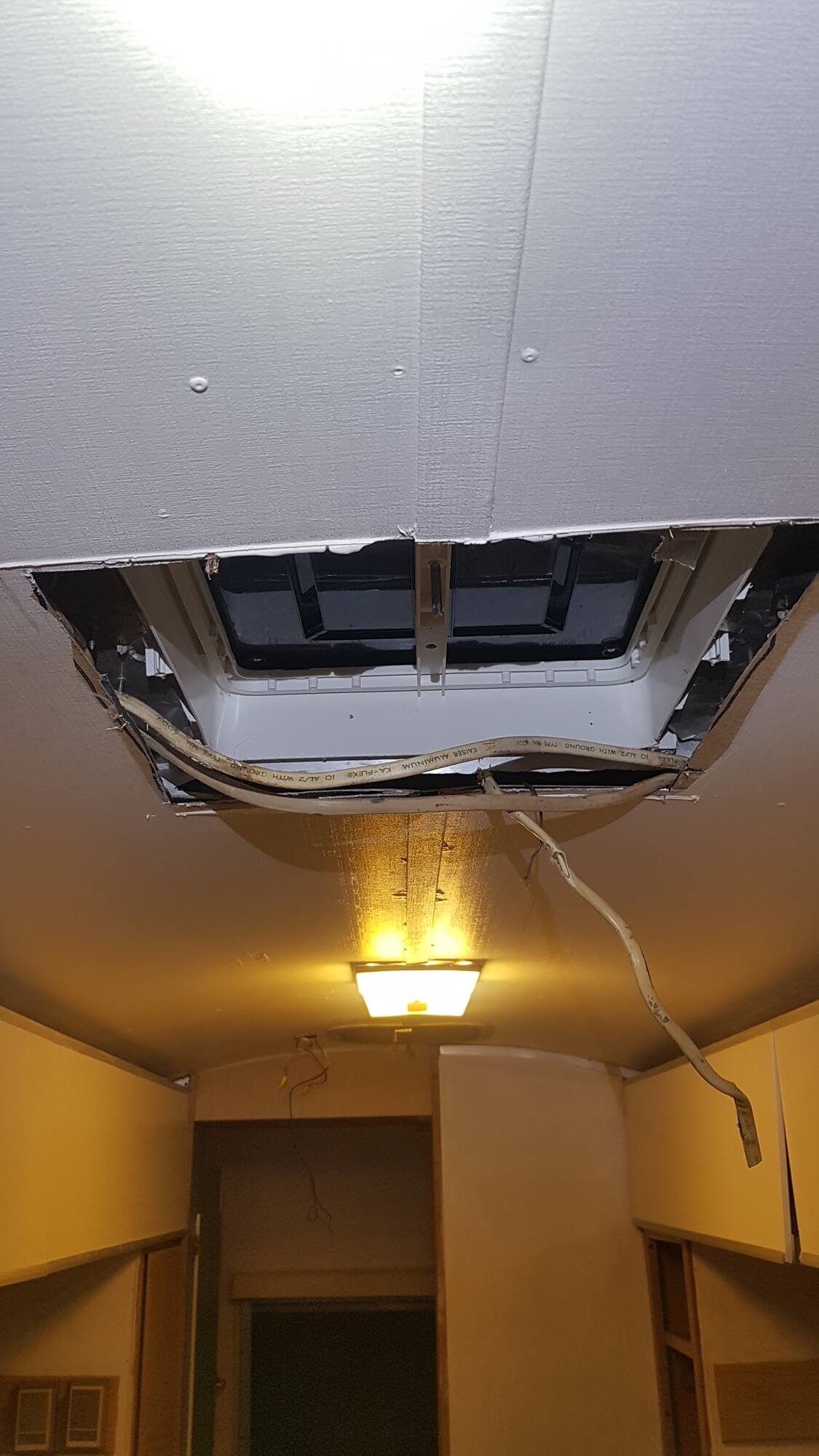

Next job started with removal of a modern skylight which had been fitted, badly!

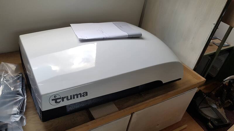

Not only does it look a bit out of place, I want to fit it to the LT, and replace it with this:

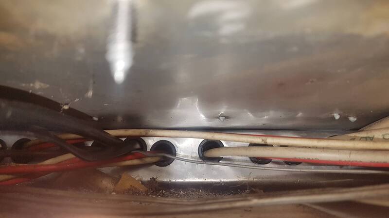

It gets pretty warm inside on a sunny day, not helped by whoever fitted the skylight pulling out half the roof insulation! Plus we need some method of heating, so this will kill two birds with one stone. Air conditioning which can be run in reverse as a heat pump, giving 1700 watts heat for 850 watts electrical input. I've calculated that it should pay for itself in 18 months of use, and also minimise the electrical load compared with conventional electric heaters. Just need some dry weather now...

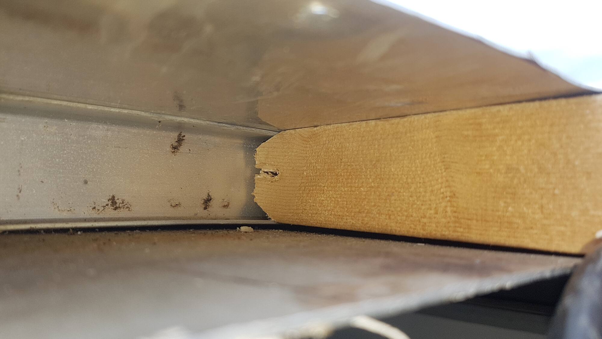

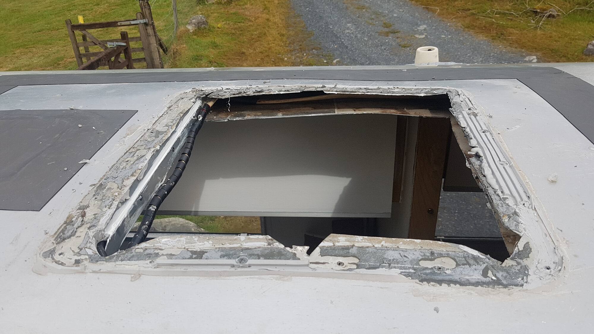

Onto the AC installation this weekend, and the first job once the existing skylight was removed was to repair the butchery to the roof strut. The photo doesn't show it particularly well, but it was hacked through where it was on the edge of the roof aperture, taking away most of its strength.
I protected the cable from chafing, seeing as though there is no longer a grommet, and as you can see I have replaced the missing roof insulation with expanding foam. I had to make up a 1 metre extension nozzle to fill the void, which took 2.5 cans.
Once that had cured I cut a length of aluminium angle extrusion to splint the old strut, bonded and riveted in place.
This still won't be quite as strong as originally, but the old AC unit weighed 45kg, and the new one only 33kg. Plus it won't be doing many road miles, hence few dynamic loads - and it takes my 80kg load doing pull-ups!

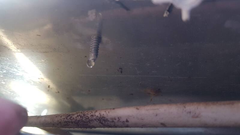

I'd also found that it was dripping from several of the securing screws, so this will give me an opportunity to cure that.

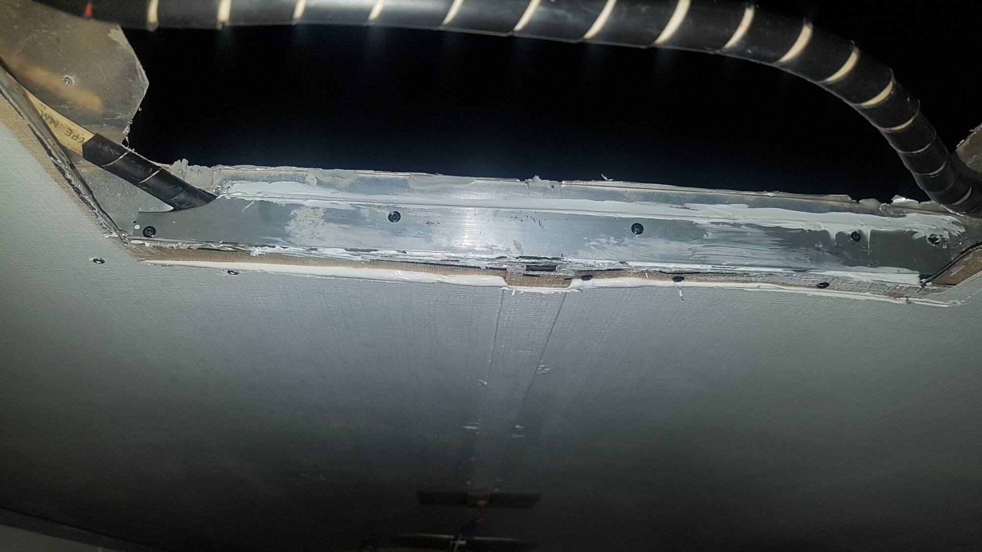

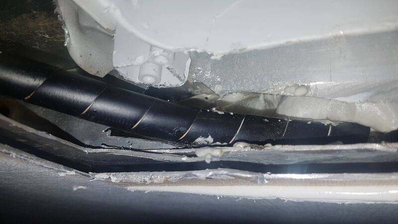

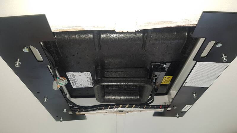

I spent an entire afternoon routing the power and control cable, as I didn't want them to be visible on the inside. Threading them through the first grommet was not too tricky...
...but getting them through the next strut took lots of patience and probing with a thin fibreglass rod. Eventually I got them to pop out where I will be fitting a fused spur unit, inside a cupboard.

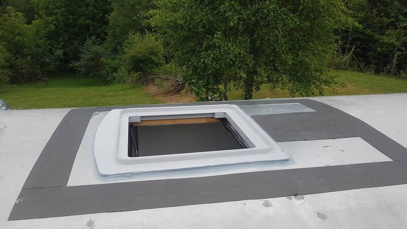

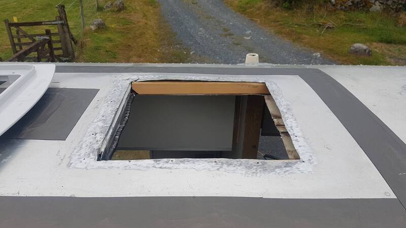

Next morning I began to tidy up the shocking job they'd made of the roof aperture!
I cut back to the correct size, wire brushed away the old sealant (some of it just peeled off), and drilled out the end of a couple of cracks which had propagated from cut notches.
You'll notice I've put in a wooden spacer each side; this is to prevent the roof from collapsing in when I tighten the clamp plates which secure the unit. The wood extends on the inside to rest on one of the existing roof struts, to spread the load.

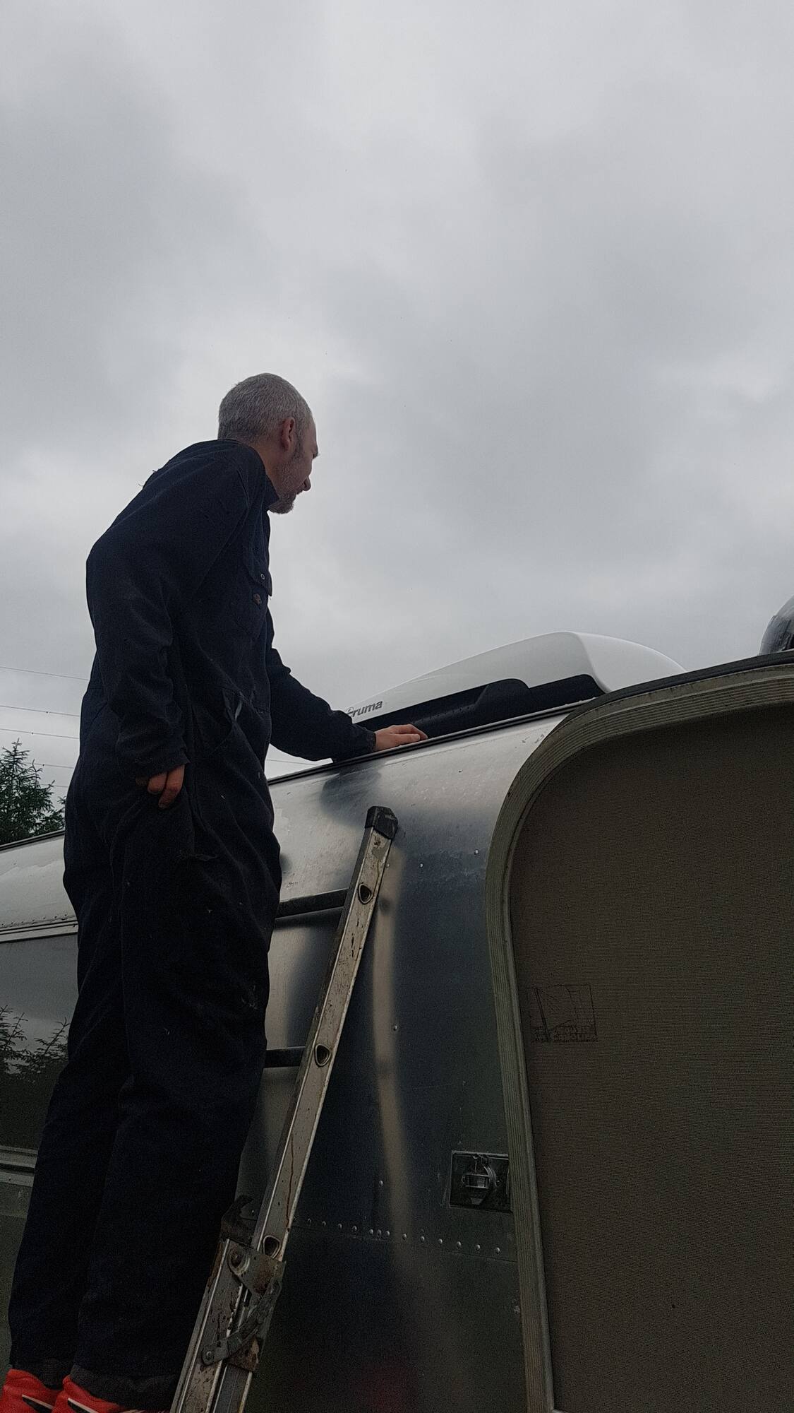

You can just seal the unit to the roof, but I bought a reinforcement frame, which helps to seal the old screw holes plus again spreads the load a bit.
The lead flashing is to cover the screw holes left by the original AC installation, and can't be seen from the ground. Next was the nerve-wracking job of hoisting up 30+kg up a ladder and onto the roof!
Must admit my arms were feeling the strain a bit! Back inside I connected the wiring and clamped it all in place.

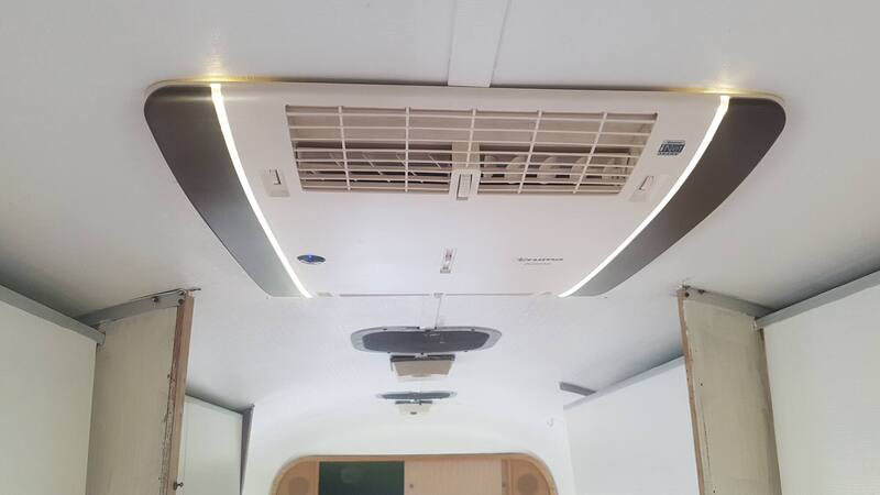

Final job was to fit the interior air outlet. This is usually grey, but you can get cream/brown to special order. This matched the inside of the Airstream much better than grey would have done I think.
I even quite like the LED strips it has - at least they are a warm white, and are dimmable from the remote control, so hopefully will create a cosy atmosphere inside. Firing it up it all works nicely in both cooling and heating modes, although yet to try it on a *really* hot day.

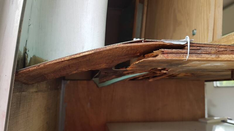

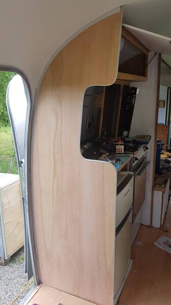

The end plywood panel at the side of the fridge was delaminating terribly, as a result of what must have been a long-standing water leak.
This fits into an aluminium channel on the wall, and is also capped on the outer edge with another aluminium extrusion, so I had to match the thickness of 5.5mm, which it turned out that 6mm ply measures typically! I've gone for a moisture resistant phenolic glue to better withstand condensation, and any future leaks.
Marked out the shape:
And cut to size. I've only loosely put it in position for now, until the worktop is sorted.
Tapped on the capping, and looks a lot better :-)

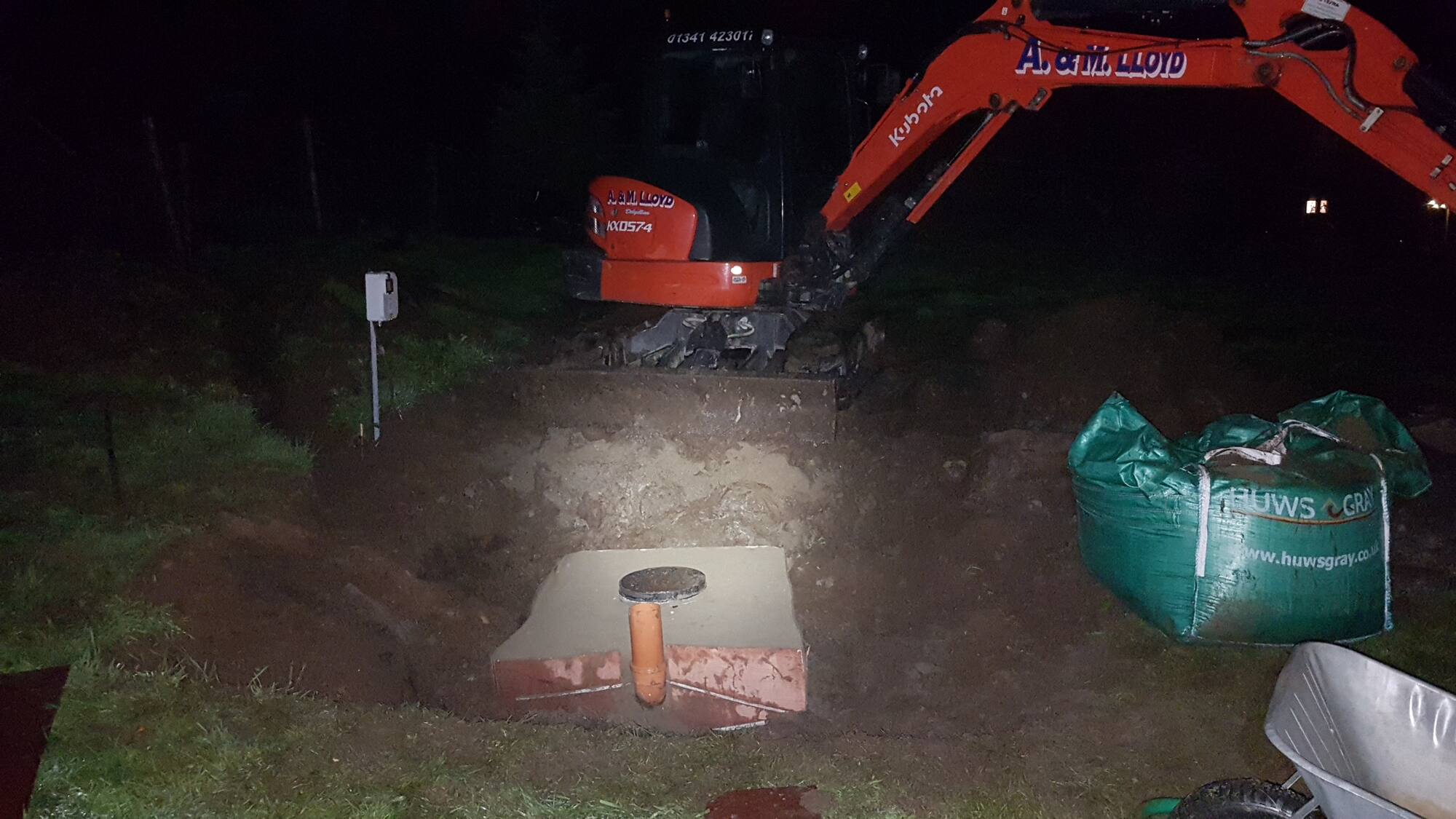

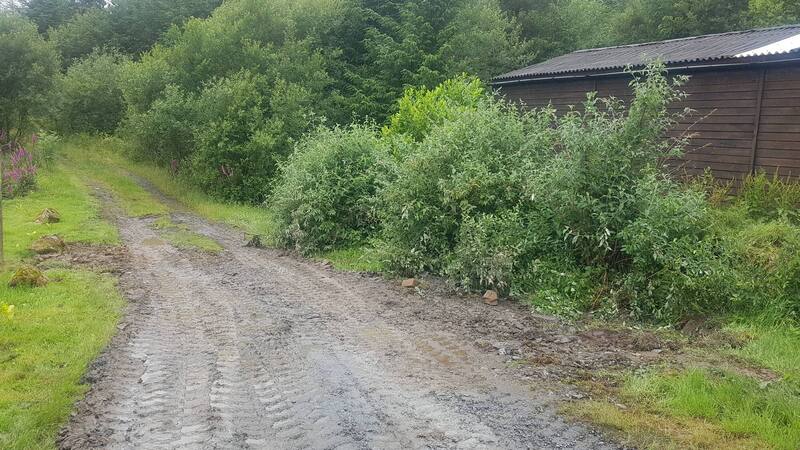

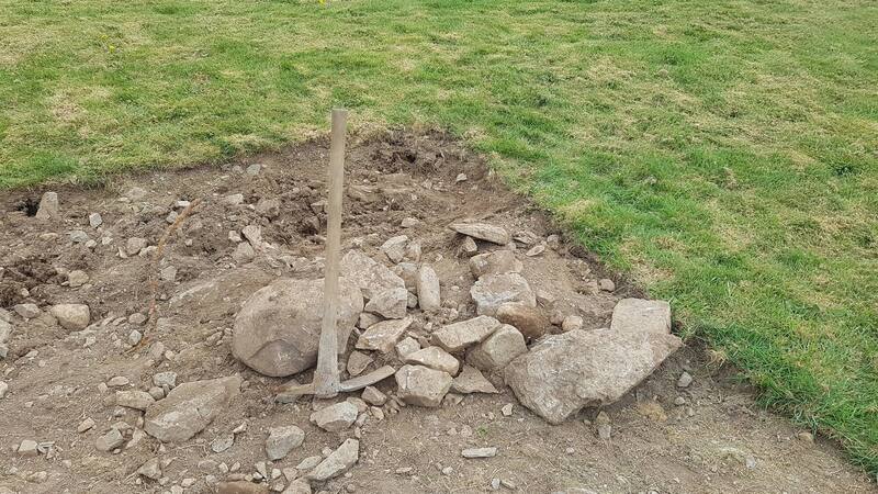

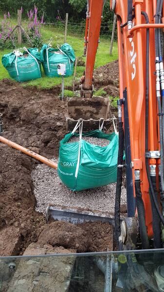

I hired an excavator this weekend, so the warm, dry weather of course ended on Friday. Trying to work with wet soil is just so much harder, especially when it's clay. The reason it was needed was to install a septic tank, and lay the electricity supply.
The tank was based on a reclaimed IBC, so required surrounding in concrete before backfilling.

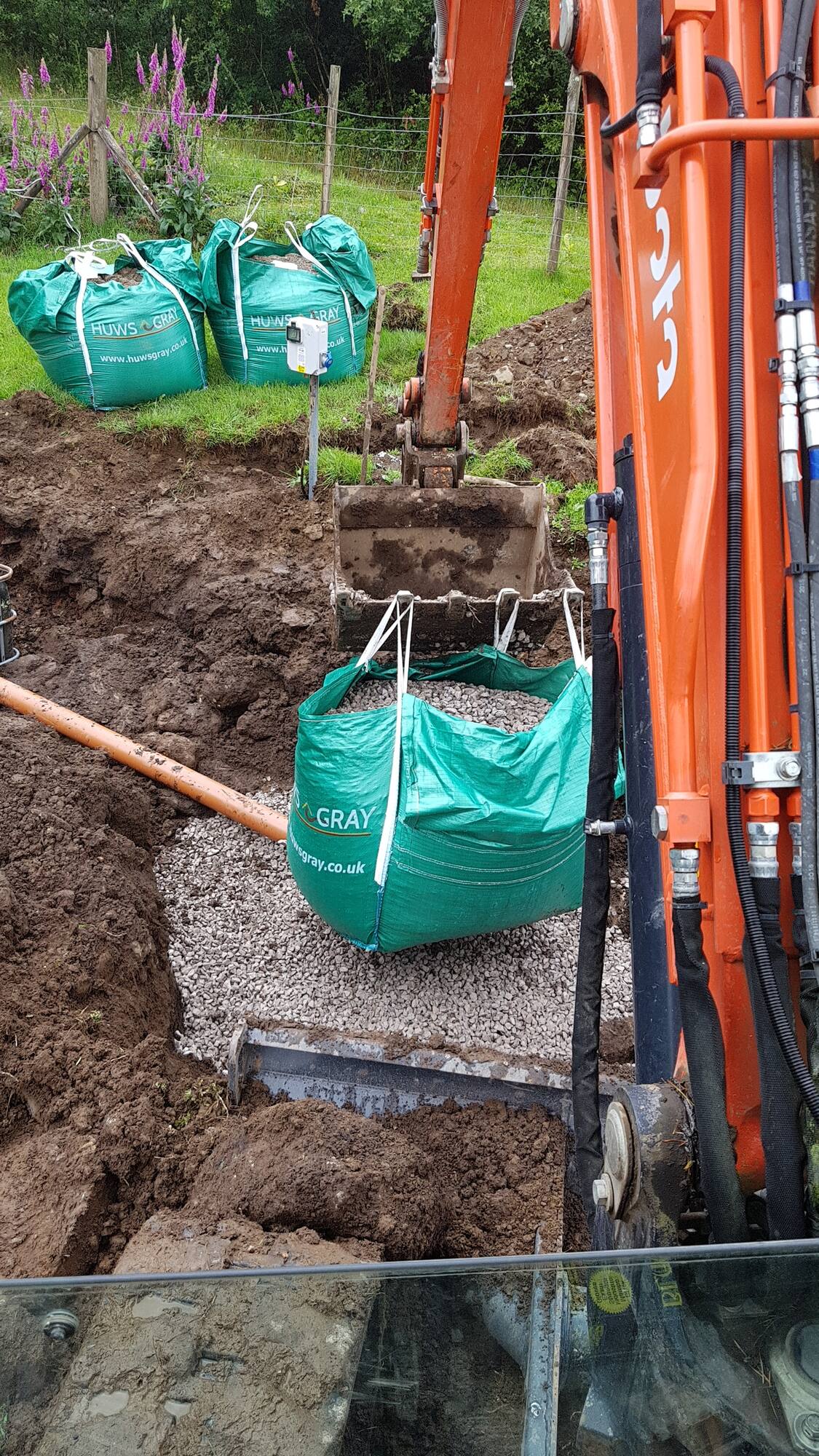

The outlet from this was led to a generous sized soakaway.
And then all filled in and smoothed over as best I could. I've run the mains cable under the track, from my workshop.
And this is the finished area, looking a bit of a mess right now!
I'm only really concerned about the gradient side to side, as front to back there is a deliberate slope down to the stream to aid water run-off, which will be accommodated by levelling the Airstream at the hitch. Question is, how level did I manage to get it?
That'll do!

Worse than that. I had been very naive in choosing what to install, and had settled on a simple system similar to this:
I normally research everything to death, but having little interest in sewage, and had seen this fairly early on in my fact-finding so didn't look any further. It even stated on the website that planning permission was not required!
We have had heavy rain all weekend, which progressed to torrential on Sunday night. When we awoke the whole thing was submerged :-(
106139574_292890365196019_813898063337508366_n.thumb.jpg.3cbeb34f40288f01a10bdc504617033b.jpg
As an absolute best case scenario, this may be because the hole was filling up with rainwater through the excavation, coupled with abnormal rainfall afterwards (the river downstream of us had flooded for only the third time in 15 years). But the thought of water backing up through the soakaway once the septic tank is put 'to use', doesn't bear thinking about! There then followed the research I should have done to start with.
First thing I discovered was that septic tanks cannot discharge to a soakaway - it has to be a drainage field, i.e. a network of trenches filled with gravel relatively close to the surface. This is so that the bacterial action necessary can take place BEFORE seeping down to the water table. Too deep and this will not happen. Secondly, there needs to be a sufficient distance AT ALL TIMES between the drainage field and the water table so that the two never meet. I should have dug a test hole to a certain depth, and carried out a percolation test. But I'm confident that with the weather we have here, that test would fail unless we're in a drought.
So that leaves two options really (three if you include a composing toilet). Firstly a large holding tank aka cesspit, which is emptied at regular intervals; or a sewage treatment plant which cleans the outfall to such a level it can be discharged to a stream, subject to a permit. (In England you don't need a permit if it's less than 5000 litres a day, but in Wales I'm not certain this still applies).
