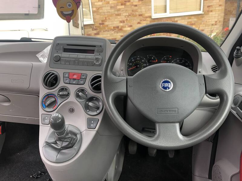

Aston Martin Posted October 5, 2019 Author Posted October 5, 2019 Wheel not attached yet, but looks better. privatewire, Ian_Fearn, Jim Bell and 2 others 5
Jim Bell Posted October 5, 2019 Posted October 5, 2019 Those seats look sexy as F. Not sure about the wheel though. Aston Martin 1
Aston Martin Posted October 5, 2019 Author Posted October 5, 2019 The headrests are too high up, the problem is 500 headrests have the notches on the inside and Pandas are on the same side. I'm going to attempt the door cards tomorrow and the rear support bar can wait as I've driven for hours two Saturdays in a row and I'm fucked. The wheel and dashboard of a Panda are all plasticy and grey, I like the wheel. Well, when it gets retrimmed. P.s. Some 500 seats have a storage box under the passenger seat as it flips up.... Mine has it. ? Ian_Fearn, jumpingjehovahs and privatewire 3

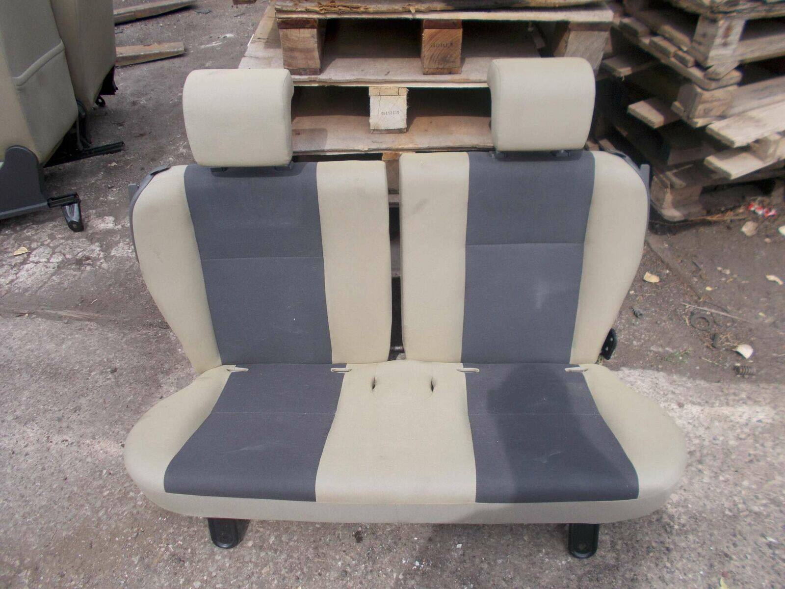

Aston Martin Posted November 13, 2019 Author Posted November 13, 2019 There's a possible rear seat solution, but it's pricey and may not work. So I'm enquiring obviously. ?
Aston Martin Posted November 13, 2019 Author Posted November 13, 2019 OK, the 500 rear seat is a disaster zone. The facefuck group suggests fabricating a rear bracket. I suggest, never in a thousand years. My plan is to buy a Panpan folding rear seat... Remove the covers and attempt to put the 500 covers on the Panpan bases. (Maybe not the seat base, just the backs) Will this work? Fuck knows and it turns out there's at least two Panpan folding rear seats. One with outer seat releases and then the facelift which for some reason has the releases at the bracket on the front. Exhibit A: shagged and holed rear seat in Rotherham, which comes with the bracket. I've had a look at the Alessi rear seat, which is the same as this one and there's no visible way to remove the metal back, to then remove the cover. I've added the picture of a Panda rear seat and a 500 rear seat. Both appear to be built a similar way. The Moog 1
artdjones Posted November 13, 2019 Posted November 13, 2019 The seat latch cover seems to come off with a couple of screws.Why not remove that and see how the seat cover attaches.Sometimes a strip sewn to the seat cloth pushes into a channel on the metal part and the stretch of the material over the foam holds it all in place. Aston Martin 1
