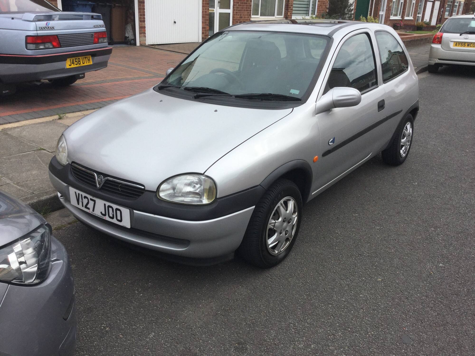

paulscavalier Posted January 6, 2020 Author Posted January 6, 2020 Been a bit quiet on this because I have been occupied elsewhere, but I have machine polished it and tidied it up. I have had to replace the mass air flow sensor , outside temp sensor and the reverse light switch and 2 front tyres. It looks a lot better with tlc Jim Bell 1
paulscavalier Posted January 6, 2020 Author Posted January 6, 2020 Fumbler, Jim Bell, jumpingjehovahs and 5 others 8

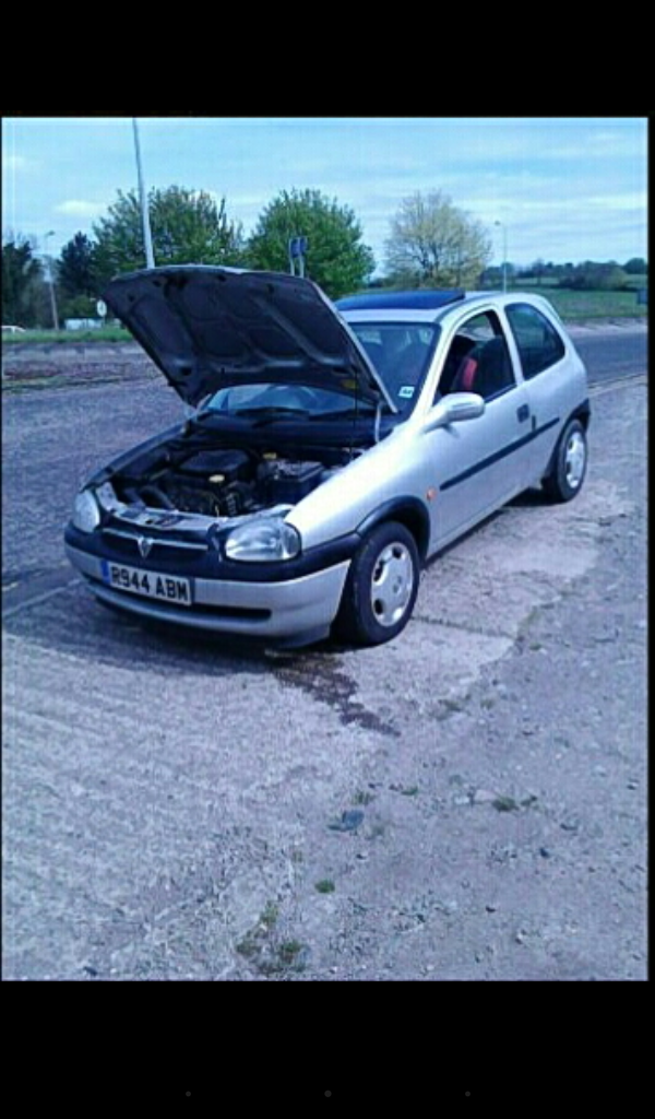

Dannyk Posted January 6, 2020 Posted January 6, 2020 That is lovely. I have a thing for corsa b's. wouldn't mind another. This was my last one (Not the best pic of it)
paulscavalier Posted January 6, 2020 Author Posted January 6, 2020 Same spec as mine late corsa b. It’s been great to buzz around in. I will miss it when my daughter passes her test Jim Bell 1
