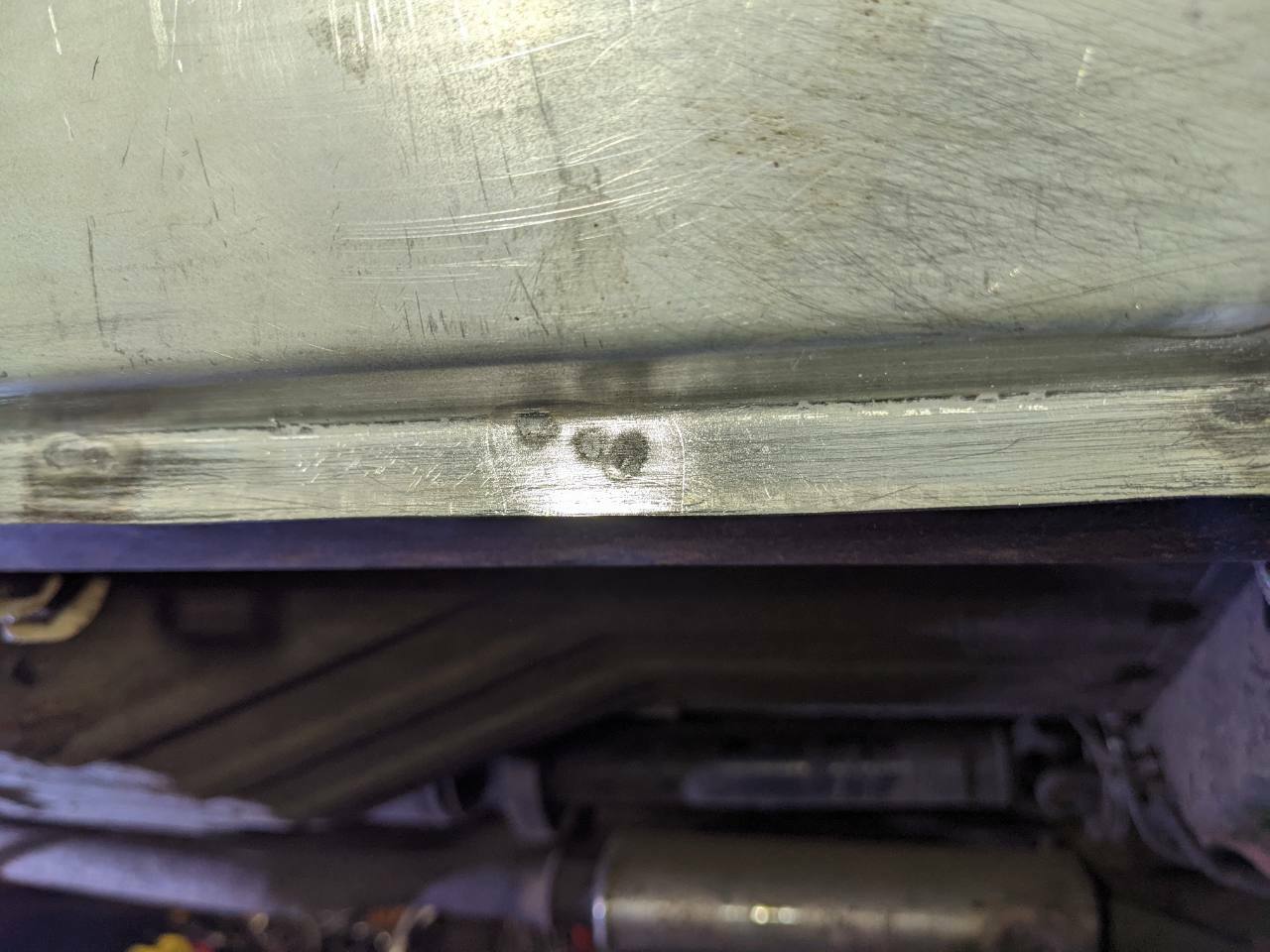

While I have your attention, do you reckon the penetration is good enough here? I've reverted to manual mode now and trying to learn how to setup a machine myself. The welds are the other side and this is the backside.
6 minutes ago, SiC said:
Plenty of meat left on the plate in mine, so I think I may just go a size bigger. The pillar is still factory and in good condition otherwise, so don't really want to go choppy chop into it. Even if the factory welds are quite laughable.
As long as it's showing penetration on the opposite side of the weld it should be good.
I'm using mine about 14v and 7 on the wire feed atm with 0.6 wire on 0.8 steel and it seems to do fine.
Yeah that's the opposite side.
That's running on 22.5v/4.5mm with 0.6 wire on 1.2mm steel. I've found that I can run at a lot higher voltage and speeds than synergic default, which I find more comfortable and still getting (what I think are) decent welds.
The synergic is crap on it anyways, I tried it once and it was totally wrong for how I weld.
I'm up in the 18-23V range on 1.2 with the wire speed about 9-10 depending on the joint I'm welding.
